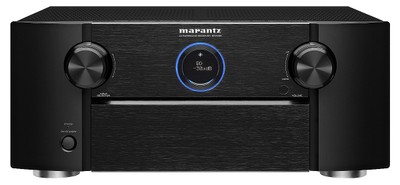

Marantz SR7005 3D Ready 7.1 A/V Networking Receiver Preview
- Newly designed clean front panel with a porthole 2nd display

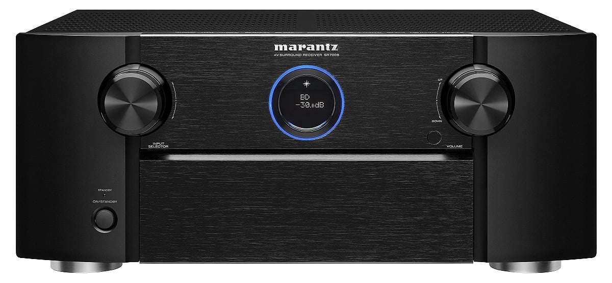

The SR7005 is positioned to replace the SR7002 as the second from the top of the line flagship model yet to be announced. The SR7005 (MSRP: $1599) retails for $200 more than the SR7002 but lacks the THX Select2 certification of the latter. The new SR7005 looks strikingly similar to their high end audiophile reference gear. In fact, the SR7005 shares the same dimensions as their AV8003 reference A/V pre/pro. Personally I find this look to be a significant cut above your run of the mill A/V receiver. One can't help but gawk at the simple and elegant chassis with rounded edges. While THX certification may be gone with this new baby, it more than makes up for it with a host of new and much needed features.

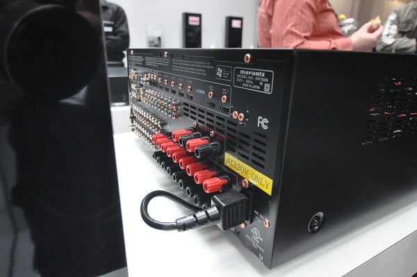

Marantz SR7005 Backpanel - courtesy of forum.blu-ray.com
I confirmed with Marantz engineering that the new GUI OSD will overlay over HDMI with simultaneous volume control display support, something again that previous Marantz receivers were incapable of doing. 6 HDMI inputs (5 rear, 1 front) and 2 HDMI outputs ensures you have plenty of ports to support all of your HDMI equipment. In fact, this is a significant step up in HDMI connectivity from the 4 inputs of the SR7002.
There are 11 speaker outputs all utilizing binding post connections. This gives the user the option of installing a 7.1 system (2x front, 1x center, 2x side, 2x rear or 2 x height) plus 2 speakers for another zone by assigning two of the seven channels to rear, height or zone2). Best of all they don't have to fiddle with rear panel speaker connections each time they decide to change the allocations of those two channels as it can all be configured through the Marantz setup GUI for each mode of operation.
It seems that Marantz has addressed every criticism we offered in our SR6004 review and took their receiver line up to the next level with their latest xxxx5 series. We are looking forward to engaging a formal review of the SR7005 as we have high hopes for its performance and operation given the recent trend of Marantz building a better product which each new generation. We love their new reference look with the porthole frontpanel display and the oversided dot matrix display conspicuously hidden in the door panel below.
