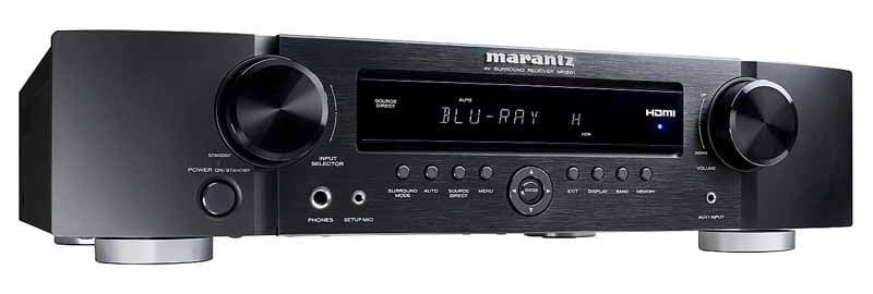

Marantz NR1501 Introduction

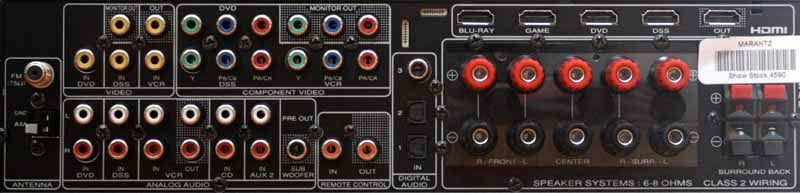

The Marantz NR1501 Surround receiver has it where it counts. For example, the system will handle three composite and three component video inputs and upconvert those to its single HDMI output. This means that users with legacy equipment, such as older DVD players and set top boxes, can simply connect these up to the NR1501 and still get that output to their televisions with just a single HDMI cable. For those looking to wall mount a new flat panel display, or with remotely-located equipment, this is a wonderful feature. It also means that you won't have to switch inputs on your television when going from component video to HDMI. These days, convenience gets a lot of weight in home theater product decisions. The NR1501 doesn't scale incoming video, it merely transcodes it. What this means is that if you send a 480i signal in via component video, it will go out the HDMI output at 480i. This is actually a good thing, since we've seen lots of AV receivers do worse jobs at processing video than displays. If you have a great TV, let's let it do something!
In terms of audio the NR1501 has 5-way binding posts for all channels except the Surround Back channels which feature spring clips. With these clips you'll want to stick to using 18 gauge wire or higher (smaller) but we don't see this as particularly troublesome, especially given the space and cost savings. There are three S/PDIF inputs, a sufficient number given that there are four HDMI inputs which also support multi-channel audio (including the uncompressed Dolby TrueHD and dts-HD formats). If you still use analogue sources there are CD and Aux 2 stereo inputs in addition to the audio inputs available for all analogue inputs. The way Marantz handles its inputs is that they are all pretty much assignable, but by design there are fully analogue options for DVD, DSS and DVR and HDMI (without analogue audio options) is fully dedicated to Blu-ray and Game.
NR1501 rear
S-video has finally bitten the dust – R.I.P.

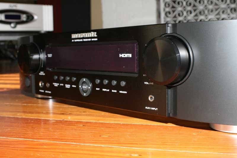

Marantz NR1501 Build Quality

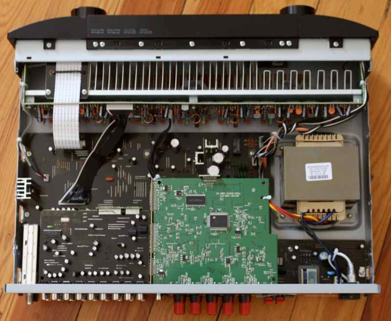

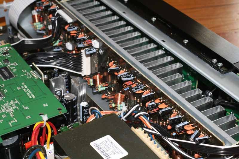

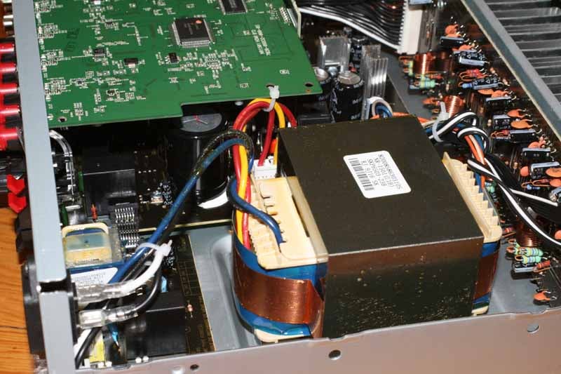

The receiver is quite attractive. It's not as tiny and "toy-like" as some of those infamous Class-D receivers that were (are?) popular for those looking to save space and heat. In the case of the Marantz NR1501 it really does seem like they truly are saving space without sacrificing too much. The receiver is a full 2-inches shorter than its elder brother, the SR5004, and an inch less in depth to boot. It maintains that nice rounded front edge that puts a lot of other mainstream AV receivers to shame – the products just looks a high end piece worthy of recognition. We popped open the hood of the NR1501 and found a full-size EI power transformer and a large heat sink that really defied our imaginations of what could fit into such a small container. In addition, all of the channels use dual push pull transistors instead of a chip amp (in fact, no current Marantz receivers use chip amps).  Many manufacturers (like Yamaha, for example) are now saving costs by using chip-based amplifiers in their $600 and under receivers. Kudos.
power supply 1 transformers
NR1501 guts
Marantz NR1501 Inside Views
