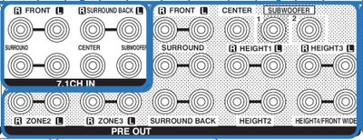

- The above facilitates the ability to run BOTH a 13ch Auro3D setup and a 13ch (9.1.4 / 7.1.6) Atmos setup without having to ruin positioning for one or the other. Because there are FOUR pairs of height speaker outputs (pre-out and speaker posts), with flexible assignment (including being able to assign Height4 to Front Wide output) you can do a complete Auro3D setup with five heights + VOG and still have another pair of height outputs for Top Middle or Front Wide use with Atmos.
- The X6400H, of course, can only do 7.1.4 (no wides) and is limited to 10.1ch Auro3D (5.1 + 4 heights + VOG). And the only way to practically mix Auro + Atmos is to use a Front Height + Rear Height layout. Plus the X6400H requires you to sacrifice the Sub2 output for VOG if you want to do 10.1ch Auro3D, whereas the X8500H has dedicated outputs for Center Height and Top Surround (VOG).

- 7.1ch multi-ch analog audio inputs, extra (3 vs. 2) component video inputs.

Here's the back panel pre-out layout, there are FOUR pairs of height outputs and Height4 which can be reassigned to Front Wide.
This allows for a 13.1ch Auro3D layout combined with a 9.1.4 or 7.1.6 Atmos layout.
