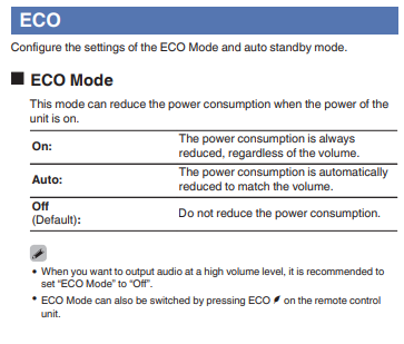

1. ECO Mode Can Limit Available Amplifier Power
Eco Mode AVRECO modes are designed to reduce power consumption and heat. Depending on the AVR design, an ECO setting can accomplish that by reducing the power-supply rail voltage available to the amplifier channels. Lower rails mean less voltage swing is available at the speaker outputs, which can reduce maximum unclipped output and headroom.
That may be perfectly acceptable at low or moderate listening levels, but it can become a performance bottleneck when you turn the system up and ask the receiver to reproduce large dynamic peaks.
Audioholics recommendation: Use ECO Auto if your AVR offers it, or switch ECO Off when you want maximum output capability. If you listen quietly most of the time, ECO can still be useful; just understand the tradeoff.

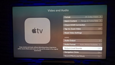

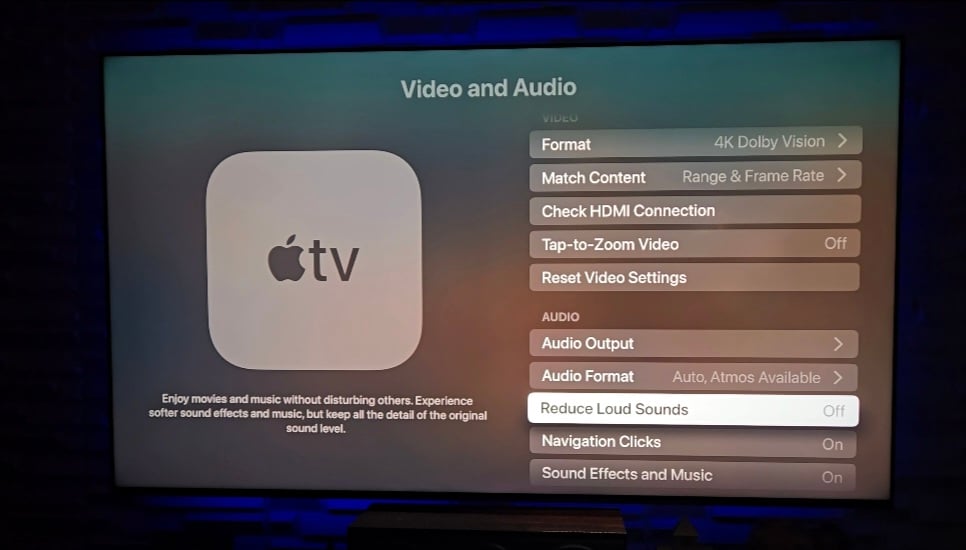

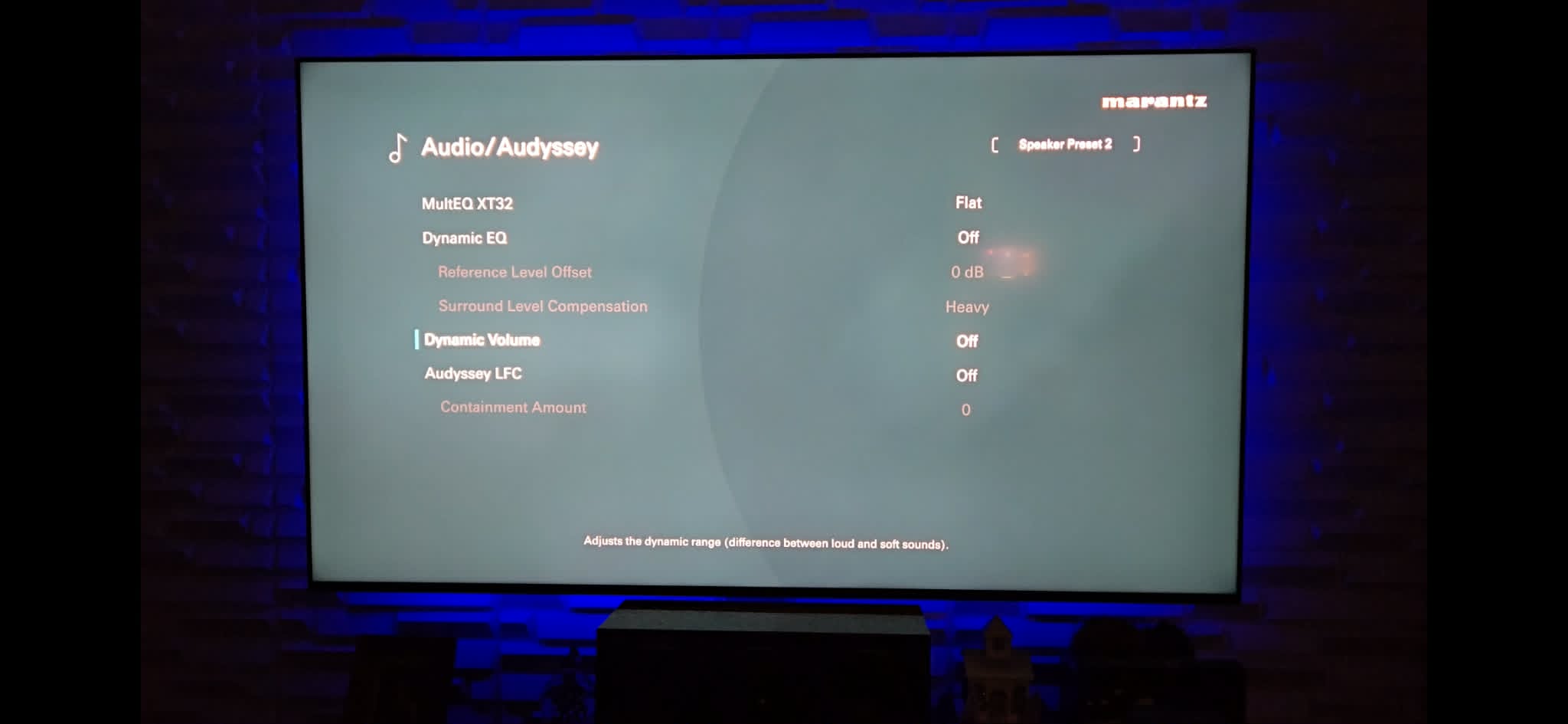

2. Dynamic Compression Can Steal Your Systems Impact
Dynamic Range Compression doesn't normally reduce an amplifier's electrical power capability, but it can absolutely make a powerful system sound less powerful. Its job is to narrow the difference between quiet and loud sounds. That can be useful for late-night listening, but it also reduces the transient impact of explosions, percussion, orchestral peaks, and other high-dynamic-range content.
Audyssey DynamicEQ Apple TV Audio
The tricky part is that compression may be enabled in more than one place. Your streaming box, streaming App. Blu-ray disc player, TV, game console, AVR, or surround processor may have settings labeled Dynamic Range Compression, DRC, Night Mode, Reduce Loud Sounds, or similar terminology.
Audioholics recommendation: For critical movie and music listening, check both the source device and the AVR/processor and disable unnecessary dynamic compression. Turn it on only when you intentionally want a reduced dynamic range.

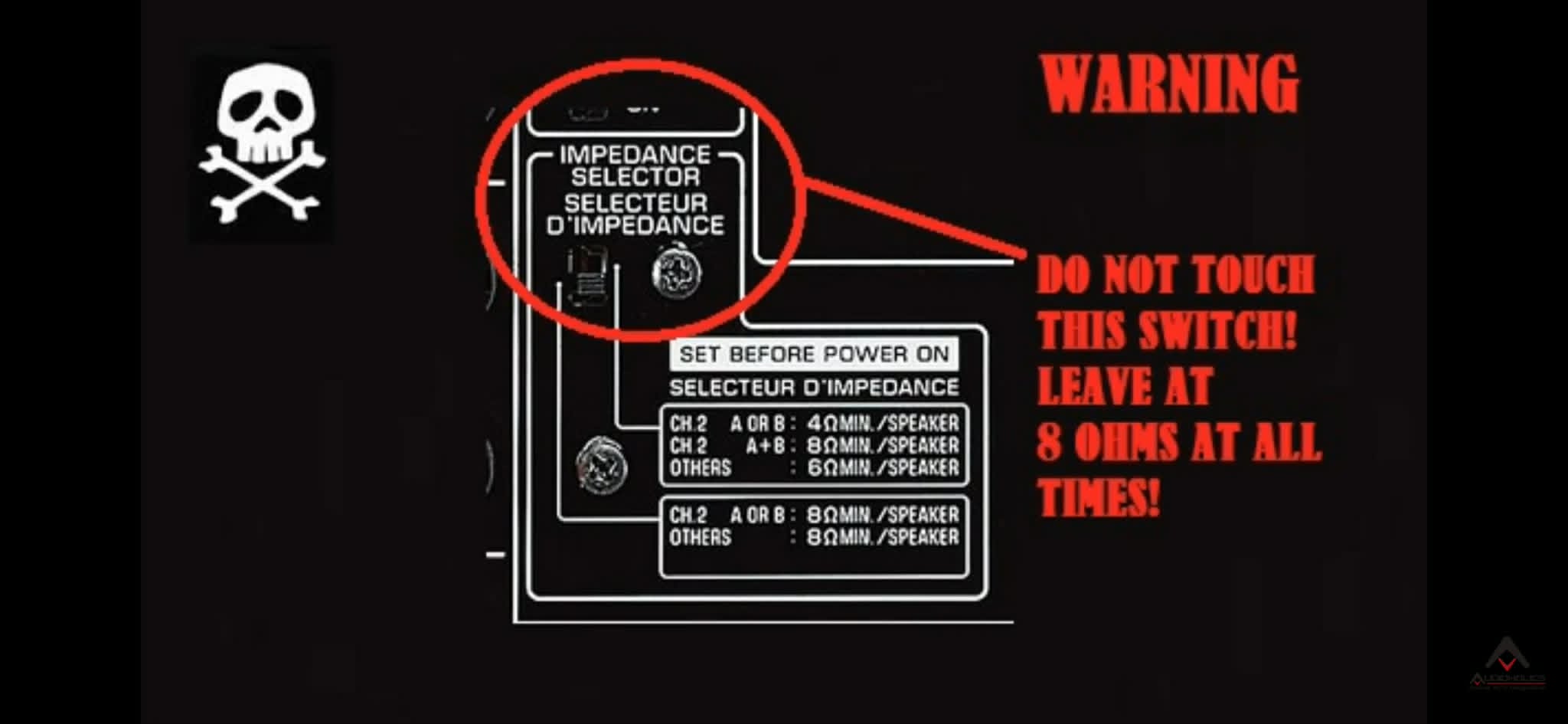

3. Don't Let the Impedance Switch Derate Your AVR
Impedance SwitchThis is one of the most misunderstood settings on an AV receiver. A loudspeaker labeled "4 ohms," "6 ohms," or "8 ohms" does not present that exact impedance at every frequency. Real loudspeaker impedance varies with frequency, and the difficult portions of the impedance curve are what place the greatest current demands on the amplifier.
On many AVRs, selecting the low-impedance mode does not magically make the amplifier better suited to a 4-ohm speaker. Instead, it can reduce the amplifier's supply rail voltage so the receiver runs cooler during demanding safety-certification tests. The downside is reduced maximum output and less headroom before clipping.
Audioholics bench testing has shown that this reduction can be substantial on some receivers. In the cited tests, five of six receivers produced significantly less power in their low-impedance modes, with the amount of derating varying considerably by model.
Audioholics recommendation: For maximum available output, we generally favor the receiver's default/high (typically 8-ohm) setting rather than voluntarily engaging a power-limiting low-impedance mode. Be mindful of ventilation, playback level, speaker sensitivity and impedance behavior, and the manufacturer's safety guidance—especially with unusually difficult speaker loads.
Read: Setting the A/V Receiver Impedance Selector Switch

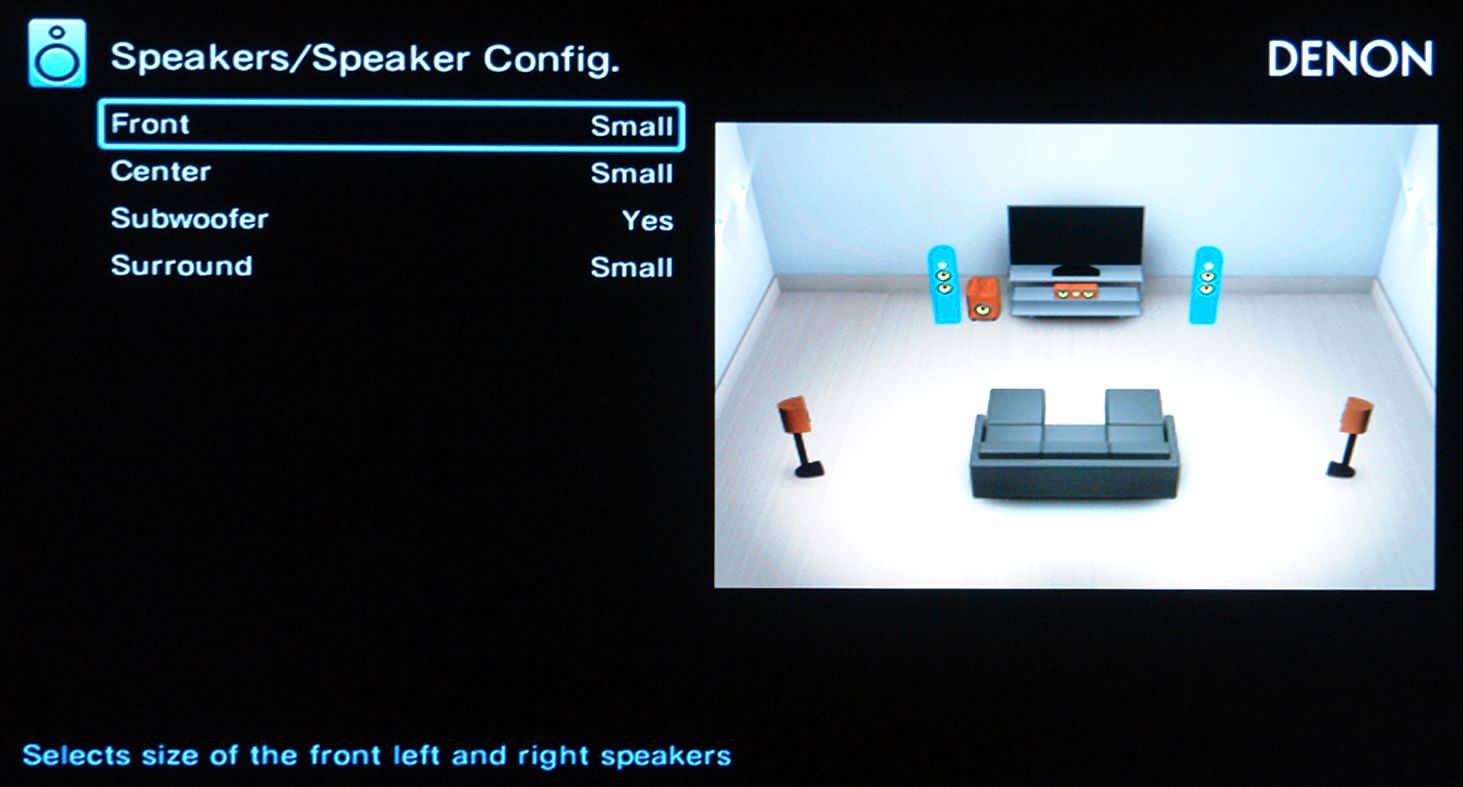

4. Poor Bass Management Wastes AVR Power & Headroom
Deep bass is expensive—in amplifier power and in loudspeaker excursion. Asking every speaker in a home theater to reproduce deep bass full-range can put unnecessary stress on both the speakers and the AVR, particularly when those speakers cannot reproduce the lowest octaves cleanly at meaningful output levels.
When a speaker is set to Large, the AVR generally sends that channel full-range information. If a bookshelf or modest tower speaker cannot reproduce strong 25–40Hz content, feeding it that energy doesn't create useful deep bass. It can instead increase cone excursion, compression and distortion while consuming amplifier resources.

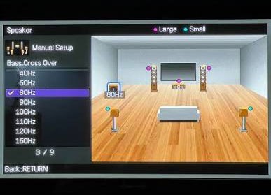

Bass Management  AVR Crossover
Setting the speaker to Small engages bass management. Low-frequency information below the selected crossover is redirected to the subwoofer, while the main speaker handles the range it can reproduce more efficiently. Because most home-theater subwoofers are self-powered, this also moves the most power-hungry portion of the soundtrack away from the AVR's internal amplifiers.
Audioholics recommendation: Start with speakers set to Small and an 80Hz crossover for most conventional home-theater systems. Adjust upward for small satellites and, where appropriate, lower for capable speakers after considering their measured response and system integration. If your AVR provides a separate LFE low-pass setting, 120Hz is the standard starting point for the LFE channel.
Proper bass management can deliver better dynamics, greater amplifier headroom, lower distortion, and more consistent bass—without buying a new amplifier.
Read: AV Receiver Bass Management Basics – Settings Made Simple

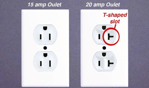

5. Your AC Circuit Can Rob Your AVR or Amplifiers of Power
Dedicated OutletYour amplifier cannot deliver power that it cannot draw from the wall. A typical U.S. 120V/15A circuit has a nominal 1,800-watt capacity, while a 120V/20A circuit has a nominal 2,400-watt capacity—a 33% increase. More importantly for a serious theater, a dedicated circuit keeps high-current audio equipment from competing with lighting and other devices on the same branch.
This does not mean every home theater needs a 20A circuit. A normal AVR, display, source components and moderate subwoofer may operate perfectly well from a properly wired 15A circuit. The concern grows with large power amplifiers, multiple powered subwoofers, demanding speakers, and shared circuits.
Line-voltage sag is the enemy. If AC voltage drops significantly under load, the amplifier has less supply voltage available and may clip sooner. In an Audioholics test of a high-powered Anthem STR amplifier, moving from a shared 15A circuit to a dedicated 20A circuit increased measured two-channel 4-ohm output by roughly 25–26% under the continuous bench-test conditions. That is an extreme test, not a promise that every amplifier will gain 25%, but it demonstrates how a power-starved AC circuit can become a real performance limitation.
Audioholics recommendation: For high-powered amplifiers and serious multi-channel systems, consider one or more dedicated 20A circuits installed with the correct wiring and receptacles by a qualified electrician. If lights on the same circuit visibly dim or flicker during loud bass passages, that's a strong warning sign that the circuit deserves attention.
Read: AC Wall Power Considerations for Your Home Theater System
