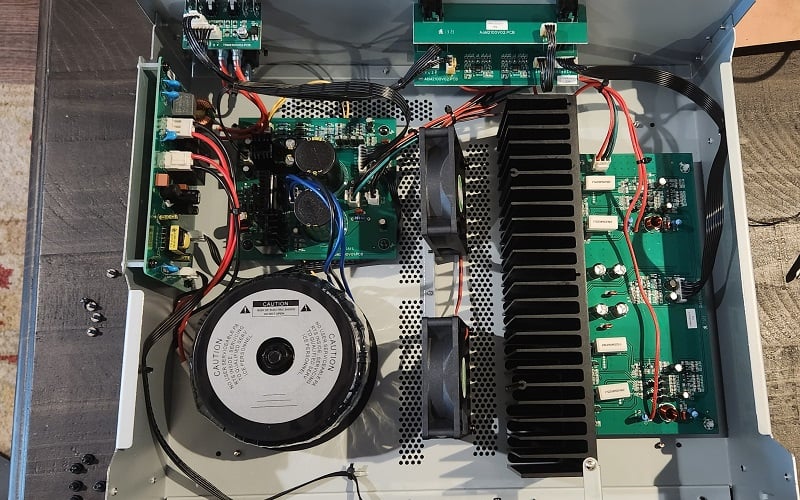

M2100X top off
Monolith M2100x Inside View
Monoprice's newest lineup of multi-channel home theater power amplifiers include the M2100X, M3100X, and M5100X. The three amplifiers are a Class AB design with a large centralized torodial transformer and filter capacitors varying in size and amount based on the channel configurations. Two low noise fans fire directly at the single heatsink housing the amplifier power transistors which only engage on power up or under extreme load. All the amplifiers in the lineup feature class AB amplification that are stable into 4 ohm loads and would be a way to relieve the power supply in your AV receiver which could handle your font LCRs while the Monoliths power the height and other effects channels in a larger system. The amplifiers feature both unbalanced RCA inputs or unbalanced XLR inputs which should make it easy to connect to any receiver or pre/pro. Monoprice rates the amplifier's power at 90 watts per channel into 8-ohms and 135 watts into 4-ohms (all channels driven) with less than 0.02% THD and a signal to noise ratio greater than ‑100dB (full power).

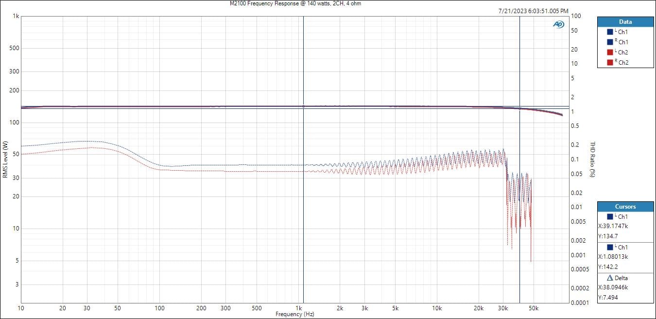

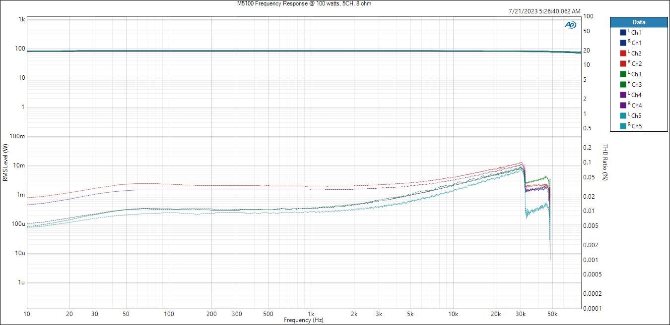

Frequency Response

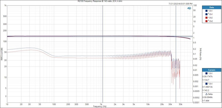

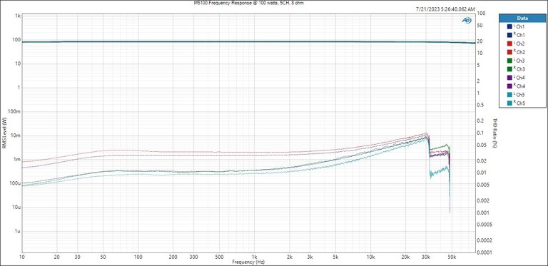

The Mx100X series is a wideband design with ruler flat frequency response from 10Hz to 80kHz( -0.8dB) when tested into 8-ohm and 4-ohm loads. Full power bandwidth and frequency response uniformity was tested with All Channels Driven (ACD) into 8-ohm and with 2CH driven into 4-ohm loads with measurement results in the power tables.
M2100-Freq-4ohm
Monolith M2100X Frequency Response @ Full Power (4 ohm, 2CH driven)
M5100 5CH Freq
Monolith M5100X Frequency Response @ Full Power (8-ohm, 5CH driven)

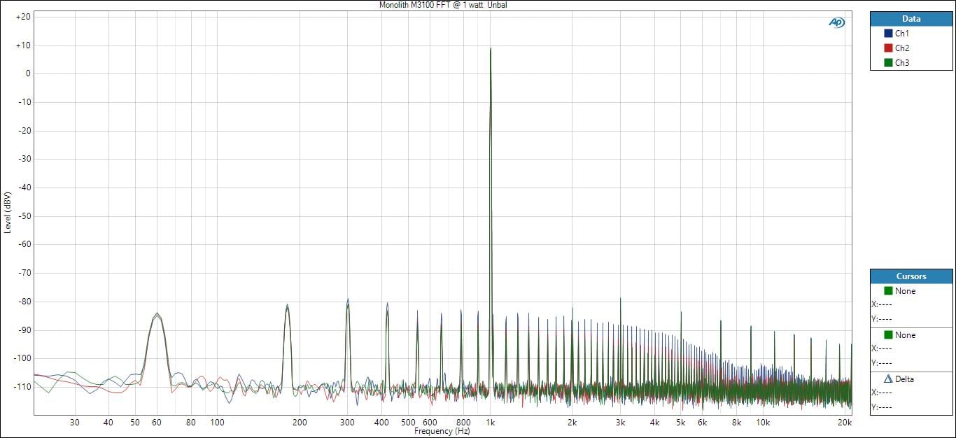

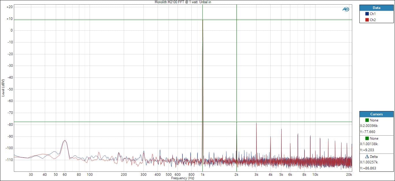

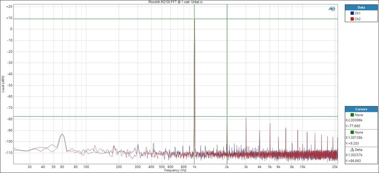

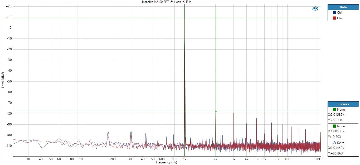

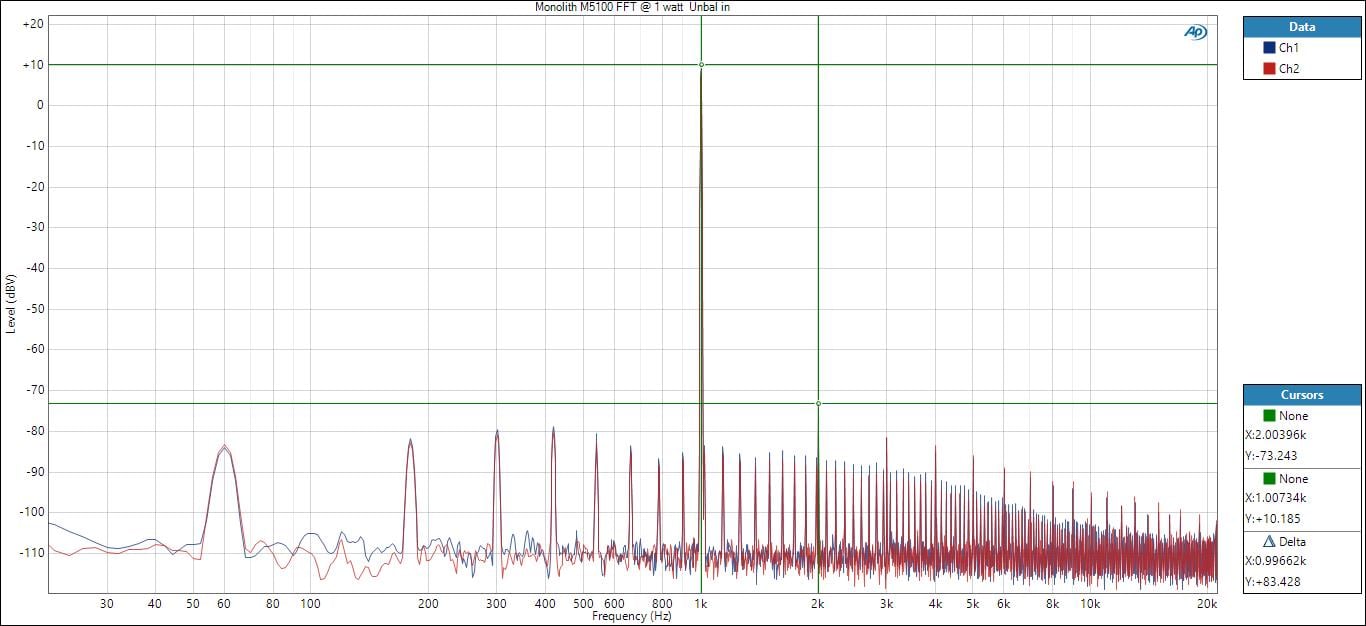

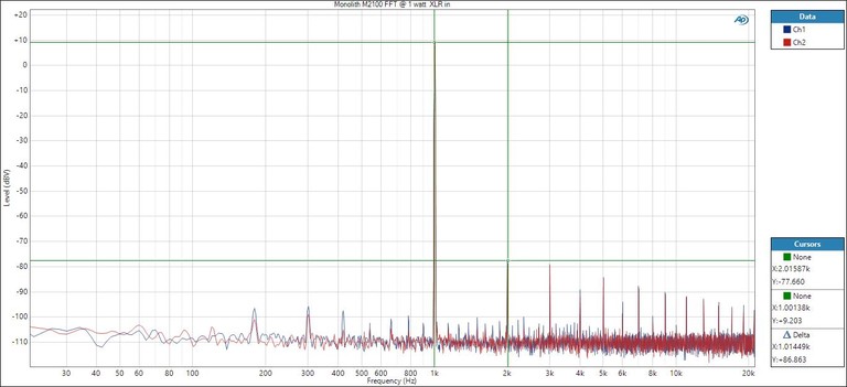

FFT Distortion Analysis

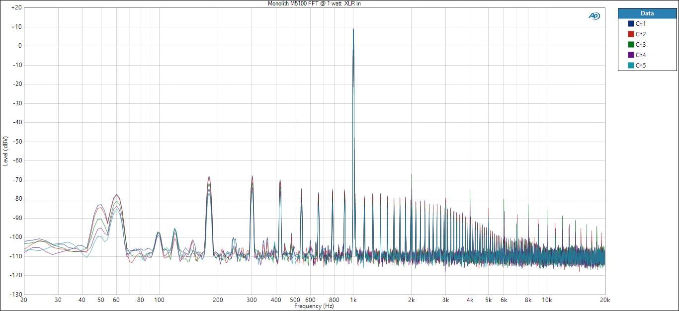

ALL Monolith Mx100X amplifiers exhibited some excessive HF harmonic distortion in varying degrees depending on model#. The M2100X power supply hum was minor as can be seen in the graph below. 2nd order harmonic distortion was at -86dB below the fundamental when driven at 1 watt, 8 ohms. This is good performance for an amplifier of this price class. The unbal inputs exhibited minor (inaudible) 60Hz power supply hum while this was not seen using the XLR inputs.
M2100 FFT 1watt Unbal
M2100-FFT-1watt-XLR
Monolith M2100X 1 kHz FFT @ 2.83Vrms (1 watt, 8 ohms)
Top graph - Unbal, Bottom graph - XLR
Some power supply hum was seen on the M3100X via the unbal and XLR inputs but the levels are low enough to likely NOT be audible in most systems. The FFT harmonic spectra isn't quite as clean as the M2100X model.
M3100-FFT-1watt-unbal
Monolith M3100X 1 kHz FFT @ 2.83Vrms (1 watt, 8 ohms)
M5100-FFT-1watt-Unbal
Monolith M5100X 1 kHz FFT @ 2.83Vrms (1 watt, 8 ohms) – Unbalanced
M5100-FFT-1watt-XLR
Monolith M5100X 1 kHz FFT @ 2.83Vrms (1 watt, 8 ohms)  - Balanced
The M5100X performed similarly to the M3100X with respect to power supply hum and residual harmonic distortion. However, the hum and distortion got slightly worse using the XLR inputs.

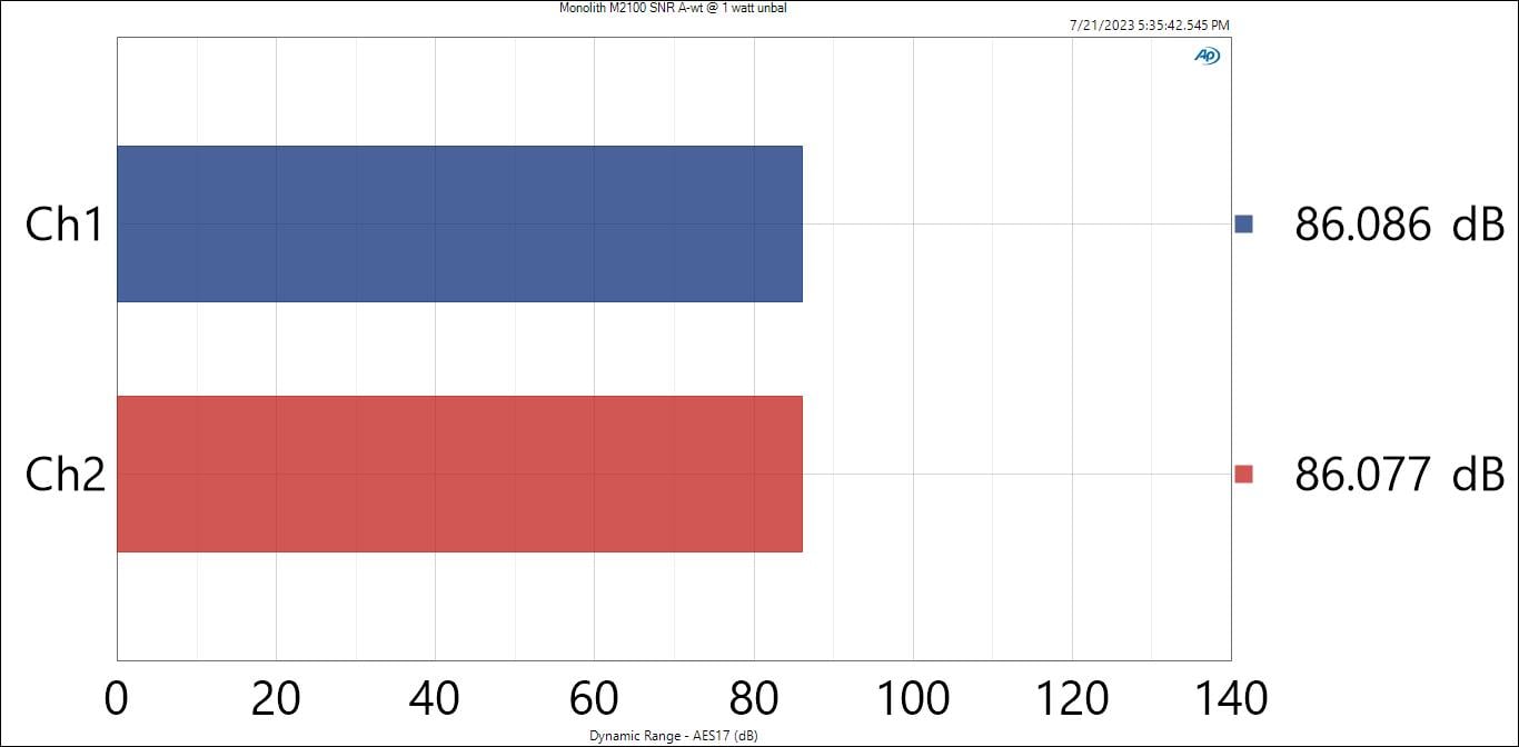

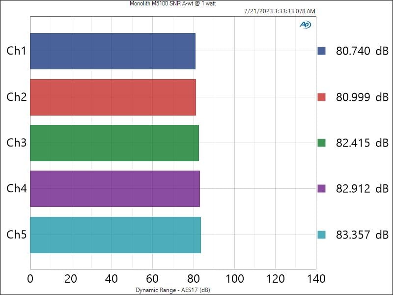

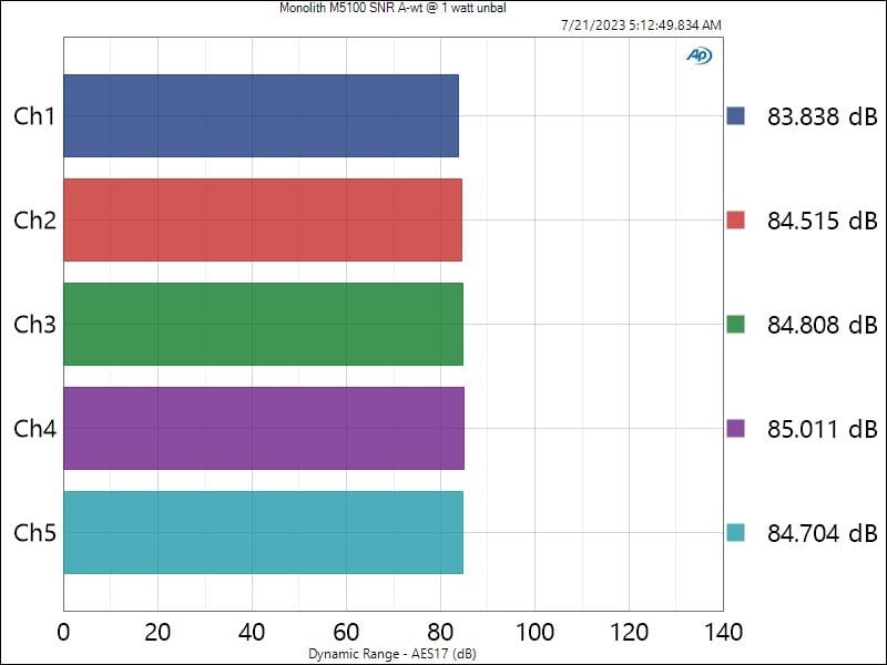

Signal to Noise Ratio (SNR)
M2100-SNR-1watt
Monolith M2100x SNR @ 1 Watt (a-wt)

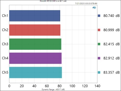

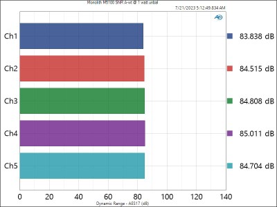

SNR was measured for each of the Mx100X amplifiers with 110mVrms input and 2.83Vrms output (1 watt, 8-ohm) and was found to be acceptable between 80-86dB (a-wt). SNR was consistently 2-3 dB better on the unbalanced vs balanced input connections between models which is how we would recommend using them in most installations.
M5100-SNR-1watt  M5100-SNR-1watt-unbal
Monolith M5100X SNR @ 1 watt (a-wt)
Bal (left), UnBal (right) images
This translates to 100-106 dB SNR at rated power depending on which model and connection type you are using. Monoprice rates these amplifiers at 100dB SNR (A-wt) at full power which matches what I saw on the test bench.

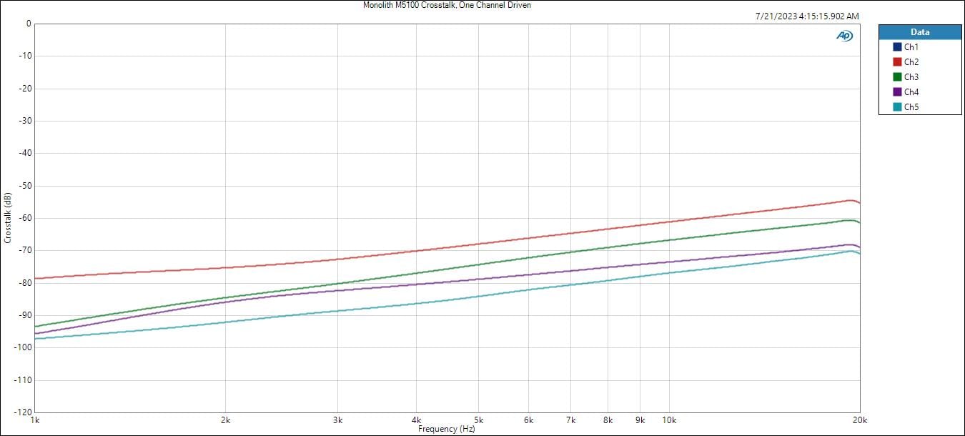

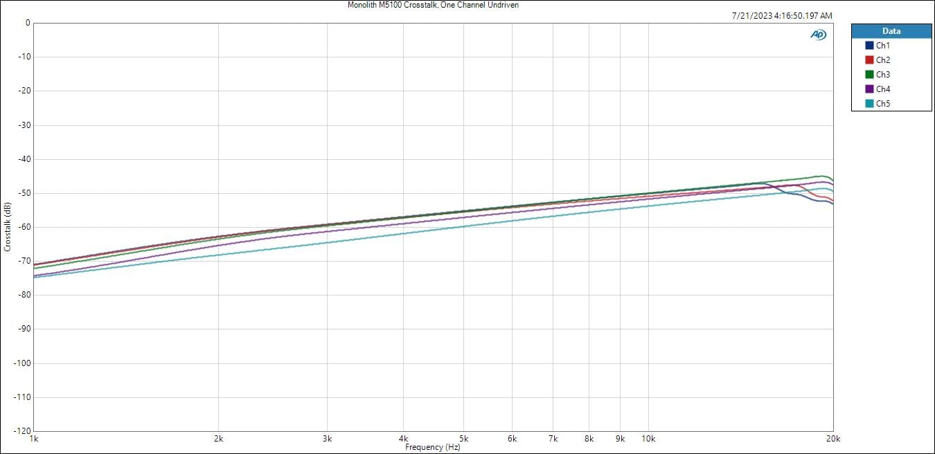

Channel to Channel Crosstalk
Monolith M5100X (1CH Driven) CH-CH Crosstalk @ Half Power
M5100-Xtalk-ACD
Monolith M5100X (1CH, Undriven) CH-CH Crosstalk @ Half Power
Channel to channel crosstalk was acceptable at -60dB @ 20kHz for all of the Mx100 models for the one-channel driven tests. CH-CH crosstalk performance degraded about 10dB with all channels driven except the undriven channel of the M3100X, and the 5100X. These are acceptable results.

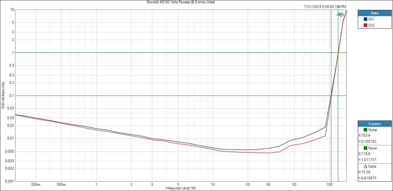

M2100-Psweep-8ohm
Monolith M2100X 1kHz PSweep (2CH, 8-ohms)

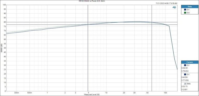

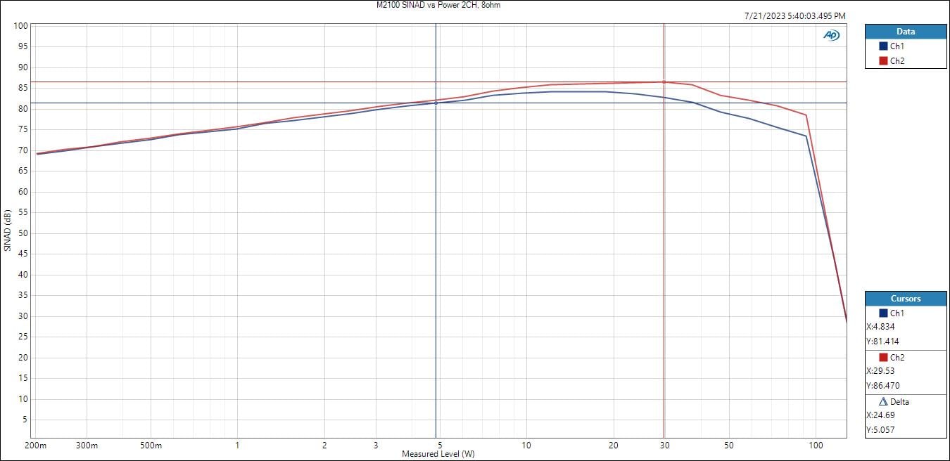

When driving 8-ohms, the M2100X delivered 103 watts/ch x 2 at 0.1% THD+N and 118 watts/ch x 2 at 1% THD+N. The knee of the amplifier is about 90 watts. SINAD on the right channel peaked at 86dB while the right channel was 5dB less at 81dB. This is good performance and shows Monoprice rated power before the knee which is NOT typical for amplifier manufacturers selling budget amps like these.

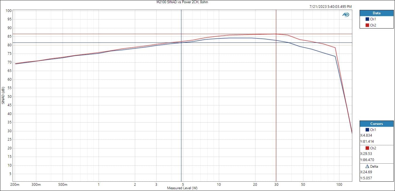

M2100-SINAD
Monolith M2100X SINAD (2CH, 8-ohms)

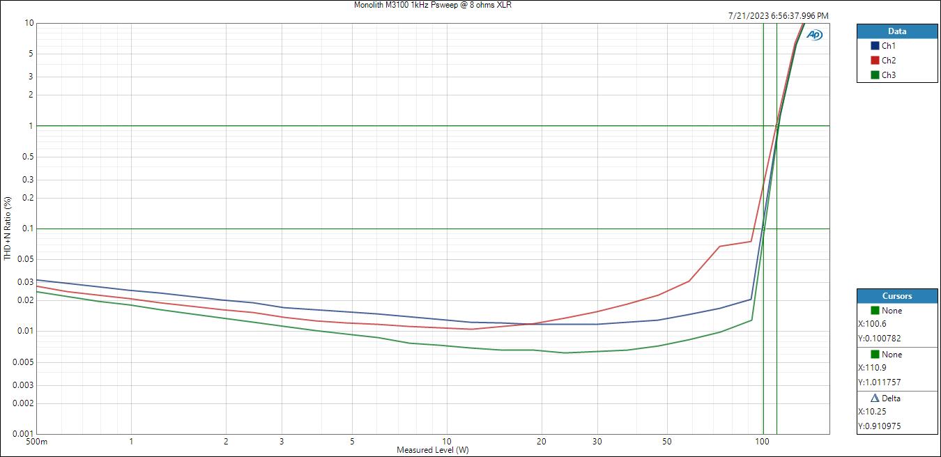

M3100-Pweep-8ohm
Monolith M3100X 1kHz PSweep (3CH, 8-ohms)
When driving 8-ohms, the M3100X delivered 100 watts/ch x 3 at 0.1% THD+N and 110 watts/ch x 3 at 1% THD+N. The knee of the amplifier is about 90 watts for Left/Right channels. The center channel appears to have significantly higher distortion when driven > 50 watts.

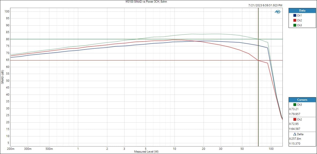

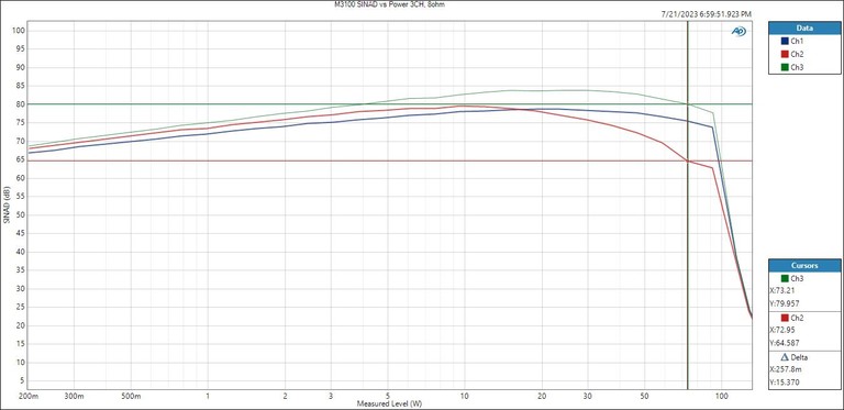

M3100-SINAD
Monolith M3100X SINAD (3CH, 8-ohms)
SINAD on the right channel of the M3100X peaked at 84dB at 50 watts while the right channel was 5dB less at 81dB. The center channel exhibited 15dB worse SINAD than the right channel at 75 watts. This is mostly academic as the center channel amp is still below 0.05% THD+N at 90 watts.

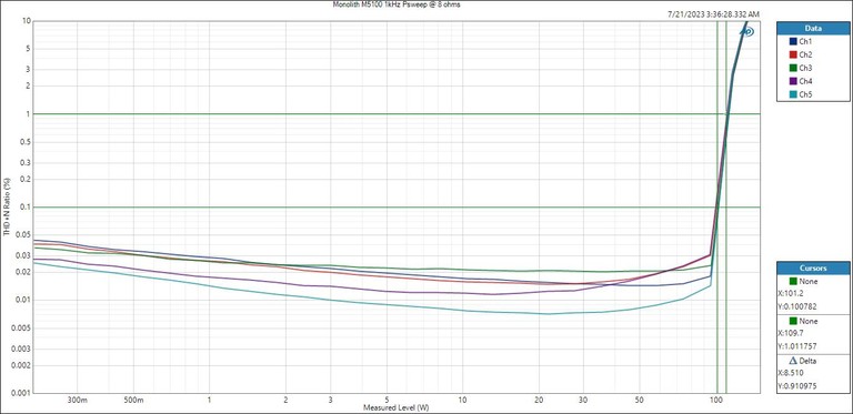

M5100-Psweep-5CH-8ohm
Monolith M5100X 1kHz PSweep (5CH, 8-ohms)

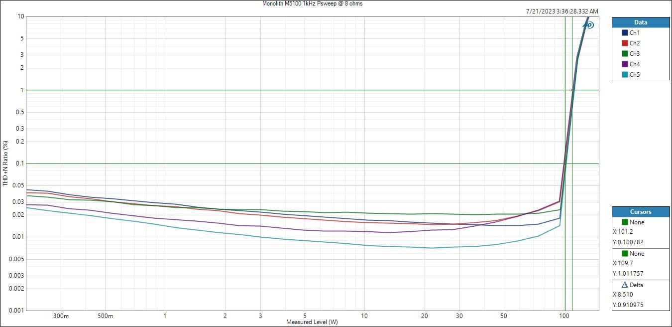

When driving 8-ohms, the M5100X delivered 101 watts/ch x 5 at 0.1% THD+N and 109 watts/ch x 5 at 1% THD+N. The knee of the amplifier is about 90 watts for all channels. SINAD on CH5 peaked at 82dB while the CH3 was about 10dB less.

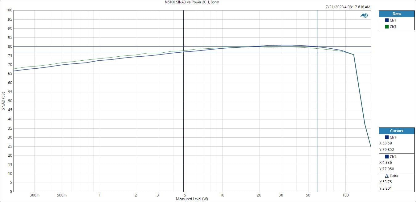

M5100-SINAD-2CH-8ohm
Monolith M5100X SINAD (2CH, 8-ohms)

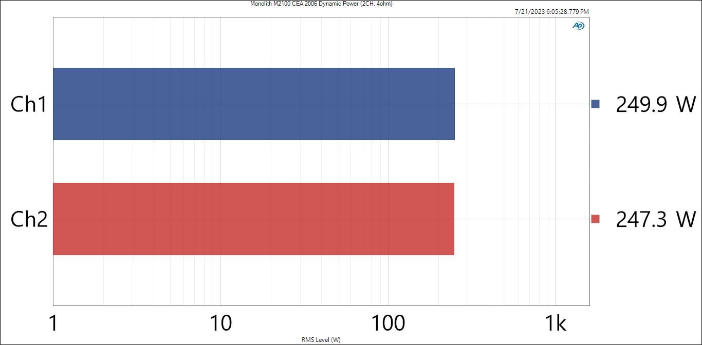

M2100-Pburst-2CH-4ohm
Monolith M2100X CEA 2006 Dynamic Power – (2CH, 4-ohms)

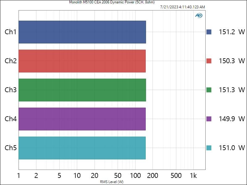

The CEA-2006 burst tests simulate musical program material to illustrate dynamic capabilities of the amplifier.  The Monolith M2100X produced 153 watts/ch into 8-ohms and 249 watts/ch into 4-ohms with both channels driven at 1% THD+N.
M5100-Pburst-5CH-8ohm
Monolith M5100X CEA 2006 Dynamic Power – (5CH, 8-ohms)
The M3100X, and 5100X exhibited similar 150 watts/ch ACD dynamic power into 8-ohms at 1% THD+N, while the M7100 produced slightly less at 140 watt/ch. Into 4-ohms, the M3100X, and 5100X produces 250 watts/ch with 2CH driven at 1% THD+N.

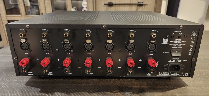

M2100Xrear
The Monolith Mx100X series of amplifiers appear to be very high-value designs with generous power supply capabilities for each model. The XLR connections are superficial to meet a feature check box but in most cases, we’d recommend using the unbalanced connections with a quality double-braided double-foil shielded interconnect like the Belden 1694A from Bluejeanscable.com.
