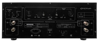

Everything on the back panel was clearly labeled, especially with respect on how to bridge the amplifier. The bridged input and + and – speaker terminals were clearly labeled, a lesson Denon could learn in their POA-A1HDCI 10CH amplifier. There is a 5-12V trigger and toggle switches to turn on/off the LED indicators and power meters as well as switching between bridged and balanced XLR and unbalanced RCA input connections.
XPA-2 back panel view

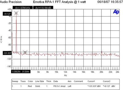

FFT Distortion Analysis
Figure 3. XPA-2 FFT Distortion Analysis at 1 watt (XPA-2 top, RPA-1 bottom)
I ran FFT distortion plots at various power levels to determine how clean this amplifier really is. At 1 watt, the spectral distortion was good with the second order harmonic being (9.007 + 67.533)dB being 76.54dB down from the fundamental or 100*alog^-1(-76.54/20) = .015%. While this is a respectable measurement, it is no way near as pristine as what I’ve seen on their RPA-1 demonstrating a measurable trade off between higher sustained power of the XPA-2 versus measurably cleaner low power of the RPA-1. If you tend to favor low listening levels, you may opt for an RPA-1/ RPA-2 over the XPA-2.

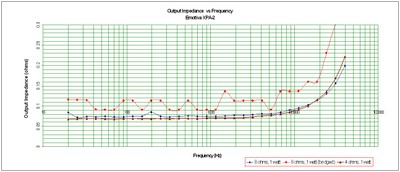

Output Impedance and Damping Factor
Figure 6. XPA-2 Amplifier Output Impedance vs Frequency
Amplifier output impedance when the XPA-2 was driving 8-ohm and 4-hom loads at 1 watt was within our preferred 100 mohm range for the entire audio bandwidth. We like to see amplifier maintain 150 mohm output impedance or less so that it will sound consistently good for a larger variety of speaker and cable loads with rather complex impedance profiles. This is a very good measurement and yet more confirmation that the XPA-2 amplifier design was well executed.

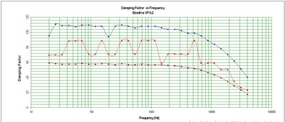

Figure 7. XPA-2 Amplifier Damping Factor vs Frequency
Again the XPA-2 did NOT disappoint. An amplifier with a low output impedance will also maintain excellent damping characteristics since these are related metrics. The XPA-2 maintained a damping factor above 100 for 8 ohm loads and ½ that as expected for 4-ohm loads. This fell right within our benchmark criteria.
