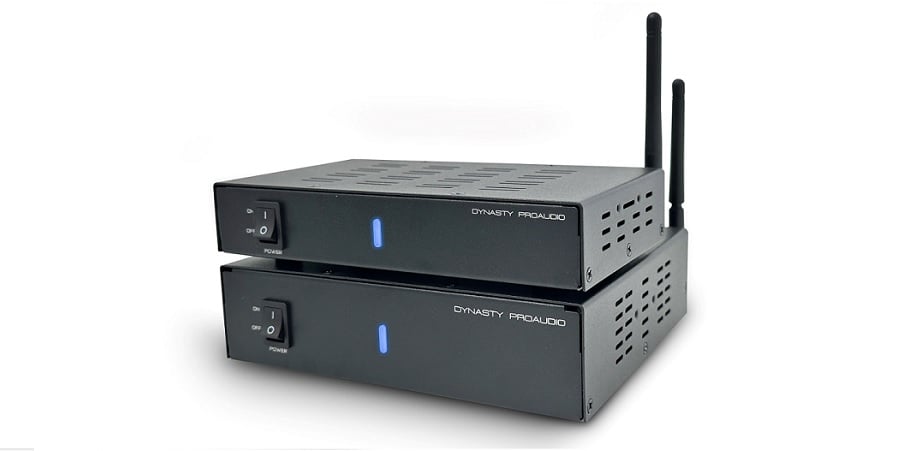

The Dynasty ProAudio WSA-5RP-Plus wireless audio amplifier may fit in the palm of your hand, but make no mistake, this Mighty Mouse amp packs quite a punch. The two-piece kit comes with a wireless preamp 5.2 / 5.8GHz switchable lossless transmitter with an operational distance of up to 100ft (30m) to provide 24 bit/48kHz full CD quality high resolution audio to the 2CH Class D amplifier. The amplifier is rated at 50 watts/ch into 8 ohms and 100 watts/ch into 4 ohms and is rated at 200 watts in bridged mode (8 ohms) but we found it much more capable than that as you will see in this test report.

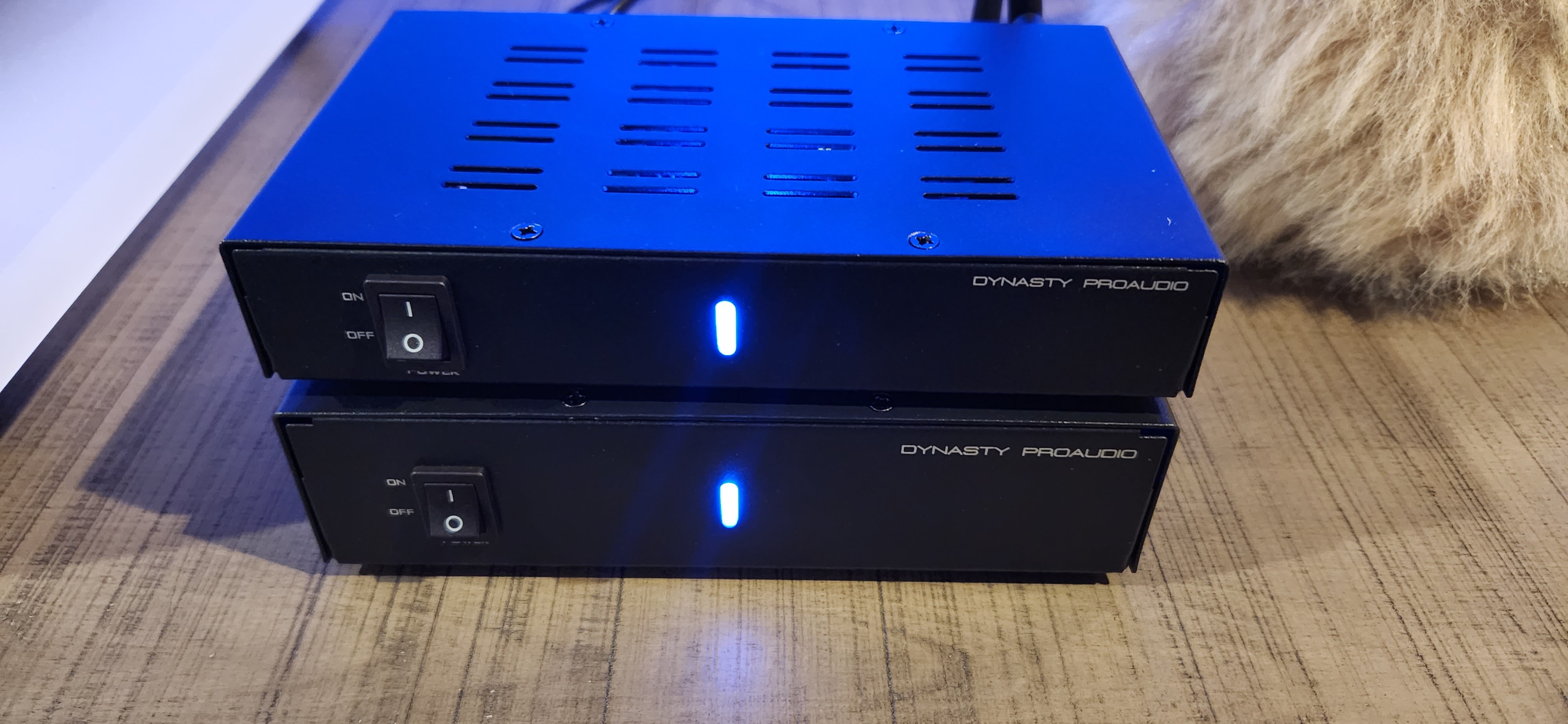

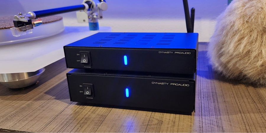

Dynasty ProAudio WSA-5RP-Plus Front View
The Dynasty ProAudio preamp has both speaker level and RCA level inputs as well as a subwoofer input and a 3 position attenuation switch (0, -6dB and -12dB). It’s powered via a 9V external power supply.

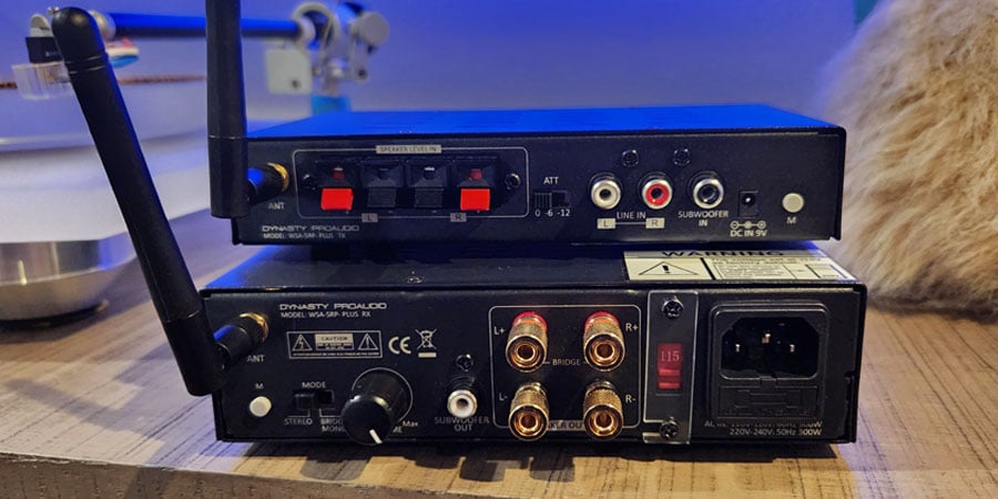

Dynasty ProAudio WSA-5RP-Plus Rear View
The Dynasty ProAudio amplifier has some heft to it for such a small unassuming box. It has two pairs of gold plated banana style speaker connectors, an RCA sub out, a selector switch for stereo and bridge mode and a rear mounted volume control. The amp comes with a detachable 3-prong power cord.

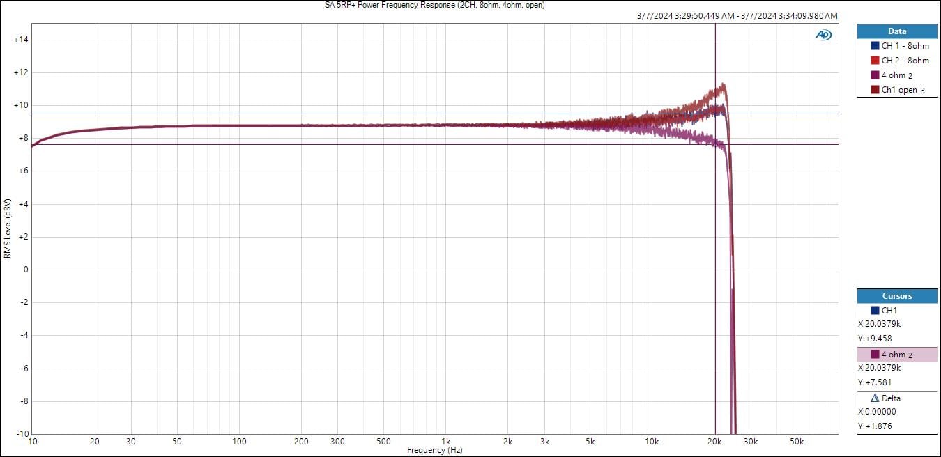

Frequency Response & FFT Distortion Tests
 SA 5RP+ Freq-loads

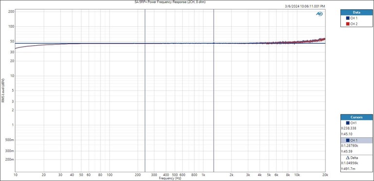

Dynasty ProAudio Amplifier Frequency Response
The Dynasty ProAudio amplifier exhibited very good frequency response linearity under various loading conditions (open, 8 ohm, 4 ohm). I wouldn’t call it completely load invariant as we’ve seen with other SOTA Class D amplifiers but to keep things into perspective, this is a much better result than what we’ve seen from some older and expensive Class D esoteric amplifier designs like the Axiom Audio A-1400. The Dynasty ProAmp is clearly optimized for a 4 ohm load, but you will get a slight treble boost of about +2dB @ 20kHz if you’re running 8-ohm nominal loudspeakers. The sampling rate is 48kHz as advertised as you can see the sharp roll-off at ½ Nyquist (24kHz).  The bottom line here, is the Dynasty ProAudio amplifier should sound consistently good regardless of loudspeaker impedance.

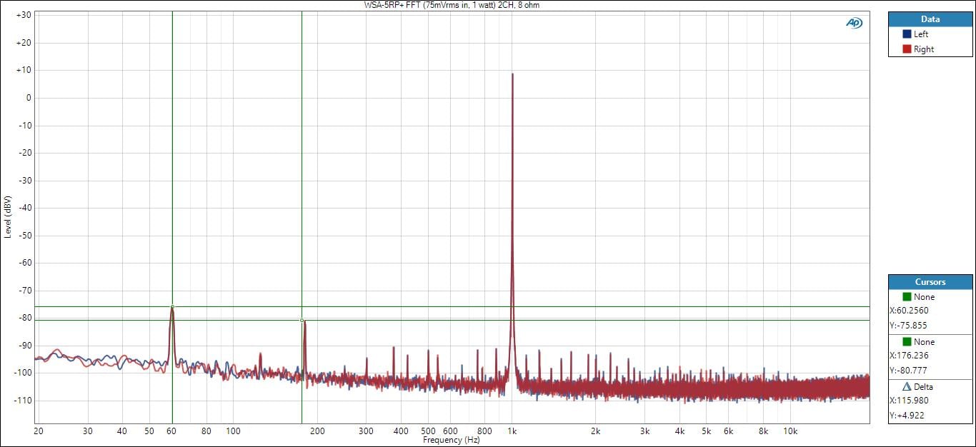

WSA-FFT-1watt
Dynasty ProAudio 1 kHz FFT @ 2.83Vrms (1 watt, 8 ohms)
The Dynasty ProAudio amplifier exhibited shockingly clean harmonic spectra when tested at 1 watt output. We see some slight power supply harmonics (-80dB) but nothing to worry about.

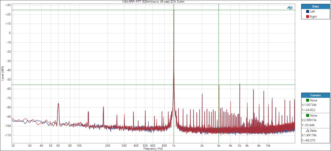

Dynasty ProAudio 1 kHz FFT @ 2.83Vrms (45 watt, 8 ohms)
At near rated power, the harmonics rise dramatically but are still roughly 80dB below the fundamental. I’ve seen expensive “audiophile” amps with a much worse distortion FFT profile such as the Pass Labs X350.5.

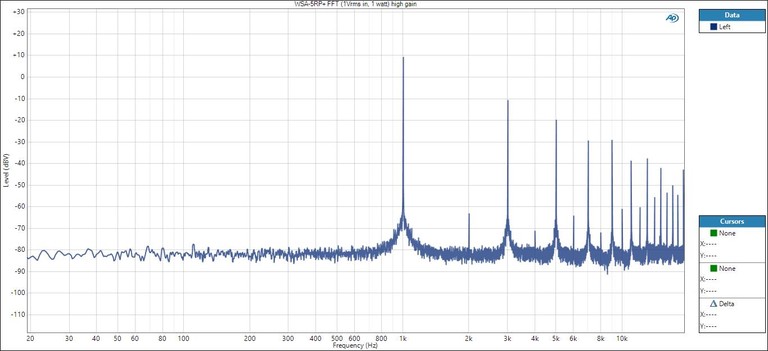

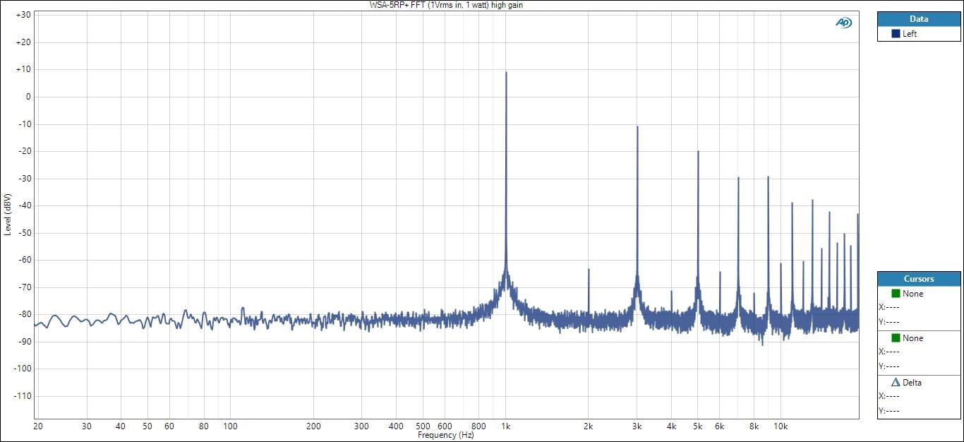

When connecting up a source to the Dynasty ProAudio WSA-5RP+ RX wireless preamp, it’s important to adjust the gain setting appropriately to avoid distortion. The unit is set to 0dB default position which I found would clip with an input signal > 750mVrms. The -6dB setting allows for clean 1.5Vrms and the -12dB can accommodate up to 3Vrms without clipping the preamp.
 WSA-5RP+ FFT (1watt) high gain
Dynasty ProAudio 1 kHz FFT @ 2.83Vrms (1Vrms in, 1 watt out) high-gain setting
Editorial Note: Don’t use the 0dB default setting if you’re directly connecting a CD player as the source. -6dB or -12dB will ensure your input signals will not overload the preamp of the system to give you the cleanest sound possible.

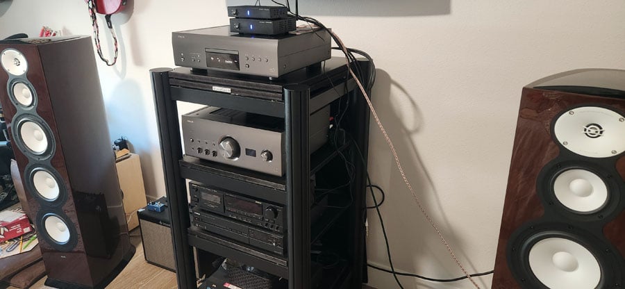

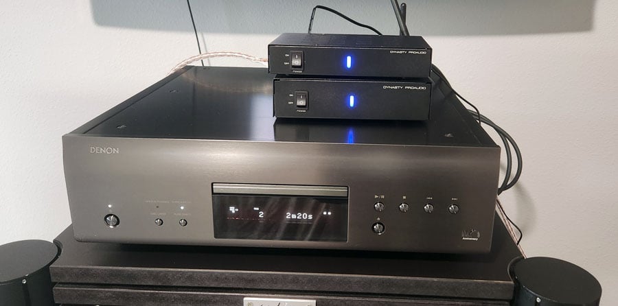

system-pic2
Dynasty ProAudio w Denon DCD-A110 SACD Player
When I connected up my Denon DCD-A110 SACD player directly to the Dynasty ProAudio preamp, the music sounded slightly distorted. That’s because the output of a CD player can be as high as 2Vrms which was causing the preamp to clip in the -6dB default setting. I found -6dB eliminated this distortion problem while still maintaining low noise in the system. This is the setting I’d recommend for most applications. If you want to play it safe, you can set it for -12dB as long as you can still get enough gain from the master volume to enjoy music at satisfactory volume levels.

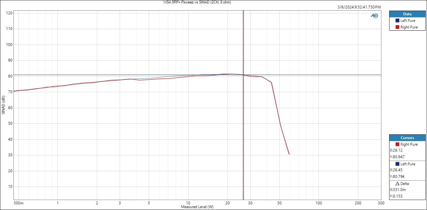

I was not expecting a low distortion amplifier, especially when the test signal was being transmitted wirelessly to it, but instead, I was pleasantly surprised. The amps lowest distortion (highest SINAD) was about 80dB (0.01% THD+N) at 25 watts.

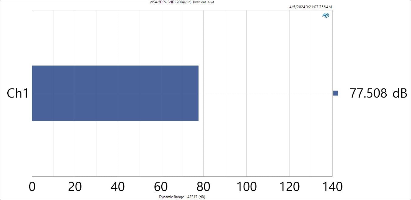

WSA-5RP+ SNR (1watt)
Dynasty ProAudio SNR @ 1 watt (a-wt)
Given this amp is being fed a wireless audio signal, it is likely limiting the full low distortion potential of the design. The manufacturer rates SNR > 90dB presumably at full power (50 watts) which would translate to > 70dB SNR @ 1 watt. I actually measured 77dB SNR @ 1 watt (a-wt) which is pretty respectable considering this is through a wireless signal path.
While this is a reasonably low noise floor, the end user could potentially hear hiss at low power levels when using high sensitivity speakers (> 90dB @ 2.83V/1m) in close proximity to the listener. I tested the amp on my Revel F328be speakers and could hear some hiss but only when my ear was within a foot or two of the tweeter. At the main listening position 8ft away it was a non issue.

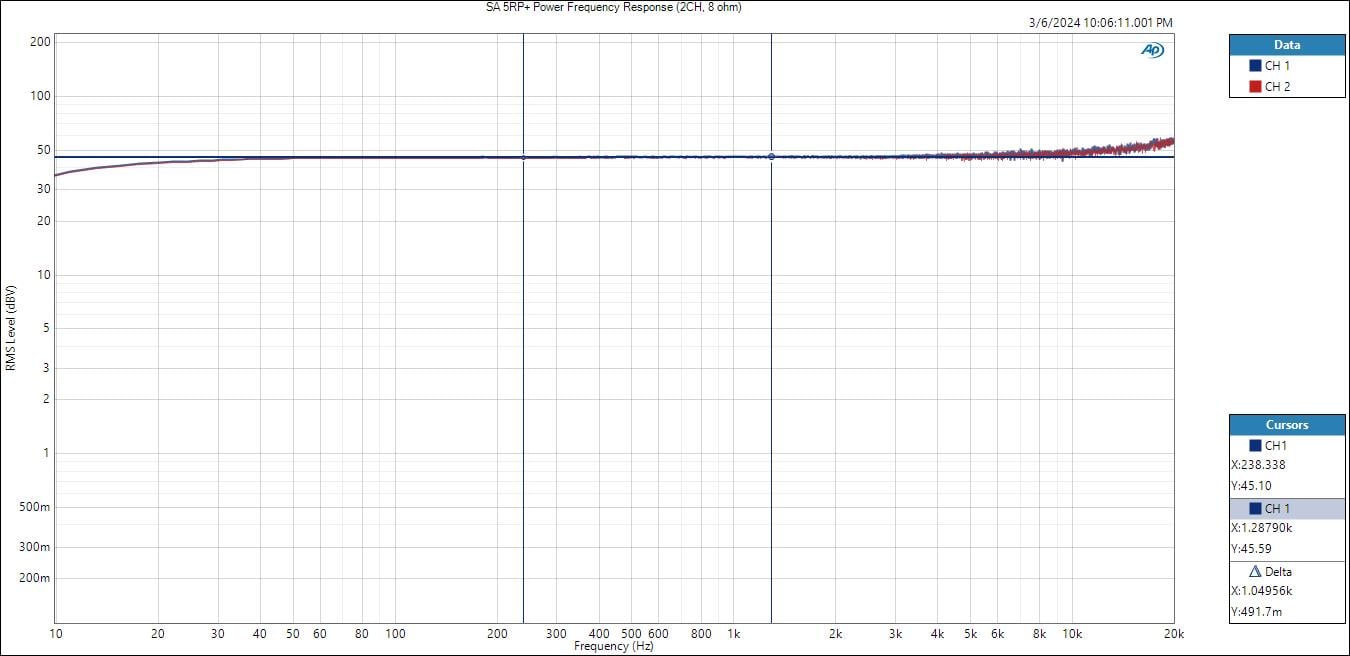

WSA-PowerBW-8ohm
Dynasty ProAudio Power Bandwidth (2CH, 8 ohms)
The Dynasty ProAudio amplifier was able to deliver 45 watts/ch with 2CH driven at < 0.1% THD+N. That’s a little shy of it’s 50 watt rating but they don’t specify bandwidth or distortion levels.

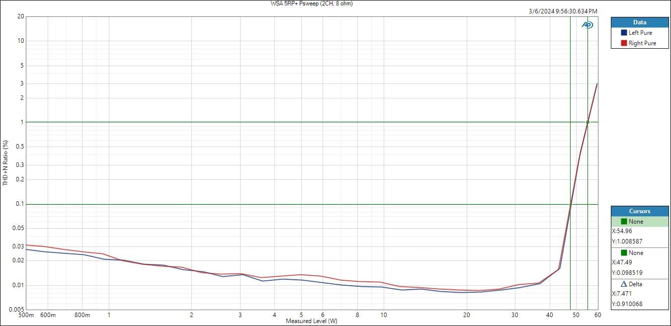

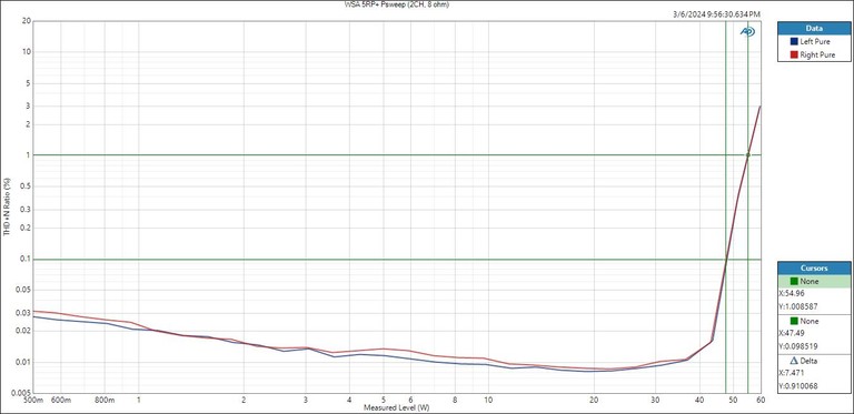

The Dynasty  ProAudio amp delivered 47 watts/ch at 0.1% THD+N and 55 wattc/ch at 1% THD+N with both channels driven into 8-ohms.

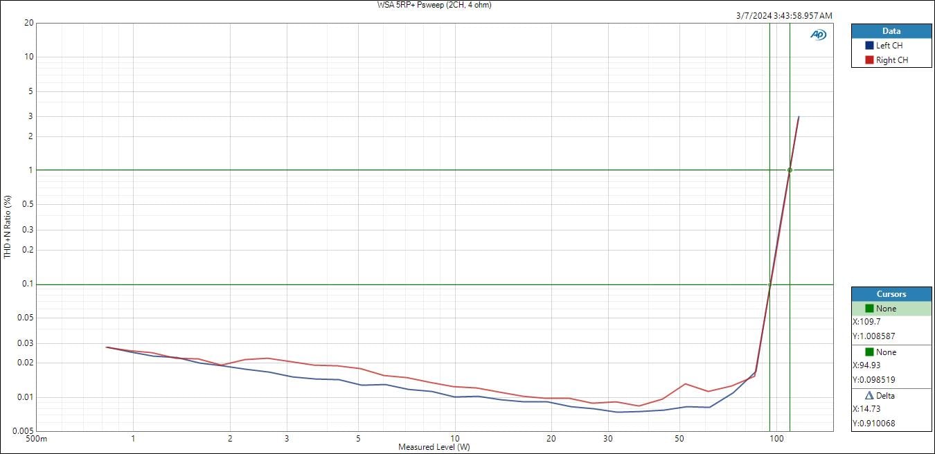

WSA-Psweep-4ohms

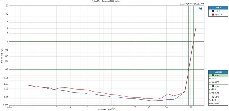

Dynasty ProAudio  1kHz PSweep (2CH) - 4 ohms
The Dynasty  ProAudio amp delivered 95 watts/ch at 0.1% THD+N and 109 watt/ch at 1% THD+N with both channels driven into 4-ohms. That’s impressive for a pint sized amplifier and should be plenty of clean drive to power a pair of surround speakers or to use for streaming to a pair of passive speakers in a 2CH system.

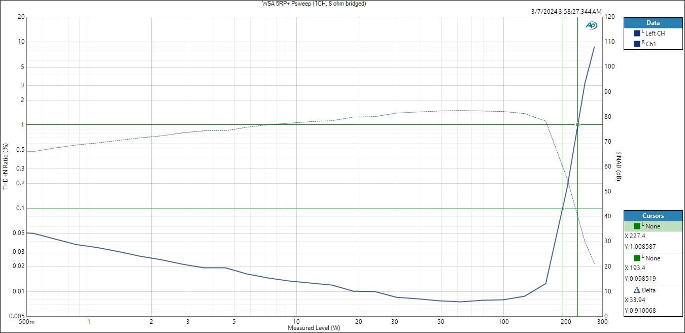

WSA-Psweep-bridged-4ohm

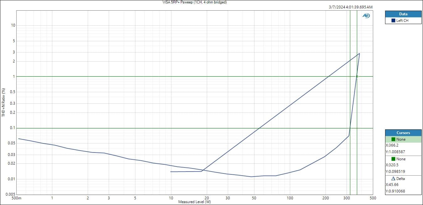

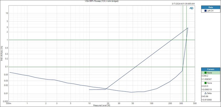

Dynasty ProAudio  1kHz PSweep (Bridged) - 4 ohms
The manufacturer does NOT recommend bridging this amp for 4-ohm loads but I was curious to test it anyways. The Dynasty ProAudio amp was able to deliver a whopping 320 watts @ 0.1% THD+N and 366 watts @ 1% THD+N into a 4-ohm load before it began to current limit. That’s a lot of power for an amp you can hold in the palm of your hand while being cool to the touch.

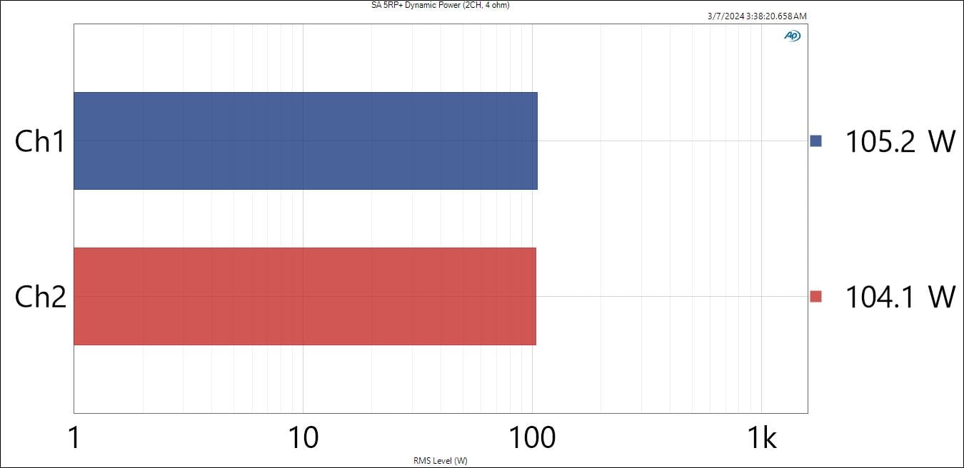

WSA-DynamicPWR-40hm
Dynasty ProAudio AmpCEA 2006 Dynamic Power – 4 ohms
The Dynasty ProAudio amp delivered 54 watts/ch into an 8-ohm load and 104 watts/ch into a 4-ohm load of dynamic power at 1% THD+N which was similar to its power sweep results indicating the power supply doesn’t have much headroom which is typical with SMPS regulated power supplies found in many Class D amplifiers.

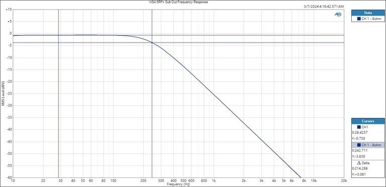

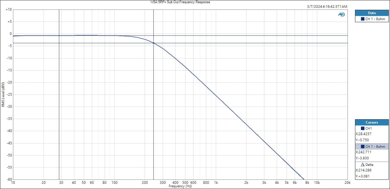

Another surpising feature of this Dynasty Audio wireless amp system is the inclusion of an RCA level subwoofer input on the preamp and  corresponding output on the power amp. If you feed a discrete input to sub input on preamp, the sub out is +6dB on power amp. If you feed a single input on Left or Right of the preamp, you get same output level on sub out of the amp. If you feed 2 inputs left/right on the preamp input, you get +6dB on sub amp. There really is no need for the sub input on the preamp unless you just want to use this system to power a subwoofer remotely. Keep in mind that this system has a latency of about 17ms so you will have to adjust your sub delay accordingly in your AVR. The sub out is bandwidth limited (-3dB at 240Hz) so you will still need to activate external bass management either in your AVR or in the subwoofer itself if you desire a lower crossover frequency (ie. 80Hz).
