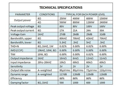

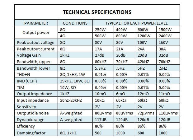

D-Sonic may not be a company a lot of Audioholics’ readers are familiar with: debuting in 2006, they’re focused on building high quality, albeit affordable Class D amplification based on B&O’s ICE modules (utilized in their M2 series) as well as more advanced designs (utilized in their M3 line). As noted in our recent article about amplifier classes, Class D amplification, while not necessarily easy to get right, boasts a major advantage over the rest of the field: efficiency. As such, when we read that D-Sonic was offering amplifiers delivering up to 2.4kW into a 4 ohm load, as well as claiming stability into <2 ohm loads, let’s just say our interest was piqued.

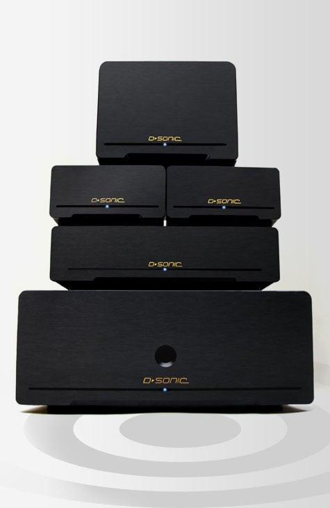

So what do these guys offer exactly? The core of D-Sonic’s offerings boils down to four separate amplifier modules, neatly spelled out below:
From there, you can get a single channel of amplification all the way up to seven channels, using any combination of amplifier modules you wish. Of course, D-Sonic does offer several “standards”. The M3 series includes two mono amplifiers using 600W and 1,500W modules; three stereo amplifiers using 400W, 600W, and 1,500W modules; as well as two five channel and three seven channel amplifiers using a mix of 400W, 800W, and 1,500W modules. The M2 series offers 250W and 500W channels of ICEpower technology. In terms of cost, the entry level monoblock will set you back $975 plus shipping, while the top level seven channel amplifier runs $3,975. Considering the amount of power on tap here, that’s not too shabby in our books.

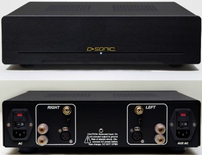

Front and rear view of D-Sonic's stereo amplifier chassis.
