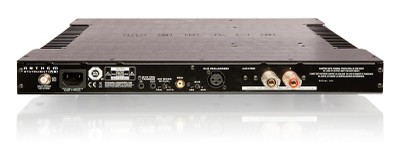

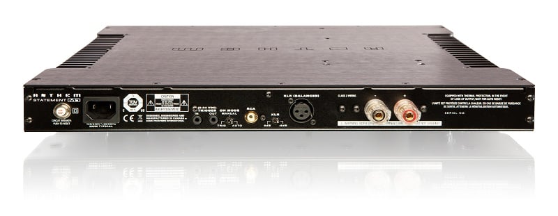

The traditional high quality five-way binding posts for speaker connection is available on the back of the Statement M1 as are RCA and XLR inputs. The Statement M1 can be activated by the incoming signal (auto-sensing) or by 12volt triggers. There is a circuit-breaker reset on the back as well as a port for the power cord. Interestingly, the Statement M1 uses a two-prong power cord. While that may seem odd to some users, it is something we prefer. While more difficult to design for, the two-prong power cord means you won't have to worry about ground-loops.

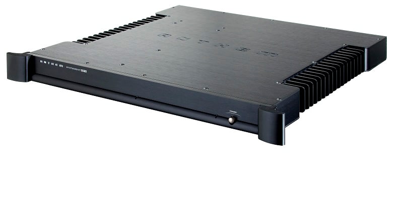

Of course, the thinness of the Statement M1 will immediately strike the consumer. With deep heat sink fins on the sides, the Statement M1 manages to be only a single rack space thick and can be stacked. This makes it very easy for installers to put together a system for a potential customer. Given it's size (2 1/4 inches high with feet, 19 1/4 inches wide, and 18 3/4 inches deep), the M1 weighs a hefty 20 pounds.
