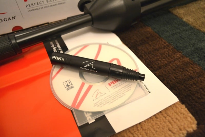

| Included in box |
| Software CD |
| Microphone |
| Microphone clip |
| Telescoping stand (19” – 47” High) |
| Two USB 12.5’ cables. |

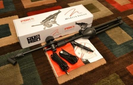

The basic idea behind MartinLogan’s Perfect Bass Kit is to give consumers an accurate, inexpensive, and easy way to automatically EQ their subwoofer(s). For $100, you get a microphone, tri-pod, 2x12’ USB cables, and a software installation CD. If this kit sounds familiar to you, that’s because it’s virtually identical to the Perfect Bass Kit created by MartinLogan’s sister company, Paradigm. Paradigm, MartinLogan, and Anthem are all owned by ShoreView Industries. Even though the Paradigm and MartinLogan kits perform the same (so, this could also be considered a review of the Paradigm PBK), they only work with the same brand of subwoofer. In other words, the MartinLogan PBK won’t work with any Paradigm subwoofer.

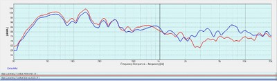

Results from a very low quality auto setup mic. Blue = before. Red = after.

The quality of microphone that comes with auto calibration systems is also cause for concern. A variance of +/- 3dB or more is to be expected. The mics are usually batch calibrated in order to save money, as opposed to individually calibrated to ensure accuracy. Many of them also lack a threaded insert for use with a tripod, making it very difficult to properly position the microphone when taking measurements. With PBK, each microphone comes with an individual calibration file, though we are unsure of the specific tolerance allowed. The mic does not have a threaded insert for use with a tripod, but it doesn’t need one because PBK comes with its own telescoping mic stand. The stand shrinks down to about 22” when collapsed and 47” when fully extended with boom pointing up.

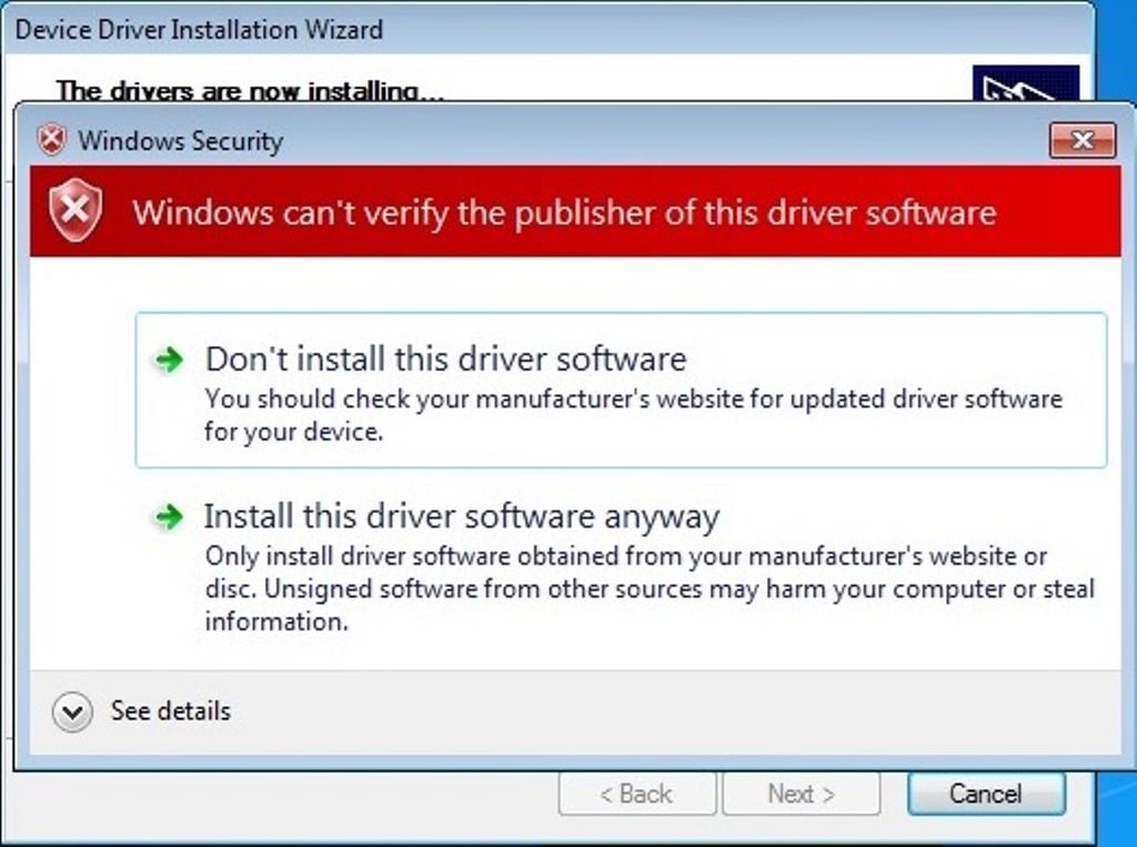

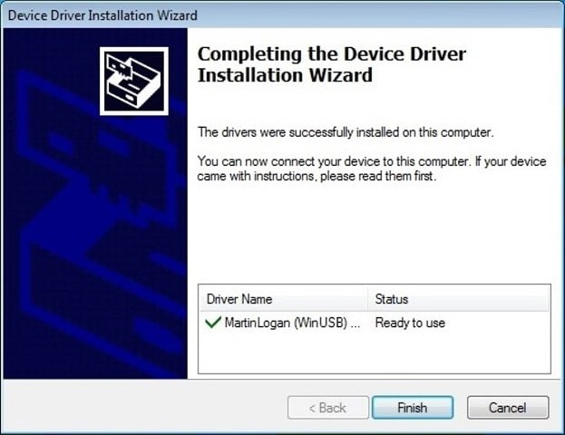

Installing the software should be simple for most people. Insert the included CD and wait for the installation wizard to pop up. Once it appears, click “next” a few times and wait for the software and drivers for the subwoofer and microphone to install. While installing the drivers, a “Windows Security” warning may pop up. Select “Install this driver software anyway” to finish up the setup.
Setup Wizard Windows Security Warning
Once the software and drivers are installed from the CD, you need to go to www.martinlogan.com/PBK and check if a newer version of the software is available. If you aren’t running the newest version (the manual included with PBK tells you how to check the current software version), you will need to download and install the most recent version. Why the software doesn’t automatically check to see if you are running the most recent version before installation is beyond me.

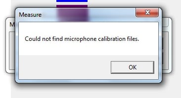

Because the laptop I installed PBK on doesn’t have a CD drive, I skipped using the CD altogether and went straight to the website. I downloaded the software, and installation went perfectly, but as soon as I tried to run the program I ran into an issue. The CD contains a mic calibration file that is specific to the microphone that comes with each individual PBK. Without that file, the software will not let you take any measurements.
Oops! That would be my fault
Thankfully, there’s a quick fix to this problem, though it’s not outlined anywhere in the manual. The calibration file can be copied off of the CD and pasted into the PBK program folder (C:\Program Files (x86)\Martin Logan\PerfectBassKit). The next time you try to take a measurement, the software will automatically find the calibration file. This entire rigmarole could be avoided if the missing file warning actually included a hyperlink where the file could be downloaded. OmniMic follows a process similar to my recommendation. By doing everything online, MartinLogan could also save some cost by not including a CD.

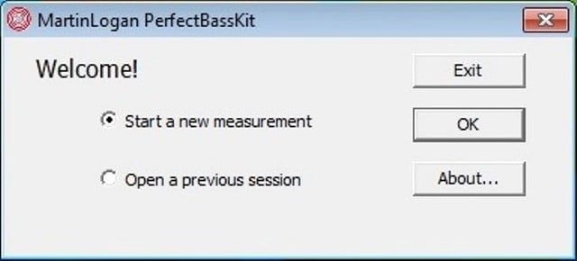

 Measuring
the frequency response of the sub and applying equalization is easier than it
is on any other standalone system I have ever used. When the software starts,
you can either select “Start a new measurement” or “Open a previous session”.
Opening a previous session allows you to load up past measurements to either
re-upload to the sub or for reference. After you select to start a new
measurement, the software asks how many positions will be used. Next, the
software checks for a valid subwoofer, mic, and calibration file. You have to
re-select the same calibration file every time you start a measurement. I
suppose this is done for users with more than one PBK (or to make testing
different mic easy during R&D), but I don’t know why anyone would ever own
more than one kit.

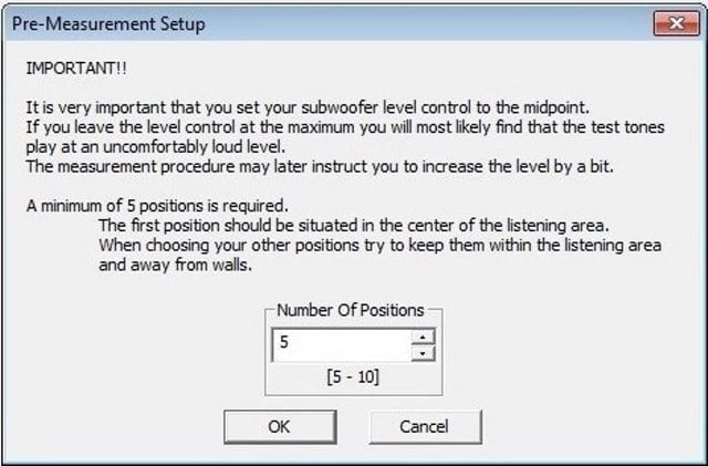

Selecting the number of measurement positions
At this point, PBK is ready to rock n’ roll. All you need to do is move the mic to the first measurement location and hit “OK”. The actual measurement process is lightning quick. PBK only takes a few seconds to measure each position and about 20 seconds to calculate the results and upload them to the subwoofer. Once PBK is finished, you still need to set the level, crossover, and phase adjustments so the subwoofer meshes well with your speakers.

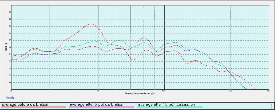

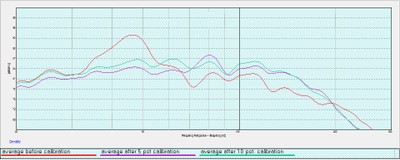

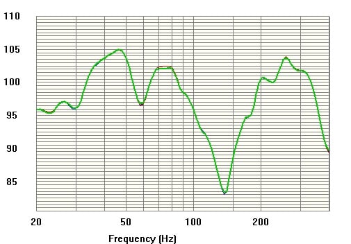

I tested PBK with a MartinLogan Dynamo 1500X placed in the optimal position for a subwoofer in the room. I used my OmniMic system to measure frequency response before and after running PBK.
The image below shows the frequency response averaged across seating locations before running PBK (red), after calibration using the minimum 5 locations (purple), and after using the maximum 10 locations (green). In all of my tests the differences between 5 and 10 measurement locations were subtle. PBK did a great job of getting rid of a huge peak centered at 45Hz, and a smaller dip at about 70Hz. It employed a nice balance of adding and cutting gain to achieve a remarkable +/- 3dB response from about 23Hz to 150Hz. Keep in mind that this is averaged. Some of the individual seating locations do fall within +/-3dB up to about 100Hz, but others are still negatively affected by room modes and nodes that create variances of over 15dB. Adding a second subwoofer would help ensure a more uniform frequency response across multiple seating locations. Note that the before/after EQ curves are offset by several dB, even in the frequency regions where the response shape is identical. I did not adjust the level of the subwoofer or receiver between tests, the difference is from the EQ applied by PBK.
Red - Before PBK; Purple - PBK at 5 location; Green – PBK at 10 locations.

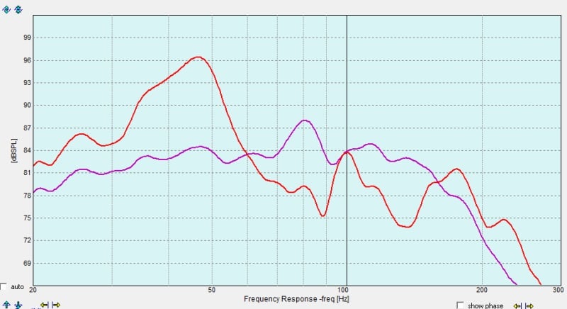

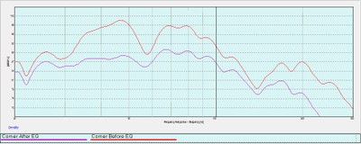

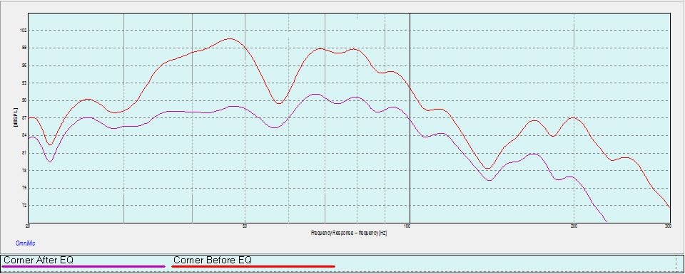

After testing out PBK under normal circumstances, I wanted to see what would happen if the system was used improperly. I wanted to know if it could be broken. I tried taking a series of measurements at various problem spots in the room (corners + back wall + center of room). I took all of the measurements in the exact same location, so see if it would over correct. Much to my delight, I could not force PBK to make any major mistakes. The graph below is the result of sticking the microphone right in a corner in the room and taking 5 measurements without moving the mic. Sure enough, it made a huge improvement in the frequency response. It didn’t get rid of a node around 23Hz, but I’m not surprised. Adding a few extra dB that low would cause undue strain on the Dynamo 1500X’s amplifier, which, during our review, we found was already heavily equalized to allow the sub to reach down to 20Hz.
Red – Before PBK; Purple – PBK results from 5 measurements at a single location

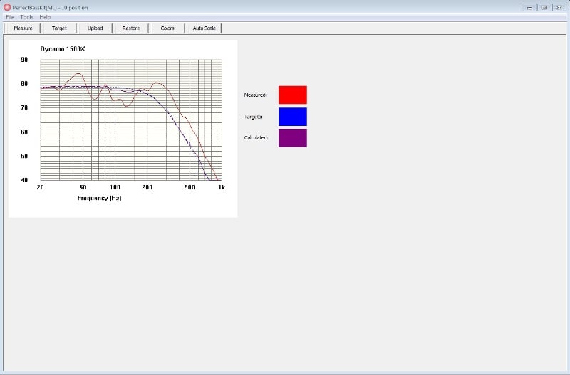

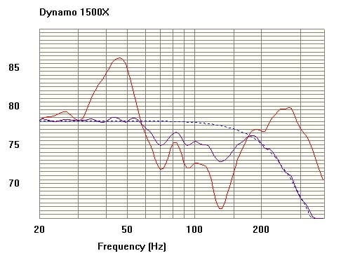

After I had taken a series of before and after measurements, I compared the results shown in the software versus what I measured. After calibration, PBK shows the measured response before calibration (red), the target curve (blue), and the actual calculated response after EQ has been applied (purple).
There was a significant amount of variance between what I measured and what PBK showed. As you can see in the image below (on the right), the red “Measured” line makes it look like the average frequency response was horrible before EQ. In reality, that is not the averaged response. The program seems to choose the single worst response at any individual location and show that as the before EQ curve. I sifted through the measurements I had taken before running PBK and found the curve that most closely matched what PBK showed, and used that for the red line in the image below (on the left). The calculated response after EQ also did not quite match my measurements; however, that is partially because I used 1/12th octave smoothing and PBK displays results using 1/6th. In nearly every test I performed, PBK claimed to have calculated an almost perfect frequency response. The results below are the worst that I was able to get the software to show me.
I’m not sure exactly what is going on when PBK generates its results, but they do seem to be rather optimistic. Thankfully, my measurements showed that PBK was always effective, even if the calculated line didn’t quite match what I measured.
Left – Results window in PBK; Right – Actual measured response in OmniMic
