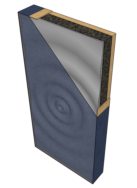

FlexRange is available on the GiK 244 panels and their Monster Bass Trap products. As shown in the picture above, it is a membrane that covers the front of the panel that not only increases the lower-end absorption but reflects high-ed energy back into the room much better than a standard panel. How much of a performance boost?

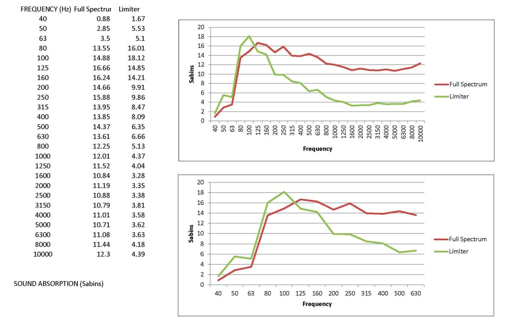

GiK Graphs of the 244 Panel with and without FlexRange
From the above image, you can see there is quite a bit more low-end energy absorption while the high end experiences much less. Is this something you want for all your panels in your home theater? No, absolutely not. But it is part of a larger room treatment plan and gives you more options. We really like how flexible (forgive the pun) FlexRange is. More importantly is price - FlexRange, as an option, will run you an extra $15 per panel. This is about a 20% increase in price - less so for the more expensive Monster Traps. The low end absorption on the panels with FlexRange is increased by up to 50% below 60Hz while retaining 70% more of of the sound from 400Hz and up.
