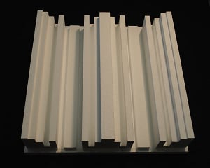

  • Product Name: GridFusor
  • Manufacturer: GIK
  • Review Date: February 03, 2011 04:05
  • MSRP: $49.99 per unit (sold 4 per box $199.96)
  • 2 foot square by 5 1/2" depth
  • 13 root QRD diffuser design
  • Easily paintable.  Painting will have no impact on diffusion characteristics.
  • Square shape allows for easy orientation changes to scatter in multiple axis.
  • Easy to install

The Gridfusor is designed to be a drop-in replacement for a 2 x 2 ceiling tile. GiK also says that two of them will fill a 4 x 4 foot space. Now, either that means that they are 4x2 or they are 2x2 and they meant that four of them will fill a 4 x 4 foot space. We're guessing it is the former (even though the press picture above looks square). Either way, the Gridfusor is designed with a drop ceiling in mind. GiK has specified that they are a direct replacement which means no extra bracing and it is strong enough that you can add additional insulation above it to absorb bass.
The thing to remember is that one of the best points in any room for diffusion is at the first reflection point on the ceiling between the front speakers and the listening position. Additionally, depending on the room, we've seen diffusion used above the seated area. Regardless, the ceiling is usually reserved for diffusion. This can add to the sense of spaciousness to your sound by breaking up that zingy, slap echo in a room without deadening it too much.
The GiK Gridfusors incorporate a mirror imaged pair of 13 root diffusers. This provides excellent diffusion from 600Hz to 5000 Hz and additional scattering below and above the diffusion range. Since you don't have to worry about the absorptive characteristics, painting the Gridfusors is not a problem. We love the look of the all wood diffusers in the showroom but the often end up standing out in a room. And it seems a shame to paint them. With the Gridfusors, you won't have that problem.
Since they are designed to be light, you can use them even if you don't have a drop ceiling. They can be easily mounted with adhesive, double sided tape, or even pins depending on your situation and permanence desired. With a 5.5" depth, however, make sure you have enough headroom. In a typical eight foot room, you should be fine as long as you don't hang out with too many pro basketball players.
