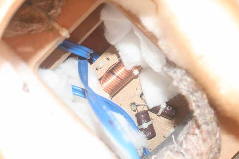

Yes, according to Yamaha's Soavo-1 brochure (PDF) Solen metalized polypropylene capsitors are used. But your pictures shows the tweeter net-work, I think, as Yamaha's photo of the Woofer crossover features several capacitors and resistors, not just two.
Could the subdued mid-range be due to the loss of the “Wave-Guide-Horn” in the Soavo-1, rather than the driver design? But why has Yamaha stopped using its White Spruce (WSD) cones. It was claimed, at the time, to the “world's lightest cone material.”
Audioholics posts on June 24, 2008 16:19
That is certainly possible. We couldn't really take apart the speakers further. What's odd is that Yamaha peer reviewed the article for technical accuracy and said nothing…

“Uses electrolytic caps in series with tweeter”
I Think this is wrong. What you show in the picture is the crossover for the bass drivers and not for the tweeter. (In many speakers that are bi-ampable they put the crossover for the bass drivers in front of the crossover for the mid and tweeter) I think they (Yamaha) use a high quality Solen capacitors for the mid and Tweeter. Here is a picture of the crossover components:
