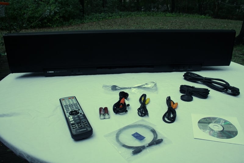

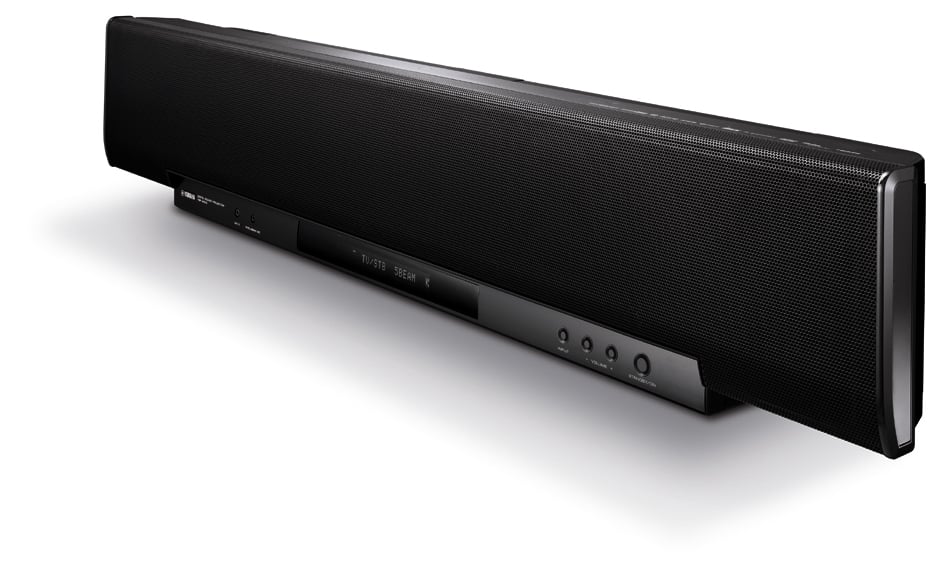

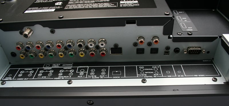

The YSP-4000 is a tank. You know you are getting a piece of equipment with some heavy duty engineering when you pick the thing up. Either that or they filled it with lead. The YSP features two 4-3/8" woofers and 40 1-5/8" "beam" drivers which resemble little tweeters. The detachable power cord attaches at a right angle in the rear of the unit which also has four threaded inserts for wall mounting. The optional wall mounting bracket is sold separately. I can't imagine that there are drywall anchors sturdy enough to hold this thing to a wall for long, so I'm guessing you'll need to locate a couple of studs. Since the wall mounting option would almost certainly be used in conjunction with a wall mounted flatscreen TV, I can't imagine this would be a problem.
The back of the unit has almost all
your inputs and outputs. The two HDMI inputs and one output are located near
the center and need to be installed from the side. All the other inputs and
outputs are connected directly up into a recessed section of the bottom of the
unit. While the RCA and TOSLink connections usually have little problem winning
the battle over gravity (which is trying to pull them loose), the orientation
of the HDMI connections actually uses gravity to make a more secure connection.
Yamaha has really thought this one through as they also suggest using tape to
secure your HDMI cables to the YSP. This all becomes more intuitive when you
consider the fact that both the YSP-4000 and your matching flat panel display
are ultimately intended for wall mounting. The YSP-4000 sports a RS-232
connection and IR in for custom control.

Now does this mean that your TV/STB can't use HDMI? No. Each of the inputs is assignable and renameable from the menu (we'll get into that later). There is also a dedicated XM input on the back as well as an Aux 3 on the front of the YSP-4000 for portable audio players (such as an iPod or MP3 player). This is simply a 3.5mm plug which will require the use of an external cradle or stereo plug connected to the headphone jack output of your player. Aux 3 can only be used for audio.
The front of the YSP-4000 has a
small, single line LCD readout, the aforementioned Aux 3 jack, a jack for the
IntelliBeam mic, and input, volume, and standby/on buttons. The front grill is
massive, metal, and permanently attached. There are rubber feet on the bottom
of the unit to protect against scratches in the case of shelf mounting. The
unit arrives with a slew of cables - a composite video (yellow), digital audio
(coaxial - orange), and analogue audio (red/white) of the RCA variety. There is

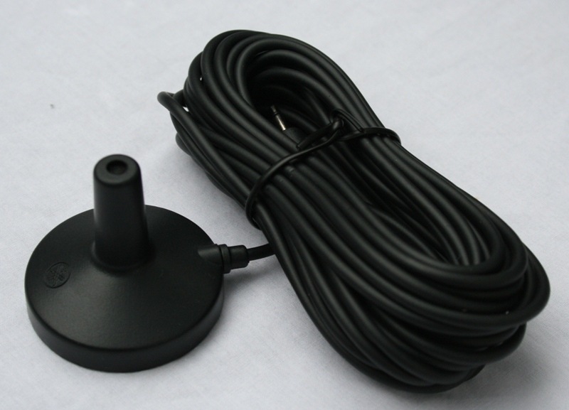

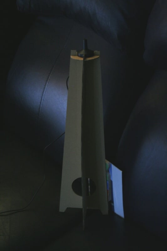

also an included optical cable, FM antenna, and power cord. The IntelliBeam mic
can be attached to your favorite camera tripod or placed on the included
cardboard stand (which is what I used). The cord to the IntelliBeam mic is
outrageously long. Your room is WAY too big if that cable isn't long enough.
There are also a host of fasteners, clamps, guides, and a remote control.
Really, the only thing that is missing here was an HDMI cable.

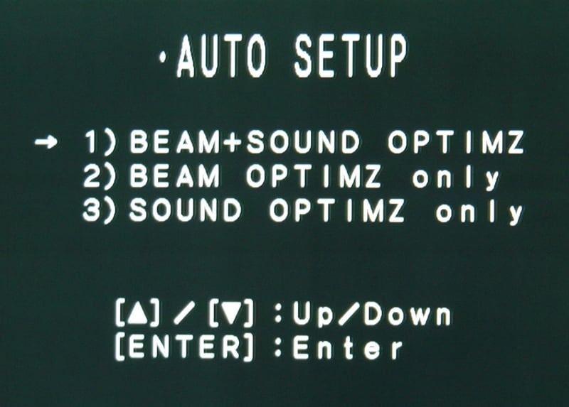

Now the problem with my room is that there is no real good way to optimally accommodate the YSP-4000. Two of the walls have openings in them that lead either to a hallway or another room. These openings are large (about the size of a double door) and offset from each other (they don't line up). If I placed the YSP-4000 in front of one of the openings, the other would be at my back and there would be nothing left to reflect the sound. If I put it in a corner, I come up with an opening near my back on one side and near the speaker on the other. So I ended up just placing it where my speakers and TV are normally, in the middle of one of the solid walls. The geometry of the room was such that I figured it gave the YSP-4000 the best chance of having a surface for reflecting. The other problem is that I have high back couches. There is really nothing I can do about that so I just had to live with it.
The

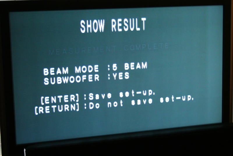

first step in the setup process involves running through the automatic
calibration process under the Auto Setup menu.
You have three choices - Beam+Sound, Beam only, Sound only. The Beam
calibration adjusts the angle of the sound that is bounced around the room, the
Sound calibrations optimizes beam delay, volume, and quality. During the
initial setup, you're going to want to do Beam+Sound as it does everything. The
nice thing is that there are three different memory locations so that you can
actually take three different measurements based on different room
orientations. "Like what?" You ask? If a wall has a window with
curtains you could measure with the curtains open and closed. Maybe there is a
chair that tends to move around (like from the side of the room when the whole
family is watching to the center when you're alone). Regardless, it is a nice
feature.
The auto-calibration is fairly
quick and painless and only requires a few things - quiet and the absence of "you".
Once you start the auto-calibration, you have 10 seconds to leave the room
before it starts. Once it begins you'll hear a number of beeps and clicks that
you can't imagine will actually do anything. In reality, that's all it really
takes for the majority of the calibration. It only takes about 3 minutes for
the entire setup, though it seemed less to me. I didn't receive any errors so I
can only assume that the YSP-4000 was able to overcome the limitations of my
room (at least in its mind). Afterward, I checked the settings and basically
agreed with everything but the subwoofer location. It just about doubled the
true distance to the sub (a common occurrence and something we tend to find
with most AV receivers). The crossover was set at 100Hz which seemed about
right though it does make the sub locatable at times. You're going to want to
be sure that your sub isn't too close to you with this setup - preferably very
near the YSP-4000. Since people that are purchasing this unit aren't really
looking to run cables, that shouldn't be much of an issue.

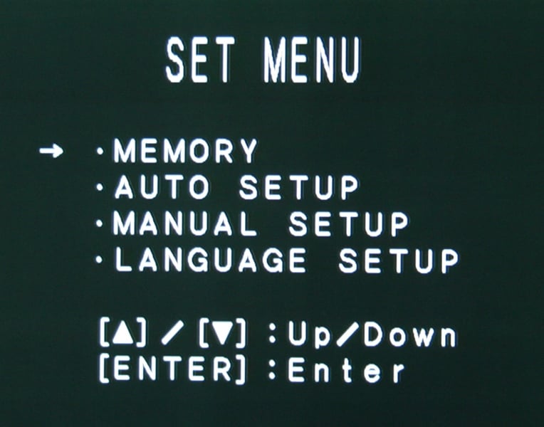

YSP-4000 Menus, Remote, and Beam Modes
There
are four menus on the setup screen, only two of which you'll probably need to
look at more than once or twice. I already addressed the Auto Setup menu above. The Memory
menu is where you can load and save your audio settings. If you have run the
automatic setup more than once, you can store each here. It would be nice to
have a way of renaming each of these memory slots but you are stuck with Memory
1, 2, 3. The Language menu simply
sets the language of the display. There are choices of English, German, French,
Spanish, Italian, Dutch, and Russian. The other menu has a little more depth to
it so I'll go into them in more detail.

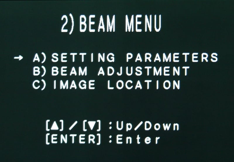

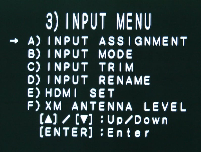

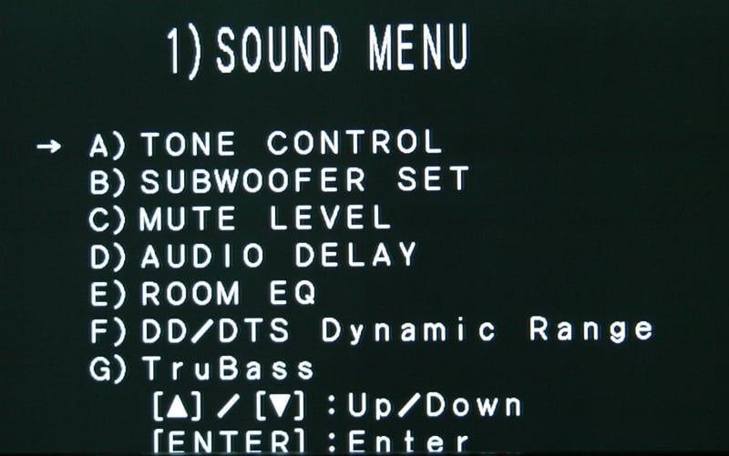

Manual Setup menu
The manual Setup menu has four options - Sound, Beam, Input, and Display.
Sound
From this menu you can adjust the
Tone Control (adjust the treble or
bass from -12dB to +12dB) Subwoofer
Settings (which includes turning on and off the sub, setting the crossover
(80, 100, 120Hz), setting the LFE level (from 0 to -20dB in 1dB steps), and
setting the subwoofer distance in half foot units), and the Mute Level (either complete mute or
-20dB). The Audio Delay can be
adjusted if you're having lip syncing issues from 0-160 msec in 1 msec units as
well as the Room EQ (which asks you
to indicate if the unit is on the wall or a shelf and whether the room is Normal or Hi Echo). Dolby
Digital and DTS Dynamic range has a min/std/max setting where min is the least dynamic range (most compression)
is and max is the most dynamic range
(least compression). I'd suggestion Max unless you are listening at night and
don't want dramatic volume changes to wake up your neighbors. The TruBass was set as Mid for me which I
didn't prefer. I adjusted that to Off rather than Mid or Deep. This setting is
really more to boost the bass when you are not using a sub. The other option is
to turn this off and raise the crossover to 120Hz, giving the sub even more of
the bass duties and further taking the strain off the YSP-4000. You should
definitely play with these options and see what works for you given your
configuration and room.
Beam
Under
the Beam menu, you are directly
controlling how the sound is reflected around your room. If you decide to start
messing with these settings you're going to want to make sure that you have
them saved somewhere. Under the Setting
Parameters option you can define the location of the unit and the shape of
your room. Remember, the room may appear to be larger than it is if some of the
sound is being absorbed by room treatments or furniture or is getting lost through
openings. The Beam Adjustment option
allows you to adjust the horizontal and vertical angles, the beam travel
length, the focal length and the treble gain. This menu is really for those
interested in eeking the most out of their YSP-4000. You can make these beam
adjustments and then re-run the auto-setup with only the sound optimizer to
balance everything out. Of course, you can just grab your handy SPL meter and
tape measure and do the same thing. Honestly, there is about 1% of the
population that wanted this menu and Yamaha gave it to them. For the other 99%
of us, it isn't worth the time. Let the auto setup do this for you. Image
Location simply adjusts the mix of the front left and right channels that gives
the illusion of a central sound in the soundstage. If you are sitting off axis
(not directly in front of the speaker) and will always do so, you'd want to
adjust this toward your listening position.
Input
Under the Input Menu you can assign inputs, choose to have the YSP-4000 auto
detect incoming digital signals upon power up or default to the last input
used, adjust the input trim (where you lower or raise the volume level of each
input from -6dB to 0dB), and rename inputs. With the rename function, you have
up to 8 characters to assign any lower or uppercase letter or number or a
variety of symbols (such as -,/,&). While 8 isn't a lot of characters to
play with, it is great that you aren't relegated to choosing from a
predetermined list which invariably won't have the choice you want. The XM Antenna Level menu simply displays
the strength of the XM signal.

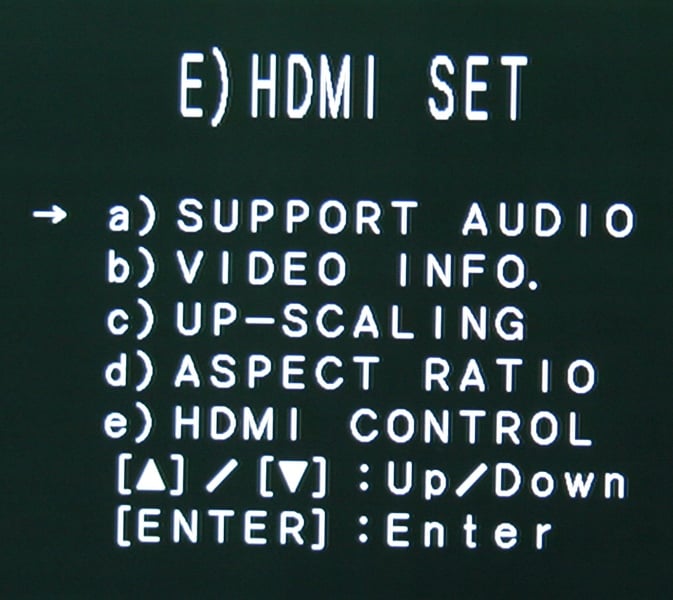

If
you have HDMI inputs, you're going to want to spend a few minutes on the HDMI Set submenu. Here you can select to
have the YSP-4000 play the audio coming from the HDMI inputs or to pass it
through to the HDMI output from the Support
Audio submenu. If you connect up your HDMI cables and get no sound, make
sure you check this option. It might have been switched to "other"
which is the pass-through mode. The Video
Info. submenu just gives you information on what type of signal is coming
in to the YSP-4000. This is a good menu to visit if you are having HDMI issues
as any error messages will be displayed. The Up-Scaling submenu will allow you to select the resolution to which
the analogue signals are upscaled to (480p, 720p, 1080i). Since the YSP-4000 does
a better job of scaling than deinterlacing, I'd suggest starting with 1080i so
that you'll get whatever deinterlacing your display can provide if your source
is non-progressive (standard definition). Otherwise, you can send a progressive
signal and have the YSP-4000 upscale it to whichever is the native resolution
of your display. Of course, if you'd like it to leave the signal alone, you can
select "through" (our preferred setting) which you would think would
send the signal through unaltered (see below). The Aspect Ratio submenu allows you to send a signal through unaltered
or to adjust it using the "Smart Zoom" options (fitting a 4:3 picture
to your screen) or "16:9 Normal"
(black bars on the sides for 4:3 signals). More than likely your display or
your source (or both) already do this. Again, "Through" is probably
your best bet. If you have an HDMI Control-capable display or other component
(such as a Panasonic's with EZ Sync) you can turn on this option from the HDMI Set menu as well. This will allow,
with no additional programming, your YSP-4000 remote to control your device.

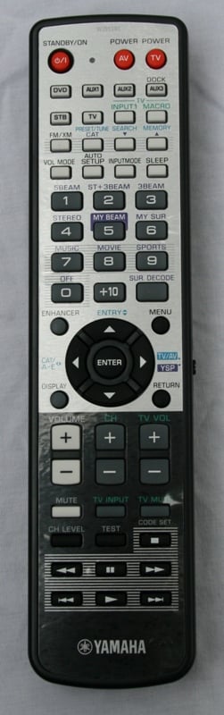

The
remote for the YSP-4000 is very utilitarian. There are dedicated buttons for
each of the inputs, surround modes, and controls. Honestly, it is like they had
more buttons than they knew what to do with so they just gave everything its
own. I'm all for that. The unit is extremely responsive and the remote worked
well off axis from the YSP-4000. My only strike against the remote is the lack
of backlighting and the fact that most of the buttons are the same shape (or
similar). For instance, the surround modes are all on the numeric key buttons
which are all the same size and evenly spaced. In the dark, you're going to
have to find the Braille dot on the five or do a lot of counting to find the
right button.
