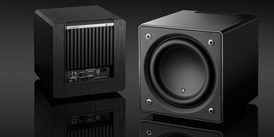

The E series subs as previously mentioned are very small sealed designs with a single forward-firing driver and a powerful on board amplifier. The e110 is so named because it houses a single 10” driver and the e112 houses…You guessed it…a 12” driver. The amplifier for the e110 is rated at a robust 1200w and the e112’s amplifier carries an even more powerful 1500w rating. There are 2 finishes available, both of which are black. The standard finish is a black ash which shows some wood grain and is less reflective. The second is the high gloss black which both the e110 and e112 review units came dressed in and which carries a $200 upcharge over the basic black ash finish. Typically I am the type of guy who would pocket the extra cash rather than splurging extra just for a cosmetic enhancement, but I have to admit the E series subs really wore the gloss black well and I’m not sure if the standard ash finish would have been as visually arresting.
Since the driver of the E series subs is a bit unique and there was mention of the motor bolting into the cabinet in the literature, I decided it might be best to inquire with JL Audio about how to remove the driver and amplifier before attempting to do so. After briefly speaking with Brett about it, JL’s lead engineer on the E series project, I was informed that there really isn’t much to it. I figure it’s better to be safe than sorry with a loaner $2,100 subwoofer though. Armed with the knowledge of how to go about disassembly of an E series sub it took all of 5 minutes.
It is often said that the driver is really the heart of a subwoofer and in the case of the JL Audio E series that may be an even more apt description than normal. These are no ordinary drivers. The design of them at some point veered off the traditional track and ventured out into previously unexplored territory. JL has not been shy about sharing pictures and information about the drivers developed for the E series and one look at them indicates that these are a little bit unconventional. To begin with they are abnormally deep units with the overall depth equaling or exceeding the diameter. Part of the reason for this is the result of an effort by JL’s engineers to increase the suspension linearity and resistance to the former rocking at high excursions by spacing out the suspension elements more than usual. The surround is in its normal position at the cone edge and there is a large diameter spider in its traditional position near the motor and voice coil. Typically the cone would also meet the former and spider at this point forming the triple joint. The E series drivers greatly stretch out and increase the depth of the former and frame and add a second spider landing between the surround and traditional spider placement up close to where the cone now meets the former. The result is a very deep driver that looks a bit odd with a very deep, open designed 12-spoke, cast-aluminum frame and spiders of different diameters spaced a good 3-4” apart. This design should be very stable and resistant to rocking effects at high excursion. In between and linking the 2 spiders and the former is a black plastic piece that I assume uses JL’s VRC technology to firmly lock the former and both spiders together into a single moving unit. Another interesting feature of the drivers is that the typical mounting flange is gone and there is a large, square, steel flange attached to the front of the driver that mounts into the enclosure and actually composes the front of the finished subwoofer. It comes up around the surround enclosing the area between the top spider landing and surround and also recesses the driver. I’m not sure of the exact reasoning behind this piece but it is certainly different. On a more traditional front the cone is concave and shares a family resemblance to the W7 or Fathom drivers. It is adorned with only a small JL logo at the bottom of the cone. The surround is rubber material formed in a half roll that supports large excursions. The motor itself also appears rather conventional compared to the rest of the driver with a stacked pair of large diameter ferrite magnets, a deeply bumped back plate and a top plate of what looks to be about 12mm in thickness. The back plate is also threaded so that it may be bolted into the enclosure. With drivers this deep the heavy motor can apply a significant amount of leverage to the mounting baffle and frame since it is hanging back so much further than usual, so supporting the motor is an extra bit of precaution in case the subwoofer is dropped or otherwise encounters a high G loading on the motor. The voice coil of the E series drivers is a 2” diameter affair that appears to be 4 layers of substantial winding length for extended Xmax. The owner’s manual mentions that the e110 driver is capable of 2.5” peak to peak excursions and that the e112 driver is capable of 3” peak to peak excursions. After watching the driver movements during a few loud action movies and conducting CEA-2010 burst testing on the E subs outdoors I’m inclined to believe them. These are very high quality drivers and it is obvious that a lot of resources and effort were used in the development of them and that they were engineered specifically for the E series application.
JL Audio E series Driver

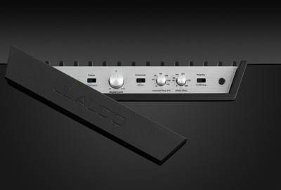

The amplifiers employed in the e110 and e112 subwoofers are high efficiency regulated switching designs both rated to produce well in excess of 1kw and like the drivers used in the E series, are specifically tailored to the individual application. These amplifiers have a simple input and output layout with stereo unbalanced inputs and outputs. There is also a set of high level inputs, a ground/lift switch and a fuse by the detachable power cord. All of the usual controls for balancing the subwoofer with the rest of the speaker system are located on the top of the amplifier plate in a recess in the back of the enclosure. These consist of: Gain, 0-180 degree phase control, absolute polarity switch, internal low pass crossover adjustment (24dB/octave Linkwitz-Riley) which also high passes the line outputs and a switch for Auto/On/Off power mode selection. During use the E series amps seemed to have the ability to give the E series drivers all that they could want and despite being run very hard for extended periods at times the amplifiers heat sinks only got slightly warm to the touch.
JL Audio e112 Amplifier

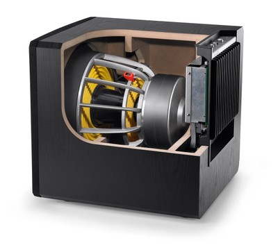

The cabinet of the E series subwoofers are constructed of CNC cut MDF (medium density fiberboard) and contain a couple of large braces internally. The first of which is near the center of the cabinet, which the super-deep drivers pass through and the second of which is back towards the amplifier and which the back of the driver motor bolts to. This second brace is a full wall which seals off the amplifier from the driver. The amplifier occupies most of the back panel while the front panel is almost entirely occupied by the unique steel mounting flange of the driver which bolts into the enclosure face. The front panel is in effect a composite MDF-steel sandwich. With the very short enclosure dimensions, internal bracing and the driver being anchored to the enclosure at both the back and front, these are very dead enclosures. I noticed no panel resonances, rattles or other issues even pushing the subwoofers for all they were worth at the outdoor test site.
The gloss black finish of the E series review units was beautiful and deep. It contrasted well with the aluminum accents on the amplifier and front panel when the grilles were off. The top and bottom edges of the cabinets have a 45 degree angle cut which helps differentiate the profile from that of a plain rectangular body. The amplifier cover piece adorned with the JL Audio logo, fit down into the recessed area for the amplifier controls well and is held in place with magnets molded into it. The grilles were more heavily constructed than most I have encountered and hold in place quite solidly. All of the controls on the amplifier possessed a feel of quality as well. I also enjoyed having the controls on the top of the unit versus on the back of the amp as is typical of most powered subs. It makes adjustment, however rarely needed, just a bit easier. The build quality, fit and finish and ergonomics of the E series subs are all excellent to say the least.
JL Audio E Series Cutaway Cabinet View

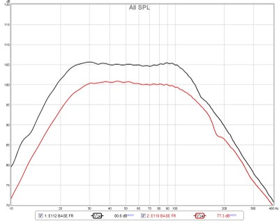

JL Audio e110 and e112: Basic Frequency Response as Tested
Above is the frequency response of both the e110 and e112 subwoofers with the internal low pass filters disabled. The shape and slope of the roll off on the low end of both the e110 and e112 indicate that there is some low frequency boost employed internally and that there is what appears to be a 12dB/octave high pass filter that comes into effect below 20Hz and combines with the sealed systems natural 12dB/octave roll off to produce a 24dB/octave total slope. The e112 response fits within a 6dB total window from 19-135Hz. The e110 fits within the same 6dB total window over a frequency range of 21-143Hz. The overall response shape of both systems is fairly close with the e112 having a bit of extra low-end extension. Even with the low pass filter defeated on both units the top end extension is fairly limited but is enough so that the crossover point to the other speakers in the system could be effectively set to around 130Hz.

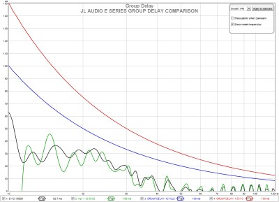

JL Audio e110 and e112: Group Delay
Group delay measurements for the E series JL’s are well mannered and show nothing of consequence. Neither subwoofer approaches 1 cycle of delay at any point over its entire useful bandwidth.

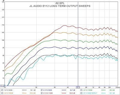

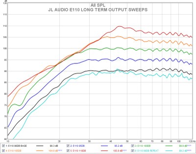

JL Audio e110: Long-Term Power Compression
JL Audio e112: Long-Term Power Compression
The long-term output compression tests for the smaller e110 subwoofer show negligible compression through the nominal 100dB sweep. Compression sets in first in the 20-25Hz area and by the 110dB nominal sweep the e110 is out of headroom full bandwidth. The little e110 manages to produce more than 93dB at 20Hz, passes 100dB at about 28Hz and produces over 105dB above 35Hz during the loudest sweep. The e112 performs quite similarly to the smaller e110 but exhibits greater low bass power. It also remains free of significant compression through the 100dB nominal sweep before exhibiting compression in the 20-25Hz area during the 105dB nominal sweep. By the 110dB nominal sweep it is out of gas. The bigger e112 leverages the larger driver and a bit of extra stroke to manage about 97dB at 20Hz, 101dB at 30Hz and about 109dB at 38Hz. Both subwoofers exhibit some thermal compression from heating of the voice coil in the repeat 90dB base level measurement conducted immediately after the rest of the measurements. Neither subwoofer made any overtly bad noises during these measurements. Other than a bit of distortion and a bit of “grumble” and distortion from the drivers near 20Hz on the loudest sweeps, there was no distress to report. The E series subs are very well protected against being overdriven or otherwise damaged.
Note on Output Compression Testing: This is by far the most demanding measurement type conducted on the subwoofers during our testing and will reveal any issues with overload, port compression, port noise, driver distress, creaks, rattles, buzzes, etc. Additionally the test is conducted outdoors with just the subwoofer operating so there will be no nearby walls or objects to vibrate and no upper frequency content from other speakers in operation. These would normally help to cover up or mask any objectionable noises from the subwoofer in a typical room. Any sort of audible distress or issues with the subwoofer are readily apparent in this environment.

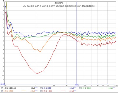

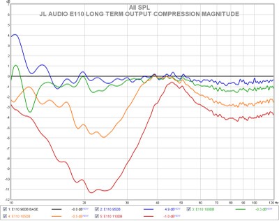

JL Audio e110: Output Compression Magnitude
JL Audio e112: Output Compression Magnitude
Looking at the amount of compression occurring in the e110 and e112 subwoofers in the graphs presented above shows that both are very well behaved until the 105dB nominal sweeps where both start to exhibit notable compression near 20-25hz as both are out of output in this frequency range. Asking the E series subwoofers for a further 5dB increase in output past this point causes them to fall into compression in the upper bass register as well where the output is now some 3 to 4dB less than it should be. As noted previously neither subwoofer showed any signs of being in danger of damage by driving them this far into compression. Judging from the measurement data as a whole it appears that both subwoofers employ significant boost in the 20-25Hz region to flatten their response.

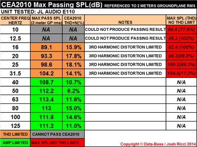

JL Audio e110: CEA2010 2 Meter Ground-plane RMS Results

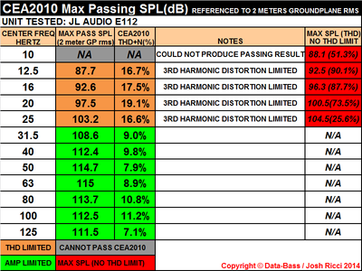

JL Audio e112: CEA2010 2 Meter Ground-plane RMS Results
CEA2010
Results
The CEA2010 maximum-distortion-limited-short-term output results for the JL Audio E series subwoofers are shown above. The e110 is a mighty little beast. It manages to produce well over 110dB from 50-125Hz which would explain why it packs quite a thump with kick drums. On the low end it still manages a passing 93.3dB at 20Hz and even manages a passing 16Hz at 89.1dB. Not exactly records by any means but for a single sealed 10” driver it is more than respectable. At 31.5Hz and above the e110 was amplifier limited and below that the distortion was the limiting factor as the e110 will put out a bit more in the deep bass if distortion is ignored. Pushing it for all it is worth at 20Hz it will muster up about 96dB. The bigger e112 with a 12” driver and slightly stronger amplifier puts out a little more as expected. At 63Hz the e112 managed to burst 115dB flat and is still well over 110dB at 40Hz. In the deep bass is where the larger driver, enclosure and amplifier of the e112 come into effect. This allows the e112 to produce about 3-4dB higher maximum output than the e110 below 40Hz. The e112 produced 97.5dB at 20Hz and 92.6dB at 16Hz while passing the CEA-2010 distortion thresholds. It even managed a passing score of 87.7dB at 12.5Hz. As with the e110 the e112 was amplifier limited above the 31.5Hz band but was distortion limited below that point and would produce another 3-4dB if pushed to its limit in the deep bass. Maximum output at 20Hz was recorded as 100.5dB without regard for distortion. When comparing the CEA-2010 short-term burst output to the maximum outputs reached during the sine sweep testing reveals that the E series exhibits 3 to 5dB of extra output with shorter term signals. This may be partly due to a protection circuit that dials back the power when the signals are of very long duration in order to prevent overheating of the voice coil.
