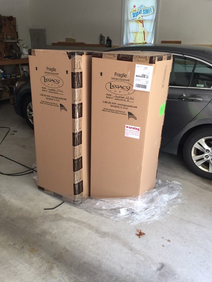

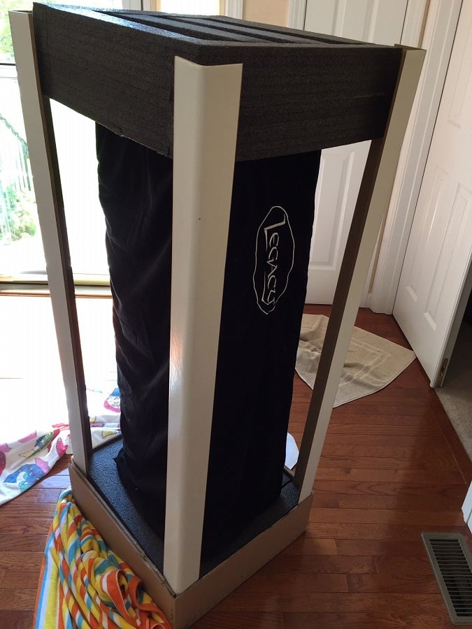

The speakers arrived on a wooden pallet, via Fed Ex Freight. I was prepared to offer the driver a generous tip to help me get the speakers directly into the house, but he said he was prevented by legal statute to not “cross the threshold.” So they ended up in my garage, which is at basement level, one level down from our living/listening floor. Yikes. These are big speakers, especially in their shipping cartons. Clearly beyond the capabilities of my wife and I (we’re in our late ‘60’s) to get up the front walk and into the house. So I called my young strong friend Jason to help out.
Mission Impossible: Legacy Signatures in my Garage
Jason is in his mid 40’s and as strong as can be. He’s ex-Army and an MMA expert. This is someone you want on your side. But, even more importantly, Jason is an EE and was the head speaker engineer at Atlantic Technology when I was there from 2003-2013. (I had a dual role as Director of Marketing and Manager of Product Development/Engineering.) Jason did both finished system design as well as transducer design. He headed the design effort that produced Atlantic Technology’s excellent AT-1, which utilized their outstanding H-PAS bass loading technology. The AT-1 had an MSRP of $2500/pr. yet it was on Stereophile’s Recommended Components Loudspeakers Class B for three years running. Speakers in Class B include pricing up to $20,000/pr. Think about that. He also did the amazing Atlantic Technology IWTS-30 LCR in-wall speaker—the acoustics, the voicing and the transducer design—the first in-wall speaker to earn THX Ultra 2 certification for flat frequency response, low distortion and high SPL capability. His body of work is impressive and his ear/musical knowledge is second to none.
So we got the speakers up from the garage and in the front door. These things were really packaged nicely. A heavy-duty outer carton with generous foam endcaps held things securely in place. Hard cardboard reinforcements at each corner ran the length from top to bottom. The speakers themselves are a good four inches in from the outer surface of the carton, so they’re well out of harm’s way. Each speaker was clothed in a full-length velvet bag, beautifully adorned with a silver Legacy logo. Most of Legacy’s speakers are very large, monstrously heavy affairs. The company obviously knows how to package its products for safe transport. They better know—the alternative is simply not tenable.
Signature SE inner packaging
The care and obvious engineering thought that went into the packaging was most impressive. They made it to my house from halfway across the country like they were going around the block. This was a great first impression.

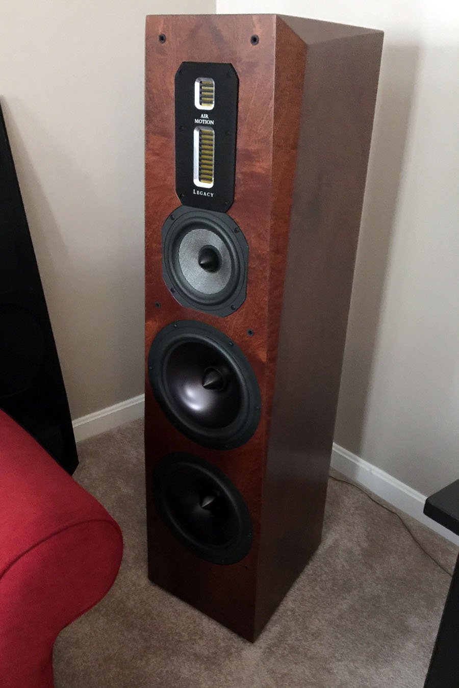

Nonetheless, sealed is sealed. The bass on the Signature SE emanates from one point only—the direct radiation from the woofer cones. As such, there is not any time delay, phase inconsistency or other anomaly that can be attributed to a vented system, where the woofers “hand off” their low-frequency responsibilities below a certain tuning frequency to the vent/port, often located several inches away from the woofers. Die-hard sealed aficionados will swear until the cows come home that bass from a sealed system is unsurpassed, embodying those elusive, indefinable, unmeasurable qualities of “fast, tight” bass. There is no intent here to pull this review off course and turn it into some wild “sealed vs. ported” argument. That’s not necessary. Properly designed systems of any kind can produce terrific bass, within well-known tradeoffs. Let’s agree on that.

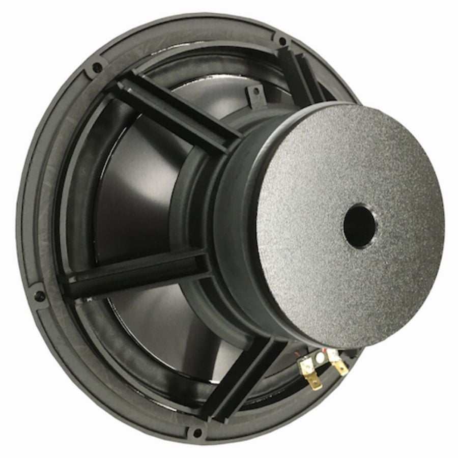

This speaker uses dual 10-inch aluminum-cone woofers with 2-inch voice coils and bullet-shaped aluminum phase plugs. These are beefy drivers—cast baskets and substantial magnets. The highly-scientific, extremely-precise “fingernail-flick-against-the-cone” test—a test that only the most modern and up-to-date loudspeaker testing labs is capable of executing properly—reveals that the Signature SE’s woofers are tuned quite low and the test quite accurately predicts that the system is capable of effortless, prodigious low-frequency output in a medium-sized space.
Legacy Signature SE 10” woofer with cast basket

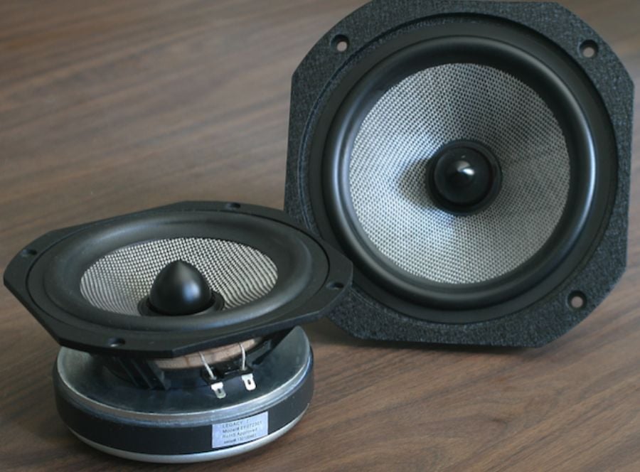

Crossing over at a very low 180Hz, the woofers make way for a 7-inch “midwoofer” with a silver graphite cone in a cast frame, also with a bullet-shaped aluminum phase plug. (When Legacy says, “silver graphite,” it’s not clear if they’re referring simply to the color of the cone or if the cone’s material composition contains some actual silver.) This driver handles the range from 180Hz to 2800Hz and is responsible for virtually the entire midrange. It is commendable that Dudleston has designed the system so that only one driver handles five straight midrange octaves, uninterrupted by any crossover circuitry or nearby overlapping driver interference. This midwoofer is quite an authoritative, capable driver, clearly responsible for the natural-sounding midrange and it’s a major contributor to the overall effortless quality of the system.
The aluminum phase plug on the woofers and midrange serve to increase the power handling, since it forms a direct heat exchange path from the driver’s pole piece to the outside air in the room. In the case of the 7-inch midrange, the bullet shape of the phase plug can also tailor the dispersion characteristics at the higher-end of the driver’s range. There is no dispersion effect for the woofers (they operate below 180Hz and are effectively omni-directional anyway) and having their phase plugs be the same shape at the 7-inch driver is simply a welcome cosmetic consideration.
Legacy Signature SE 7” midwoofer with cast basket

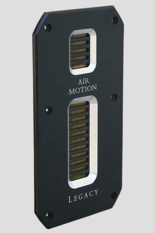

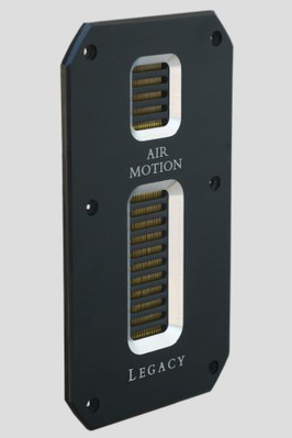

From there, the system crosses over to a dual AMT upper midrange/tweeter element mounted on a common faceplate. The 4-inch upper midrange AMT handles the range up to 8kHz and the 1-inch tweeter AMT takes over above 8k. Mounting the two units very close together (within an inch and three-eighths) on a common faceplate presumably enables them to act as a virtual acoustic “point source,” since the two radiators are less than a wavelength apart (.81 of a wavelength, actually) at their 8kHz crossover frequency. Such an arrangement yields the “coherent point source” acoustic benefits of something like the KEF Uni-Q driver, but totally avoids the dispersion-restricting/diffraction-producing “tweeter in a cave” problems inherent in that design. The Legacy shows a very insightful, intelligent design.
Legacy Signature SE dual AMT upper-mid and tweeter on common mounting plate

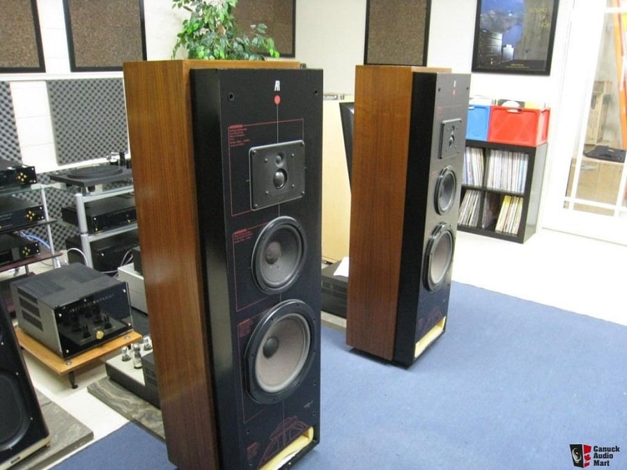

The AR9LS of 1982 used what AR called a “dual dome” upper-midrange/tweeter arrangement. The
1 ½-inch upper midrange dome and ¾-inch dome tweeter were mounted on a common faceplate and driven off a single large magnet structure. Their crossover frequency was similar to the Signature SE’s—7kHz. Since the two domes were within a wavelength at crossover, they operated acoustically as a virtual point source.
AR9LS with “Dual Dome” from 1982
As a matter of fact the AR9/90/9LS/9LSi series was somewhat similar in overall design to the Legacy Signature SE. The ARs were sealed systems, with dual 12-inch woofers (9), dual 10-inch woofers (90), and a 12 + 10-inch woofer arrangement (9LS and LSi). They were 4-ways with 8-inch midwoofers and the two dome upper-range drivers (the LS/LSi having the aforementioned coincident “dual dome” array). Their crossovers were 200, 1200 and 7kHz—fairly similar in concept. The Signature SE’s have a great advantage in avoiding that 1200Hz heart-of-the-midrange crossover, but it could be considered to be a modern version of that basic AR design approach, using the very latest materials, manufacturing methodologies, driver designs, cabinet bracing conventions and far higher-quality crossover componentry and internal wiring. Dudleston is on record as saying that he respected the AR9’s design, so it’s not beyond the realm of possibility that some of that respect—perhaps totally subconsciously—manifests itself in the execution of the Signature SE. In any event, being a veteran audiophile with a very long memory into past products gives me an unusually-long half-century vantage point from which to make observations and posit “what ifs.” Interesting to think about, that’s all. I’d venture a guess and say I’m one of only a bare handful of Signature SE owners in the universe who has detailed, first-hand knowledge of both those old AR speakers and these new Signatures. My Signature SE’s replace a set of meticulously restored mint-condition AR9’s in my main system, so the comparison is direct and fascinating.

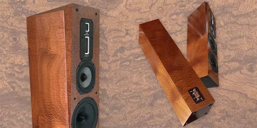

Signature SE Enclosure

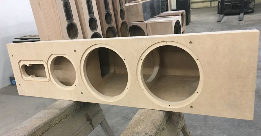

The cabinet is made from 1 1/8-inch thick MDF with very substantial internal bracing. The slight extra panel thickness leaves a substantial amount of “meat” for driver mounting, even after the routing for the drivers’ frames. There are four internal braces for the cabinet, quite a lot considering it’s only 48-inches tall.
The cabinet tapers front-to-back from 12 inches wide across the front to 9 ½ inches wide across the back. The top panel tapers down from 48 inches high in the front to 46.5 inches high in the rear. This means, of course, that the cabinet’s walls are not parallel, which greatly reduces the incidence of audibly detrimental standing waves within the enclosure. The top panel’s side edges are chamfered down and the top half of the cabinet’s tall front edges are cut back in a sculpted shape that reduces the boxiness of the cabinet’s appearance. It looks flat-out great. The quality of the Brown Sapele Pommele wood veneer is simply outstanding, and the total look garners that all-elusive WAF—the first speaker in my experience to do so. As can be seen in the picture, this is a very heavily-braced cabinet and the informal “knuckle-rap” text confirms it.
Legacy Signature SE cabinet under construction, showing thick internal bracing

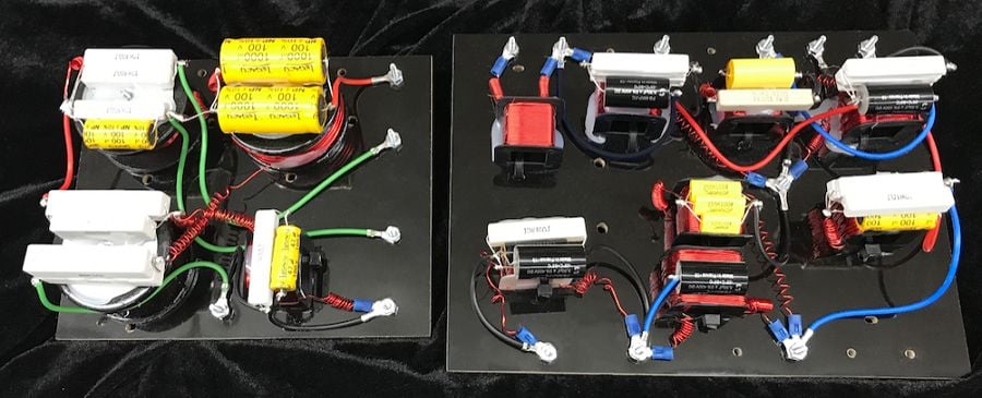

Legacy Signature SE crossover in two sections, with high-quality parts.

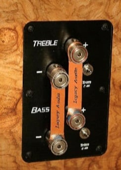

On the back panel are two sets of nice beefy binding posts, to facilitate passive bi-wiring or bi-amping if either of those snake-oil approaches appeals to you.
There are also two switches to the right of the binding posts that provide a subtle degree of tonal modification/room equalization. One is a high-frequency switch that simply shelves the response above 10kHz down by 2dB to tame any harshness in too-lively rooms. The other is a low-frequency switch that reduces the speaker’s output between 60-85Hz by about 2dB, to remove any mid-bass “bloat” caused by placement or room-dimensional problems. In my room—which has very cooperative dimensions for bass reproduction and is treated acoustically for a near-perfect balance of damping vs. reverberation, I didn’t need either of these controls, but I did verify that they worked as intended. Legacy describes the Signature SE as having “adjustable damping,” but never expounds on that in any detail, either on their website or in the owner’s manual. Presumably, the 60-85Hz control is what they mean by adjustable damping.

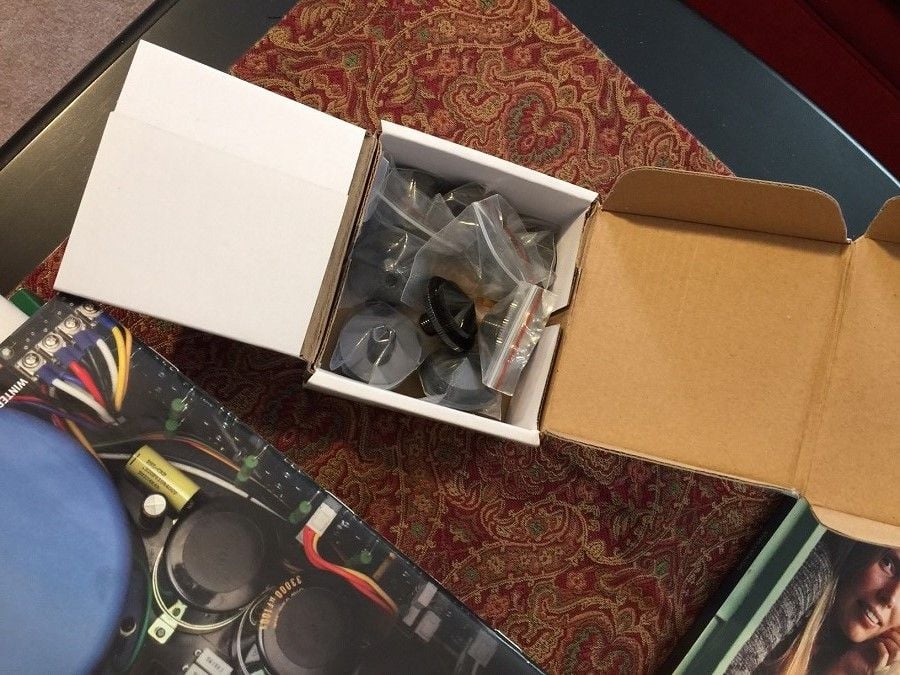

The speaker came with rubber feet already installed (thank you, even though the electronic PDF manual said the rubber feet needed to be attached by the owner). In one of the two cartons, there is a small white cardboard box containing adjustable-height carpet spikes that screw into the bottom of the rubber feet. I have never used carpet spikes on any speaker I’ve ever had. I suspect that the inclusion of these spikes is more to satisfy some unrealistically-critical reviewers who will then say, “Ahh, spikes. Good.” than it is to meet a real-world demand. I don’t know anyone who wants to poke holes in their expensive Karastan. I certainly never would. I remember writing the “Carpet spike installation and warning” slip-in sheet for an expensive Boston Acoustics tower back in the early ‘90’s and I showed the preliminary instructions to an audiophile lawyer friend of mine. He said to me, “You must be crazy. I’d never do this.”
Box containing carpet spikes
I do like the brass straps that connect the bi-amp terminals for conventional single-wire use. They’re insulated and have a nice printed ‘Legacy’ logo. If a stray wire strand somehow makes its was over from the + side over to the – side and touches a strap, no worries. Obviously that’s highly unlikely, but the logo’s insulation is a classy touch.
Rear panel terminals and contour switches

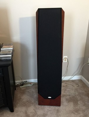

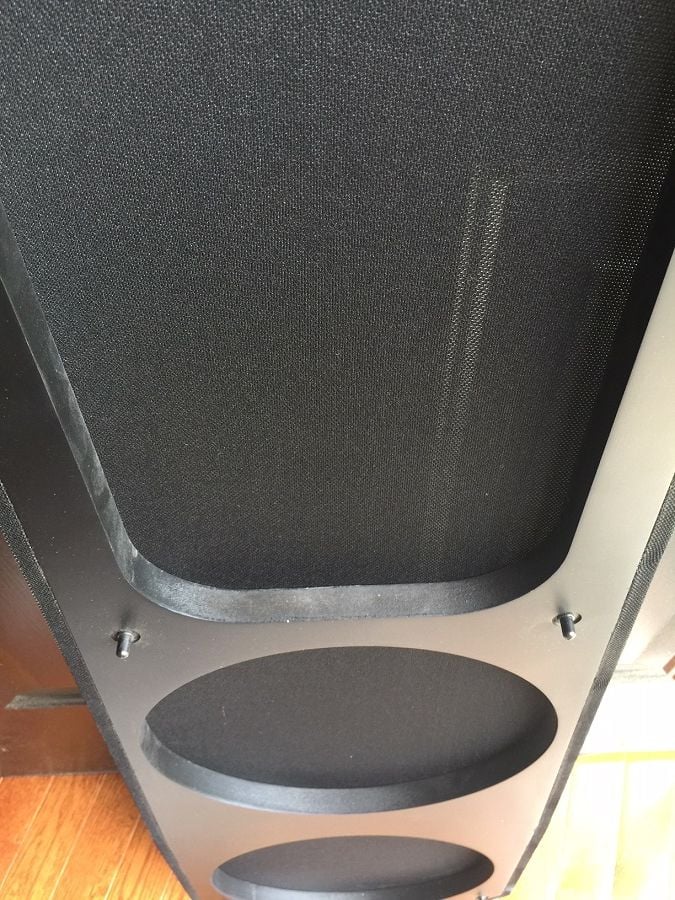

The grille frame appears to be MDF painted a smooth satin black. The frame itself is fairly thick—about ¾-inch—and the edges of the cutouts are not angled away from the drivers. Instead, they present a nice, flat, diffraction-inducing surface to the drivers, which, when combined with the fairly heavy grille cloth, may explain why I preferred to do all my listening sans grilles. The fact that the Signature SE’s driver array looks so cool with its dual AMT faceplate and black aluminum bullet-shaped phase plugs on the woofers and midbass cone drivers I’m sure had nothing to do with it. I’m a speaker professional, after all, with decades of experience. I’m above being influenced by a cool-looking driver array. Right?
Non-beveled ¾”-thick grille frame

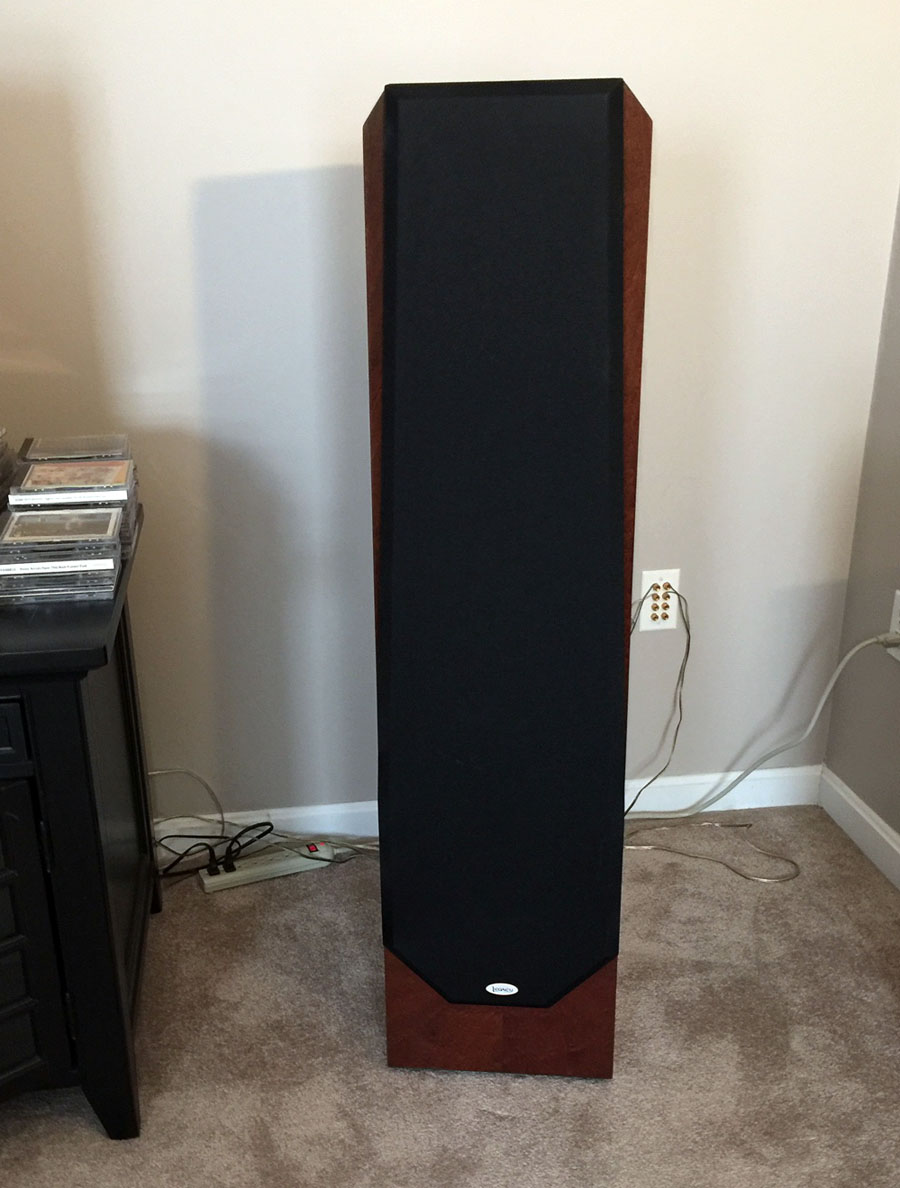

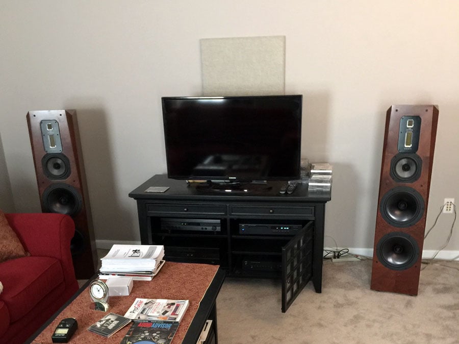

Legacy Signature SE Set-Up & Listening

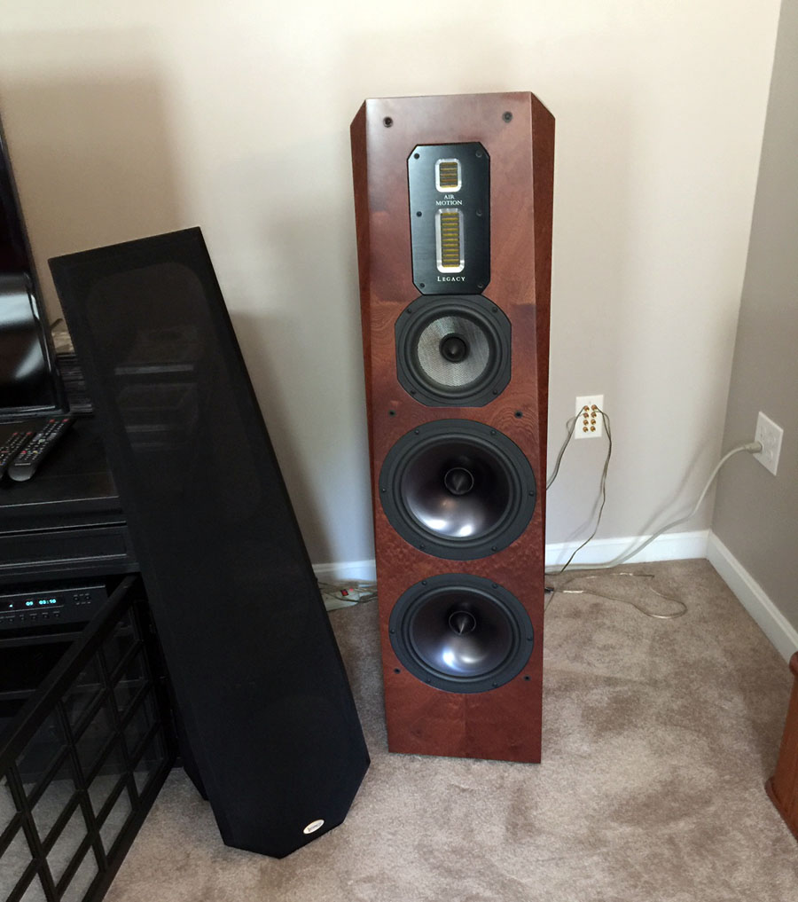

I set up and listened to the Signature SE’s in a 2-channel music system. The room was a small-to-medium sized 17 x 14 x 8 ft. These are very good-sounding dimensions, since the length (17) is a prime number, and the height (8 ft) is not a whole number multiple of either the length or width. Therefore, these dimensions do not lend themselves to troublesome, additive bass/room resonances. The room has six 2 x 3 ft acoustic wall treatments staggered around the four walls (one centered on the front wall, two each at different heights on the side walls, and one centered on the rear wall between the two windows). There is a large sectional couch for seating and the floor is carpeted. Overall, the room is just slightly on the dead side of neutral, and it sounds excellent: solid, uniform bass, good imaging and detail, very little “ringing,” but live enough to let the speakers blossom out and fill the space with organic sound. Excellent recordings, especially of small-scale ensembles like jazz trio or solo piano, can sound almost live in this room. I have tremendous confidence that this room allows equipment to sound as good, or bad, as it can.
The Signature SEs were set up about 1-1 ½ feet from the wall behind them and about 1 ½-2 feet from the sidewalls. I experimented with placement by moving them closer to the wall behind them, and I’d say there was very little change until the speakers were virtually right up against the wall. No doubt, part of that placement flexibility is because there is no rear-mounted port that is being “squeezed” up against the wall. Legacy claims the Signature SE is very tolerant of different room placements and I’d agree with that assessment.
The speakers have good horizontal dispersion and toe-in was modest—perhaps 5–10º or so. Set up this way, the speakers threw a very solid, well-defined image with a good phantom center. They sounded similar, but not identical, when seated vs. standing. The upper mid-range AMT is 1 x 4”, so its dispersion will be somewhat wider in the horizontal plane than vertically. The math indicates that a 1” radiating dimension will not be noticeably directional until 13,560Hz. (13560 is the speed of sound at sea level in inches per second. If you divide that by the radiating dimension of the diaphragm, you’ll get the CDF or Critical Dimensional Frequency, the point at which that driver becomes directional and starts to ‘beam’ its output like a flashlight.) But the 4” vertical dimension of the upper mid-range AMT indicates that it will be totally non-dimensional only below 3390Hz (13560 ÷ 4 = 3390), above which it will start to beam. The UMR AMT crosses over to the tweeter at 8kHz. So the UMR AMT restricts the vertical dispersion to a modest degree, and it’s somewhat noticeable when standing vs. sitting. It was not an issue at all when listening in the normal seated position. In this room, I am only about 10 feet from the speakers, so I am sitting in the Critical Field—neither totally far-field/reverberant nor totally near-field/direct. I have no doubt that in a larger room at a greater listening distance, this would be a total non-issue. To be clear here, this is merely an observation, not a criticism. I do all my critical listening while seated.
Associated Equipment
The rest of the system is simple but straightforward, and very high quality. The pre-amplifier/power amp combo was Parasound’s New Classic 2100 pre-amp and 2250 power amp, conservatively rated at 200/385 watts per channel 20-20k at 0.05% THD into 8/4 Ω loads, respectively. Legacy rates the Signature SE as a 4Ω speaker with a sensitivity of 92dB 1W/1M on axis. Needless to say, there was plenty of power on tap.
The CD player was the NAD 545 with Burr-Brown DACs. Considering the modest size of the listening room, this is more than enough clean, distortion-free power to ensure that the electronics never intruded upon the listening sessions in a negative way. Speaker wire was simple 14 ga. twisted-end, formed into a “J” and wrapped around the posts of the terminals. Basic Monster interconnects between the pre/power and the CD/pre. Nothing lunatic-fringe about the connectors and speaker wire, and more importantly, nothing that could even remotely be considered a defining or distracting influence on the sound.

Legacy Signature SE (no grille left pic) ; (grille right pic)
