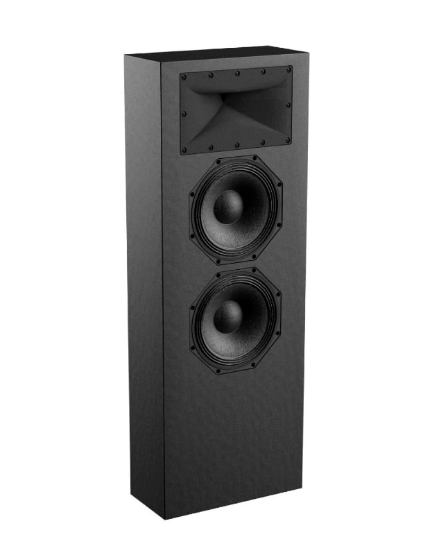

Rixos-L 2.5-way Active DSP Speaker
  • Dual 8” woofers / 1” annular driver in CSA™ waveguide
  • Max SPL 1m Long-Short: 113-120dB 80Hz to 20kHz
  • 600W rack amplifier, DSP x-over and room EQ
  • Dimensions: 36”H x 13”W x 6”D

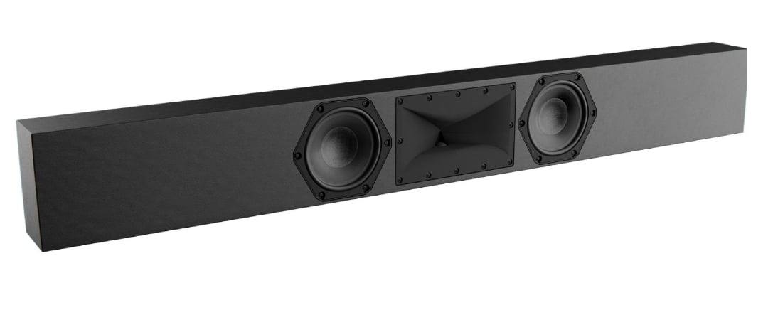

Rixos-H 2-way (H1) or 2.5-way (H2) Active DSP Speaker
  • 6.5” woofer(s) and 1” dome in CSA™ waveguide
  • Max SPL (H1) 1m, Long-Short: 104-112dB 80Hz to 20kHz
  • Max SPL (H2) 1m, Long-Short: 108-115dB 80Hz to 20kHz
  • 80Hz to 16kHz, +/-2dB.
  • 320W rack amplifier, 2-way DSP x-over and room EQ
  • 7”H x 4”D x Width Variable from 34” to 78”

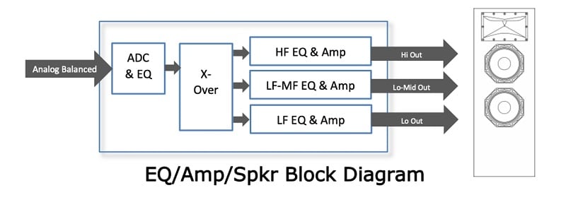

The second ingredient in Grimani’s secret sauce is powerful digital signal processing (DSP), which allows for active crossovers, more efficient amplification, and increased reliability, according to the company. By going the active route, Grimani eschews passive crossovers, which the company describes as damping-factor-killers that prevent the amplifier from exerting control over the motion of the drivers. This loss of control results in “ringing” or “time smearing” in the driver, according to Grimani. The company also points out that a passive crossover network must be tuned to the impedance of the driver it’s connected to, but the driver’s impedance will actually change while the speaker is in use because the voice coil heats up, changing the resistance of the wire. Grimani says that the effect can be substantial in home theater speakers (which are often tasked with pumping out high-SPLs) causing unintended peaks in the frequency response in the crossover region.
While ANY form of active crossover is vastly superior to passive crossovers (ones that use large capacitors, inductors, and resistors), a digital crossover is more flexible, has less noise and distortion, and is more stable over time than any analog crossover could ever be. Traditional passive crossovers, frankly, have no place in a premium cinema system loudspeaker. They introduce distortion components. They are a potential failure point. They can’t be built with nearly as much precision. High order slopes are simply not practical to build.
— Grimani Systems
DSP also allows Grimani to time-align drivers and apply frequency equalization. According to the company, typical audiophile-grade drivers might offer low distortion and excellent frequency response, but they are inefficient and have relatively low power-handling capability. In order to deliver high SPLs, typical home theater speakers are more efficient and handle more power, but with much higher distortion, and a frequency response that isn’t as smooth overall. Because movie soundtracks can have extreme dynamic range, a speaker’s ability to play loud without getting damaged is certainly of great importance, but at what cost? Grimani uses powerful DSP to combine the high technical performance of an audiophile driver with the robust build and high output capabilities of a home-theater speaker.
Because we have such powerful DSP built into our speaker, we can optimize our drivers for low distortion, high efficiency, and power handling, and not concern ourselves so much with box tuning and frequency response. We have all the signal processing we need to linearize the drivers’ response while keeping the size of the cabinet down. Ultra low distortion, ultra linear frequency response, high efficiency, and high power handling give Grimani Systems loudspeakers unrivaled clarity and naturalness of sound with all the dynamic punch you could ask for.

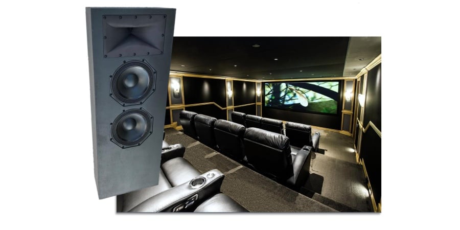

Grimani Rixos-L.jpgWith all that in mind, let’s take a look at the newest members of the CEDIA-award-winning Rixos series, starting with the Rixos-L. The new flagship of the series, the Rixos-L is a compact yet powerful 2.5-way active speaker that employs a pair of 8-inch woofers, plus a 1-inch annular (ring) tweeter in the company’s signature CSA waveguide. At just 6 inches deep, the Rixos-L can be installed either in-wall or on-wall, and is designed to function as a front-channel LCR speaker in rooms up to 600 square feet, or as a surround speaker in larger rooms. According to Anthony Grimani, the Rixos-L is intended to bring the company’s “ultra-high definition” performance into “home cinemas, media rooms, and any space that deserves dynamic sound pressures within a very shallow form factor.” As a 2.5-way active speaker, the Rixos-L is tri-amplified by a dedicated 600W rack amplifier controlled by integrated digital signal processing that handles everything from driver frequency response to room correction EQ. The Rixos-L is said to deliver “exceptional dynamics and finesse, wide dispersion, and smooth off-axis response.”
While the Rixos-L will likely find its home in a dedicated theater room, the smaller Rixos-H has a horizontal form-factor that allows it to be placed directly above or below a TV, bringing “the same patented design, philosophy, and quality that bedrocks all of Grimani Systems’ products” into smaller domestic spaces, such as living rooms, bedrooms, or anywhere that has size limitations. Like the other Rixos speakers, it’s an active multi-amplified speaker with integrated DSP and room correction EQ. The Rixos-H is said to provide “the same level of performance and technology” as the company’s other home cinema products, but in a more style-conscious package. To that end, the Rixos-H can be customized to match the width of a TV, from just 34 inches up to 78 inches wide. (The max width just so happens to match perfectly with LG’s massive 88-inch 8K OLED TV.) In a smaller space, the speaker can be configured as a bi-amplified 2-way speaker (the Rixos-H1), with a single 6.5-inch woofer and a 1-inch dome tweeter in a CSA waveguide. In larger rooms, the Rixos-H2 adds a second 6.5-inch woofer, and is tri-amplified in a 2.5-way configuration. The H2 version starts at 57 inches in width. Both the H1 and H2 versions of the speaker are just 4 inches deep and can be surface-mounted to the wall, or installed as an in-wall speaker for a more custom look. Boasting no off-axis cancellation lobes, the Rixos-H should work well in a wide variety of environments. Like other Grimani Systems speakers, the Rixos-H should also be an unusually low-maintenance product for the end user — calibration, diagnostics, and 24/7 monitoring are all managed over IP networking. How cool is that?
