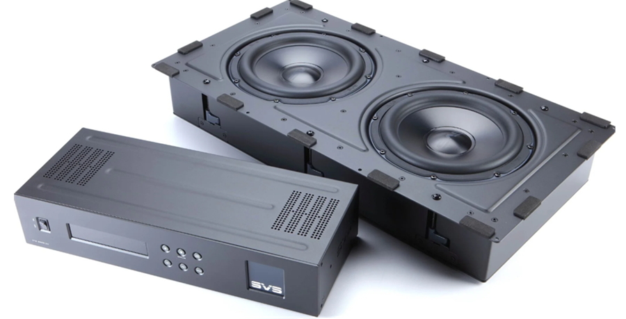

SVS 3000 in roomSVS recently announced and introduced their first architectural product, an in-wall subwoofer. Known for their high-quality, high-performing, and high-value box subwoofers, this move came as a surprise. SVS has traditionally been a direct sales company, only recently expanding into dealer networks. In-wall subwoofers typically cater to integrators, marking a significant step for SVS in partnering with integrators.
However, considering SVS's expertise in crafting exceptional box subwoofers, I wondered if their in-wall subwoofers could achieve the same level of performance. At $1,999 for a single subwoofer and amplifier, or $2,999 for two subwoofers and an amplifier, this product is competitively priced for the market, though not inexpensive. To discover my thoughts on the new 3000 series in-wall subwoofers, read on.

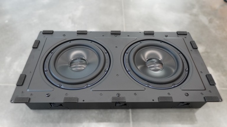

SVS 3000 In-Wall Subwoofer Unpacking Appearance and Design
The unboxing experience of an in-wall subwoofer is quite unique. It arrives in a relatively large but thin box, designed to seamlessly fit within the wall. The subwoofer itself may seem unremarkable at first glance, featuring a black metal box and a metal grill. This discreet design is intentional, as in-wall subwoofers are meant to be hidden. Despite its simplicity, the build quality of this SVS subwoofer not only matches but exceeds its price point.
SVS Sub profile

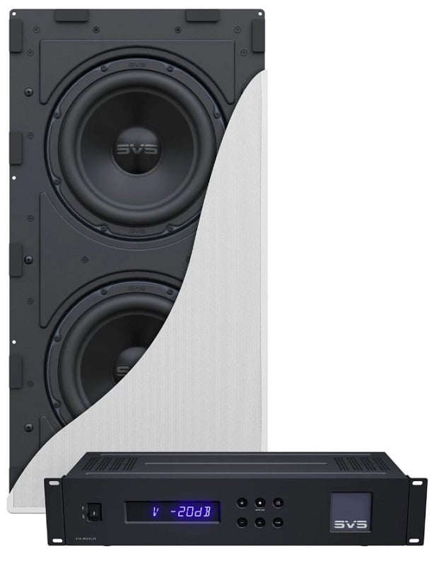

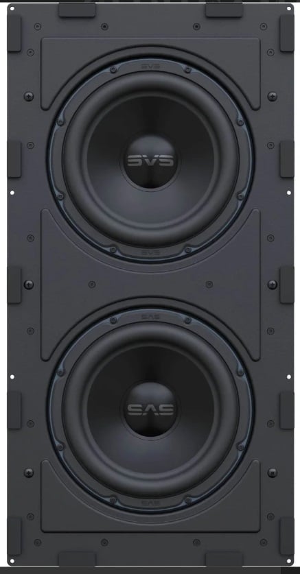

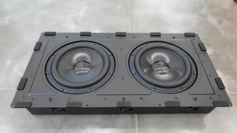

On the front plate, two custom-designed 9" drivers catch your attention. The additional inch in diameter aids in increasing displacement while maintaining a compact size to fit between standard studs. The front plate is also equipped with dog legs and holes, facilitating easy attachment to studs when proximity  to the studs becomes a concern for the dog legs—an excellent feature that I wish more in-wall subwoofers incorporated.

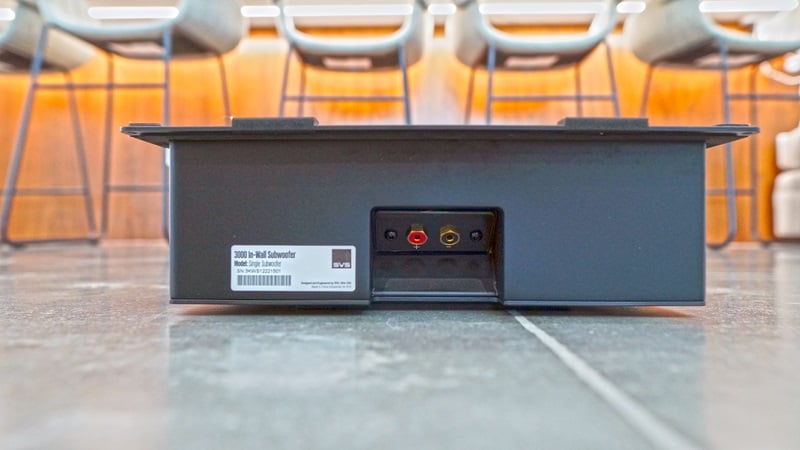

Terminal
A tap on the back box reveals a compact volume and solid damping. SVS's use of aluminum for certain parts of the back box allows for a thinner enclosure wall, maximizing internal volume. The enclosure cleverly combines MDF and aluminum, leveraging MDF for superior damping and aluminum for the front and back to reduce thickness, accommodate larger drivers, and create a thinner bezel/baffle on the wall.
Both drivers are active, in a sealed enclosure. This design choice necessitates that the drivers handle significant power and exhibit high excursion, evident from their large rubber surrounds. The subwoofer's appearance exudes a business-like seriousness, and while SVS claims that the drivers have optimized motor assemblies to deliver powerful impact, some of SVS’s marketing materials feel somewhat exaggerated. It's important to note that, despite the large roll surrounds, these drivers may not achieve the excursion of deeper drivers found in most box subwoofers within a similar price range, primarily due to space limitations.
Amp Front

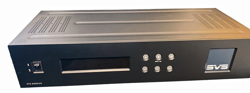

The included amplifier, SVS's proprietary Sledge STA-800D2C, boasts 800 watts RMS and 2500 watts peak, powered by discrete MOSFET output devices. Throughout testing, the subwoofer amplifier remained cool. The Sledge amplifier is compatible with SVS's smart control app, allowing convenient adjustment of various parameters. The app provides three bands of PEQ, suitable for most users to achieve excellent sound—a feature I appreciate and wish all in-wall subwoofers possessed. Additionally, the amplifier supports the addition of a second subwoofer, offering an economical dual subwoofer solution.
From an installation standpoint, SVS has taken an approach that I admire but one that presents challenges. By maintaining a compact subwoofer enclosure, it works well in both existing and new constructions. Unlike many in-wall subwoofers that mandate a back-box installation before drywall placement, SVS eliminates this requirement. However, the tradeoff is a smaller box size. While other in-wall subwoofer boxes may reach 5 feet in height, this box measures less than 27" tall. This makes installation in a retrofit situation possible, but it also means that the small box volume pushes the Fs way up into the midbass and limit low bass output. The actual impact on sound quality is yet to be discussed. Read on to discover my thoughts on this matter.

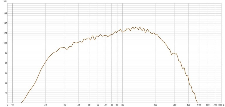

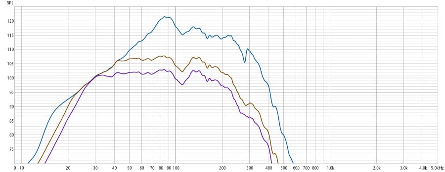

 103dB SPL Freq Resp
Figure 1: Linear Sweep

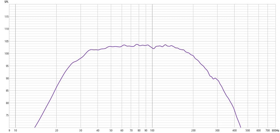

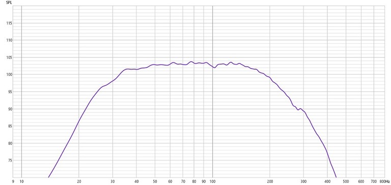

The frequency response measurement at 103dB showed a fairly flat response and a -10dB point at 23.6hz.  The upper end of the response was subject to a fixed lowpass filter inherent in the subwoofer amplifier (and in most subwoofers).
106dB SPL Freq Resp
Figure 2: High output Sweep

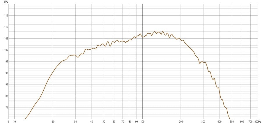

In the above graph, I have increased the drive level by around 3 dB.  The first measurement shows the response near its limit for a flat response and the extra 3dB shows that the SPL increased above 65hz only.  Everything below this point stayed the same in output, showing the effect of compression.
In fact, an accidental sweep at around 115dB (or what should have been around 115dB) produced a fairly ugly looking graph that does a good job reflecting what the compression behavior is like.

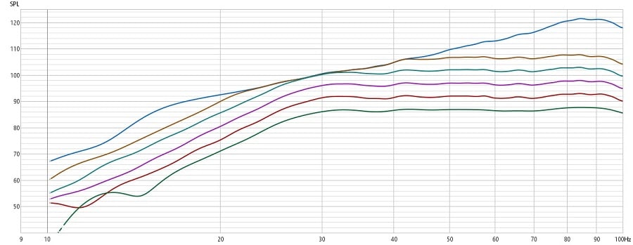

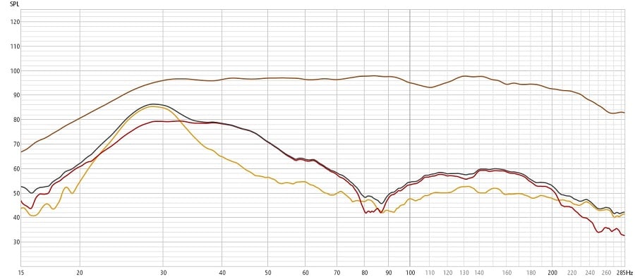

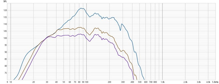

I did a compression test from 85dB through 105dB, where I saw the 3dB change in response, indicating the compression limit.  However, I also swept at 115dB, by accident, as mentioned before, and so this graphic reflects that behavior, which makes very clear what is happening between its fully linear range and its maximum output range.  That big peak around 80hz is due to the resonance frequency of the box/driver giving rise to a small area of maximum efficiency.
Figure 4 Compression Sweeps
Figure 4: Compression Sweeps

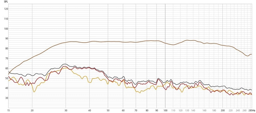

In addition, I have included the distortion of the SVS subwoofer.  By 105dB the distortion below 30hz was approaching 100%, so I have included distortion at 85dB and 95dB to make clear how the distortion is rising.  As can be seen, the driver runs out of excursion around 30hz, which is where we see the distortion rise dramatically.  Below 30hz the subwoofers limiters and high pass filter are providing protection to prevent as much overloading.  When pushed to 115dB it was found that distortion rose below 30hz to near 100% 3rd harmonic and the built in protection was insufficient to prevent this rise.

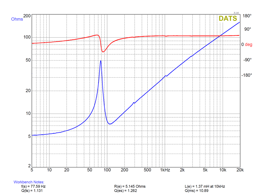

I performed an impedance sweep using the DATS V3.  It showed an impedance peak at about 77hz, the Re is 5.145 ohms, and the Le is 1.37mh.  All of this shows good behavior with no obvious signs of problems or resonances in the operating range.  The two take-aways are that with such a high Fs, the subwoofer operates at or below it’s Fs nearly all of the time.  The net effect of that is that distortion is substantially lower at that resonance frequency, which we normally prefer to have near the low end of its operating range.  Second is that the Re is higher than I expected, I had assumed this would have a lower impedance, but with the amplifier being a required accessory, this is not a concern for the end user.  Finally, the inductance is low enough that users need not worry about excessive rolloff or distortion caused by the inductance.  That likely helps explain the very good midbass efficiency.
Impedance Curve
Figure 7: Impedance Sweep

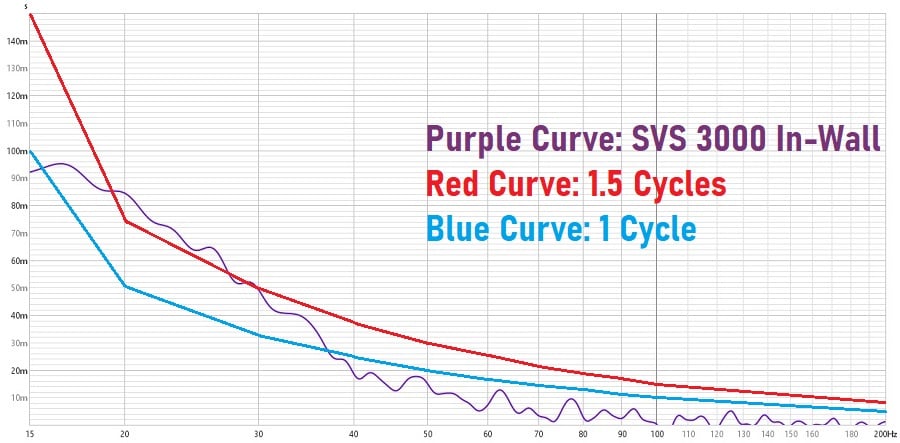

The group delay measurements exhibit generally satisfactory performance down to 60Hz. However, below this range, there's a noticeable escalation in group delay. Specifically, the SVS subwoofer surpasses one cycle of group delay around 35Hz to 40Hz and exceeds two cycles by 30Hz. While this level of group delay is relatively high for a sealed subwoofer, it stems from various design decisions made by the SVS team.
Firstly, a significant EQ boost at low frequencies contributes substantially to the observed group delay. Additionally, it's probable that a highpass filter is employed on the subwoofer for protection purposes. While this arrangement represents a compromise, it's crucial to acknowledge that a subwoofer prone to distortion would present a more significant issue than one with elevated group delay.
Although some may argue that SVS subwoofers tend to exhibit excessively high group delay, not all reviewers, even within Audioholics, share this perspective on its audibility or detrimental effects. Rectifying the group delay issue would likely necessitate compromising performance in more perceptible ways. The current design, with its small box volume and substantial EQ adjustments, seems optimized given the circumstances.
While it's important to note the presence of elevated group delay, it's equally vital to recognize that there are other concerns of greater significance. Anyone purchasing and using this subwoofer really needs to be more focused on the subwoofer integration, frequency response, and at limit behavior.  These group delay concerns would only likely be of any consequence under the most ideal of conditions. Overall, I consider this issue a minor quibble and believe it represents an appropriate design choice considering the available alternatives.
