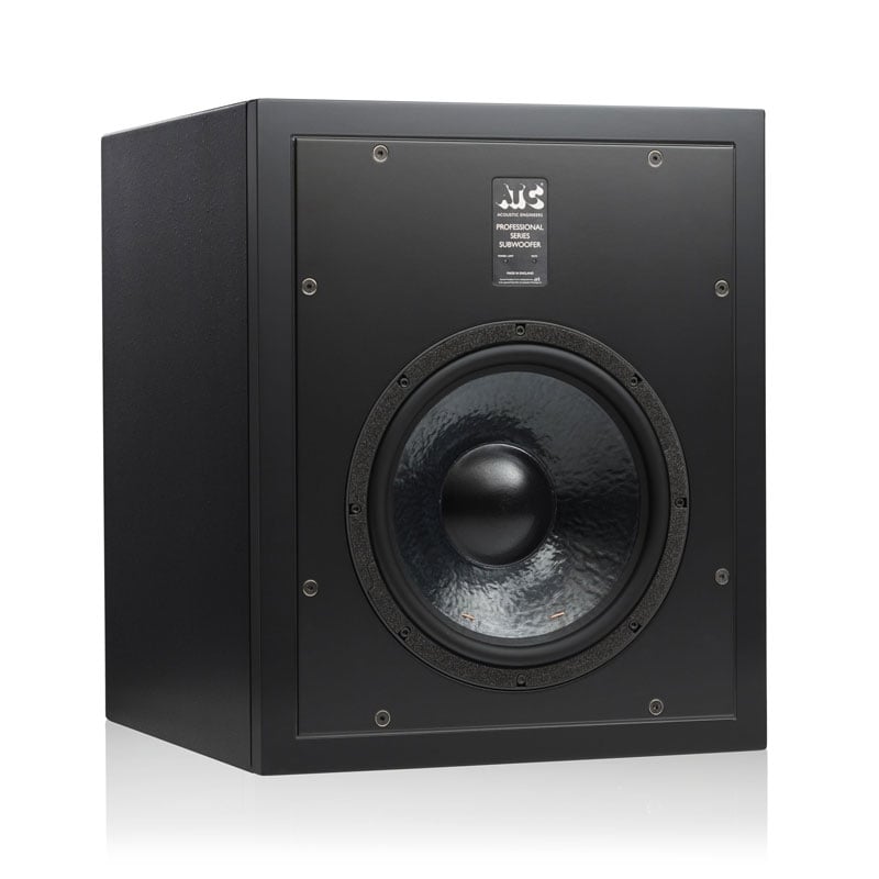

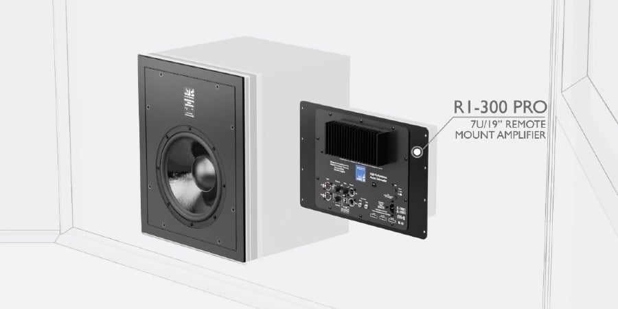

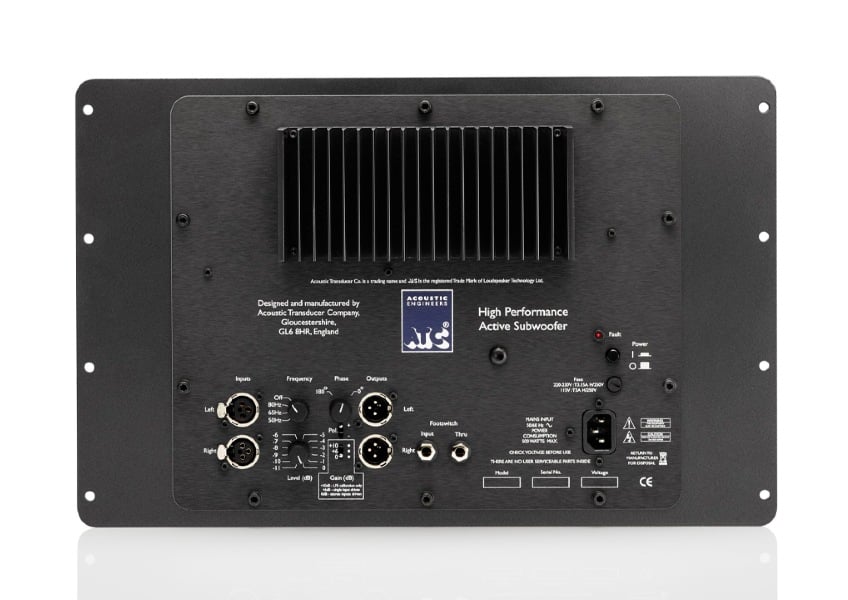

ATC got its start in the 1970s making professional studio monitors, and the company still makes gear found in some of the world’s best pro audio facilities. Although the British manufacturer now also makes speakers and electronics for the home audio market, the new SCS70iW Pro is really intended for studio use. But that doesn’t mean that it wouldn’t make a killer home theater sub, especially when you consider that it’s destined to be used for mixing and mastering immersive audio formats such as Dolby Atmos. The SCS70iW Pro is an in-wall active subwoofer with an included outboard amplifier and a custom-built 12-inch driver. At almost 20 inches deep, this is obviously not a drop-in solution for an existing home theater, but if you’re in the fortunate position to be designing a home theater from scratch in a relatively large space, the new ATC has a lot to offer. The 12-inch driver was designed in-house, and features a 30mm magnetic gap, 50 percent longer than any other offered by ATC. The sub’s long-gap and short-coil configuration is the ultimate implementation of a long-standing ATC design feature, and promises to both minimize distortion and deliver the high linear excursion required to produce accurate and dynamic reproduction of the lowest four octaves of the audio band. The long-gap/short-coil configuration also ensures that the voice coil is always surrounded by the steel motor structure. This reportedly maximizes cooling, reduces power compression, and improves reliability. According to ATC R&D Manager Richard Newman, “Generating a high level of magnetic flux over such a long gap required extensive FEA computer modeling, and the resultant 6-inch N48M Neodymium magnet is the most powerful ever assembled by ATC and a first for the company.” A large, flared vent running through the middle of the motor structure minimizes turbulent air noise within the driver and increases voice coil and motor cooling. Like the impressive REL HT/1510 Predator recently reviewed by James Larson, the ATC SCS70iW Pro eschews DSP and electronic equalization, relying instead on transducer engineering and a relatively large cabinet. The result should be a reduction in phase shift and group delay. ATC says this leads to “a more balanced and coherent experience for the listener, extending the low-frequency response without masking details or changing the tonal character in the upper bass/lower mid-range.” The sub is powered by an outboard 300-watt class AB amplifier that has been optimized to the requirements of the driver. Dual balanced inputs and outputs provide connectivity for both stereo and multi-channel audio systems, and allow for daisy-chaining multiple subs. The amp plate can be installed in-wall near the subwoofer, or in a separate equipment rack. Both the sub and the amp are hand-built in England, and covered by a 6-year warranty. When the subwoofer was first announced last summer, ATC’s American distributer had this to say:

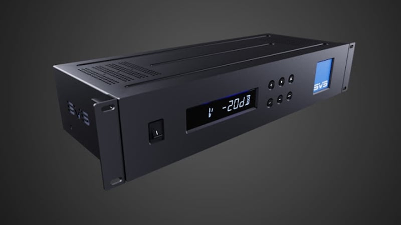

rather than later. Like the aforementioned ATC sub, the SVS In-Wall 3000 is a two-piece system, comprising an
in-wall subwoofer with dual 9-inch drivers and a separate rack-mountable amplifier unit with built-in DSP and crossover
controls. The settings for volume level, crossover frequency, and many other
adjustments can be controlled by the full-featured SVS app when the unit itself
is out of reach. The amp is conservatively rated at 800 watts RMS, with a peak
power of 2,500 watts, according to SVS. The amplifier platform combines Class D
efficiency with the high-current output of discrete MOSFETs, all controlled by an
Analog Devices DSP. According to SVS, the amp has no trouble sustaining
high-current output without clipping or bottoming out, so even difficult
low-frequency playback sounds effortless. SVS says that the In-Wall 3000’s amplifier is not only powerful, but

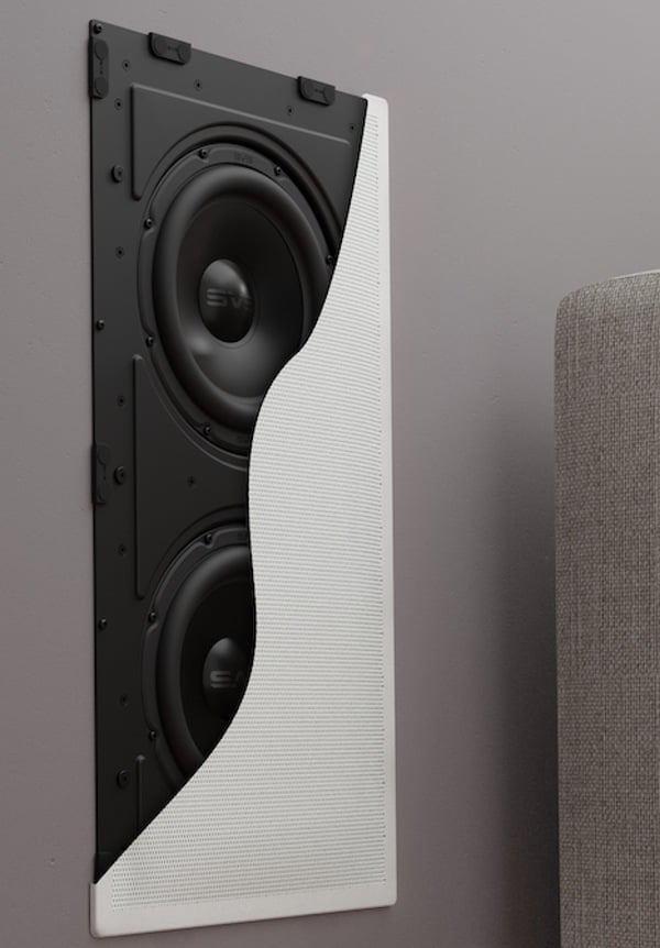

The In-Wall 3000 Sub’s dual 9-inch woofers are housed in a sealed aluminum and MDF enclosure that fits into a standard stud bay, making it an easy choice for both retrofit installations and new-construction home theaters. SVS says that the enclosure is virtually resonance-free, ensuring clean low-frequency output with low distortion. The sealed box features dog-leg clamps for fast and easy installation, and also has screw holes for direct mounting to a stud. A user template is provided for making a precise cutout of the mounting hole in existing drywall, while an optional pre-construction kit takes the guesswork out of installations in new construction. The SVS In-Wall 3000 will be available to order early next year, and should begin shipping during Q1 of 2023.

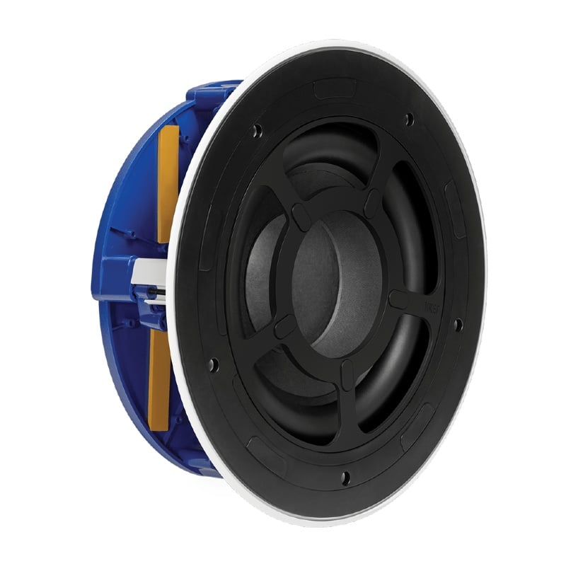

KEF Ci250RRb-THX ($1,499.99)

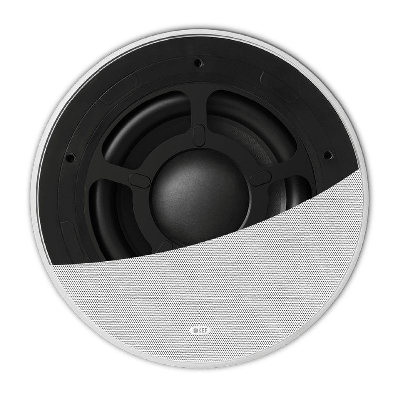

The KEF Ci250RRb-THX is billed by the British company as “The Extreme Architectural Subwoofer.” This in-ceiling sub is “engineered to deliver incredibly accurate and powerful bass… (with) exceptional depth, with the accuracy needed for an epic music, movie, or gaming experience,” according to KEF. The Ci250RRb-THX features an extra-long-throw 10-inch bass driver with a massive 150-oz magnet, promising both tremendous power and the ability to reproduce fine detail. Thanks to that enormous magnet and custom-designed motor system, the Ci250RRb-THX digs all the way down to 20 Hz (-6dB) and has a maximum SPL of 109dB. As its name would suggest, the Ci250RRb-THX is certified THX Ultra. But to meet this certification, the user must install a 4-pack of the subs. And since the Ci250RRb-THX is a passive design, a separate amplifier is required. KEF recommends its own KASA500 ($1,100), a powerful, DSP-controlled Class-D dual 250-watt amplifier. A single KASA500 can power four Ci250RRb-THX subs, with the whole system meeting the THX Ultra standard. When the amp is used to power just 2 of the subs, the performance meets the THX Select standard. The KASA500 offers both line-level and speaker-level inputs with optional high pass filters for installations where bass management isn’t being handled by a preamp/processor. Perhaps the most impressive thing about the Ci250RRb-THX is just how small and visually inconspicuous it is. In-ceiling subs don’t have to be quite as shallow as their in-wall counterparts in order to be retrofitted into existing spaces, but the Ci250RRb-THX is still just 6 inches deep. What’s more surprising is that the sub’s circular footprint is only about 13.5 inches, and the hole you need to cut in your ceiling to accommodate one is just 11.8 inches in diameter. Furthermore, the sub features what KEF calls a paintable UTB (Ultra-Thin Bezel), which essentially means that the rim around the speaker is as slim as possible and casts virtually no shadow. The magnetic grille is also paintable. The Ci250RRb-THX is even IP64 certified, meaning it can withstand occasional splashes and resists the ingress of dust. Looking for the perfect in-ceiling subwoofer for your pool house? Neither am I, but KEF has you covered just in case. The Ci250RRb-THX was only just announced at the end of September 2022, and is currently on backorder on KEF’s US website. However, it appears to be available to order from Best Buy, of all places.
