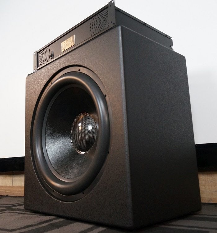

This is going to be a short section because the 18Sub was meant to be hidden behind a baffle wall. In other words, appearance wasn’t a very large part of the design criteria. Nonetheless, it doesn’t look terrible, and if it had to be out in the room, it wouldn’t be that off-putting if placed in a corner. One of its charms in this respect is that it is a relatively shallow sub, having only a 15” depth, which perhaps makes it the most shallow 18” home audio sub on the market today. So it will not jut out very far into any space that it is placed in. The finish is a rough matte black that is made for durability rather than ravishing good looks. The 18Sub has circular notches at the top that is made to stack either the 410 speaker or other 18Subs on top. All of the edges and corners are rounded so there are no hard edges. Visually, the high point of the 18Sub is the cone, which has a smooth texture that leads into a carbon fiber-esque dustcap. The surround is an imposing large half-roll of rubber that makes this sub look like it means business. There is no included grille, since the screen or wall material is expected to fill that role.

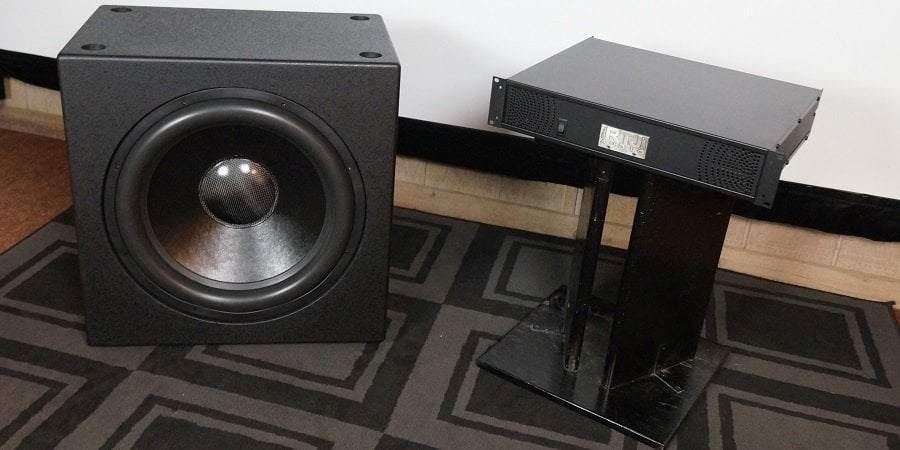

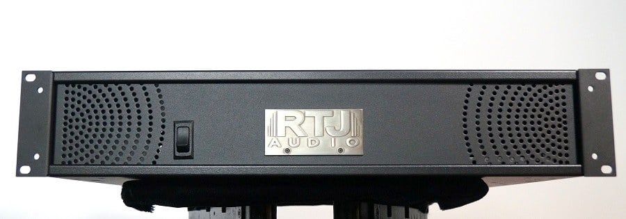

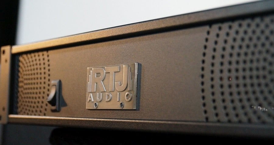

The 18Sub is powered by an outboard amplifier that does look surprisingly stylish, so at least it gives you a neat-looking piece in your equipment rack. It is a black amp with a front vent hole pattern that looks like two bursts coming from the sides of the unit. There is a cast metal plaque with the RTJ name in a brushed aluminum texture on the front that looks quite nice. There is a similar plaque mounted on the back of the subwoofer enclosure above the binding posts - it is an attractive piece but why put it in a location that it will seldom be seen? Either way, it is a nice touch and attention to detail.

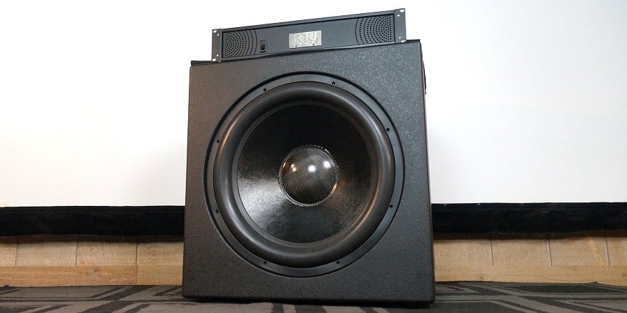

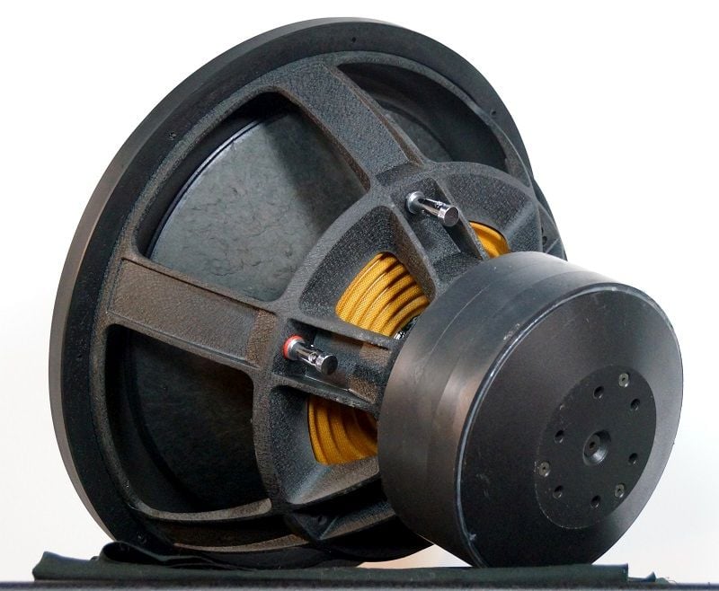

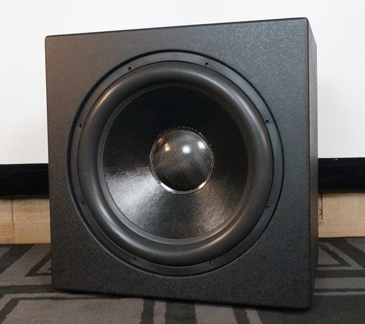

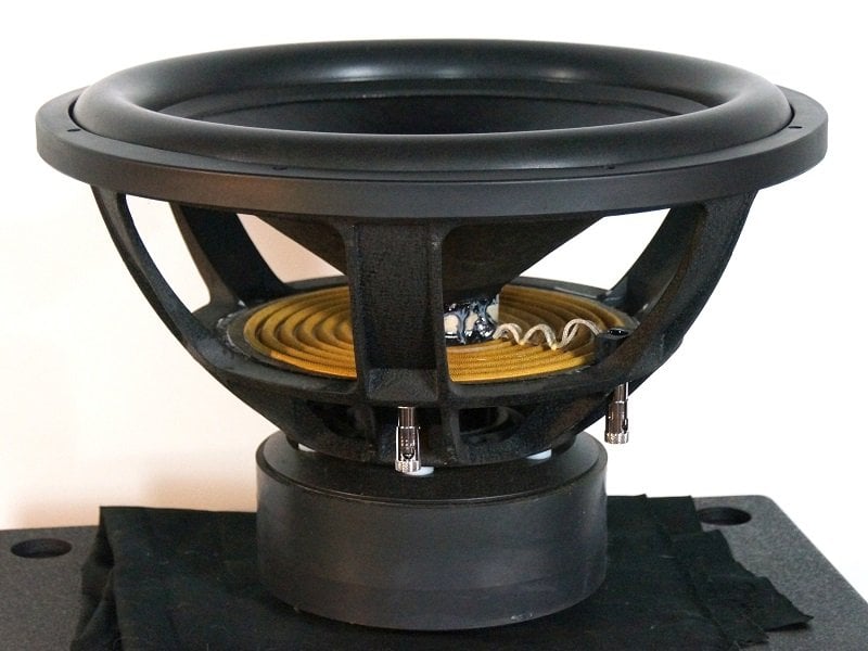

The RTJ 18Sub is not an overly complex design on the surface: it is merely a long-throw 18” driver in a small sealed enclosure that is powered by an outboard amplifier. This simplicity is a bit deceiving, however. The heart of this sub, the driver, is a state-of-the-art powerhouse of transducer engineering. It combines two advantageous elements that are rarely seen together: long-throw/high power-handling combined with low inductance. The reason why these two traits so seldom go together is that drivers that have a long throw and high power-handling need a lot of voice coil in order to achieve that end. However, lots of voice coil usually creates a lot of inductance. Inductance is when the motion of the voice coil within the fixed magnetic field generates a current that itself produces a magnetic field that has an opposing polarity with respect to the original magnetic field. The induced magnetic field degrades the linear travel of the voice coil, and what typically occurs is greatly diminished bandwidth that reduces upper and lower frequency output but increases some sympathetic resonance frequency. The result is a very peakish frequency response with greatly increased distortion as the frequencies move further away from the peak. In other words, high inductance means low fidelity.
Inductance is measured by
units of henries, termed “H”, which is the ratio of the voltage to the rate of change of
current. Loudspeaker drivers term the amount of inductance as “Le” and have
inductance values in the milliHenry range - mH. RTJ claims that the driver used in the 18Sub has is less
than 1mH. To put that into perspective, most long-throw, high power-handling
drivers would normally have Le values of around 4mH, give or take a milliHenry.
Higher inductance drivers in this category might have Le values of up to 8mH,
and lower inductance drivers of this type might have 2mH. For a driver that has 36mm of Xmax (one-way
linear travel) and over 2,000 watts of power-handling such as the RTJ 18”, a
1mH Le is astoundingly good. That should yield a very flat response with
extremely low even-order harmonic distortion. The RTJ 18” driver should have
excellent fidelity characteristics along with tremendous output potential.

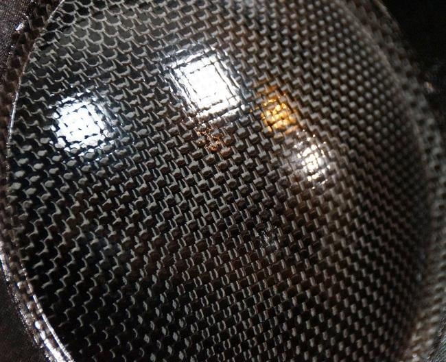

The driver itself weighs about 60 lbs. which is mostly motor. The motor has a 3” diameter voice coil that hangs in a gigantic magnet structure that uses three 1” thick discs that have an 8” diameter. The moving assembly is attached to the heavy-duty cast aluminum basket by a 10” diameter spider and a bulbous half-roll surround that has a 2” width and 1” height. That caliber of suspension ought to enable the cone a tremendous amount of throw, and, as was mentioned before, a 36mm Xmax gives the 18Sub driver one of the longest linear excursions from any commercial subwoofer available today.

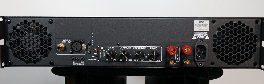

The driver is given 2,400 watts RMS courtesy of an outboard class-D amplifier. The amp itself is not exactly feature-rich and expects the system to be fine-tuned from an exterior processor. It only has controls for gain, low-frequency boost, crossover frequency, and a delay up to 20ms. There is also a switch for always-on, auto-on, and off/12V trigger. The front panel has a traditional on/off switch. For connectivity, it has RCA and XLR inputs as well as a 12V trigger input and output. 2,400 watts is a lot of power and thus potential for heat generation, so the amplifier is well-ventilated and has two active fan exhausts on the rear. Heat dispersion is one of the major advantages of outboard amplifiers and is a real benefit for an amp with so much power output potential. In typical subs with plate amplifiers, much of the heat produced by the amp can become trapped in the subwoofer enclosure along with heat produced by the driver, but with an outboard amplifier, heat dispersion can be much better managed by placing the amp in an area with good ventilation. Of course, heat is the enemy of long-term reliability in electronics, so using an outboard amp should prolong the life of the system.

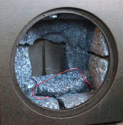

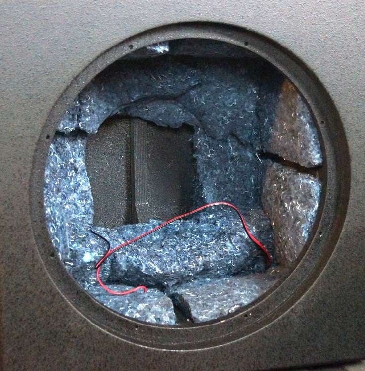

The enclosure is a simple sealed box with the aforementioned attribute of a relatively shallow depth of 15”. This was done so it could better fit behind more baffle walls in installs with acoustically transparent screens. As was said before, this is a subwoofer that was meant to be heard and not seen. The cabinet is a rugged affair that uses baltic birch which is much stronger than the standard MDF used in sub cabinets. It has a 2” thick front mounting frame and 1” thick paneling and braces. Four lengthwise braces run from front to back of the enclosure. The cabinet is packed with denim insulation which is one of the most effective acoustic damping fills available. It uses thick rubber rings for feet. This is a very heavy-duty cabinet, but it has to be since it has to contain the tremendous amount of backwave pressure from such a powerful driver. It needs to stop any significant cabinet vibration, especially since this enclosure is meant to have other modules stacked on it.

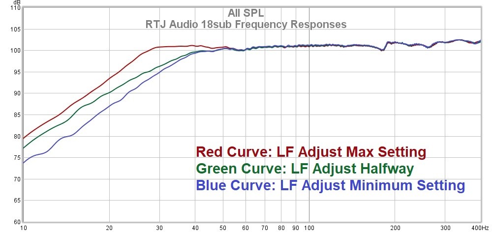

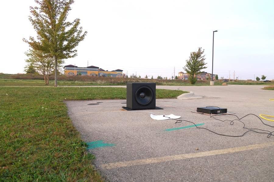

Testing on the RTJ Audio 18Sub was conducted with the microphone facing the woofer at a 1-meter distance and then scaled back to 2-meters in our graphs by subtracting 6dB in output. The temperature was recorded at 62F degrees with 84% humidity. The subwoofer’s gain was set to maximum, phase was set to 0, and the low pass filters were left off.
The above graphs show the measured frequency responses for the RTJ Audio 18Sub subwoofer. Here we see a traditional sealed response shape which is unusual since most manufactured sealed subs use a high-pass filter for protection which makes for a steeper roll-off on the low end. The RTJ driver is such a robust unit that it doesn’t need as much protection from over-driving as most sealed subs. We also see a very neutral response that extends well past 600Hz. In fact, it maintains a flat response out to 600Hz- such a wide frequency band for a subwoofer that it could easily be used as the bass driver in a full-range three-way loudspeaker if desired. That is quite a feat for a long-throw 18” sub with a low resonant frequency, but it is one of the advantages of having such incredibly low inductance. Our graph shows the difference that the LF Adjust knob makes between the minimum, maximum, and mid-way settings. The minimum and mid-way settings look to change the slope of the low-end roll-off, whereas the maximum setting extends the knee of the response from 40Hz down to below 30Hz. The level of room gain should determine the level of boost that you set the LF Adjust to, as well as your preference for deep bass.

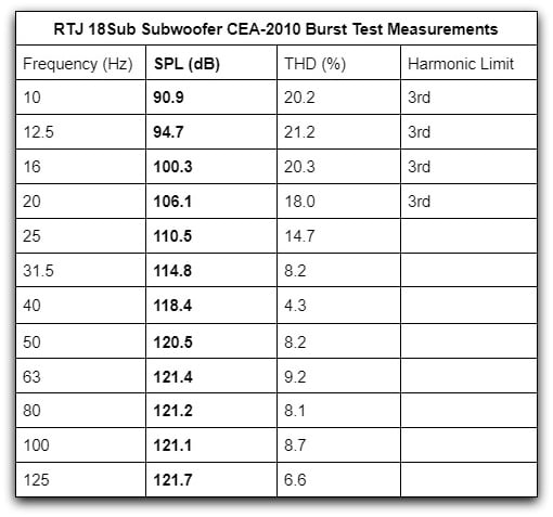

The above CEA-2010
measurements are short-term bursts that show the subwoofer’s clean peak SPL
before heavy distortion sets in. Our measurements have been referenced to
2-meter RMS, which is 9dB down from the standard requirement for the
measurements to be shown at 1-meter peak. However most publicly available
CEA-2010 measurements are shown at 2-meter RMS, so we followed that convention.
The performance demonstrated here from the 18Sub is formidable with output
exceeding 120dB through the entire mid-bass band along with great deep bass
output as well. There are plenty of ported subs that can not achieve these deep
bass numbers, but that is what can be had from such a high-displacement driver.
This subwoofer punched with tremendous force in my listening sessions, and here
we can see why. This level of performance easily earns this subwoofer our Bassaholics ‘Extreme’ room size rating making it suitable for rooms of 5,000 cubic feet.

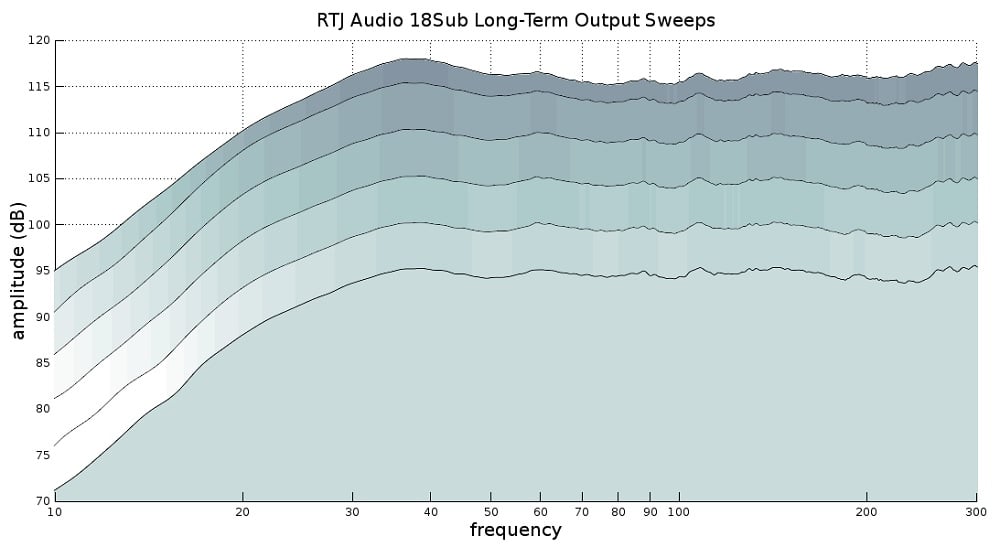

Testing for long-term output compression was done by first conducting a 20-second sweep tone where 50Hz hit 90 dB with the subwoofer 2 meters from the microphone. We then conduct further 20-second sweeps by raising the gain by 5dB until no more output could be wrung out of the subwoofer. These tests show us the long-term continuous headroom that the subwoofer is capable of. Here we see more tremendous numbers from the 18Sub which achieves a continuous 115dB+ at 30Hz and above. The response shape does change a bit above 115dB, and there we can see that natural response of the driver in the cabinet, and that DSP does do some response shaping at lower drive levels. There is a small hump just under 40Hz that is probably telling us that the enclosure is just a tad smaller than optimum. However, the driver is so powerful that it isn’t badly penalized by being housed in this small enclosure, and it still has tons of headroom at all frequencies. There is hardly any frequency-specific compression at all, a rarity among subwoofers that I have tested. This sub keeps the same response no matter the drive level; nice!

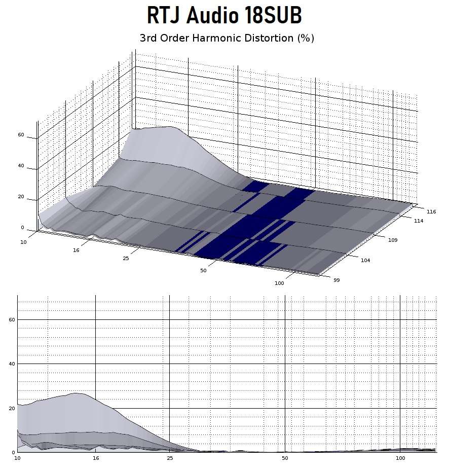

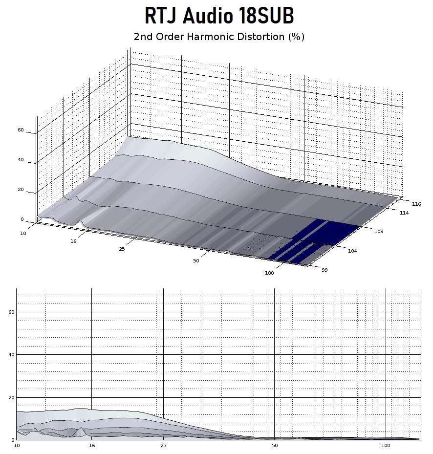

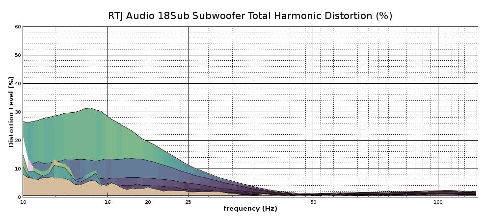

The above graphs show the corresponding total harmonic distortion to the long-term output graphs. Essentially, they depict how linear the subwoofer remains for the corresponding drive level seen in the long-term sweeps. The quantity being measured is how much of the subwoofer’s output is distortion and is shown here as a percentage. The 18Sub has so much linear excursion that it doesn’t run into significant deep bass distortion until the highest drive level. Taking the gain down by a few dB ensures that distortion will never be audible at any frequency. At that point, the subwoofer plays very clean bass, and at nominal levels, the bass was so clean I wasn’t able to capture a reliable distortion reading above the environmental noise floor that in many instances still put it at less than 1%THD. At the highest drive level, the sub is still quite comfortable above 30Hz, meaning most music can be played as loudly as you want without significant distortion. At the highest drive level, the only thing that will distort in mid-bass ranges is your hearing as your eardrums implode. This is extremely clean bass that most outrageously expensive ‘audiophile’ brand subs could only hope to aspire to.
The above graphs depict measurements of the constituent harmonics from the long-term output sweeps and are what the total harmonic distortion measurements are composed of for the 2nd and 3rd harmonics. These individual harmonics can give us a clue as to what might be the cause of some quirk or non-linearity. We are only showing the 2nd and 3rd here because they more or less reflect the higher even-order and odd-order behaviors, although higher-order harmonics tend to be much further down as a percentage of distortion compared to the second and third.
One of the principal causes of even-order distortion in subwoofers is inductance, and we do see some even-order distortion quantities in lower bass, even though the 18Sub has very low inductance. I would attribute the cause as being the very small enclosure. There is not a lot of space for the internal air to move which creates a lot of backpressure, especially at lower frequencies. This causes a slight imbalance of outward excursion to inward excursion thereby giving rise to even-order distortion. It isn’t a tremendous amount of distortion, and for the same drive levels, the odd-order distortion is going to be a lot more audible, so this is more of a point of academic interest. Odd-order distortions are very low until we get below 30Hz at very high drive levels where the driver is reaching the end of its linear excursion. It can move a lot of air, and even at the maximum drive level, the distortion levels aren’t massive.

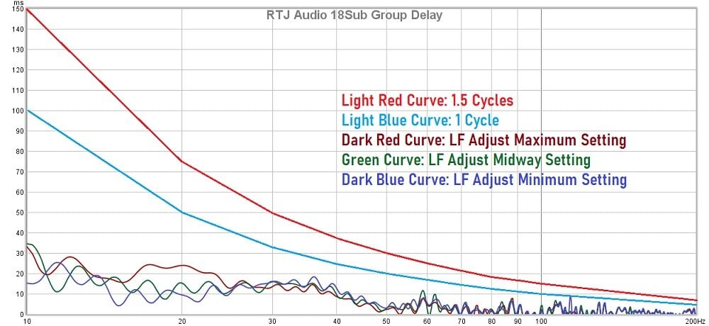

Group delay is the measurement of how much time it takes for individual frequency bands of an input signal to be produced by the speaker. It can indicate that some frequency components are developing slower than others or are taking longer to decay. It is generally thought that 1.5 sound cycles are needed for group delay to be audible at bass frequencies, although there is an argument that group delay should remain under 20ms to be completely unnoticeable, but that is likely meant for mid and upper bass frequencies.
The 18Sub turns in an outstanding showing here, among the best group delay measurements we have ever seen. Group delay hovers at or below 10ms until we get lower than 40Hz. There is nothing even remotely audible in this set. This subwoofer is as sharp as a razor blade much as I heard in listening to it on any content. One point of academic interest is the blip at just below 20Hz in the maximum LF Adjust setting where we can see the equalization causes just a tad extra delay there, as all filters will do, but this is very mild compared to what I see from most filters or equalization on subwoofers. Overall, the time-domain behavior is nearly ideal here. Anyone who is obsessive about the transient response from their subwoofer has a real champion in the 18Sub.
