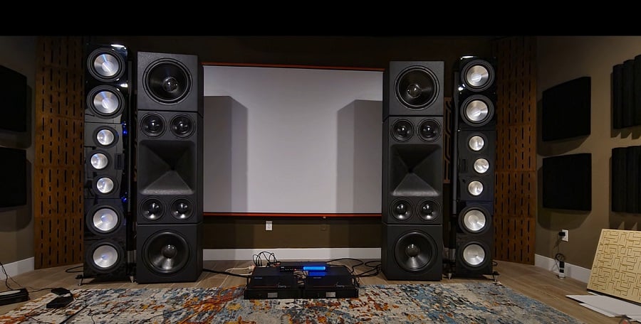

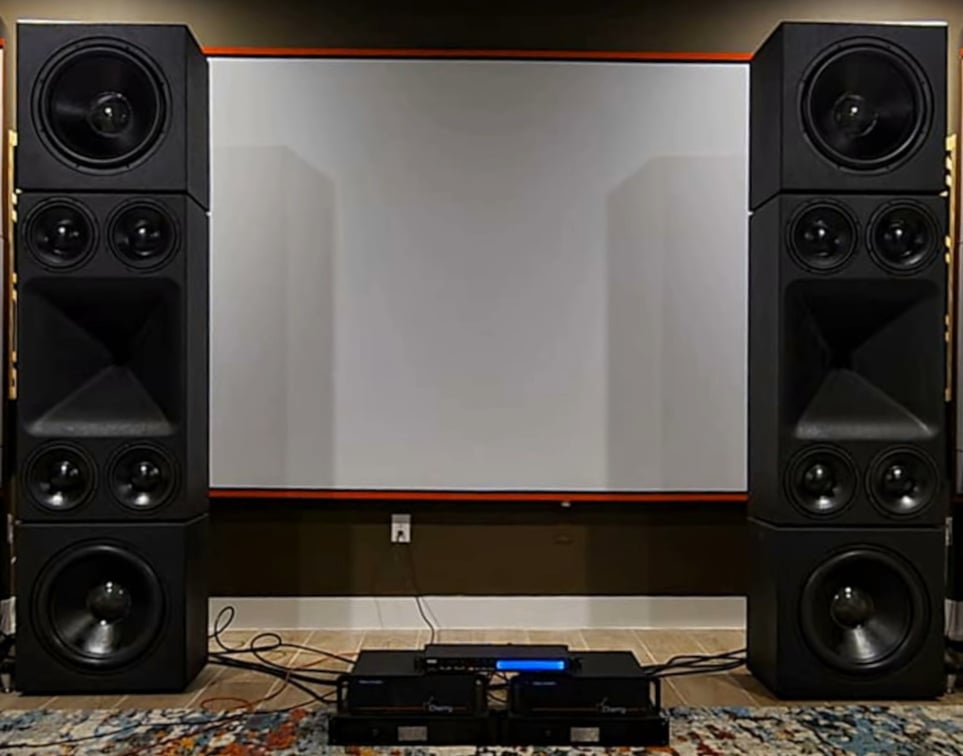

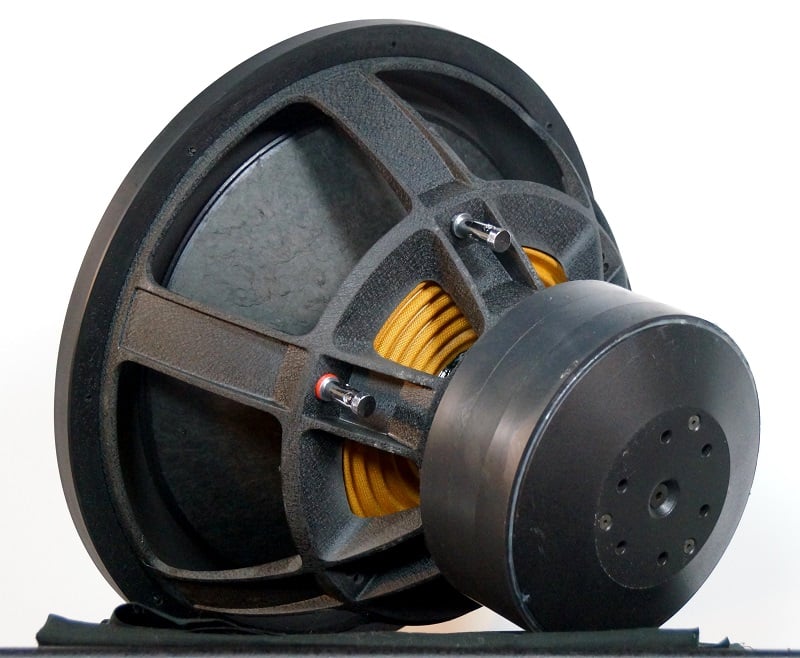

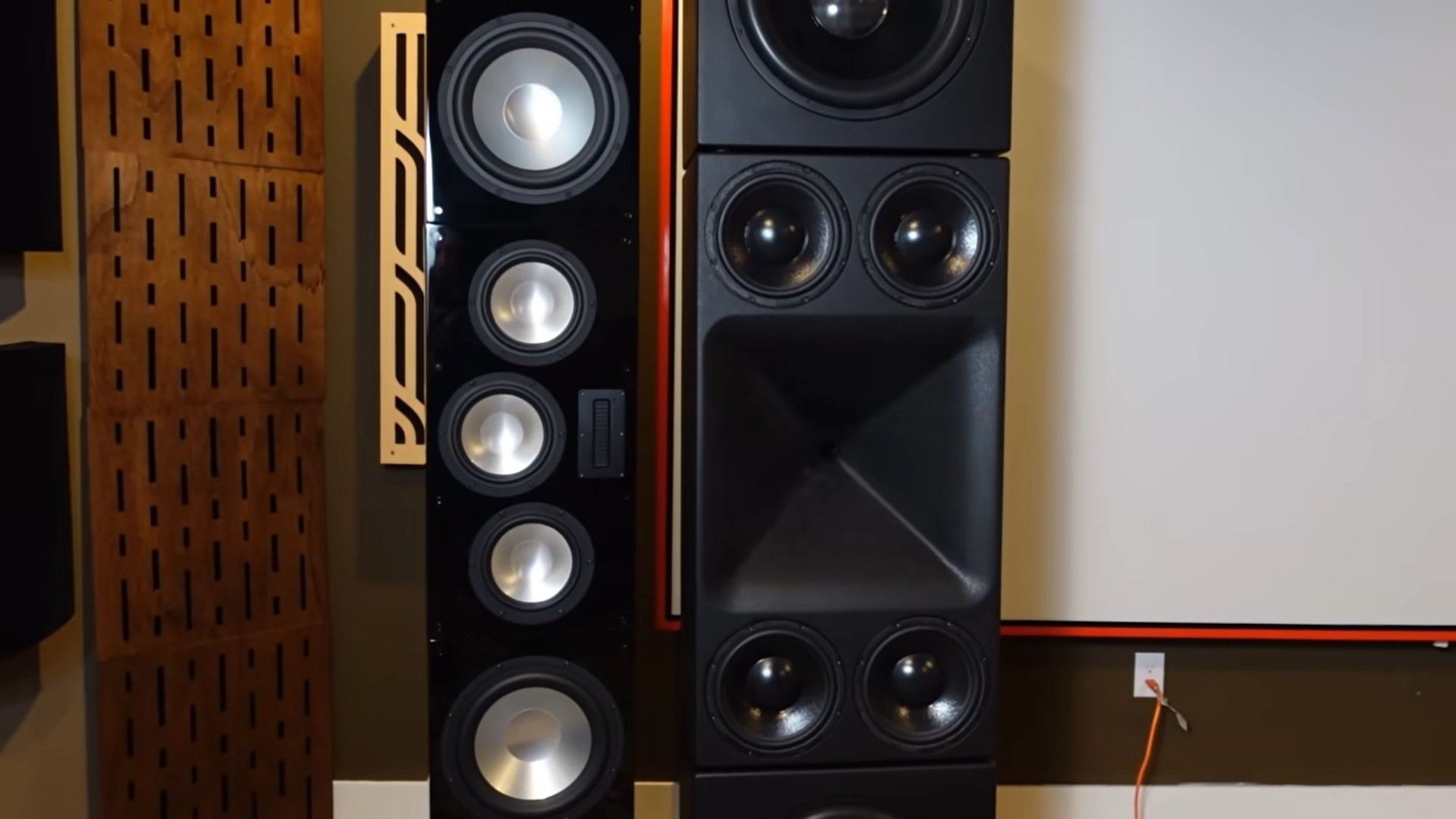

While everything in this speaker is impressive, I think for many, the subwoofer was the star of the show. Not that the 410 is bad, just that it was the sub that stuck out for all of us. Admittedly, stick four 18” high excursion drivers in any room, and fun will be had. For many, this might look familiar, a lot like a JTR Speakers RS1? You would be forgiven for thinking that, but…They aren’t identical. The biggest and most meaningful difference for the 2021 lineup is that the RTJ line is exclusive to dealers, so the subwoofer was optimized for custom installers. All subwoofers are passive and come with a rack-mount amp, as it should be. Controls for the Room gain adjustment and amp gain are on the back to keep nosey customers from mucking up their own system (For those of us who have installed these types of systems, it’s a reality we all deal with, customers making changes and then complaining about bad sound). We heard the 18s powered by an 8000 watt amp, which was feeding 4000 watts per side, or 2000 watts per driver. That is RMS, not some fairyland weaksauce peak number. Is it enough? Jeff can provide you with two amps, give you 4000 watts per driver, but keep in mind, we popped a breaker repeatedly with this setup. You will need one dedicated 20amp breaker per amplifier.
The enclosure is unusual in consumer audio. It is built like a pro audio cabinet, in all the best ways. Baltic birch plywood nearly an inch thick, internal rib bracing, and glued together the same way Jeff has always built pro audio cabinets. This thing is designed to take a beating. It’s a much stronger enclosure than MDF and it allows it to forgo the kind of bracing typically required for MDF boxes. While some might argue that MDF is inherently more dense and better damped, below the 100hz that this box operates, that is of no consequence at all. The enclosure is a pure pressure vessel, and it is stiffness that matters. Plywood is MUCH stiffer than MDF. It is also much lighter, so while this speaker is not light, it isn’t anywhere near as heavy as it would have been had MDF been used. I am sure any installer will be happy about that.

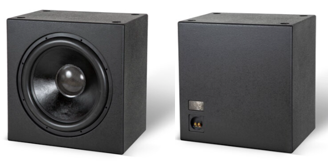

RTJ 18sub

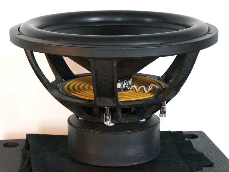

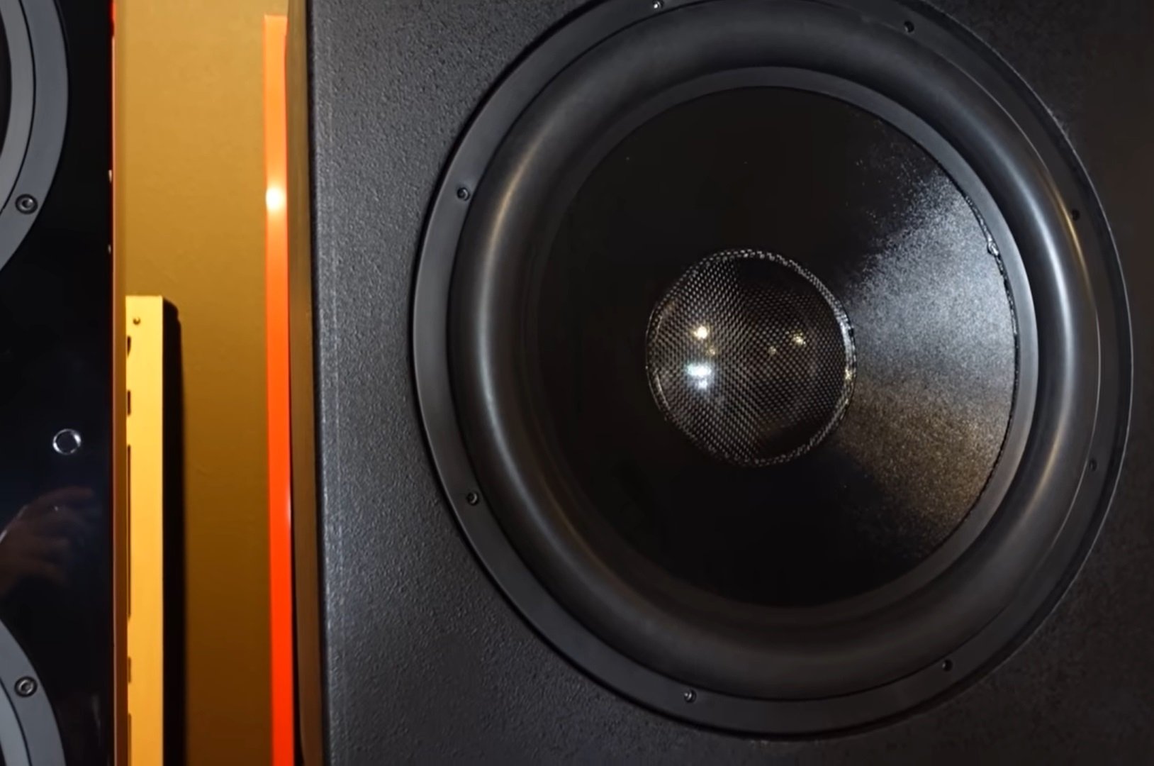

What about the driver? Is it anything special? In fact, the first question that Don Dunn and Gene DellaSala asked was who else uses this driver. The answer to that I already knew. Nobody. This driver is unique to Jeff. He designed it himself along with his supplier and its proprietary to him. For those who know where he sources his drivers, just know you can’t source this one. It’s completely unique to his company, and it really is a special driver. Jeff decided to massively upgrade the driver he had been using in his JTR speakers by adding a lot more aluminum to the motor. This is done to reduce eddy currents caused by the higher inductance and, as a result, higher distortion. The motor has been dramatically improved and inductance now sits below 1mh. As a result, this driver has a massive 3.5” voicecoil, 36mm (that is one-way) x-max, and a ridiculous multi-kilowatt power handling. There are virtually no other companies selling subwoofers for any price using a driver this good. While the car audio scene has drivers with similar x-max and power handling, they don’t have that low inductance, they just aren’t this linear. As you will see in our limited measurements section, it seems to have all paid off. This subwoofer has the lowest distortion I have ever measured and a very good response. I look forward to seeing what James Larsen comes up with once he has time to put it through his testing.
RTJ 410 Module

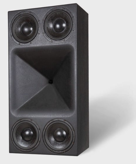

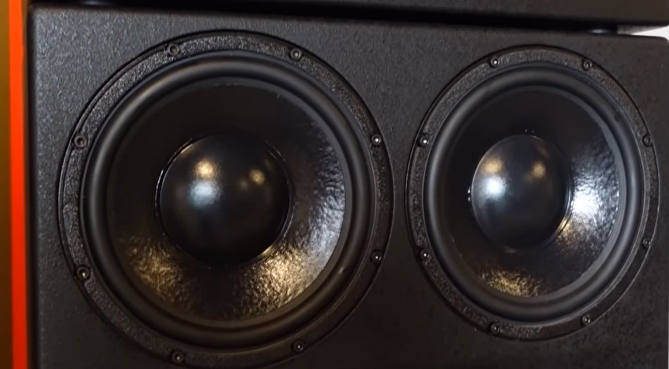

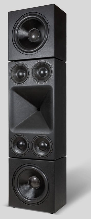

What about the 410? What makes it tick? Is it just a glorified, oversized JTR speaker? Again, the answer is no. This speaker is using unique pieces to provide better sound and better measured performance. Specifically, the waveguide is a brand new design. It’s much larger than any waveguide that is used by almost any other speaker. Most of JTR’s speakers used waveguides that were no larger than 15”, most were about the same size as the midbass drivers, and while this made sense aesthetically, Jeff likes to cross his waveguides over very low, often around 500hz. This means the waveguide was not providing significant directivity control down to the crossover point. The 22” waveguide used in the 410 allows for directivity control down to around 600hz, much closer to the crossover point.
The 410 module also uses a Coaxial BMS compression driver from Germany that was designed specifically for high end studio monitors. Some have criticized these parts as low fidelity parts designed for stage use. That is incorrect. This driver was designed for very high-quality pro equipment and studio monitors, meant for the highest levels of fidelity. Additionally, the advantage of using a coaxial driver like this is that is that the 410 acts like a point source down to 650 hz. In fact, because of the wavelengths at 650 hz and below, this speaker is practically a point source at all frequencies. The BMS driver has two concentric annular rings which produce both the midrange and high frequencies. That allows the BMS driver to cover from 650 hz up to and beyond 20khz. These compression drivers have very good response, very low distortion, and very high output. This driver will not compress at any level used in studio or residential use, something that can’t be said about the vast majority of tweeters used in home audio speakers.
The ten-inch drivers are custom made for RTJ in the United States. These drivers are built to be top quality with low inductance, low distortion, a linear response, and good compression behavior. Again, through the use of such an excellent driver mixed with the sheer number of them assures this speaker will play at very high levels without losing linearity. Using two drivers next to each other will impact the directivity, however, the very low crossover point largely eliminates this benefit. While it is possible the drivers may still improve directivity control, I would not consider that the major benefit. Rather, this speaker’s advantage is a moderate size with good output and linearity.
The Crossovers
The crossover in all RTJ speakers are built to the highest standards using the best reasonable parts for the job. This includes high power inductors, some steel core are used because of the very low series resistance and price/performance. However, air core inductors are used where they make the most sense and the most improvement in sound. Large paralleled resistors are used to ensure sufficient power handling without degradation or reliability problems. Film capacitors are used for the improved sound and reliability over electrolytics. Far more important is the quality of the parts is the quality of the design. Most manufacturers seek to eliminate as many parts as possible in a crossover to keep costs down. Some make ridiculous claims, such as how this improves sound quality by removing veils. Crossover parts don’t impart a veil, the degradation is typically as added distortion or reliability issues. The amount of distortion added is very minimal. However, the problem with overly simple crossovers is that the amplitude response is compromised. Jeff makes no such compromises, the RTJ uses as many elements as is necessary to get the best possible on-axis response. Some may argue that the passive design is a compromise. While an active system allows for superior performance, it also adds complexity. This places a lot on the installer, who now needs to deal with at least twice as much amplification, twice as much wiring, and ensure they load the DSP properly. Passive systems are simple. You plug them in and they work. While DSP gives you lots of flexibility to add a lot more equalization of the response and steeper crossover slopes, in many cases, 4th order slopes offer optimal performance with the best on and off-axis response. The major argument for steeper slopes is greater driver protection, but if the drivers are fully in their linear operating range, the detriment isn’t there. Passive crossovers are lossy, which is not optimal, but the lossy problem is not audible. While many point to passive systems as having reliability problems, most well designed passive speakers last decades. That is not commonly true of DSP electronics, with the DSP platforms needing hard resets routinely, and the hardware eventually going.
As for the actual crossover design. The speaker uses Linkwitz Riley 4th order crossovers at 650hz and 6200khz. This design ensures optimal phase alignment between drivers. A lot of speaker companies save money in the crossover. RTJ does not, using both high quality and high power powers, along with enough parts to get a good response. The crossovers are well optimized to ensure a smooth response.
Overall, the design and build quality of the RTJ speakers punches well above their price class. Even with the higher price point demanded by these higher end custom install speakers, they remain a series value in the market. Few subwoofers are nearly as good as the RTJ subwoofers. Few speakers combine the high fidelity, careful directivity control, and high output of the RTJ 410 modules. Those that come from companies like Pro Audio Technology and Procella, two companies whose products typically cost more for a similar level of product. Of course, none of this tells us how they sound. Read on to see what I thought.

First let’s discuss the sound signature before getting into some specific tracks. The RTJ system sounded clean, effortless, and relatively neutral. The first time I ever heard a speaker with this kind of dynamics, I found the experience transformative. My experience had been that more typical speakers sounded fantastic when it came to their ability to recreate instruments’ natural timbre. However, they always made the performance sound small. It never sounded real to me because it just didn’t match the dynamics and levels I was used to hearing in real life. Remember, a piano, guitar, and trumpet are very loud in real life. However, I also found that most speakers capable of natural dynamic range also sounded lousy.  Bright, ear piercing, harsh, often with a cupped hand effect. Just not neutral. The RTJ speakers had that realistic level of dynamic range, but also sounded very neutral. Jeff has always made a fairly neutral speaker, but I think this is his best effort yet.

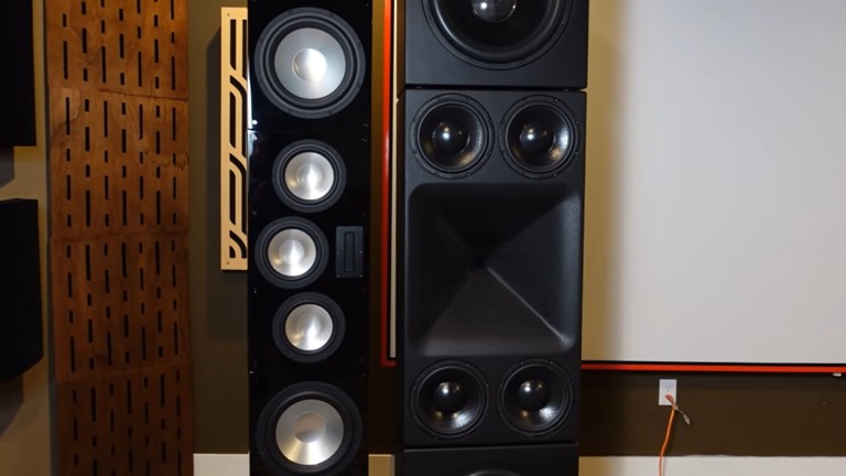

Imaging has always been a strong suit for Jeff’s speakers, but I should really talk about this in more appropriate terms. This requires a bit of nuance, and that became especially apparent hearing them back to back against the RBH speakers in Gene’s room. The RBH speakers had a larger and more spacious sounding image, but it was also less defined and precise. It’s the classic sound signature of a wide dispersion speaker. The RTJ speakers sounded more intimate, better defined, with a kind of image specificity only a constant directivity speaker can produce. This is my preference. Gene prefers the more spacious presentation of the wider dispersion speaker. Neither is right nor wrong, it’s just a preference. However, what that means is that a room utilizing the RTJ speakers needs to be treated carefully.  Whereas you may want to absorb or diffuse some of the lateral reflections with a wide dispersion speaker in order to add back in some intimacy and specificity, the opposite is true of the RTJ. Significant lateral absorption will likely make the speaker sound too much like a point source with no apparent source width. The image will largely sit between the speakers. If I were tuning a room with these speakers, I wouldn’t absorb the first reflection point and I’d likely use more diffusion at ear level. Absorption would be used above and below ear level or toward the front of the room to simply keep the RT time to a reasonable level. In fact, the magnetic mounts that Gene used for his Sonitus panels made it easy to switch out some of the absorption for diffusion.
Talking about the bass response of these speakers is just silly. With four 18” high excursion subwoofers and 8000 watts of power, bass was everything you would expect. You want silly bass, it can produce silly bass.  Our first night with the system, it wasn’t setup right, but that didn’t stop the group from turning it up to ridiculous levels and turning the bass level up with it.  It was outright ridiculous.  What impressed me was just how tight and distortion free the bass sounded.  There were no signs of distortion or compression, no inappropriate noises, everything remained clean, even if excessively loud.  The next morning, the first thing we did was take some baseline measurements, turn the bass down to reasonable levels, and tune the system for neutrality.  It was at this point that I realized just how good these subwoofers are.  The systems bass was the best quality, best sounding bass I have ever heard.  I know the word “tight” is a bad word in the psychoacoustic community. It’s ill-defined, but I know of know better word to describe what I heard.  The bass had a kind of cleanliness I am just not used to hearing from even high end subwoofers.  It was so good, I would honestly put this up against the most expensive subwoofers I’ve ever seen or experienced, and I would bet this quad sub setup would still come out on top.  It’s that good.  Don’t take my word for it, our own measurements of the system further showed that it was an extremely flat/linear subwoofer with among the lowest distortion we have ever measured, totally consistent with what we heard.  Further, because it was a sealed system with such good low end extension and so much excursion, the system was capable of low single digit extension in Gene's theater room.

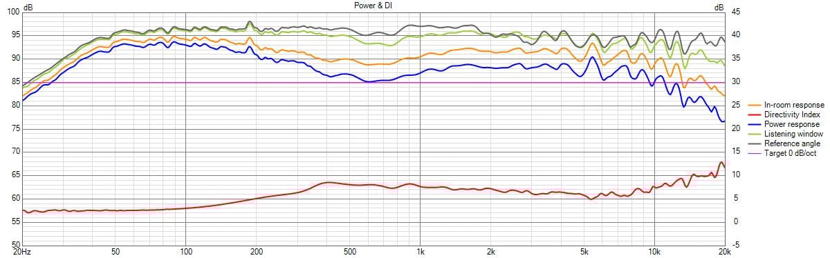

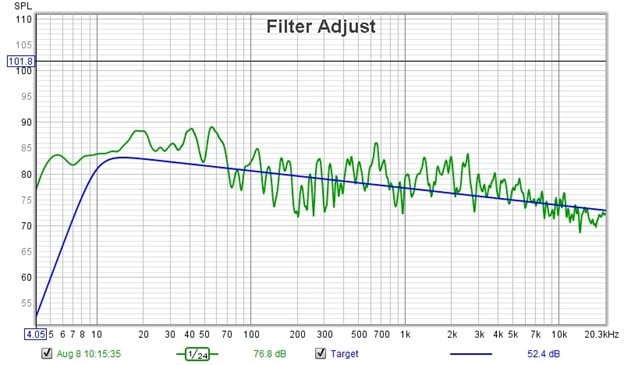

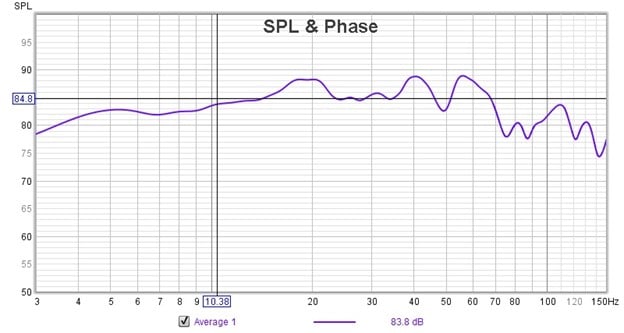

The measurements section won’t be our typical Audioholics measurements. Unfortunately, the circumstances prevented us from measuring this system as we had liked. It was hot, in typical Florida summer style. The videos we shot had taken too long. Jeff needed to get home in a timely manner, and was going to be driving through the night. I pushed Jeff to let me try. I really wanted to get some measurements. At least a handful of angles. Gene’s new house really needs an exorcist. We ran into little problems throughout the weekend, and this was no different. By the time we finally had sound coming out, we discovered problems in the measurement setup we had concocted, and it was too late to fix them. I was able to get only one measurement of the 410 module, with a microphone aimed dead on. The subwoofer was measured ground plane such that we could show how the room gain control works to extend the bass response. It gave me a chance to see the speaker’s distortion performance. This measurement section will include a single on-axis measurement of the 410, a few measurements of the subwoofer at one level, and an in-room measurement of the speaker as calibrated. I hope to generate complete data on this speaker at a future date. Past efforts by Jeff have measured well, and the larger waveguide in this speaker promises to improve on those past efforts. Hopefully, I can see that for myself and convince Jeff to drive another 9 hours each way to see me.
As for the in-room measurement, what we saw was a typical in-room response full of resonances caused by various reflections and room modes. The natural downward slope and relative smoothness suggest consistent directivity. The rate at which the response falls between 100hz and 10khz suggests that directivity is well controlled, but not overly narrow, as it follows close to the typical target curve, if not a little flat. Above 10khz, the response falls faster, suggesting narrowing directivity, typical of most speakers.
The in-room extension is unreal. I’ve long known that sealed box subwoofers could get better extension in room because of the slower rate at which the response falls off (2nd order). However, most sealed subwoofers we deal with have limited output and a fairly low excursion. While it may technically be possible to get very low extension, it’s typically at such low levels it is not useful. Here, what we saw was a response that was rising toward around 10hz, where it then slowly fell, leading to high output single digit extension.
What is most impressive about the response we see in Image 3 is that there is no clear end in sight for that extension. I have that graph starting at 3hz and the bass is only down around 4-5dB. That is with no EQ extending the response. The sealed boxes allow very deep extension in room and the four 18’s have enough output to allow a pretty aggressive room curve if so desired.
Now, I managed to get some outdoor free space measurements. The speaker was placed on a stand around 5 feet off the ground. The stand we used, given the size of the speaker, raised heavy loads much like a small fork lift, rather than our typical style of stand. This worked to get the speaker off the ground, but unfortunately didn’t allow easy rotation nor was high enough off the ground. The acoustic center of the speaker was just 7 feet off the ground. When measuring the speaker at 2 meters, we couldn’t get a clean enough signal. I moved the mic to 1 meter, which improved things dramatically. Measuring this speaker in the future will demand a different approach to get good results. This allowed me to capture the on-axis response with a clean impulse response out to around 9ms. By then windowing this measurement and splicing in the bass response of it and the bass module, we can see that the on-axis response is very smooth.
There are a few resonances and the shape isn’t totally flat, but it tracks a good response shape for a speaker of this type. There are a few resonances in the response that a bit of DSP could address. None of these are majorly concerning, the response still falls within a +/- 2dB window, and fixing these tightens that to fit within a +/- .5dB window. For custom installers, this kind of intrinsic correction is readily possible and appropriate. What isn’t correctable and was unexpected is the directivity. While not horrible by any means, you can see a shift in directivity between the midbass drivers and waveguide. This is caused by the diameter and spacing of the 10” midbass drivers, causing a narrowing in their directivity starting around 200hz and becoming most prevalent at around 700hz. This causes a rise in the DI and a dip in the power response. This is even evident in the predicted in-room response. This actually threw me during tuning and I initially corrected this, only to find it made the speaker sound worse, not better. This is not unheard of. Interestingly, other than this slight issue, the speaker’s directivity is so well controlled that the directivity index is basically flat. This is really unusual to see a DI that is so flat and well extended. It is basically around 6-9dB from 400hz to 15khz. There is a bit of widening in the directivity around 5-10khz where the DI is at its lowest, around 6-7dB. Most speakers would have a rising DI, and often not nearly as linear.
