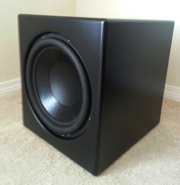

Before we look at the measurements, let’s talk about what goes into the PS-15X and the PV-15X. The PS-15X is a medium-sized, front-firing sealed subwoofer measuring 18”W x 20”H x 20”D (sans grill, feet, and amplifier), and boasts a long-throw 15” driver backed by the 950W Dayton SPA-1000 amplifier. Looking at the driver itself, it appears to be a very capable unit featuring a treated paper diaphragm, 12 spoke cast aluminum frame, a meaty half-roll surround plus large-diameter spider for large excursions, and a 3” voice coil for high power handling. To help ensure that the only sound you hear emanates from the driver, the cabinet is built with ¾” MDF and uses full panel internal bracing.
The Reaction Audio PS-15X; that meaty looking driver can deliver one-way excursion in excess of 30mm.

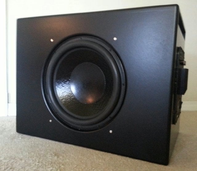

Moving on, the PV-15X is the side-firing, vented counterpart to the PS-15X. While it sports the same driver/amplifier combo, the PV-15X is quite a bit larger at 18”W x 22”H x 29”D (again, sans grill, feet, and amplifier). The enclosure volume along with a large slot port achieves a tuning frequency of approximately 18Hz.
Side view of the PV-15X sans the grille.
