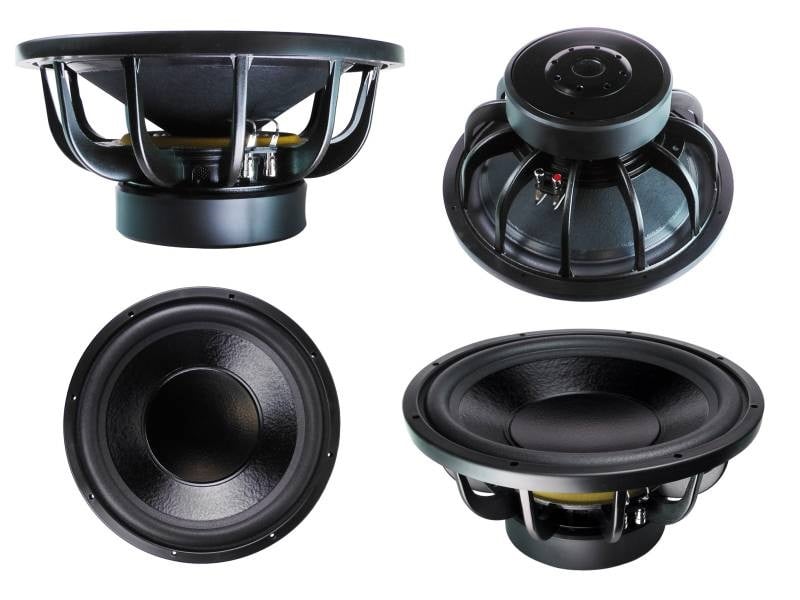

Since the debut of their Power X line in 2012, Tom Vodhanel and Jim Farina of Power Sound Audio have sought to redefine value in the Internet Direct subwoofer business. Now the Ohio based company is at it again, refreshing their Power X offerings with an updated “SE” driver which promises substantially improved performance for a modest price increase. Yeah, we hear claims like that from manufacturers all the time. Fortunately, Tom V. was kind enough to send Audioholics’ subwoofer guru Josh Ricci test samples of the XS15se and XV30Fse. Want to know the results? Keep reading!
SE Driver
Power Sound Audio's SE driver.

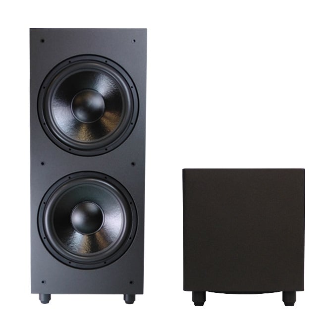

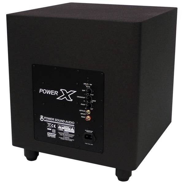

Before we get too deep, it’s a good idea to go over the particulars of these two, very different subwoofers. On one hand, we have the XS15se ($799), a medium sized, down-firing sealed subwoofer boasting a 15” driver motivated by 550W worth of amplification. The driver is a custom model from Eminence based on their LAB15 platform. Power Sound Audio rates the driver to have 2” of peak to peak excursion, and proudly notes that it is assembled in the USA. Meanwhile, the enclosure itself (also built in the US) is constructed of 1” thick MDF and lined with damping material. While the cabinet doesn’t feature any cross-bracing, it is relatively inert thanks to the thick walls and compact dimensions.
XS15se Rear
Rear view of the XS15se.

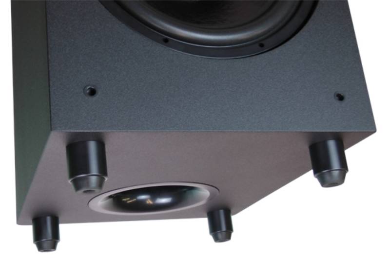

Then there’s the big dog. Measuring 22.5” x 18.5” x 45” and weighing in at 162 pounds, the XV30Fse ($1,499) boasts a pair of forward-firing 15” drivers backed by 750W of amplification and a 6” flared port. Needless to say, this isn’t a subwoofer that’s just going to slip by your significant other or hide in a corner. We’d also note that cabinet construction is much heavier here to compensate for the much larger panel sizes, with an internal window brace and a double thick front baffle.
XV30Fse bottom
View of the XV30Fse's bottom panel and 6" flared port.
