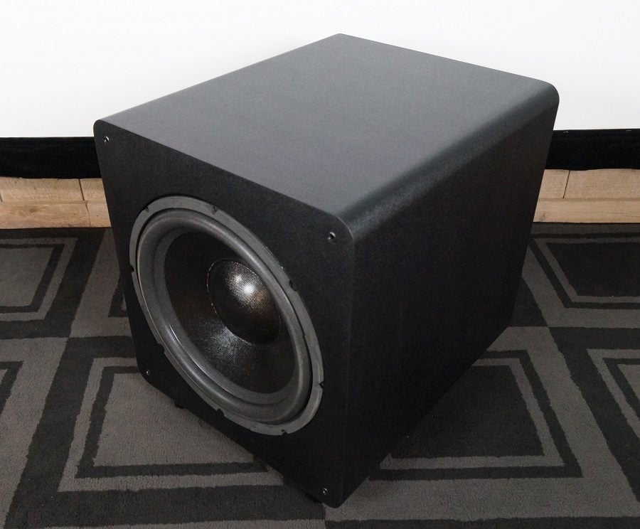

Monoprice SW-15 Subwoofer Packing and Appearance

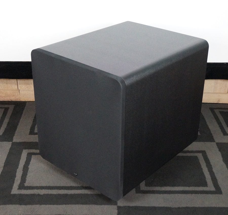

The SW-15 arrived double-boxed. Inside, there were some thick polyethylene corner pieces glued to an additional cardboard sheet. The sub itself was wrapped in a plastic cover to protect against moisture. Overall, this is an impressive level of packing given the cost of the sub.

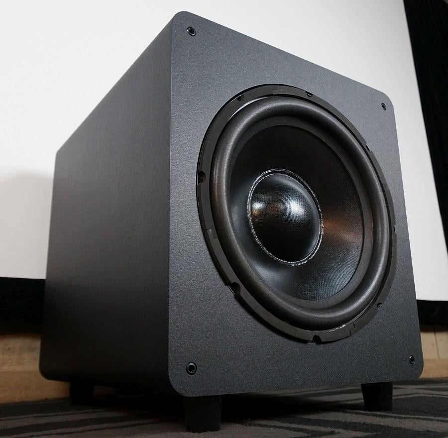

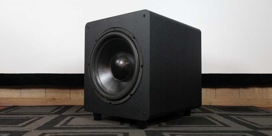

Once unpacked, we are met with a pretty typical subwoofer, albeit it is on the somewhat large side. It is a black oblong box like so many other subs. The extended horizontal edges are rounded which does help to soften the appearance. The finish is a textured vinyl like we see on many other budget speakers. It doesn’t look bad, and it is resistant to scuffs and fingerprints. The grille covers the entirety of the front baffle, and it is just black fabric draped over a shaped frame. With the grille on, the SW-15 looks fairly blank: a nearly featureless black box. Without the grill, we get to see the driver cone, and that gives the sub a lot more character. At a glance, the cone almost looks like carbon fiber, but a closer inspection reveals that it is a simulated threaded texture, not an actual woven material. The driver has a beefy surround, and the frame edge is mostly covered by a rubbery gasket piece. The cone is not recessed much into the enclosure and the surround does stick out a bit. The sub floats a couple of inches above the ground on some plastic cone feet. The SW-15 is not a luxury item and doesn’t pretend to be one. Those who are shopping for subs in this price range probably won’t be bothered by its rather plain appearance. However, it doesn’t look awful, and the grille would help it disappear in many rooms.

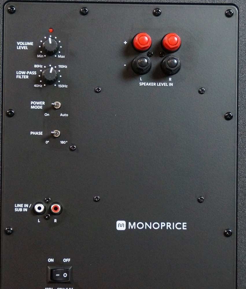

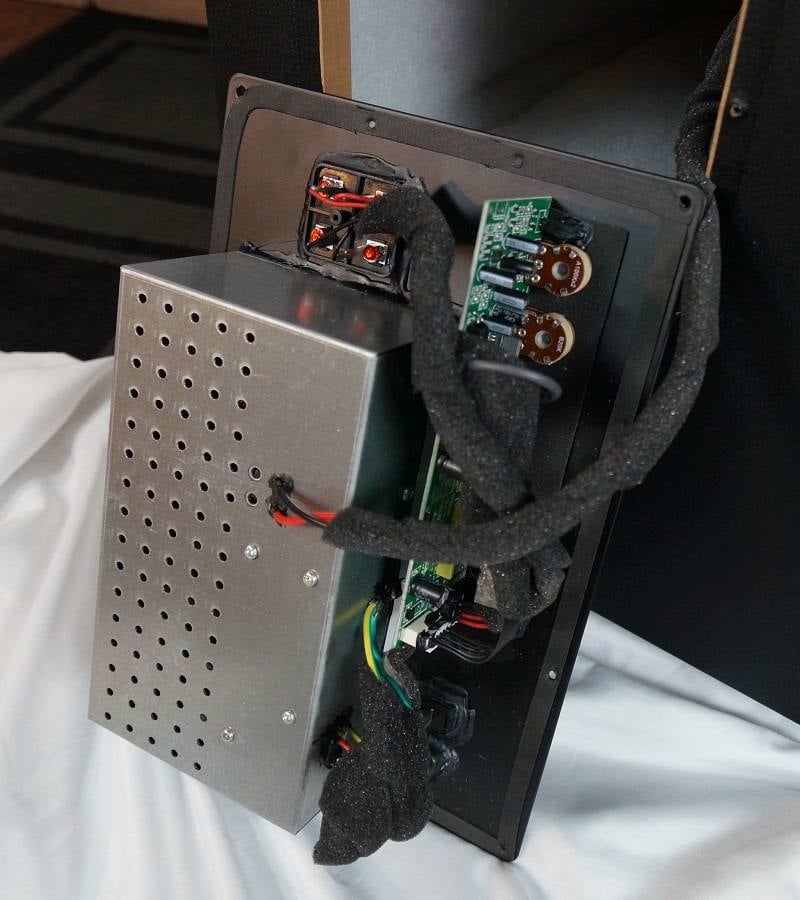

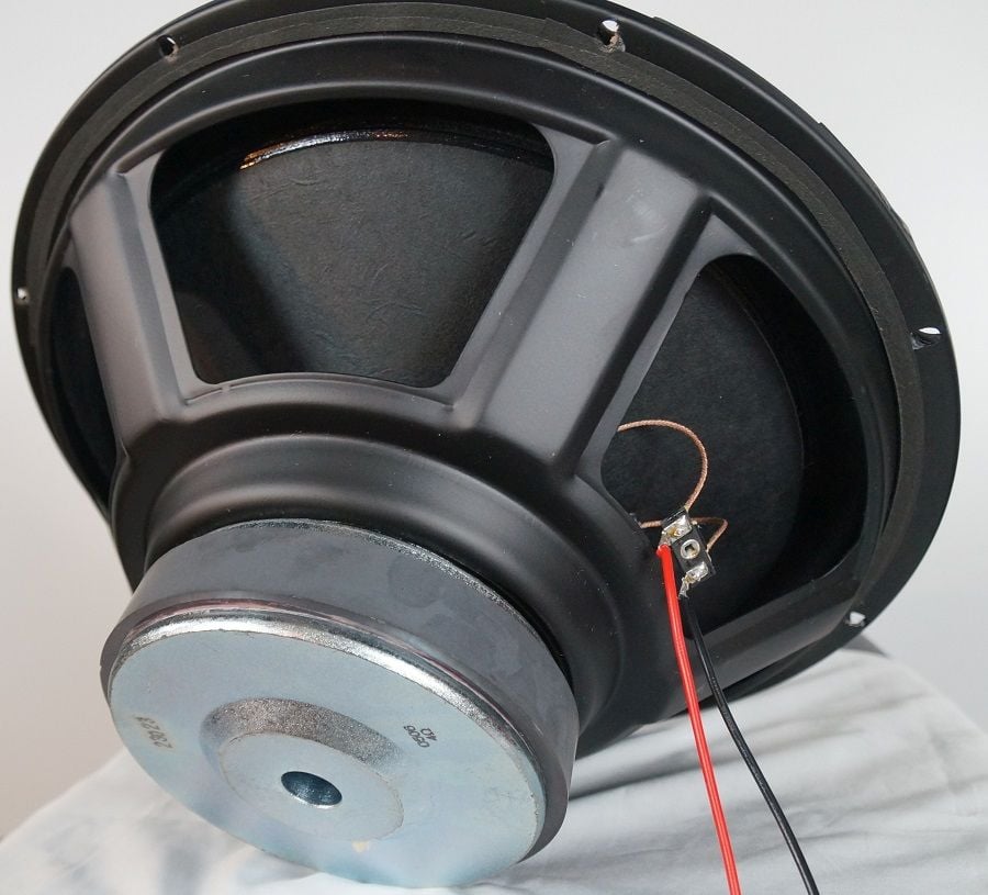

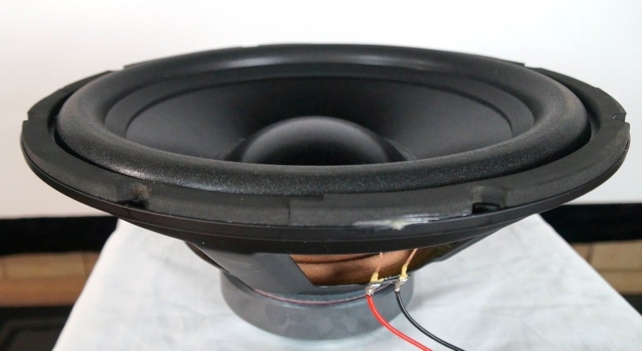

As a very economical design, the SW-15 is a relatively simple subwoofer, but it does have a couple of unusual attributes worth highlighting. Let’s begin our discussion of the design by talking about the driver. It does use a 15” woofer, but that is measuring it from the edge of the frame, not the cone. Most, but not all, manufacturers rate their driver diameters the same way. The cone is reinforced paper that is coated in some kind of lamination, and it attaches to the frame with a 1 ¼” half-roll butyl foam surround. The frame is stamped steel with ridges to help increase stiffness. It attaches to a not-huge magnet measuring 6 ¼” diameter with a 1” thickness, but you can’t expect a massive magnet in a sub with a $300 price tag. Besides, the number that really counts is how much magnetic flux it delivers in the gap to the coil, and that number isn’t known to us. Venting is done through the pole piece, and the backplate is bumped out to permit higher excursions before bottoming out.
The driver is ostensibly powered by a 600-watt RMS amplifier, but, as was said before, I find that number to be implausible. Amp controls are the bare necessities of a volume knob, a low-pass filter knob that goes from 40hz to 150Hz, an on/off switch, an auto-on power switch, and a 0-180 degree phase switch. Connectivity is implemented through left and right RCA inputs and speaker-level inputs. As a digression, I don’t know why so many low-cost subwoofers have speaker-level inputs. I would imagine that very few people use them. They were a lot more useful 25 to 30 years ago when lower-cost receivers weren’t guaranteed to have subwoofer outputs. Unless the cost to add speaker-level inputs is next to nothing, manufacturers ought to skip this feature.

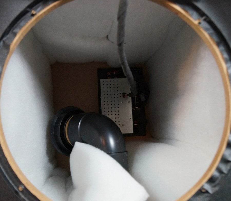

The enclosure uses a ⅞” thick front baffle, and there are pieces of corner bracing at points in the corners. A thin layer of polyfill-type stuffing lines the interior panels. The feet are some tall plastic cylinders that give fingers plenty of clearance to safely place the sub by hand. The grille uses a thick MDF piece as a frame, and it attaches to the front baffle with some plastic pegs. If the grille is not going to be used, store it somewhere where it will be left alone, because I can see the plastic pegs getting easily broken off by knocking them across anything hard.

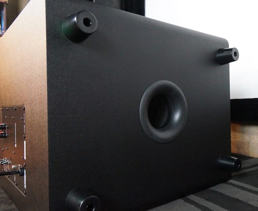

The port is unusual; it takes a 90-degree turn within the cabinet. I think there would have been room for a straight port of its size, but, for whatever reason, this one has a right angle. It is a bottom-mounted port that extends 8” upwards within the cabinet and then extends another 6” after the angle. It has a 3 ¼” diameter and is flared on both ends. I would guess that a port with those dimensions should have a somewhat deep tuning frequency for this class of sub. I would also guess that a hard 90-degree turn wouldn’t be great for reducing port turbulence and that a more gradual bend would have been better in this respect. However, much of the turbulence this port can generate will likely be masked by its down-firing orientation.
There is not a whole lot else to talk about regarding the SW-15’s design. Its individual components are expectedly simple, and what really matters is how they all come together to produce sound. Let’s now hear it in action to see what it can do…

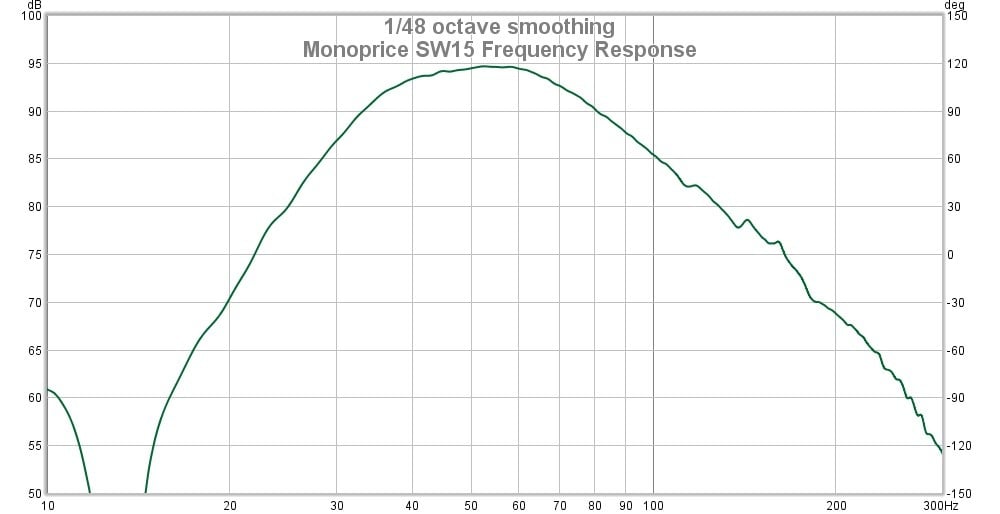

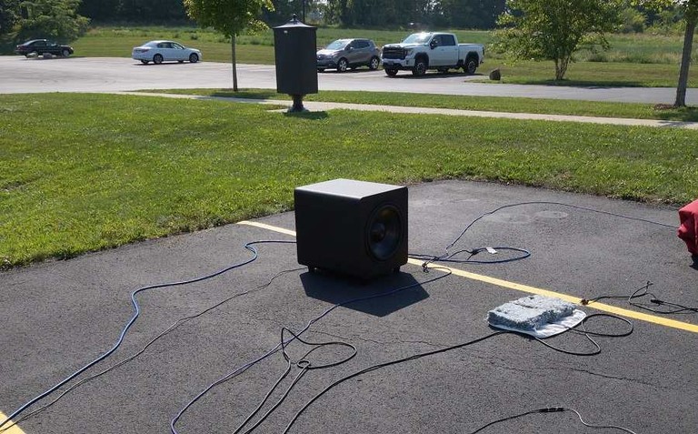

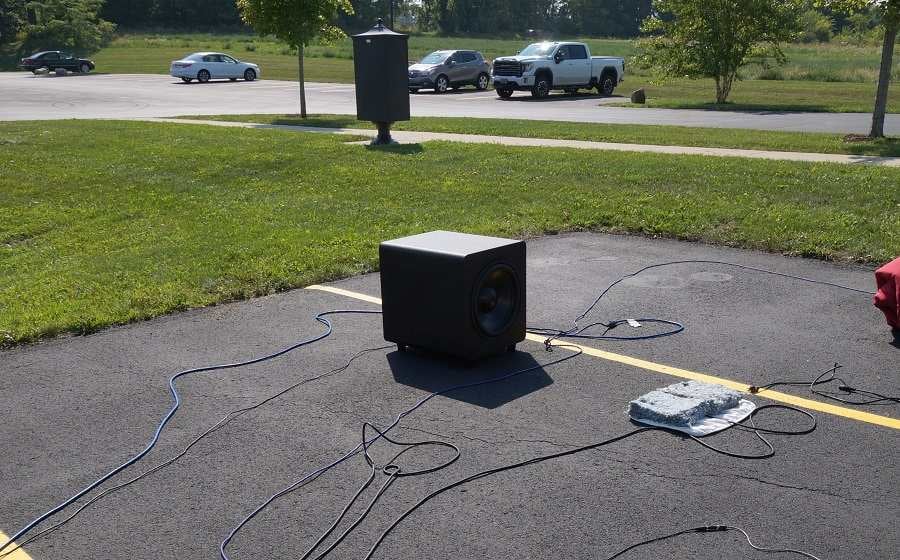

Testing on the SW-15 was conducted with the microphone facing the woofer at a 1-meter distance with measurements scaled back to a 2-meter distance by subtracting 6dB. The temperature was recorded at 67F degrees with 85% humidity. The subwoofer’s gain was set to maximum, phase was set to zero, and the low pass filters were set to maximum.
The above graph shows the measured frequency responses for the Monoprice SW-15 subwoofer. The most obvious aspect is that this sub has a relatively small bandwidth. Users might think that I mistakenly measured the SW-15 with the low-pass filter set to 80Hz, but this is not the case. I might characterize the +/-3dB window of this sub to be about 33Hz to 81Hz. I was a bit surprised about the SW-15’s lack of upper-frequency extension, but it gets the job done for most people who will be using an 80Hz crossover frequency to the sub. The port tuning frequency looks to be around the low 30 Hz range, and, like myself, I think room gain will shore the in-room response up to 30Hz but not much below that point.
The rapid fall-off above 80Hz puts this sub at a bit of a disadvantage. That means that the SW-15 isn’t really suitable for crossover frequencies above 80Hz. It’s NOT a subwoofer I would use with small bookshelf speakers that usually need a higher crossover frequency in order not to have a gap in the mid-bass response. However, those with full-sized bookshelf speakers as well as tower speakers should be fine. This lack of upper-frequency extension also works against multi-sub setups where placement can address acoustic problems above 80Hz.

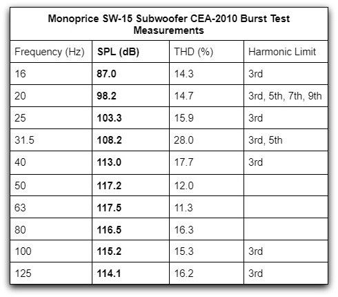

Monoprice SW-15 CEA 2010 2-meter RMS
The above CEA-2010 measurements are short-term bursts that show the subwoofer’s clean peak SPL before heavy distortion sets in. Our measurements have been referenced to 2-meter RMS, which is 9dB down from the standard requirement for the measurements to be shown at 1-meter peak. However most publicly available CEA-2010 measurements are shown at 2-meter RMS, so we followed that convention.
The measured burst numbers for a $300 subwoofer are absolutely superb. I measured this sub on two separate occasions just to make sure the first measurement set was not a fluke or a mistake, but it measured similarly in both sessions. In sheer output, the SW-15 blows away all of the $500 subs that we rounded up recently. The only sub that isn’t outperformed at every single frequency is the BIC PL-300 which maintains a lead only around its adjustable port tune frequencies at 16 to 20Hz. That is pretty nuts considering the SW-15 is significantly cheaper than any of them and in many cases doubles their output.
 So why even consider other subs in this
price range? One reason might be that those other subs keep their drivers on a
shorter leash in terms of distortion. Yes, you can drive the SW-15 to huge
output levels, but it does change tonality as distortion starts to creep in.
That happens to most subwoofers, but the SW-15 is more subject to this effect
than others. This can be seen in the THD percentage numbers as well as the
harmonic limits. In the table above, the harmonic limit column has items in it
at all frequencies except three. This means that the SW-15 could be pushed to
surpass the distortion threshold for the stated harmonics for the CEA-2010
burst tests. These are pretty generous thresholds, so that means that the SW-15
can be pushed to produce a lot of distortion. However, these levels of
distortion occur when the sub is pushed very hard. At nominal levels, it stays
well-behaved, and those nominal levels are still relatively high. In other
words, if we back down on the gain by 6dB from these levels, we are roughly at
the maximum output level of the other subs, but now the SW-15 is much better
behaved. So, in the end, you have a lot more headroom with the SW-15 but you
have the potential for a lot more distorted output if you drive it hard.

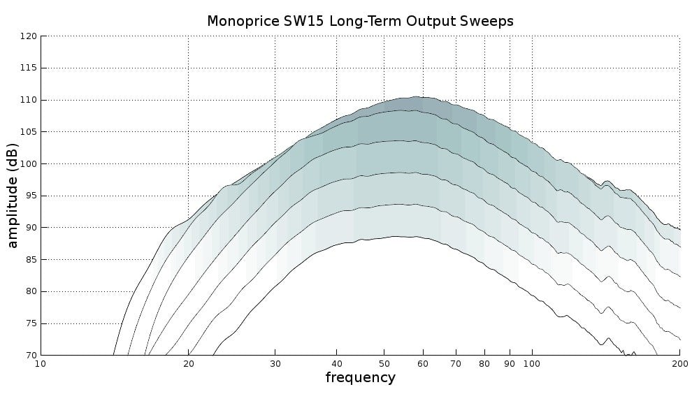

Testing for long-term output compression was done by first conducting a 20-second sweep tone where 50Hz hit 90 dB with the subwoofer 1 meter from the microphone (graph has been scaled to 2 meters for easy comparison with our other review measurements). We then conduct further 20-second sweeps by raising the gain by 5dB until no more output could be wrung out of the subwoofer. These tests show us the long-term continuous headroom that the subwoofer is capable of.
The SW-15’s gobsmacking level of output is carried to continuous tones as well as short-term tones. This is a ton of SPL and, in sheer level, is what would be expected from much more expensive subs. It should be noted that the SW-15 becomes more nonlinear at the highest output level, and it wasn’t terribly linear to begin with. The ‘peakishness’ of the response looks like a product of inductance, and a sub of this pricing isn’t likely to employ the usual methods of fighting inductance such as shorting rings or copper caps which add significantly to the manufacturing cost. Nonetheless, it holds its nominal response shape nicely out to 100dB, which is very good considering its price. Its mid-bass punch is unrivaled by anything close to its price point.

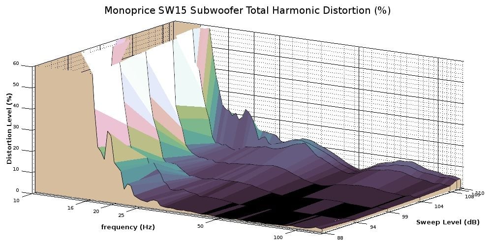

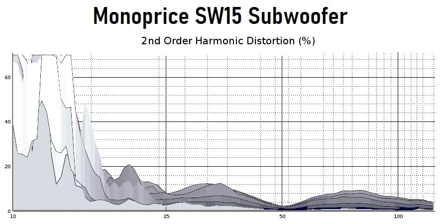

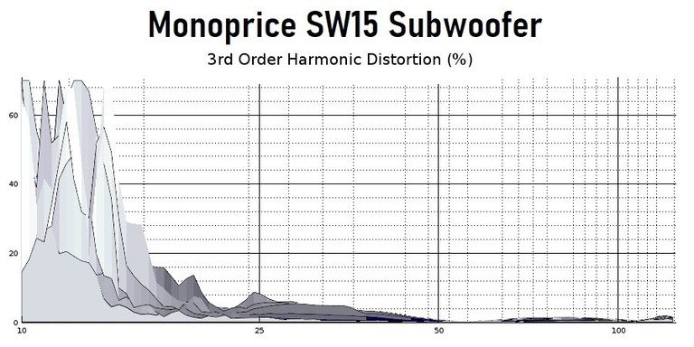

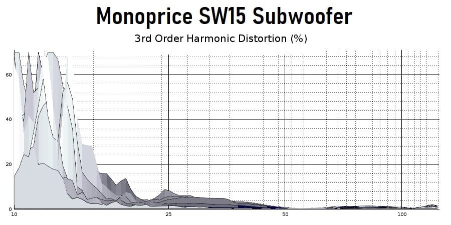

The above graphs show the corresponding total harmonic distortion to the long-term output graphs. Essentially, they depict how linear the subwoofer remains for the corresponding drive level seen in the long-term sweeps. The quantity being measured is how much of the subwoofer’s output is distortion and is shown here as a percentage.
At nominal levels around 90dB, the SW-15 produces fairly clean bass. In this graph, it looks like distortion increases in the low-end as the drive level increases, but what is happening is that the noise floor of the testing environment is relatively high compared to the output of the sub at deep frequencies, so much of what is being reported as distortion at the 88dB and 94dB sweeps around 20Hz is just background noise. That being said, while this sub has huge output, it doesn’t have far-reaching extension, and if you do push it hard, it will run into distortion as can be seen in the higher-level sweeps. Distortion in mid-bass never becomes severe and doesn’t surpass 10% THD at any drive level. In deeper bass, the SW-15 can be pushed into higher levels of distortion, but it doesn’t really fly off the handle until just above 20Hz at maximum output.
The above graphs depict measurements of the constituent harmonics from the long-term output sweeps and are what the total harmonic distortion measurements are composed of for the 2nd and 3rd harmonics. These individual harmonics can give us a clue as to what might be the cause of some quirk or non-linearity. We are only showing the 2nd and 3rd here because they more or less reflect the higher even-order and odd-order behaviors, although higher-order harmonics tend to be much further down as a percentage of distortion compared to the second and third.
We can see in the above graphs that the main driver of distortion for the SW-15 is even-order harmonics until we get to the highest drive levels. That reinforces my previous guess from the peakish response that inductance is likely somewhat high in this driver. Inductance tends to inhibit one way of the driver’s travel and tends to rise at a steady rate with the drive level which is what we see here. This is not surprising in a $300 subwoofer. As we said before, addressing this issue is costly. Furthermore, inductance can actually contribute to output within a narrow range, and the SW-15 is probably using it to produce its tremendous output.

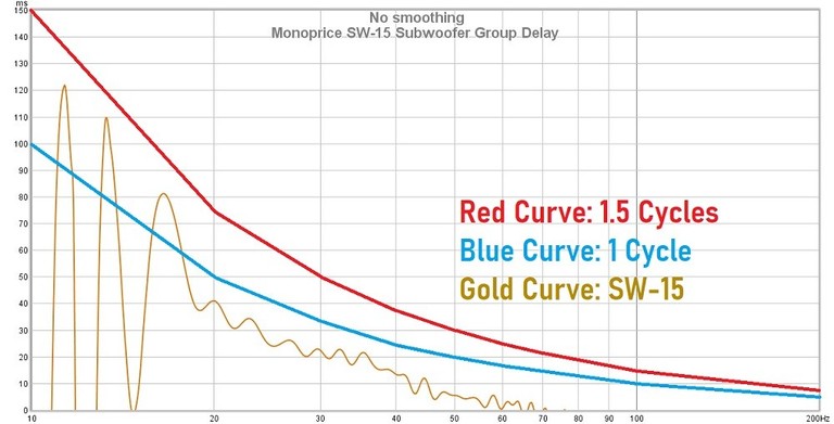

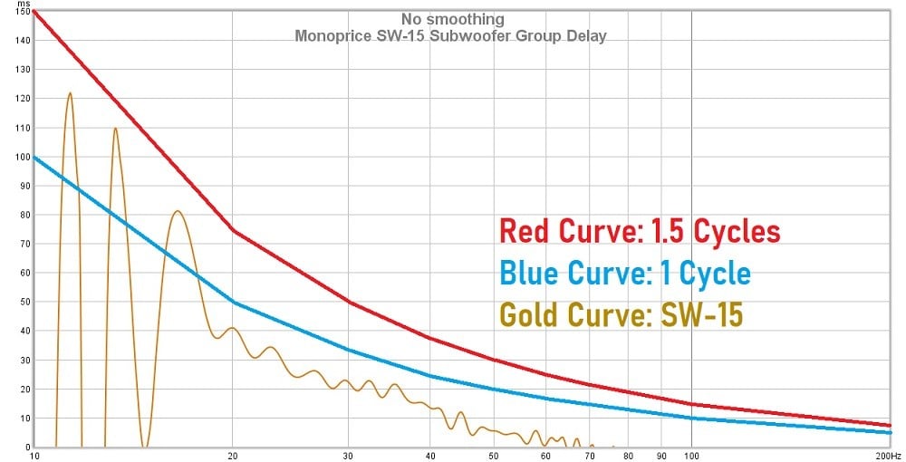

Group delay is the measurement of how much time it takes for individual frequency bands of an input signal to be produced by the speaker. It can indicate that some frequency components are developing slower than others or are taking longer to decay. It is generally thought that 1.5 sound cycles are needed for group delay to be audible at bass frequencies, although there is an argument that group delay should remain under 20ms to be completely unnoticeable, but that is likely meant for mid and upper bass frequencies.
The SW-15 does pretty well in this test, even without considering the cost. While it does surpass our strictest 20ms criteria at around 35Hz, it does stay under 1 cycle down to 20Hz. Its lack of group delay above 80Hz is likely due to its rolled-off output in that range. The high delay below 20Hz is not anything to worry about since this sub doesn’t have much output at all in that range. In my listening, I didn’t notice anything amiss in the time domain such as laggy kick drums.
