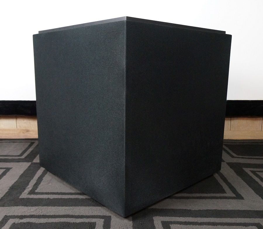

Definitive Technology Descend DN15 Appearance

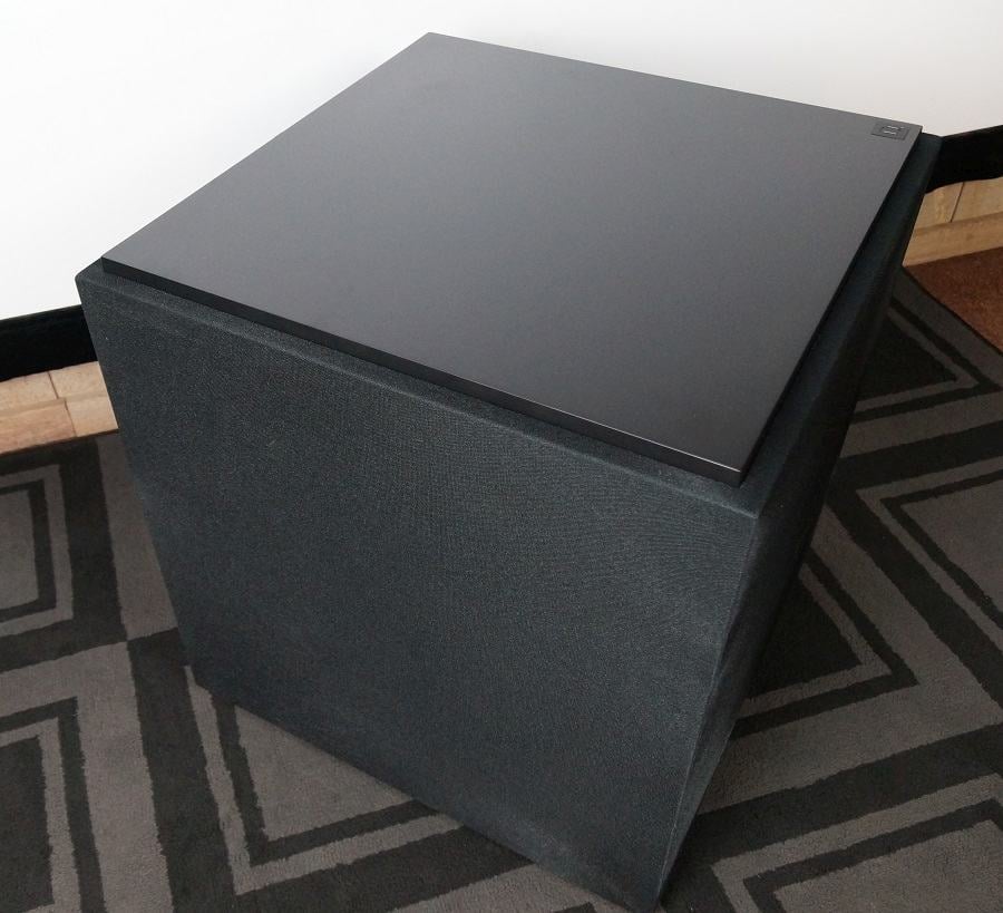

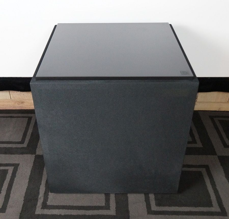

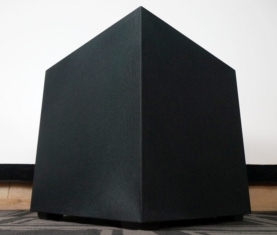

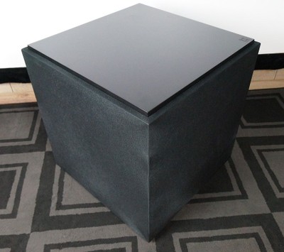

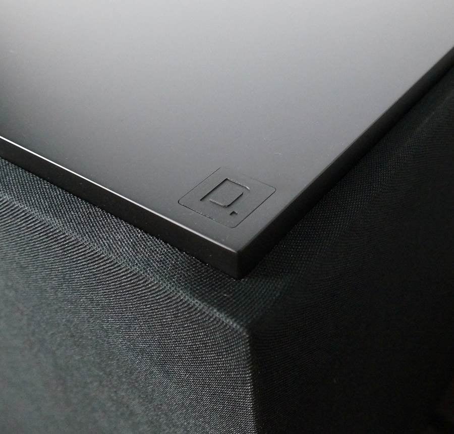

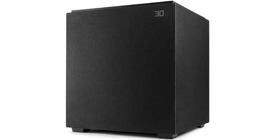

As with many other Definitive Technology products, the DN15 has an attractively minimalist appearance that should go some way towards making its sheer size palatable in a typical room. It leans into its cube dimensions by having all of the edges and corners be hard 90-degree angles. It follows the aesthetic set by Definitive Technology’s bipole speakers by covering the unit in a black fabric. If your speakers are Definitive Technology’s BP9000 series or Dymension series, the DN15 will be a perfect stylistic match. The sub is capped with a satin black top that has an understated Definitive Technology badge inset in the corner. It is basically a big black cube that is softened in appearance by the fabric surface. The non-reflective fabric will help it disappear in a darkened environment. Owners of cats should be made aware that the fabric covering of the DN15 might be an irresistible scratching surface for the felines; cat owners might want to skip this sub unless it will be used in a room cut off from the cat’s space. One interesting visual cue is the LCD display on the front of the sub. It is hidden unless active where it glows through the fabric covering of the sub. It lets the user see the sub’s gain level, phase, and operating mode.

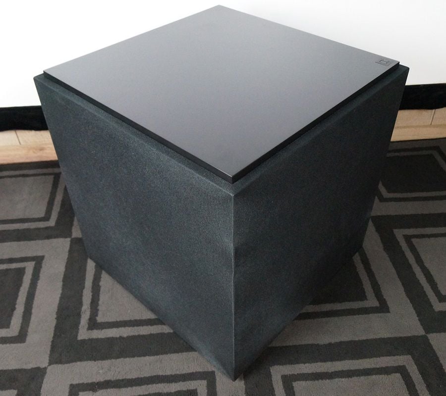

Definitive Technology Descend DN15 Design Analysis

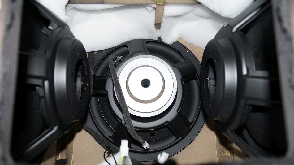

The DN15 is a 15” subwoofer that uses passive radiators, which is an unusual design these days. Passive radiators used to be more common, especially in smaller subs, but they have fallen out of vogue in the past decade or so. Passive radiators function much like ports; the backwave pressure wave from the rear of the driver cone resonates a radiating surface, which in turn creates its own pressure waves of air. In standard ports, that vibrating surface is a cylinder of air inside the port, but in a passive radiator, the vibrating surface is the moving mass of the radiator, which is largely the cone of an unpowered driver with no motor. The advantage of a passive radiator is that they can tune the system to lower frequencies for the same size enclosure, hence their popularity for smaller subs. It’s unusual to see them employed in a unit using a 15” driver because the sub can’t help but be large, but I suppose the DN15 would be even larger were it using ports to achieve the same deep bass extension. The disadvantage of passive radiators is that they add to the cost of the sub since they are much more complex than the simple hollow tubes or slots ports. Another advantage of passive radiators is that they don’t run into audible turbulence that happens when port velocity is overloaded, however, they can be pushed into over-excursion which can also turn into an audible problem.
There are two 15” passive radiators mounted on the opposing left and right sides of the sub. This is a good idea that cancels out rocking motion since passive radiators can often have some heft. In fact, it is their diaphragm weight that governs their resonant frequency. The active driver is a front-facing 15” that looks to have a paper-based cone. It uses a stamped steel frame with extruded ribs for added rigidity. It is mounted to a motor that uses a double-stacked 1 ¾” thick magnet with a 5 ¾” diameter. That is a fair amount of magnetized iron, but it doesn’t tell us the flux within the gap, which is the pertinent value here, and only Definitive Technology’s engineers know that information. The motor has a bumped-out backplate to enable longer excursions, and it is vented through the pole piece. The passive radiators look to have a similar cone and basket as the active driver.

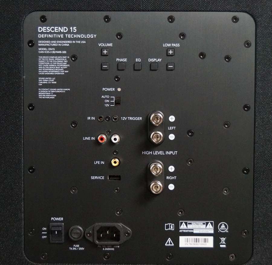

users can easily operate the sub with an eye on the display. Connectivity is comprised
of left and right RCA inputs, an unbalanced LFE input, and speaker-level
inputs. I cannot understand why I still see speaker-level inputs being used on
subwoofers; the situations where they would be used are uncommon. Definitive
Technology would have been much better off ditching the speaker-level inputs in
favor of balanced XLRs which would be a lot more useful.

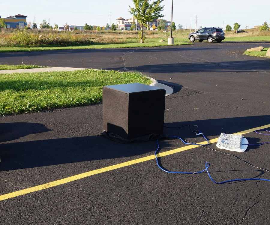

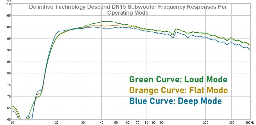

Testing on the Definitive Technology Descend DN15 was conducted with the microphone facing the woofer at a 1-meter distance with measurements scaled back to a 2-meter distance by subtracting 6dB. The temperature was recorded at 60F degrees with 90% humidity. The subwoofer’s gain was set to maximum, the phase was set to zero, and the low pass filters were set to maximum.
The above graph shows the measured frequency responses for the DN15 subwoofer. Here we see a nicely linear response from 20Hz and above. There is definitely a high-pass filter preventing output below 20Hz because the low-frequency roll-off is so steep. There isn’t much of a high-frequency roll-off, and we are only down by 5dB by 300Hz, so this sub could be crossed over at any frequency that the user could want. That is great news for multi-sub systems that want to use subs with higher crossover frequencies to address room modes. I like how Definitive Technology decided on a clear and specific performance target and hit the bull’s eye. There is not a tremendous difference between the various operating modes. The “Loud” mode gives the user a bit more punch from 40 to 50Hz, and that might give some more oomph to the fundamental frequencies of low-tuned bass drums or electronic bass lines. “Deep” mode gives 20Hz a couple more dB at the expense of the 40-50Hz range, and that would perceptually give more weight to the low-end. “Flat” mode is the middle ground between these. In my listening, the differences between these modes were subtle, so I just left it on flat for most of my listening.

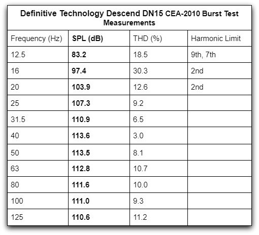

The above CEA-2010 measurements are short-term bursts that show the subwoofer’s clean peak SPL before heavy distortion sets in. Our measurements have been referenced to 2-meter RMS, which is 9dB down from the standard requirement for the measurements to be shown at 1-meter peak. However most publicly available CEA-2010 measurements are shown at 2-meter RMS, so we followed that convention.
The DN15 posts some good numbers here,
but it has to be said that this doesn’t hit the same loudness levels as
similarly priced large subs. I think that one aspect that holds it back is the
amplification; most competing subs have significantly more power than 500-watts
RMS. A doubling of amplification could potentially increase these numbers by
3dB which would put it more in line with its competition. However, there is
more to performance than peak SPL, even in CEA-2010, and we should be looking
at THD as well, and here we see a very clean sub that does not lose its
composure even when pushed to the max. It doesn’t really go above 10% THD at
25Hz or above, no matter how hard you push it, and that makes for a very
clean-sounding subwoofer. These numbers give the DN15 our Bassaholics ‘Large’ Room Rating meaning it should be able to handle

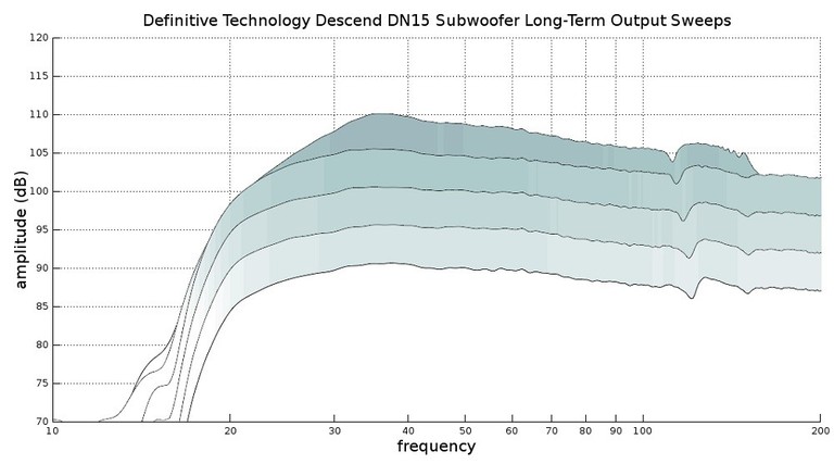

Testing for long-term output compression was done by first conducting a 20-second sweep tone where 50Hz hit 90 dB with the subwoofer 1 meter from the microphone (graph has been scaled to 2 meters for easy comparison with our other review measurements). We then conduct further 20-second sweeps by raising the gain by 5dB until no more output could be wrung out of the subwoofer. These tests show us the long-term continuous headroom that the subwoofer is capable of.
The DN15 performs well in this testing, and it does not change its response shape at all until the last 5dB of headroom. At the maximum drive level, it does compress some output from 20Hz to 30Hz, but this is not as severe as we see from most subs in this test. Again, while the max output isn’t bad, it isn’t on the level of many of its peers, mainly in the range above 40Hz. More amplifier power probably wouldn’t have given it more headroom in the range where we see compression, but it would have increased output in mid-bass frequencies above 40Hz.

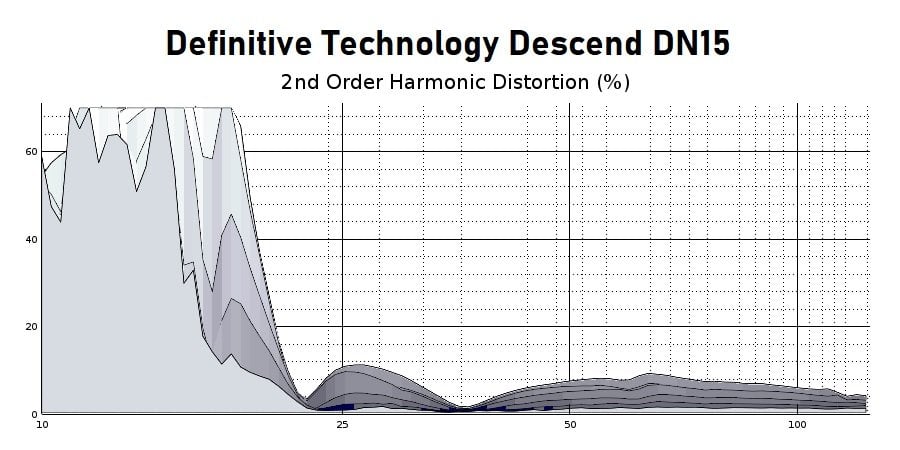

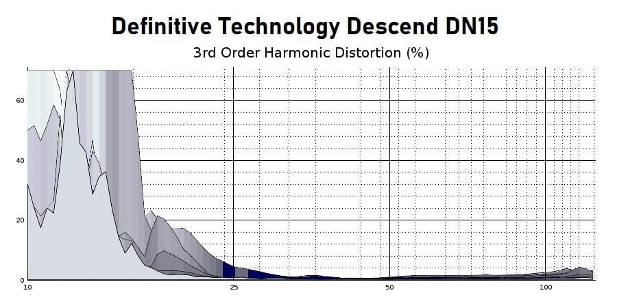

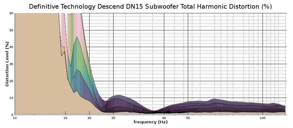

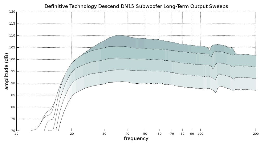

The above graphs show the corresponding total harmonic distortion to the long-term output graphs. Essentially, they depict how linear the subwoofer remains for the corresponding drive level seen in the long-term sweeps. The quantity being measured is how much of the subwoofer’s output is distortion and is shown here as a percentage.
As we saw in the burst testing, the DN15 holds its composure well, even when pushed to full throttle. Yes, there is a lot of distortion below 20Hz, but there isn’t much output in that range, so that doesn’t matter. What matters is distortion within its operational range, but it stays well-controlled above 20Hz. Distortion can barely break 10% THD even at the maximum drive level. This sub just does not want to produce any sound that isn’t in the source signal, and it maintains its fidelity no matter how hard it is pushed. I still think there is room for more amplification. If Definitive Technology did add another 500 watts, I wouldn’t guess we would see a major boost in distortion on top of the levels seen here, only a minor increase. I think it would be worth the additional headroom. However, I should say I never really topped out its headroom in my own listening.
The above graphs depict measurements of the constituent harmonics from the long-term output sweeps and are what the total harmonic distortion measurements are composed of for the 2nd and 3rd harmonics. These individual harmonics can give us a clue as to what might be the cause of some quirk or non-linearity. We are only showing the 2nd and 3rd here because they more or less reflect the higher even-order and odd-order behaviors, although higher-order harmonics tend to be much further down as a percentage of distortion compared to the second and third.
It’s interesting to see that the majority of measured distortion is even-order. That tells us that most of the distortion is originating from only one side of the driver’s excursion. I would guess, from the steady rise in 2nd-order harmonics, that the distortion comes from induction. I think that if it were suspension or motor-based, then we would see an abrupt rise at the edge of the DN15’s performance envelope, but instead, we see a gradual rise as the drive levels increase. I am not sure what measures Definitive Technology has taken to reduce induction, but there are a lot of measures that can be taken to inhibit induction. There may be room for Definitive technology to do more here and get even cleaner output, although the results may be more a technical achievement than anything that is audibly beneficial. Even-order harmonics tend to be more difficult to discern than odd-order harmonics since the spectral character of many musical instruments as well as the scaling of octaves follow even-order harmonics, therefore music recordings can do a lot to mask even-order distortion components. In other words, the nature of the DN15’s minor levels of distortion makes it very difficult to hear. The bottom line is that this sub produces extremely clean and accurate bass.

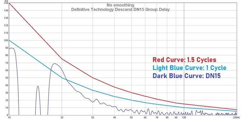

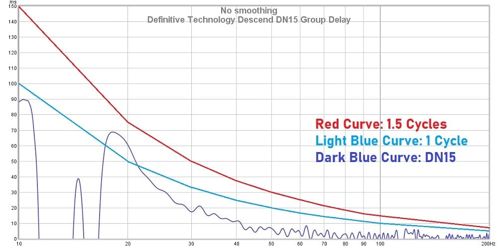

Group delay is the measurement of how much time it takes for individual frequency bands of an input signal to be produced by the speaker. It can indicate that some frequency components are developing slower than others or are taking longer to decay. It is generally thought that 1.5 sound cycles are needed for group delay to be audible at bass frequencies, although there is an argument that group delay should remain under 20ms to be completely unnoticeable, but that is likely meant for mid and upper bass frequencies.
These time domain results are overall quite good. In the ranges where rises in delay might have an audible penalty, it is very low, not exceeding 10ms until around 40Hz. It doesn’t even exceed our worst-case scenario of group delay audibility until just above 30Hz where it is too low to matter. Group delay does break 1 cycle around 20Hz, but that is far too low in frequency to be of audible consequence. These results match my own listening impressions that the DN15 is a sharp sub with excellent transient behavior. If you are looking for a sub that can nail the quick attacks and decays of sudden sound, whether it be a kick drum or gunshot, the DN15 doesn’t have any lag or overhang to smear the sound.

Outside of the sound, I think one of the strengths is the appearance of the DN15; while it is essentially a black box like so many other subs, this one does not look like anything else on the market on account of its fabric finish. I think it looks nice, but some might find it a bit odd-looking, so potential buyers will have to decide for themselves. The LCD in its minimalist cube appearance does give it a slight retro-futurism aesthetic that I dig.
