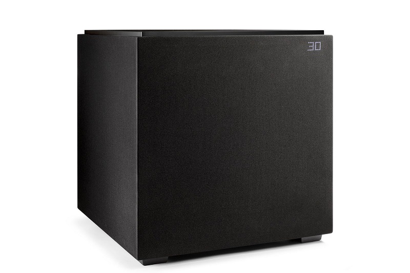

Definitive Technology released information about their new lineup of subwoofers dubbed the 'Descend Series". The new line consists of four high-performance models ranging in size from 8" to 15". The Descend Series is using a new design from Definitive Technology called 3XR which employs dual passive radiators coupled to an active drive unit. Definitive Technology claims the new design will triple the bass-producing radiating area.
The 3XR Architecture generates deeper bass and higher output levels due to the unique design of the two radiators, which are the same size as the woofer. And because this proprietary design does not rely on conventional bass ports, Descend Series subwoofers do not produce any chuffing or distortion that plagues ported models.
--Definitive Technology

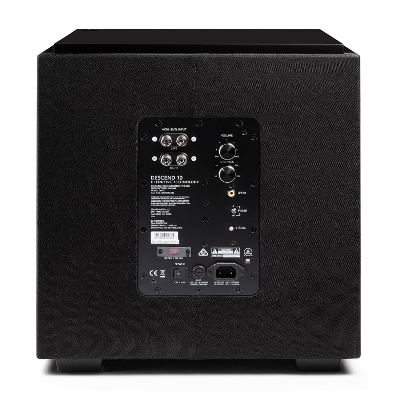

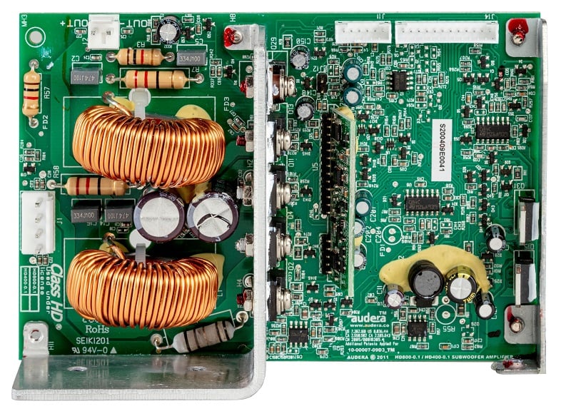

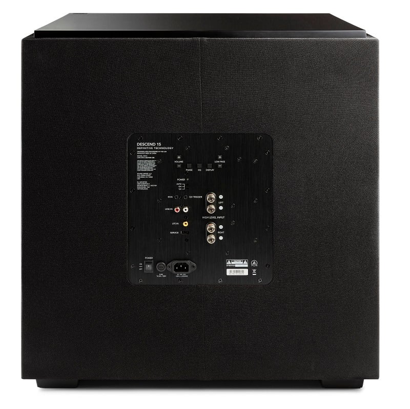

Each model also features custom amplification designed to deliver impactful, dynamic and extended bass. All four models boast connectivity via LFE, while the 12- and 15-inch models also have a stereo line level RCA input. All four models are available in non-resonant cabinets finished in Midnight Black and two models (DN8 and DN10) are also available in Glacier White.
Definitive Technology was founded on the premise that superior technical innovation can deliver thrilling high-performance audio experiences for any need or application. We take R&D seriously, and we're home to some of the best engineering minds in the industry. The Descend Series is a must-listen for anyone who appreciates impactful, dynamic and extended deep bass” Sterns added.
--Frank Sterns, President of Definitive Technology
The Definitive Technology Descend DN15 and DN12
The Definitive Technology Descend DN15 and DN12 are 15-inch and 12-inch subwoofers and have been designed for reference music systems and significant home theater applications. Each model is powered by a custom-built Definitive Technology 1500-Watt Class H sliding rail amplifier, which should handle both transient peaks and super low bass extension. Definitive Technology claims below 20Hz (in the case of the DN15). To produce smooth and precise reproduction from the deepest bass-heavy content, 3XR Architecture pairs custom drivers with a same-sized, dual-radiator array.
 Another proprietary innovation found within the DN15 and DN12 is Intelligent Phase Control, which provides a full 360-degrees of customizable phase adjustment. To better align phase, most subwoofers offer either a polarity toggle between zero or 180-degrees, or an all-pass filter that can cause smearing. Intelligent Phase Control, on the other hand, allows you to fine-tune your subwoofer’s phase by combining the best elements of a polarity toggle, but with greater granularity, along with an all-pass filter, while automatically aligning the phase adjustment with the low-pass filter to support the entire audio system.
The DN15 and DN12 also have an advanced 56-bit Digital Signal Processor (DSP) that is designed to improve bass response and overall sound quality while closely monitoring the woofer system to prevent potentially harmful distortion at ultra-high volumes. In addition, the DN15 and DN12 have three built-in performance EQ modes (Flat, Deep, and Loud), The out-of-the-box "Flat Mode" is designed as a starting point for level adjustment and system calibration. "Loud Mode" provides listeners with the most output level and is excellent for big action movies and cinematic sound effects, while “Deep Mode" offers the lowest frequency extension possible, perfect for music reproduction, particularly passages with wide dynamic range.
The DN15 and DN12 models come with a slim remote and built-in front LED display, which allow you to adjust volume level, phase and EQ with visual confirmation from the listening position. Further, each model features a 12V trigger and IR pass-through for integration with popular control systems to achieve full functionality and custom adjustments from anywhere in the room.
The Definitive Technology Descend DN10 and DN8
The Definitive Technology Descend DN10 and DN8 are 10-inch and 8-inch subwoofers and are powered by a 500-Watt Class D amplifier matched with custom drivers and the same 3XR dual-radiator architecture found in the 15-and 12-inch models. To ensure the DN10 and DN8 are tuned to the rest of the system and room acoustics, each model features built-in controls to adjust output level, low-pass filter and phase (0/180°).
The Definitive Technology Descend Series subwoofers include a 5-year warranty on drivers and cabinets and 3 years on amplification and electronics, and are currently available for sale at DefinitiveTechnology.com and authorized Definitive Technology retailers.
Our Initial Impressions
We like what we are seeing here from Definitive Technology. Anyone can make a high performance subwoofer play loud and deep with a large driver in a large enclosure with a hefty amp. Definitive Technology seems to be pushing the bleeding edge of engineering by employing a dual passive radiator bass alignment mated with a high performance active drive unit and powerful amplifier. In order for passive radiator systems to work most effectively, you generally need 2X the surface area of the active drive unit. This is exactly what Definitive Technology is doing with the Descend series of subwoofers. We find their "Intelligent Phase Control" technology interesting and like the inclusion of an All Pass Filter which may really help integration of a problematic multi-sub system due to room issues coupled with non optimal placement. We look forward to reviewing these subwoofers in the near future.
