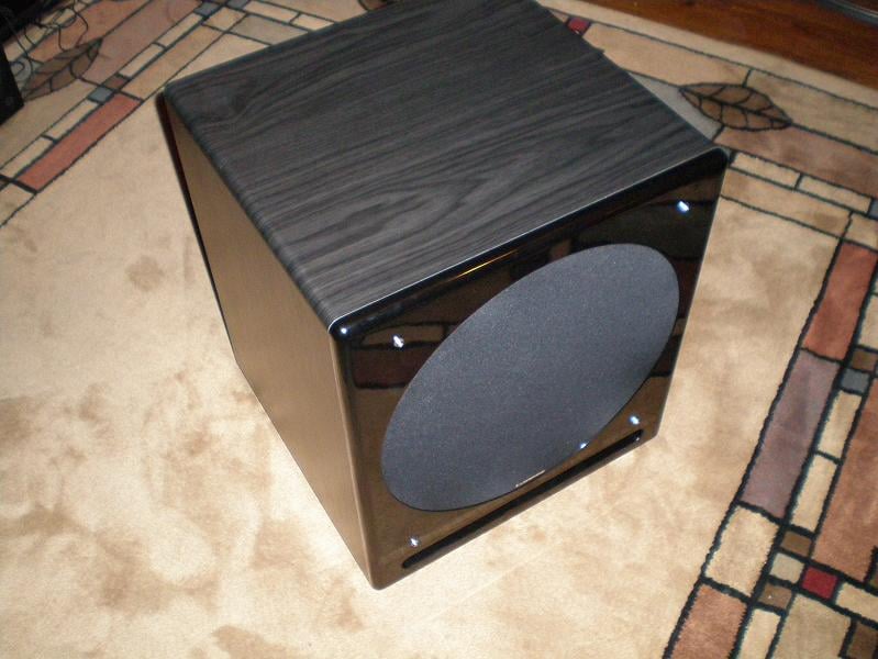

Unpacked, the CSX15 MK II looks rather nice due to the moderate size, the gloss black front panel with inset grille and the dark wood grain panels. The front panel, round grille insert and screws securing the front panel add just a little flair to the appearance, but not so much as to prevent it from disappearing into a dimly lit room. Certainly the CSX15 MK II presents itself better than its modest price tag might suggest. Despite being a vented 15” subwoofer the overall size is not outlandish by any means and is comparable with that of some 12” vented units on the market. It is a chunky unit with a weight of 88lbs but thankfully the slot vent provides a convenient handle when maneuvering it. The fit and finish and overall sense of quality exceed what one might reasonably expect from a $500 subwoofer of this size.

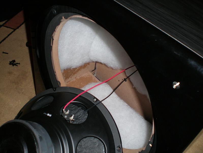

The CSX15 MK II is a moderate sized bass reflex system utilizing a 15” front firing driver in a ¾” MDF constructed glued and braced enclosure with a detachable grill. The vent providing the tuning for this system is a roughly 1.5” tall slot port running across the entire bottom width of the enclosure or about 17”. There is a modest flare to the port built into the front panel. The amplifier is rated at 300 watts rms and 600 watts dynamic.

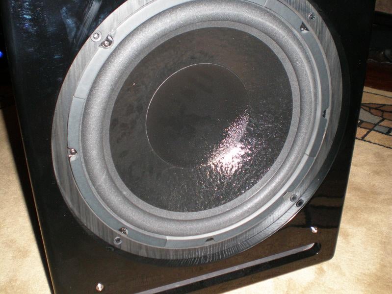

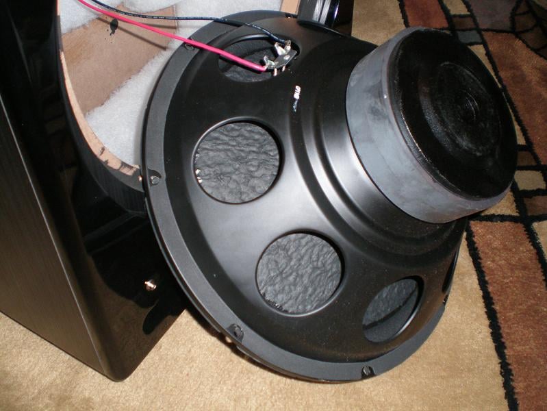

The driver at the heart of the CSX15 MK II is a moderate duty 15” unit built on a 2.5” diameter four layer voice coil on a kapton former. The motor consists of a pair of stacked ferrite magnets roughly 6” in diameter and 1” thick, an extended and center vented pole piece and a bumped back plate to clear extended voice coil incursions. The cone appears to be a heavy pressed paper that is coated with a large diameter concave dust-cap. The suspension consists of a foam half roll surround and a pair of modest sized, what appeared to be poly-cotton spiders. All of this is built on an open stamped steel frame. This is not an expensive driver by any means but appears to be quite sturdy and well suited for the purpose at hand. I have seen much lesser drivers used in far more expensive subwoofers.

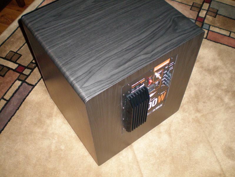

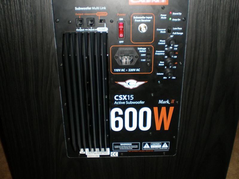

The amplifier providing control over the 15” driver in this system is a 300 watt unit with a 600 watt dynamic power rating. Rather than the very lightweight and efficient digital amplifiers that are now all the rage for powered subwoofers, Cadence literature calls this unit a high current linear class A design, makes mention of using some better than average transistors and goes on to mention a damping factor of >400 and a slew rate of 80 volts per uS in full range operation, 33K ohm input impedance, etc. The claim of a linear class A design is interesting because amplifiers with true class A operation are very inefficient, expensive and very rarely of 300 watt capability. It is more likely that the amplifier used in the CSX15 MK II is a more common class A/B design. Unfortunately I did not remove the amplifier from the cabinet to examine it due to its construction. The leads going to the woofer have very little slack and are soldered to the driver terminals while being glued solidly at the point they pass through the internal cabinet partition. This did not leave enough slack to pull the amplifier without de-soldering the speaker terminals and breaking loose the glue at the pass through point, neither of which I felt were worth doing. The amplifier sports a rather large aluminum heat sink extending from the back of the amplifier plate which has become less common to see of late. During testing and use the amplifier did get quite warm a few times but not alarmingly so and seemed to have plenty of power for this system. Even during the extremely strenuous outdoor testing it never had any issue. Though I did not see it, I suspect that a large amount of the almost 90lb girth of the CSX15 MK II comes from a large transformer for the amplifier mounted inside of the cabinet. Externally the control scheme includes the usual: Detachable power cord, input gain control, 0-180deg phase adjust, low pass crossover, crossover defeat switch, main power switch and also a 50Hz centered bass boost EQ. There is also a 110 to 220v ac input selector which can be handy. The lone input is an unbalanced RCA style connector. There is also Cadence’s master/slave daisy chain connection which allows one subwoofer to send signal to and control the others. I would’ve liked to have seen just a little more in the way of connection possibilities but what is provided is fine for probably 95% of situations.

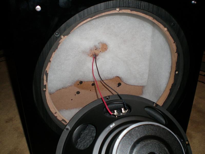

The enclosure of the CSX15 MK II is constructed of ¾” MDF which is wrapped in a synthetic black wood grain with a nice look on 5 out of 6 sides of the enclosure. The front panel is finished in a nice glossy black that enhances the aesthetic look of the CSX15 MK II. Functionally it mounts onto the front enclosure face behind it that the driver screws into and provides a countersinking effect for the driver, conveniently flush mounts the grille and also provides a small round over for the slot port exit. The amplifier plate is also flush mounted which is nice. Internally after removing the driver I was surprised to see that there was a solid panel behind the driver subdividing the enclosure almost exactly in half internally, effectively sealing off and devoting half of the total enclosure volume to the amplifier. This dividing panel, the doubled up baffle area and the slot port itself do provide a serious amount of stiffening and bracing to the enclosure panels, which combined with a light amount of poly batting on all of the enclosure walls resulted in a very inert and dead cabinet. However, since the panel behind the driver is solid with no windowing or cut-outs to allow the driver to “see” the airspace behind it, the enclosure volume is effectively half of what it should be. Additionally the slot port is also rather short stopping about 1.5” from the internal panel. This is a very small airspace for a 15” driver to operate in especially in a bass reflex alignment. The short length combined with the small airspace and relatively large port area indicate that this system very likely has a rather high tuning and will not be capable of much deep bass extension or output. Usually in a subwoofer effective enclosure volume is at a premium as it results in higher deep bass sensitivity, efficiency and allows for deeper system tuning with shorter port lengths. If the system is intended to use a smaller effective airspace and higher tuning the entire subwoofer enclosure could be shrunk down which would reduce weight, size, shipping costs and material costs while also improving S.O.A.F. (Significant other acceptance factor.) I have never seen a design with this much unutilized internal air space. It is very curious. Overall the component quality, packaging and fit and finish of the CSX15 MK II are commendable especially considering the bargain pricing.

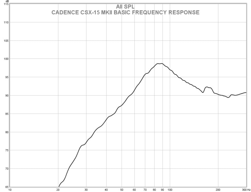

Cadence CSX15 MK II: Basic Response
Above is the basic response measurement of the Cadence CSX15 MK II in an outdoor ground plane condition with the 50Hz EQ boost and low pass filter defeated. As can be seen there is a very abrupt roll off towards the deep bass frequencies. Cadence provides an effective frequency range of 25-250Hz for the CSX15 MK II but gives no tolerance. The measurement fits within a 10dB total window from 53-300Hz. By 30Hz the response is down over 21dB compared to the peak at 85Hz. The CSX15 MK II has very limited extension. The onset of an even steeper roll off below 30Hz indicates that the rumble filter has probably kicked in with what appears to be an 18dB/octave slope.

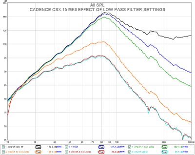

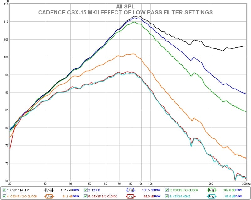

Cadence CSX15 MK II: Effect of Low and High Pass Filter Settings
Above is the effect of various settings of the low pass crossover on the CSX15 MK II’s response shape. The filter exhibits decent correlation with the labels on the control and a 12dB octave slope but the roll off of the system response and peaking near 85Hz make it difficult to discern.

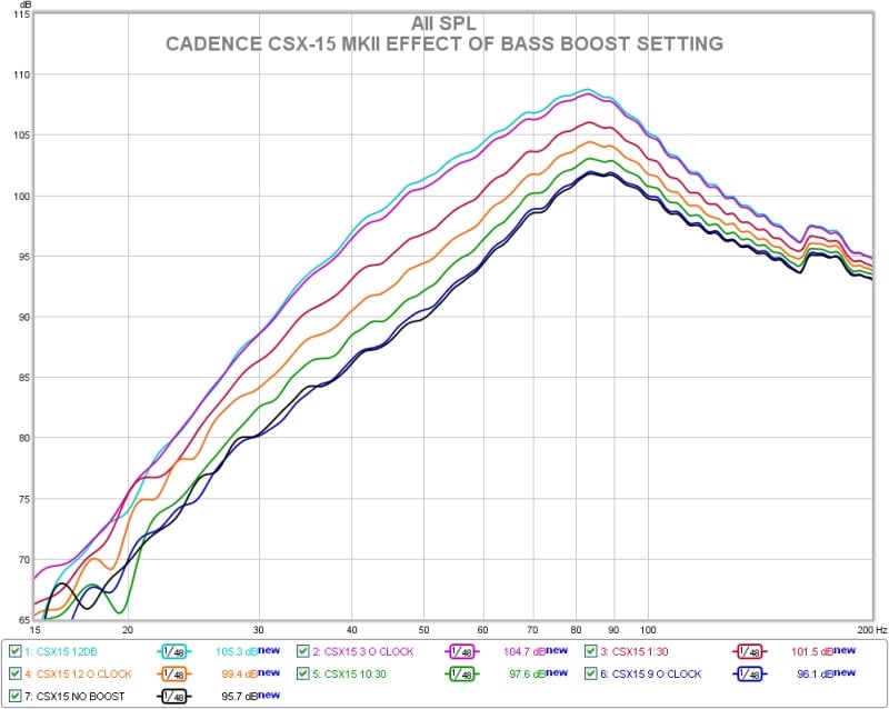

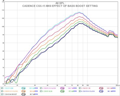

 Cadence CSX15 MK II: Effect of 50Hz Bass Boost EQ Settings
The above measurements show what changes can be made to the response using the bass boost knob and indicate that it does provide a moderate to low Q boost centered at roughly 50Hz as indicated. Varying this control in combination with the low pass filter control can produce large changes in the overall frequency response shape in order to flatten or extend the response.

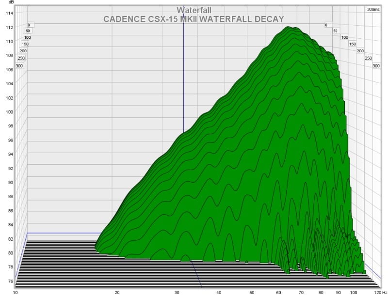

Cadence CSX15 MK II: Waterfall Decay

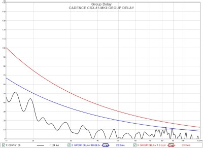

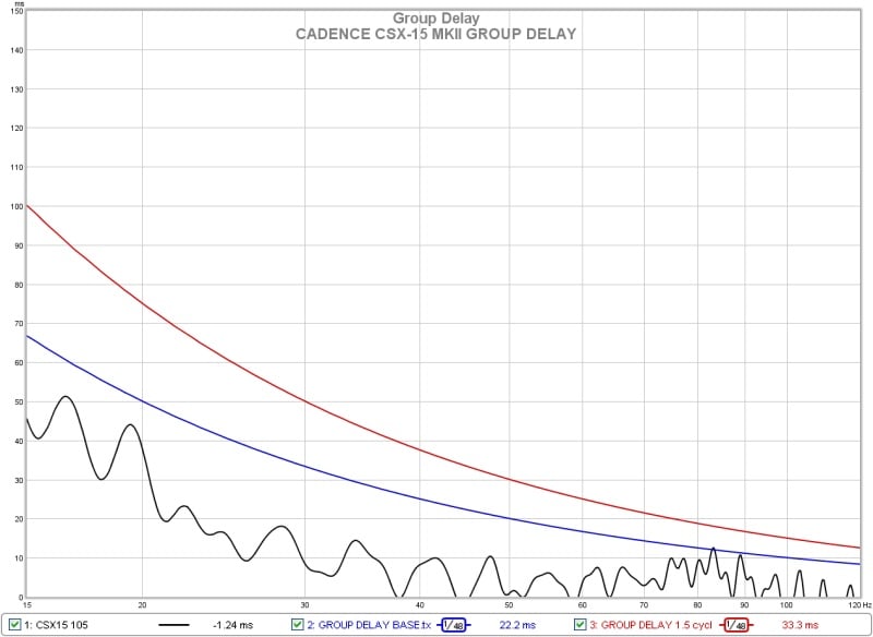

Cadence CSX15 MK II: Group Delay
Viewing the group delay and waterfall measurements of the CSX15 MK II indicate that it has no notable issues with energy storage or ringing and exhibits a clean and rapid decay of energy across the bandwidth of interest.

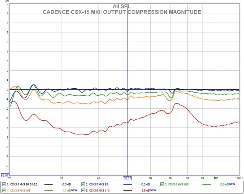

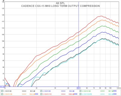

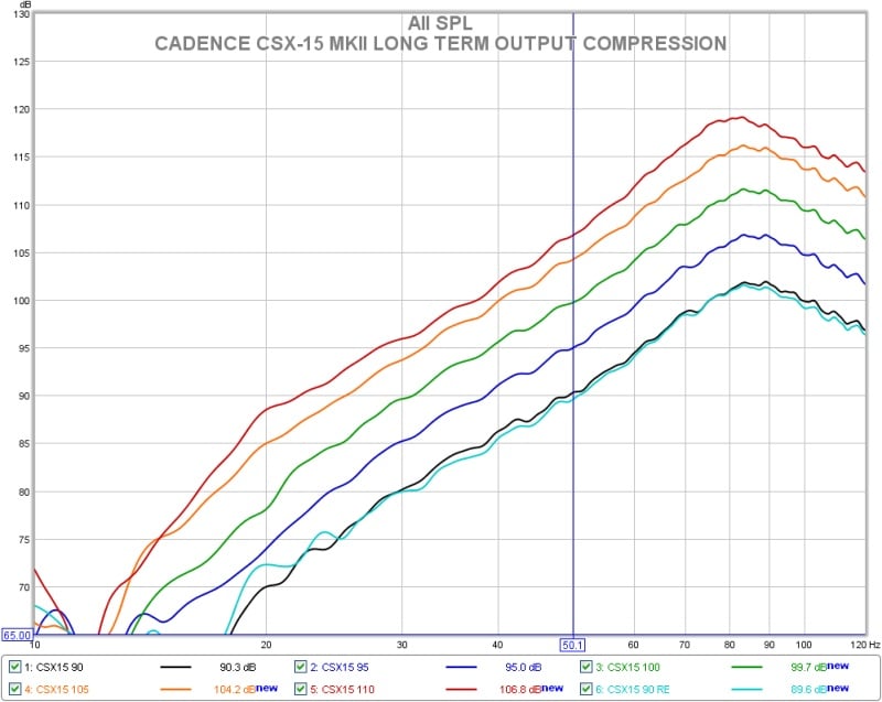

Cadence CSX15 MK II: Long Term Output Compression
Above are the results of the long term output compression test for the Cadence CSX15 MK II. Since this test is referenced to 90dB at 50Hz and the CSX15 MK II’s response is tilted heavily towards the top end it was asked to produce very high SPL levels at the top of its range even though the base SPL of the sweep is considerably lower. As can be seen the CSX15 MK II performs well with little compression up to and through the 105dB nominal sweep but increasing the signal a further 5dB resulted in only 2 to 3dB increase in output indicating that the subwoofer was out of gas by that point. Note that above 65Hz the CSX15 MK II produced in excess of 115dB and reaches about 119dB briefly near 80Hz which is very loud indeed.
Note on Output Compression Testing: This is by far the most demanding measurement type conducted on the subwoofers and will reveal any issues with overload, port compression, port noise, driver distress, cabinet creaks, rattles, buzzes, clipping, etc. Additionally this is outdoors with the subwoofer operating alone and with no nearby walls or objects to vibrate and no upper frequency content from other speakers that would normally help to cover up or mask any objectionable noises from the subwoofer in a typical room. Any sort of audible distress or issues with the subwoofer will be readily apparent in this environment.
During the high power sine wave sweeps the CSX15 MK II was well behaved up until the 105dB nominal sweep where some distress noise from the driver was in evidence below 40Hz. By the 110dB nominal sweep level the driver was obviously badly overloaded below 40Hz and produced a loud doubling noise accompanied by lots of distortion. The extra high tuning of this system coupled with a rumble filter that appears to not kick in until almost a full octave below the tuning frequency puts the driver into a situation where it is unloaded below the tuning of the vent but still capable of receiving full power from the amplifier which is not an ideal situation for a bass reflex system to be in. There was never any significant port noise or noise from the cabinet itself which was stoic throughout and free from buzzes, rattles or any other spurious noises.

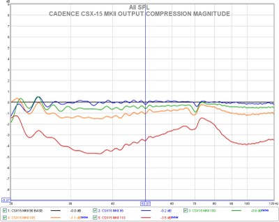

Cadence CSX15 MK II: Output Compression Magnitude
Looking at the output compression measurements in a different manner which only shows the amount of signal compression occurring, again indicates that the CSX15 MK II is basically free from compression up to and through the 105dB sweep level but has entered heavy compression during the 110dB sweep indicating that it is out of useful headroom by that point.

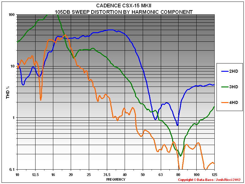

Cadence CSX15 MK II: 105dB Sweep Distortion by Component

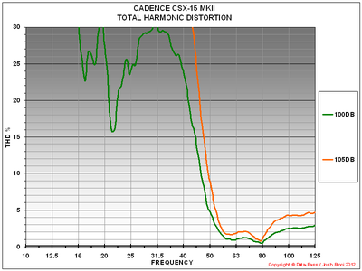

Total harmonic distortion and distortion by harmonic component testing reveals that the CSX15MK II has very low THD levels above 50Hz even when driven to extreme output levels, but below 50Hz the THD skyrockets even with much lower output levels. With bass reflex systems this is a common occurrence below the vent tuning which in this case appears to be about 50-55Hz judging from some of the measurements. Of note is that the distortion is greatly dominated by the second harmonic which is held as the least offensive to the ear so despite elevated levels below 50Hz the distortion may not be as audible as that from a subwoofer with lower overall THD levels but containing a higher concentration of higher order harmonics.

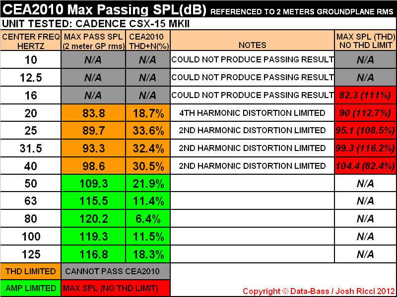

Cadence CSX15 MK II: CEA2010 2 Meter Groundplane RMS Results
Cadence CSX15 MK II: CEA2010 2 Meter Groundplane RMS Output

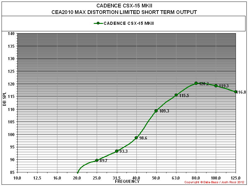

CEA2010 Results
The 2 meter groundplane rms CEA-2010 maximum short term distortion limited output results for the Cadence CSX15 MK II indicate that there is a massive amount of clean headroom available over the 63-125Hz octave, even breaking 120dB at 80Hz and that it still provides nearly 110dB at 50Hz. The CSX15 MK II is amplifier limited at 50Hz and higher in frequency. However the maximum output plummets quickly below 50Hz with a passing result of 98.6dB at 40Hz, 93.3dB at 31.5Hz and a passing output of only 89.7dB at 25Hz. If no distortion limit is imposed the CSX15 MK II can generate roughly 6dB greater output below 50Hz but accompanied with extremely high levels of distortion. This behavior in the deep bass is unsurprising given that these frequencies are below the system vent tuning. The measurements suggest that the CSX15 MK II’s effective useful extension is limited to 30 to 35Hz in room and that good bandwidth uniformity is only maintained into the 50Hz range.
