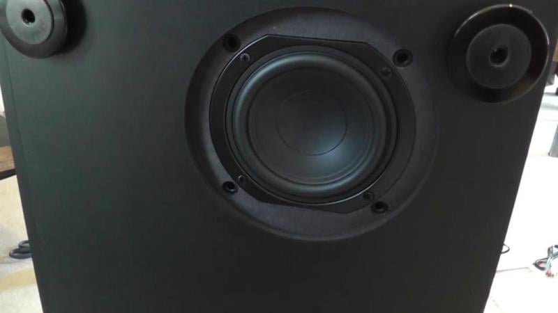

There are two 5.25” subwoofers built into a separate chamber in the bottom of the enclosure and rear-ported. This means that there is no external subwoofer, which is great for those trying to avoid extra speakers in their room, which is the whole point of this product. In my large/open room, the CS3 was linear to 40hz and I was able to get to the rated 35HZ at about -6db. All these drivers are powered by 80 total watts of amplification.
The appearance of the CS3 is all about blending in with your flat panel, not standing out. With the exception of a small silver badge, the black vinyl enclosure and black cloth grill disappear in a dimly-lit room. And let it be said, I’m a sucker for magnetic grills. Being able to reattach a grill with one hand and your eyes closed is just too cool, and having a clean, unmarred front baffle when running your equipment sans grill is a big win in the aesthetics column. If someone knows of a downside to magnetic grills, other than the slight additional manufacturing cost, please let me know because I’m having a hard time seeing why you’d want to do it any other way
One of the 5.25” subwoofers in the bottom of the Speakercraft CS3.

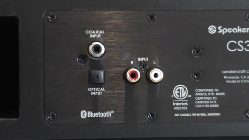

Setup is as simple as any audio-only soundbar. You just connect power, and then connect you input of choice: optical or co-ax digital, analog RCA, or paired via BlueTooth. Once paired, the CS3 remembered my Nexus, but can only be paired with one device at a time, so if you connect a visitor’s device, be prepared to repeat these steps on your everyday gadget when they leave.
A word on the digital audio inputs: as a sticker placed over them noted, the optical and co-ax input will only play back linear-PCM signals. If your source component does not convert Dolby and DTS encoded signals to linear PCM, you'll need a separate converter device, or you’ll need to just use the analog inputs. All of my testing was done with the analog inputs, and I thought the sound was great, so don't be disappointed if you decide to go this route.
Speakercraft CS3 Input

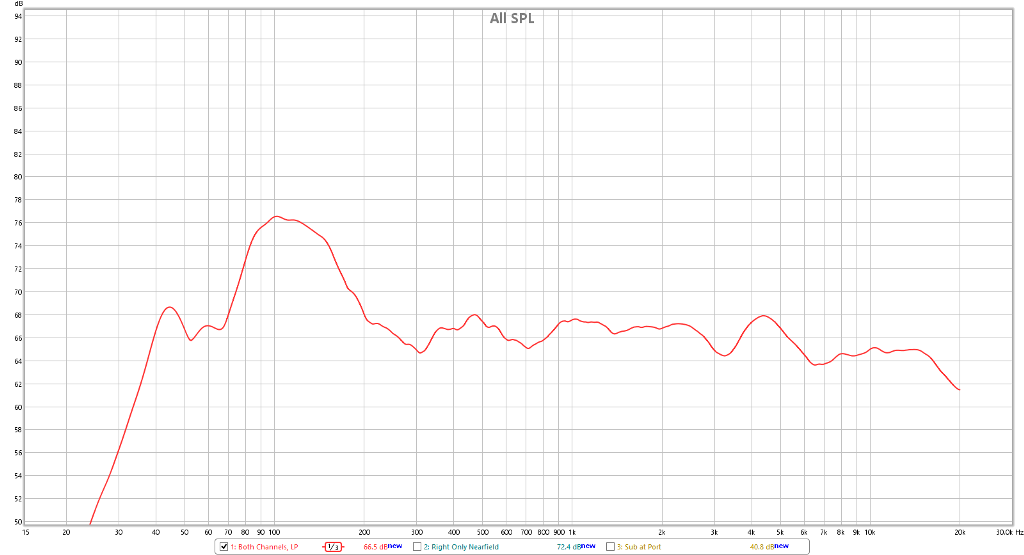

In fact, the CS3 sounded really great. It was among the loudest of the soundbar systems I've tested maxing out at 92db on pink noise from my 11’ listening position. The flying monkey attack in this year’s Oz properly pushed the CS3, and while it didn’t shake my seat, the low-frequency effects were appreciably tactile which is no easy feat. Male vocals did get a little “chesty” at times, but a measurement from my listening position revealed a room mode around 100hz, so I’m placing the blame squarely on room placement Just keep in mind, you won’t be able to move the CS3 around for ideal placement in the way you would a separate subwoofer.
⅓ smoothed Frequency Response at Listening Position (11’)
