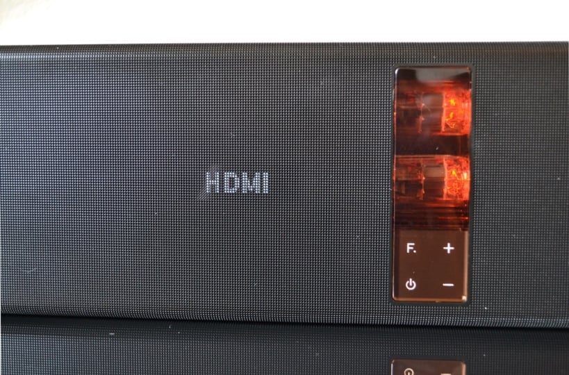

As for the HW-F750, it’s busting at the seams with features. One of the most dominant and unusual is a vacuum tube input stage. Vacuum tubes are a staple of high-end audio and can dramatically affect the sound quality of equipment. Samsung doesn’t provide any technical information about the tubes, and sadly they are not replaceable. When most people think “vacuum tubes,” they think of power amplifiers, but the F750 still has a typical class D power amp section. The tubes are part of the input stage of the design, meaning the signal passes through them before it reaches the main amp. I think it was a brilliant marketing idea for Samsung to include vacuum tubes in this design. Not only does it look cool (they’re backlight with dimmable orange lights), it makes a bold statement that this is a high-end soundbar. But, the real question is, “Is it simply a marketing gimmick, or is the rest of the unit also high-end audio-oriented?” Well, you’ll have to keep reading before we get to that section of the review.

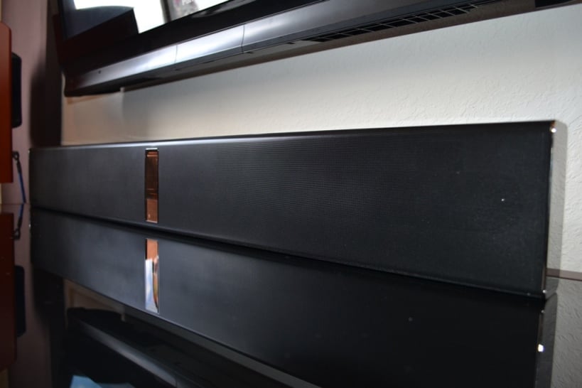

Another major feature is its dual orientations—horizontal and vertical. The HW-F750 sits flat when set on a stand, but flips upright when mounted on a wall. When set flat, the dimensions are: 37.1" W x 2.2" H x 4.6" D. However, in vertical orientation the depth and height flip, so the dimension are: 37.1” W x 4.6” H x 2.2” D. This dual orientation is nice because it allows the F750 to be short enough to avoid blocking the bottom of a TV when setting on a stand, but still be extremely thin when mounted on a wall. A few soundbars on the market follow this design, like the Bose CineMate 1 SR ($1499), but it’s uncommon.
In order to make sure the soundbar works well in both positions, Samsung installed two different sets of speakers and LED displays, so the speakers and display are always pointing at you, no matter the orientation. The second set of drivers (pointing straight up when on a stand, and straight down when mounted) are used to supplement the main speakers. The speakers facing away from you play the exact same audio as the drivers facing you, but the volume is reduced. This could give the HW-F750 a bigger, more expansive sound. The downside to this approach is that instead of being able to focus on optimizing the soundbar for one orientation, Samsung had to divide up valuable real-estate and money between both positions. The HW-F750 is packed with 8 midrange drivers and 4 tweeters, for a total of 12 drivers. There are 6 drivers on front and 6 on top (when in horizontal orientation), arranged in a T-M-M-M-M-T configuration. The tweeters are 1” and the midrange drivers are 3.5”x1.5”.

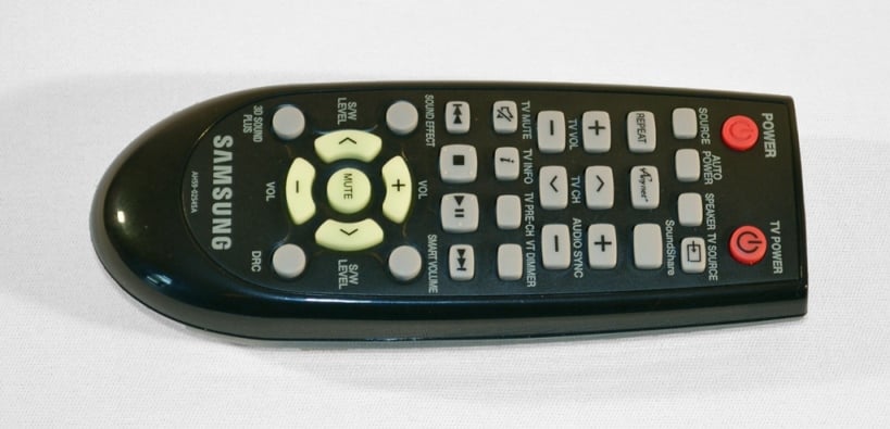

After setup, you can turn your attention to the cluttered, convoluted, ergonomically challenged remote. Samsung managed to cram 33 buttons on this tiny remote, allowing it full control over the soundbar plus control of a TV. (Ironic, since their 2012 TV remotes couldn’t control the volume on their soundbars. This was fixed for 2013). If I just spent $750 on a soundbar, why do I need dedicated TV volume +, -, mute, ch. +, ch. -, info, pre-ch., power, and source buttons on my soundbar remote? Isn’t it likely that I will use my set top box or TV remotes, or some other universal remote to control everything? Yes, yes it is likely. This poor little remote tries to do everything a unit twice its size couldn’t handle. Samsung, take my advice: forget the TV and make the soundbar remote a soundbar remote. BTW – it does control the soundbar just fine, if you can actually find the button you want.

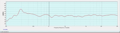

All measurements were taken in-room utilizing an OmniMic measurement system. 1/12th octave smoothing was employed and a 5ms blended response to help remove room interaction from bass frequencies.

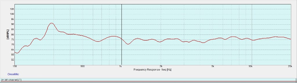

In-room 2 Meter Frequency Response
The above graph shows the soundbar’s frequency response from 150Hz to 20kHz. The large peak at 280Hz can be partially explained by room interaction. The sharp drop off at about 280Hz shows an abnormally high, high-pass filter. This explains why I heard vocals come through the sub during my listening tests. I have no doubt that the overall sound quality of the system would improve if the crossover frequency was lowered. Otherwise, the response is remarkably flat, other than a hump between 600Hz and 1kHz. It should be noted that this is a measurement of the left channel alone. Significant comb filtering was shown in measurements that used both channels, a predictable problem with the wide tweeter placement.

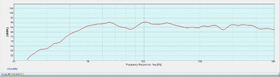

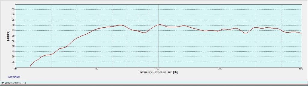

Subwoofer In-room 1 meter Groundplane Frequency Response
Normally I would measure the subwoofer without the rest of the speakers in a system enabled, but since this subwoofer is wireless, the soundbar also had to be active. Therefore, the above graph does not show a clear roll-off from the subwoofer’s low-pass filter. Still, you can see the high-pass filter kick in at about 50Hz, leading to a rough frequency response of 50Hz-250Hz +/-5dB. With a 6” driver and 2” port, I wouldn’t expect the unit to play any lower. In fact, when given a constant 50Hz tone, port chuffing was audible.

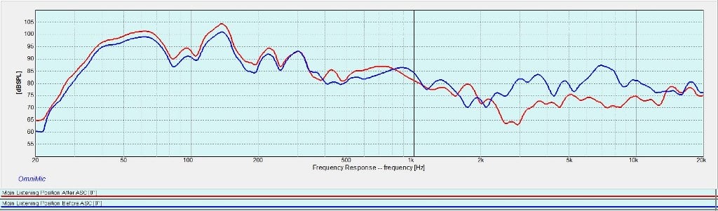

In-room Auto Setup Calibration Comparison
This last chart simply shows the results of running Samsung’s Auto Setup Calibration system. The measurements were taken at my listening position, with all settings (including subwoofer level) at default. I have never measured such poor results from any setup system. With a nearly 15dB cut at 3kHz and 7kHz, it’s easy to see why the EQ made voices sound muffled and recessed during my listening tests. Most auto setup systems are shifting their focus to do less correction in the mid and high frequencies, and instead make large changes in bass response. This was obviously not the case here. Luckily, as I said earlier, the EQ that ASC applied can be easily disabled.

The F750 is a form over function product, so naturally, I have a number of suggestions to improve its functionality. First, the remote needs to be redesigned. It should do one thing well, rather than two things poorly. Focus on the soundbar. If Samsung is worried about easy remote integration with other devices, then they should follow the lead of other manufacturers, like Polk Audio and Boston Acoustics; both of whom incorporate IR learning into the soundbar. This way, the soundbar can learn to respond to any IR remote.
