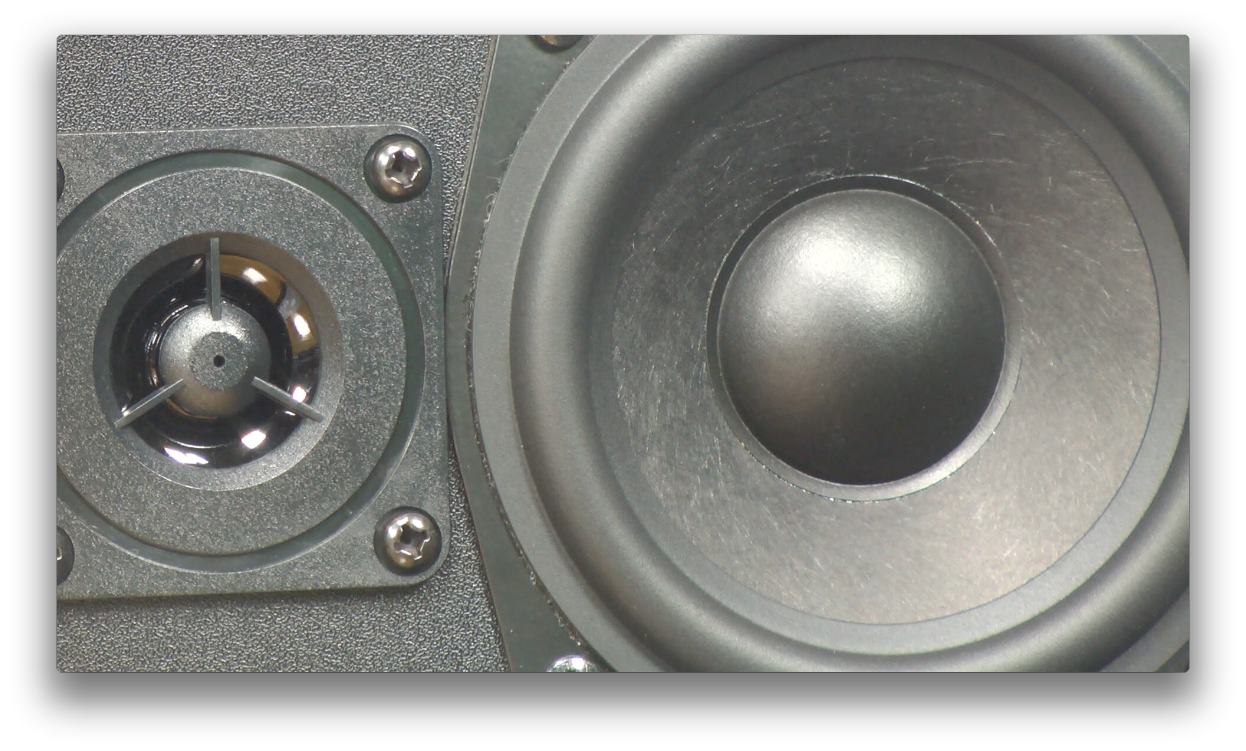

So, the OSB-1 Sound Bar is a horizontally-oriented H-PAS cabinet that has a frequency response of 47Hz- 20kHz (+ or - 3dB) and it does that with just a pair of 4" mid-woofers and a couple 3/4" tweeters...and a whole lot of fancy port technology and other tricks as we've mentioned. The drivers are actually positioned on the outer edges of the speaker, allowing for the widest natural stereo separation possible. Playing back some older Chicago, we queued up tracks like 25 or 6 to 4 and the amount of bass present from this soundbar was substantial...I mean, those who are forced into that decision of aesthetics or sound. You get the aesthetics of being able to locate all your speakers in a sound bar, but it's got enough space to put out some decent audio. When we played classical music like Moonlight Sonata as played by the London Philharmonic, the piano had a nice belly to it where the pressure of the keys was driving the mid-bass solidly into the room without losing any of the higher or lower registers of the surrounding octaves.
OSB-1 drivers

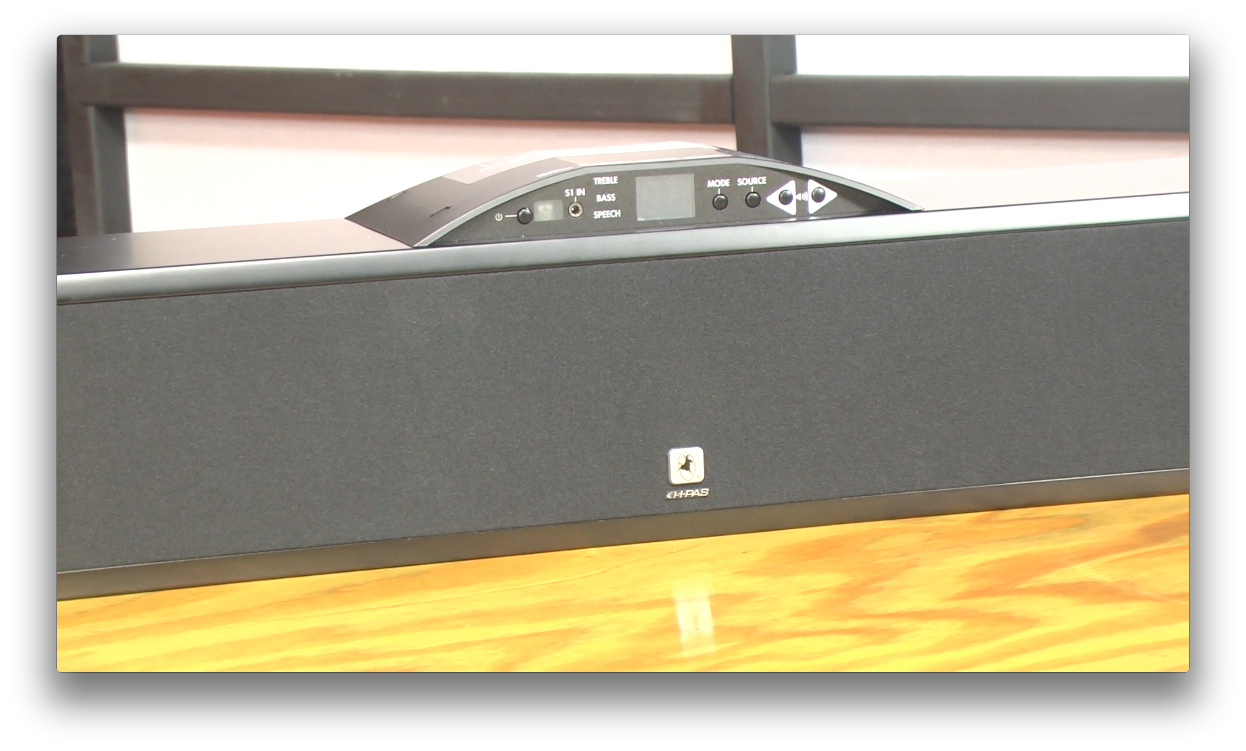

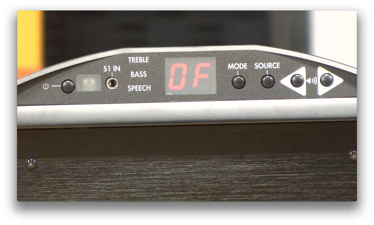

Let's talk about the physical sound bar. It's a 43" wide, 5.5" tall rectangular enclosure with tapered ends that is designed to aid in reproducing the simulated surround effects present in the system. On the front you have a two-character display that provides feedback on source, volume, whether a sub is connected, and the audio playback mode. It takes a little getting used to but we found that we learned the naming scheme pretty quickly. The OSB-1 can also be set on a shelf or flipped upside down and wall-mounted. When you flip it, Outlaw provides a way to also flip the display and the grille - and there is even an inverted control panel label so you don't have to read the default one upside down.
display

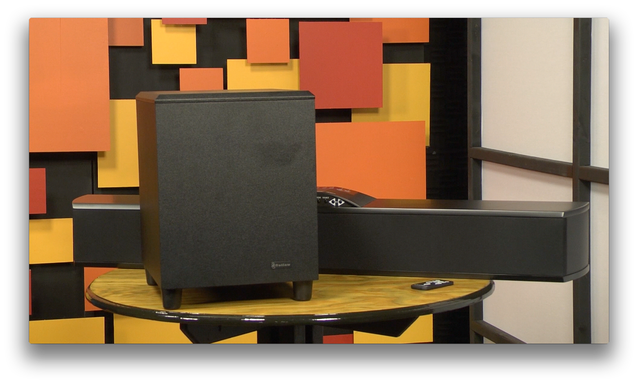

Now, the cost - the OSB-1 runs $799 so it's not meant to be a budget product for those looking to gain only slight  advantage over their televisions. This is a system that is being positioned for those who want to be able to play loud and clean without distortion. But, the OSB-1 includes a sub output so you bassheads can add in the M8 subwoofer and get the whole package for $998. That's not a bad upgrade and this is a pretty solid sub that we enjoyed quite a bit. For $200 and a cable it's almost a no-brainer.
OSB-1 and sub
