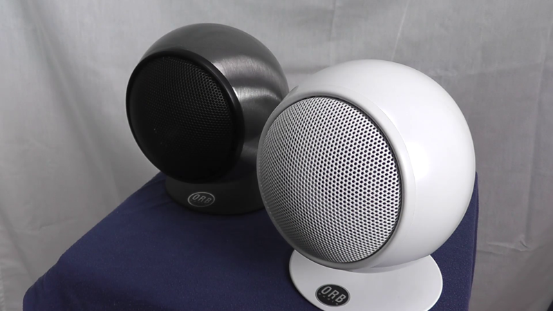

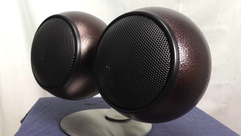

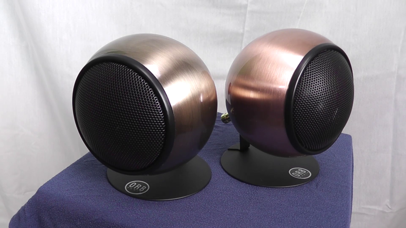

There are six standard finishes to fit every aesthetic need. Traditionalists might choose the metallic black, where Ikea-frequenting modernists may prefer the Pearl White or Hand-polished Steel. Steampunks and Victorians will be drawn to the Copper and Bronze finishes. I have many leather-bound books and my apartment smells of rich mahogany, so I was very happy with the Hammered Earth finish with its subtle texture.
There are modest upcharges of $15/per module for the hammered earth finish, and $30/module for the steel, copper, and bronze
Bronze & Copper Finishes Chrome & White Finishes
The speakers come standard with a steel desktop stand in black or white, though I was also able to audition the optional BOSS Stainless Steel Desk Stands. A variety of wall and floor stands are also available. The standard steel stand was sturdy enough to hold the speaker with confidence, and could be bent slightly to adjust the listening angle. The optional BOSS stands were much sturdier and had a nice rubber pad on the foot, but did not allow for any angle adjustment.

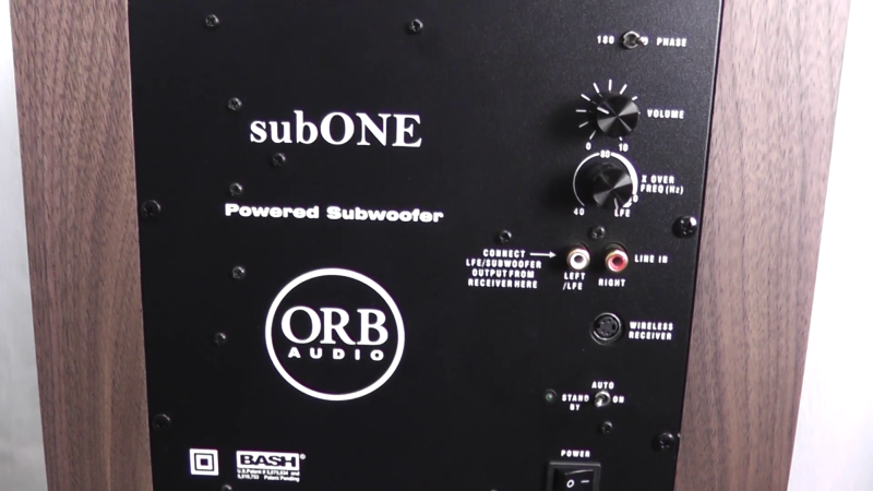

The Orb Audio subONE is an 8” composite
driver in a bottom-ported cabinet that measures 12” cubed, which is quite small
by ported sub standards. It is available
in matte black for $399, but I took a look at the real walnut veneer, which is available
for $517. Powered by a 200w hybrid
digital amplifier, the sub features a standard volume and crossover knob, with
a 0 and 180 degree phase switch and auto-sensing power mode. There is also a wireless adapter available
for $129 that is powered from a port in the subwoofer, which does away with the
need for a separate power connection.

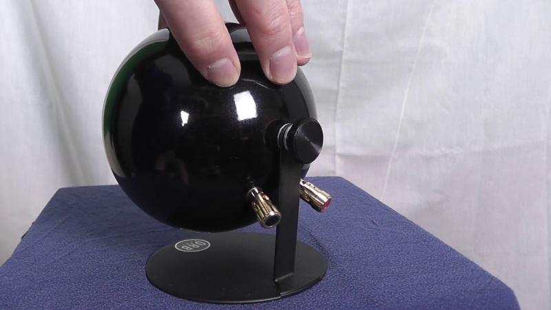

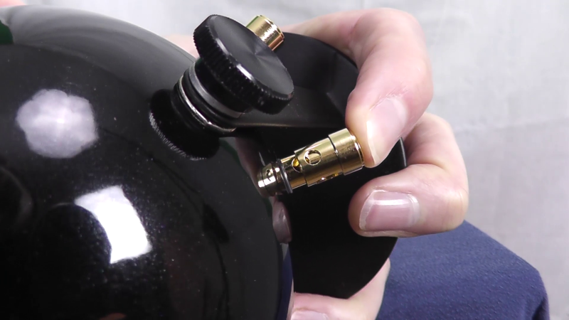

The orbs feature spring-terminals, which work fine, but did limit the size of wire and type of terminations that can be used with these speakers. This is especially true of the Mod2X, which is essential two Mod1X orbs wired in parallel. This meant that I had to fit both the jumper wires and my main speaker wires into the spring terminals, which was doable, but required nimble fingers and 16-gauge - or thinner - speaker wire. I would recommend that orb take a look at smaller banana plug options that are almost exactly the same size as the spring terminals to allow for jumper wires to be connected via rings or spade, and accommodate usage of banana plugs for the main wires.

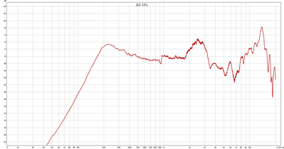

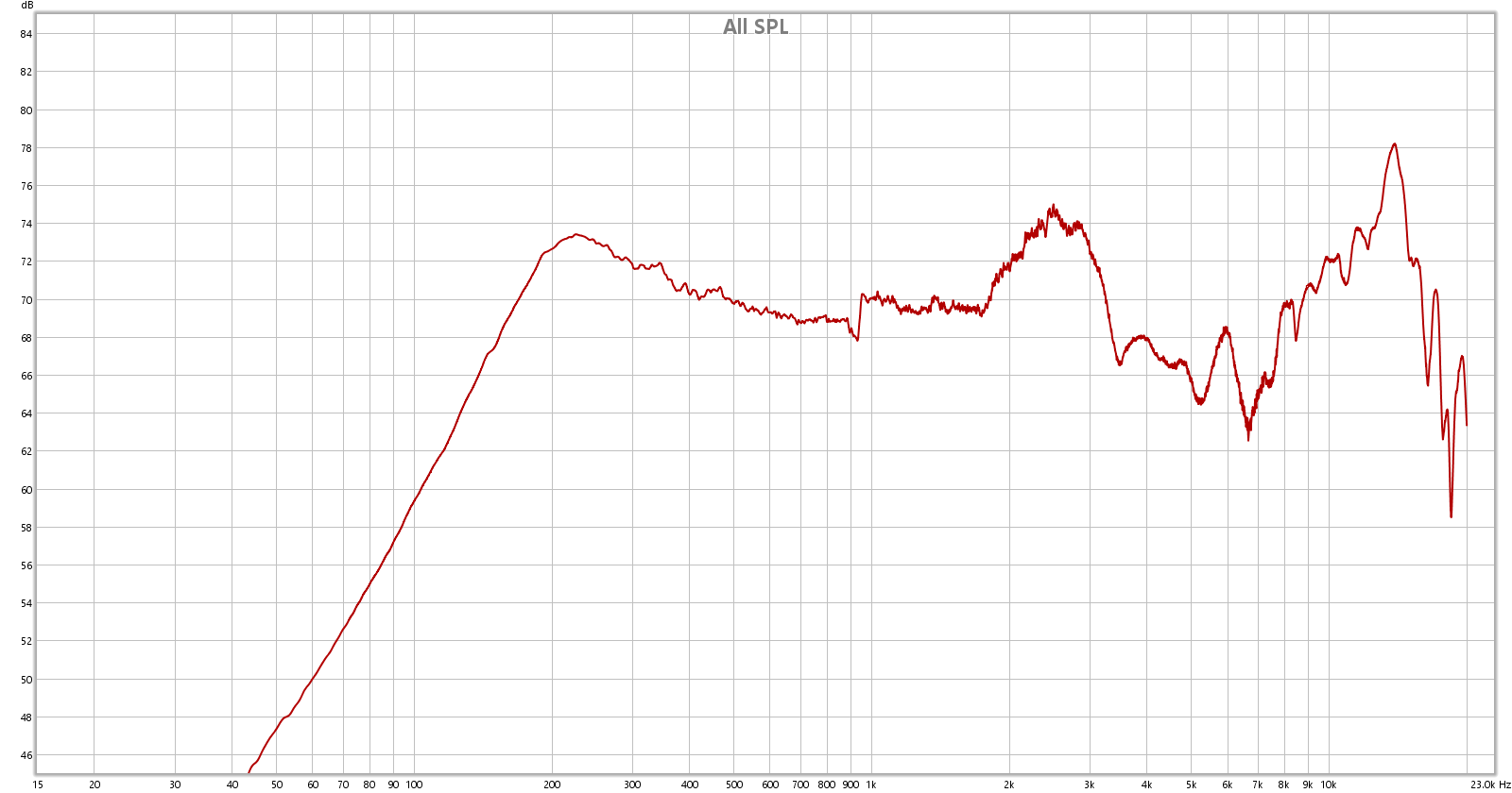

According to the published manufacturer specs, the Orb Mod1X is rated to 80Hz +/- 3db. However, my ears, and measurement microphone, showed the Mod1X dropping off closer to 120Hz measured at near-field from the center of the driver. This isn’t a problem, and I was able to crossover the SubONE at 150Hz and get a full-range sound, but I would like to see Orb double check their measurements.

Mod1x Nearfield Frequency Response
In listening, the speakers proved to be well designed and reproduced the most critical midrange bands cleanly at high volumes. This kept dialogue clear and the most critical music components present. As previously mentioned, low-frequency reproduction was restricted below 120Hz, but that’s expected with a 3” driver in a small sealed enclosure, and the subONE handily took over low-frequency reproduction duties. High frequencies weren’t exactly extended and airy, even in the near-field, but this is once again expected from a single driver design. For a system to look and sound good, I think that all the engineering choices made were solid.
