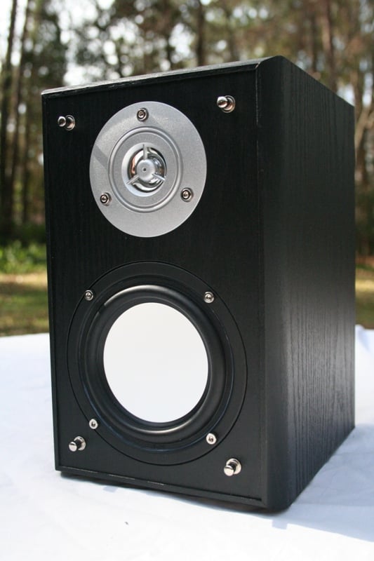

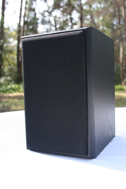

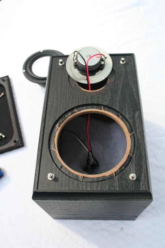

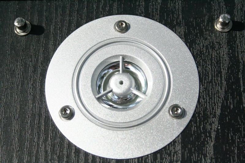

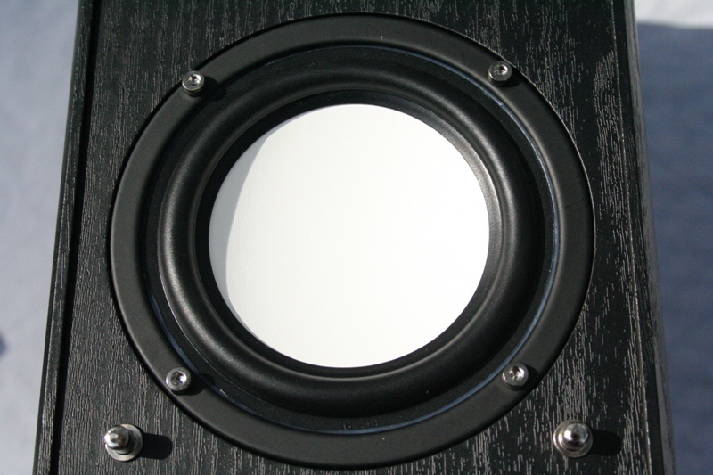

The 50-908's are constructed
out of 3/8" MDF with a very thin piece of polyfil inside. The edges are
glued and the exterior is covered in a black woodgrain vinyl wrap. The grills
fit tightly on the chrome posts. The 50-9085 bookshelf speakers come with a
metal keystone wall mount or sticky rubber feet that can be affixed to the
bottom. The 50-9080 center channel only has the sticky rubber feet without the
keyhole wall mounts.

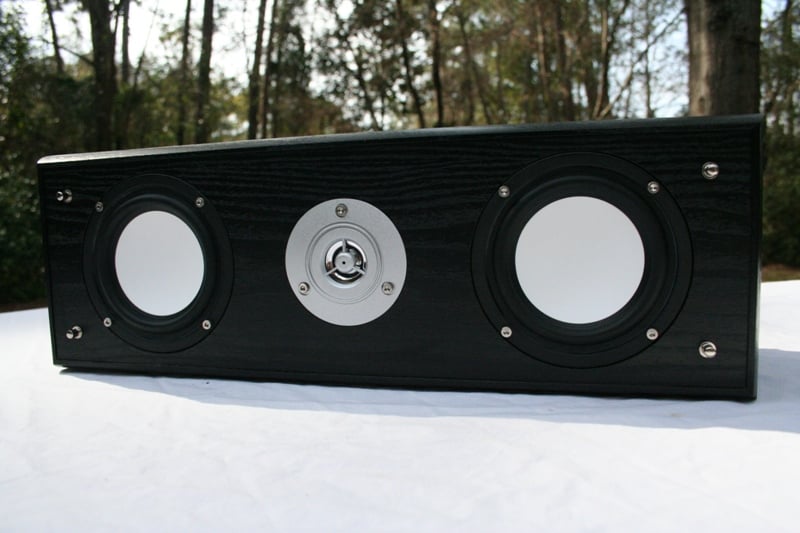

The speakers are quite small, though not as tiny as some of the cube systems out there. The bookshelves are sealed (regardless of what it says on the MCM website) which should make placement a bit easier (especially useful for neophytes that don't understand why the initiated insist that you shouldn't put bookshelf speakers in a bookshelf). The center channel has shielded drivers which are actually pretty useful at this price point. Usually, I mock shielded drivers as frivolous but mostly that is because anyone spending many hundreds to thousands of dollars on a speaker certainly isn't putting them on top of a CRT. The MCM speakers are at a price point where this could certainly be the case. I took the speakers into my office and held them up to the ancient CRT monitor that I should have replaced years ago. The smaller bookshelf speakers caused visible distortion but the center did not - verifying MCM's claim.

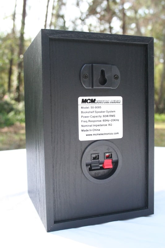

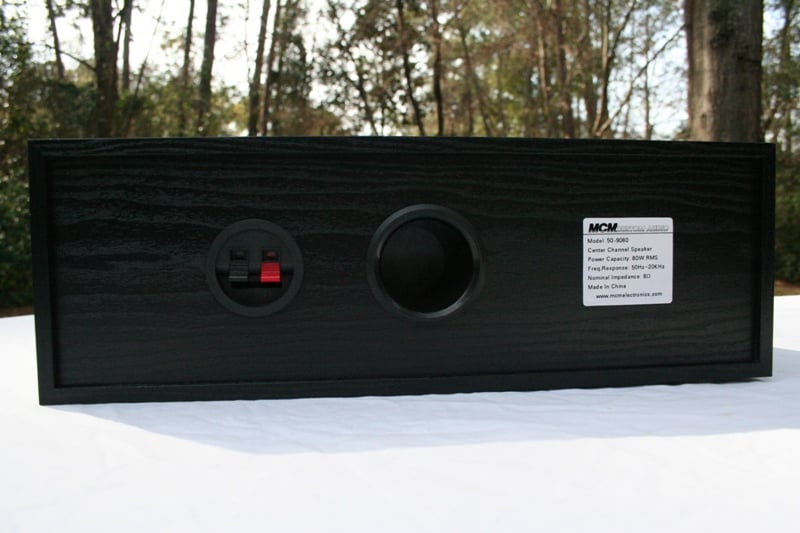

The back of the speakers
sport plastic spring clips which really only accept bare wire. You will
probably be limited to 16 AWG wire though with a little persuasion and perhaps
some trimming 12 AWG might work. The tweeter is mylar and the woofers are poly
cones that are painted to look aluminum. The overall look of the speakers is
nice especially when you consider the price. MDF is a huge step over the tiny
plastic enclosures that you might see in a competitor. The drivers take up most
of the real estate on the front baffle of the bookshelves and the center is
wide and short which will hopefully make placement in a number of different
type of cabinets easier.
