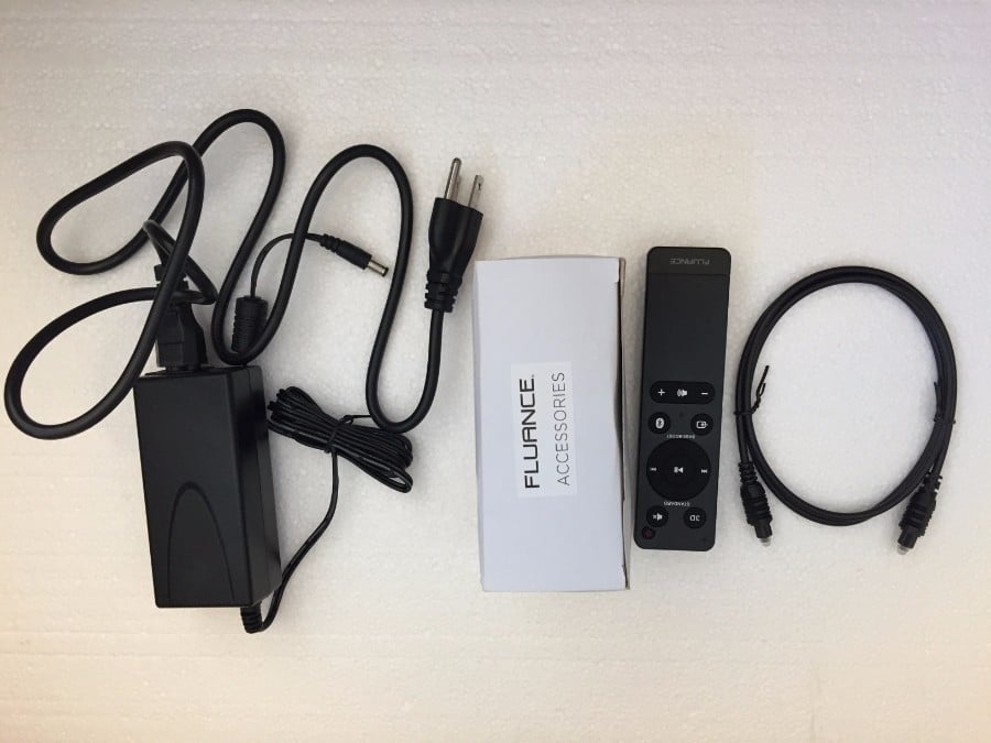

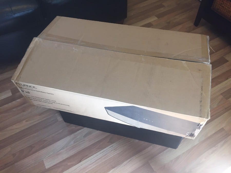

The AB40 came double boxed in corrugated cardboard. Upon opening the boxes, the unit was nicely nestled in soft foam inserts to protect the unit itself and the accessories.  The entire product arrived intact without damage or missing pieces. For the price point, it is good to see that Fluance included the optical sound cable and batteries for the remote control with the AB40.  These are the little touches that Fluance puts into their products that sets them apart from many other manufacturers. Sure we can go out and get better optical cables and longer lasting batteries, but when you are unpacking the system for the first time it’s good to know that everything you need to get started is right there.

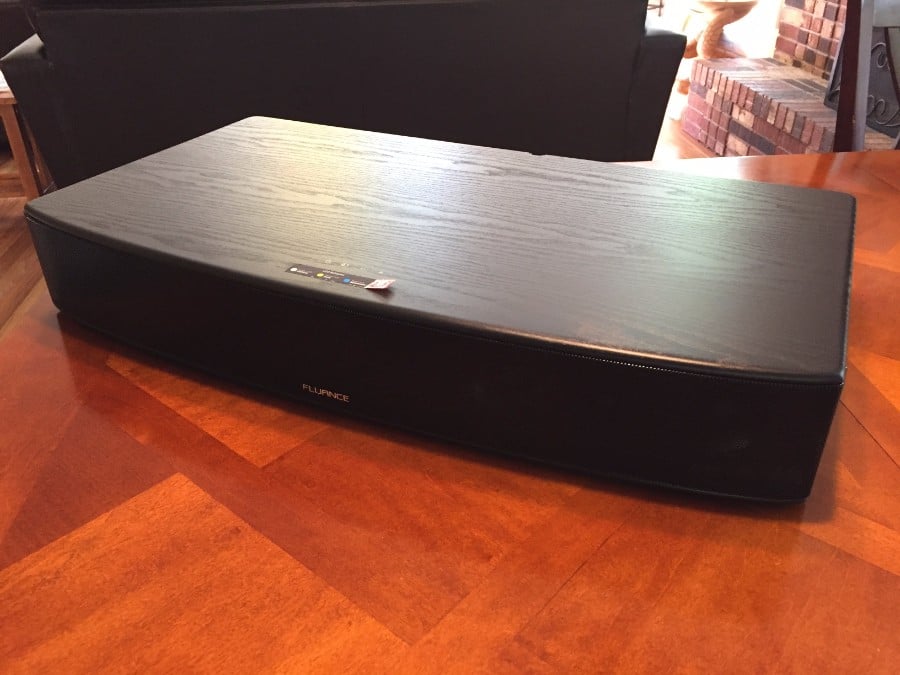

At 24 pounds, the AB40 is not especially heavy, but the cabinet itself is rated to hold up to 150 pounds! I didn’t think Fluance would appreciate me testing this particular feature since invariably they want their product back after the review. The AB40 does have a beautiful real wood exterior in a black satin finish. The woodgrain shows through and complemented our mahogany TV stand extremely well. The front metal grille is very strong, and will do well in households where curious fingers might be an issue.

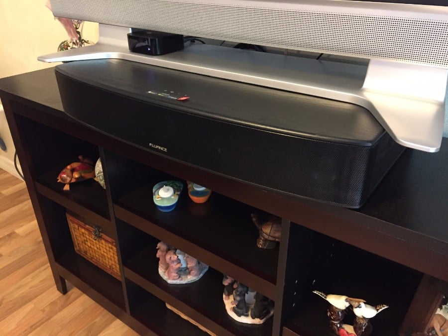

The biggest concern with a soundbase is finding one that will fit your TV. With the overall width of 26” the AB40 is 3” too narrow for my TV. Though the AB40 can be used above or below the TV like a normal center channel speaker, it might just be the push I need to mount the TV to the wall (or upgrade my TV). In fact, if we look at some of the best-selling TVs of 2017 the AB40 will not fit under the majority of them in the 50” range. But where the problem of compatibility is the soundbases’ biggest downfall, it is also its greatest advantage. The first reason is covered in our article Myths & Facts about Loudspeaker Cabinets. The AB40 is made of engineered wood whereas most soundbars are made of ABS plastic that are intrinsically inferior at suppressing resonances and destructive vibrations. The second advantage of the soundbase is the additional enclosure volume compared to a soundbar that is acoustically tuned to enable the speakers to perform at their optimum level. Much like an in-wall speaker, there are many pros and cons for soundbars vs. soundbases and the idea of free-standing vs in-wall is covered in our article The Truth About In-Wall Speakers.

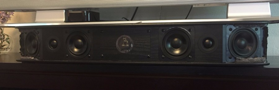

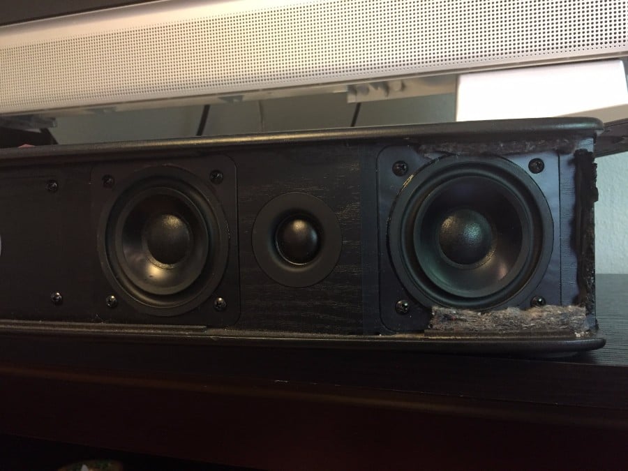

Under the hood, the AB40 has an impressive 90-watt Class D amplifier to power dual silk dome tweeters for the highs, and four midrange/woofer drivers for the lows. The outer drivers are angled at 35 degrees to help create a larger soundstage and broaden the imaging. Personally, I think that either the soundbase itself should have been curved to fit the 35 degrees angle of the outer drivers, or Fluance should have had more of an angle on these side drivers to widen the soundstage.
Each of the six speaker drivers is solidly encased in the cabinet, including the four 3” aluminum cone woofers with butyl rubber surrounds and the pair of 1" silk soft dome ferro fluid-cooled tweeters.

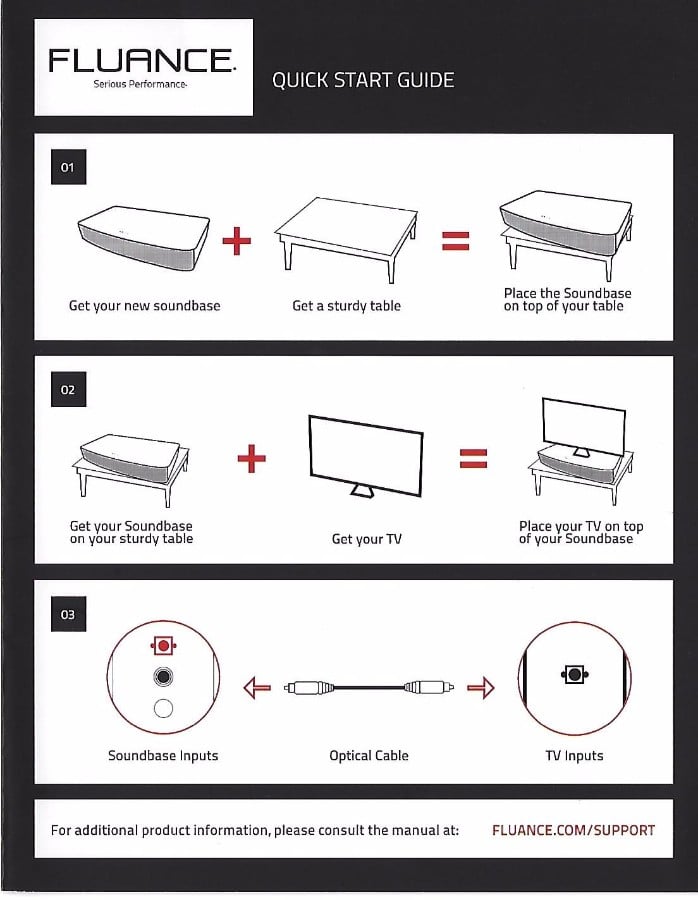

Some quick start guides are getting too quick (ie. Apple). So, when I took out Fluance’s guide for the AB40, I thought there was going to be trouble. After getting my soundbase and TV on a sturdy table (yes those are the first two steps in the quick setup guide), I used the supplied optical cable to connect the soundbase to my TV. I turned off the speakers in my television’s menu, and turned on the AB40.

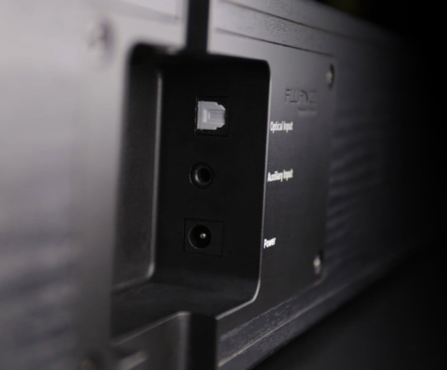

Inputs on the AB40 are pretty basic.  Optical cable, 3.5 mm aux and power.  That’s it. No HDMI, RCA, or anything else, so if you’re using an older Blu-ray player with just RCA jacks you’ll have to buy an RCA to 3.5mm converter.

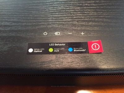

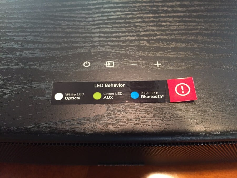

On the top of the AB40 is an LED behavior sticker that explains how the LED colors correspond to the input source, along with power and volume. White light pairs with the optical cable, green light with the 3.5mm Aux, and the blue light is for when the unit is paired with a Bluetooth device.
I expected to see these lights shine through the wood just above the sticker on the top of the cabinet and became impatient when the power light wouldn’t come on.  It wasn’t until I looked at the front of the unit that I realized the light colors are displayed through the front grille.  While using the AB40 it is important to note that the light does stay on (White, Green, or Blue), which some users might find annoying.

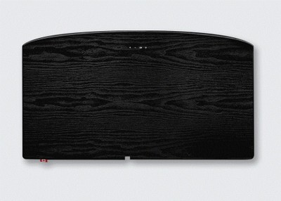

The sticker on top is designed to be peeled off by the user, and just above the sticker are some of the functioning buttons for the unit itself, including power, source, and volume control.  The buttons are not buttons per se, but touch-enabled spots in the wood.  By looking at them I wasn’t sure that they did anything at all, but they function very well in turning the device on or off and changing the volume and source with just a small amount of pressure from your finger.
