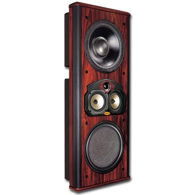

Triad Platinum Custom In-Wall
In
order to compare an in-wall speaker
to an in-room speaker, it’s only fair
that they each use high-quality components and are in the same price range.

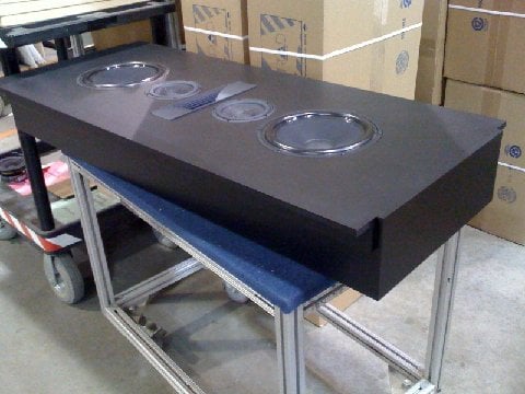

Apples to apples. There are a few high-end speaker companies that produce
freestanding speakers and directly comparable built-in versions, and their
performance is very similar. A serious in-wall design will have quality
drivers, a proper crossover network, and most likely a fully-engineered and
braced enclosure. And here is where we run into a problem. Nearly all in-wall
speakers are open-back, because it’s cheap, lightweight, and easy. An open-back
speaker will annoyingly bleed sound into adjacent rooms, but there’s another problem.
A speaker arbitrarily installed in a stud or joist space will not have the
optimum volume of air behind it as a speaker in an engineered enclosure will.
Most likely, bass will not be very good. Or it might be; who knows? Because of
the arbitrary nature of what’s behind a wall when you cut a hole, there can be
no predictable bass performance from an open-back in-wall speaker.

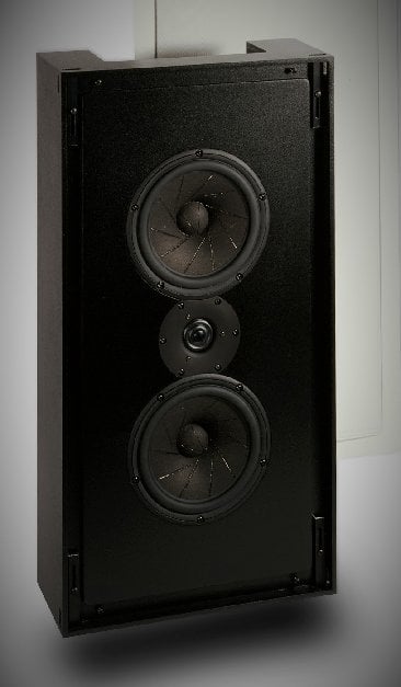

RBH Sound SI-6100R (left) and MartinLogan Voyage (right)
