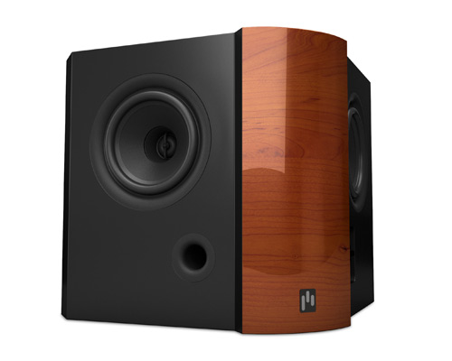

To be honest, the Verus Surround speaker is designed to be paired with the Verus Forte line more than the Verus Grand. It shares the same coaxial driver as the Verus Forte Satellite speaker though it is priced more in line with the Grand line at $299 each. Like many dipole/bipole designs, the Verus Surround has a trapezoidal shape with the drivers on the two angled faces. In the case of the Verus Surround, this equates to a single 4.25" Aperion PhaseSync driver with integrated 1" Aperion ASR tweeter on each side. They are mounted fairly high up on the baffle with a small, flared port near the bottom. We're not sure if there is a port on each baffle or if there is only one.

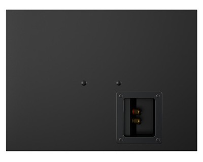

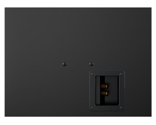

The back of the speaker is fairly spartan with a single set of five-way binding posts and two rubber nubs that cover threaded inserts for use with the included wall bracket. The speaker is a relatively heavy 13 pounds and is 9.5" tall by 13" wide by 7" deep. Like the rest of the Verus line, the Verus Surround eschews the industry standard MDF for the more rigid (and expensive) HDF for the enclosure material. The speaker comes in either a high gloss black or high gloss cherry furniture-grade veneer with acoustically transparent, magnetic grilles. A 10 year warranty, free shipping, and lifetime technical support are included as they are with all Aperion offerings.
