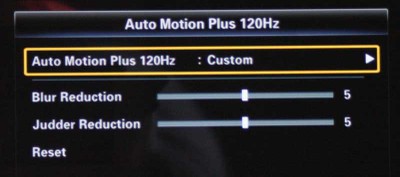

We took some time to play with the Auto Motion Plus 120Hz system, located under the Picture Options sub-menu. What we really liked was the ability to vary the Judder effect (the part of the system that removes the motion effects of 2:3 pull-down and makes DVDs and BD look like it was shot on HDTV) as well as the Blur Reduction which is supposed to help eliminate the pixel blur associated with 120Hz processing. There is a place to set the Auto Motion Plus 120Hz mode to either Off, Clear, Standard Smooth, or the above-mentioned Custom. There’s even a Demo mode that splits the screen, though it didn’t show a dramatic difference like you would see with the Standard mode.
menu - Auto Motion Plus

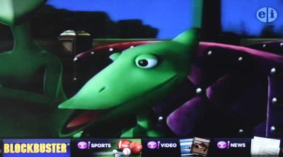

The Yahoo! Widget system is effective and gives users a wide selection of tools with which to enhance the viewing experience. The Widgets pop up over the screen and so can provide you with information or interactivity without (necessarily) covering up the entire screen. Conspicuously absent (at time of publication) is a Netflix Widget. This is extremely unfortunate as Netflix seems to be the hottest thing around these days. If you connect the 7000 series TV to an HT-BD8200 Sound Bar (as we did) you'll be able to use the network features built into that system to get Netflix as a standalone application.
Yahoo video
Widget Widget download
New Widgets can come online at any time (though they have to be certified for use with the Samsung system)

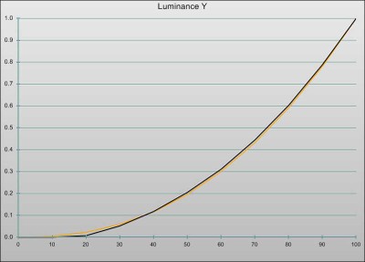

luminance
Luminance response was good and users have the ability to tweak Gamma if desired
