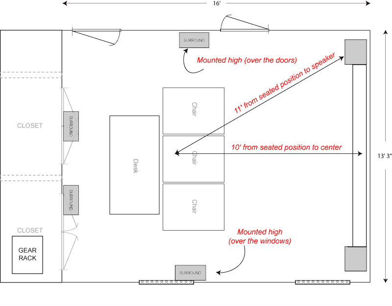

![[Speaker]](../../../images/speaker_th.gif) Loudspeaker layout should be a simple process as long as you understand a few basic principles. While there are a myriad of options, the principles of good loudspeaker positioning are relatively constant for home theater. Unlike some, who recommend full range speakers placed in a near-field configuration around a single listening position, Audioholics' stance is more of an "every seat is a good seat" approach. It does no good, in our opinion, if a home theater has a single "golden seat" and your guests (or significant other) are sitting in a bass mode or in a place where the surrounds become distracting and the soundstage is collapsed. As a result, we recommend dipole or similarly diffuse speakers for the side surrounds and careful subwoofer placement to alleviate the effects of the room's natural standing waves (bass modes). Please see our article on  subwoofer placement guidelines  for an expanded view on this topic. When possible, three matched speakers for the front soundstage are best (with a "behind the screen" center channel being a good way to accomplish this) but we recognize, as in the case of the RBH Sound CinemaSITE, that there are necessary exceptions and alternatives that may employ a different center channel. In these cases, we simply recommend (though  insist  would be more appropriate) that the center channel be very compatible with horizontal placement with careful consideration given to correct horizontal and vertical dispersion as well as timbre matching the main speakers.

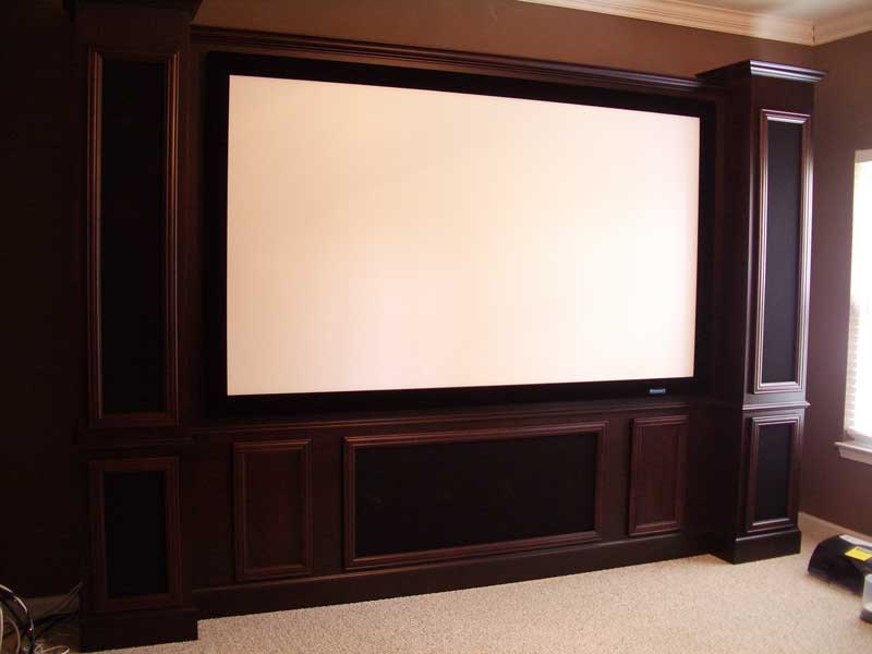

The final complement of loudspeakers which had to be configured into Reference System 2 included:
- RBH Sound Signature SI-6100 for front and center speakers (located within the CinemaSITE enclosure)
- RBH Sound Signature SI-1010P subwoofers (located within the CinemaSITE enclosure) powered by dual SA400 amplifiers
- RBH Sound Signature 66-SE hybrid surround loudspeakers (in-phase midrange drivers with dipole configured tweeters)
- RBH Sound Signature 41-SE surround back speakers
Additional loudspeakers can be used within the reference system through redundant speaker connections which were placed in strategic areas throughout the room. We did this to better facilitate testing and bringing manufacturers' products into the room without having to completely disassemble the RBH Sound CInemaSITE.
Identify Compromises and Design Constraints
Unless you are designing and building from the ground up you will likely have to identify, preferably early on in the process, particular design constraints associated with the home theater project. For some this will include issues such as ceiling height, doors & windows, compounding room modes, construction materials and budget limitations. With Reference System 2, the largest constraint was its intended "dual-use" configuration. While a dedicated home theater is typically the best solution, I wanted to be able to co-exist within RS2 and conduct measurements, write reviews and perform all of the functions associated with evaluating consumer electronics equipment. It not only made ergonomic sense, but the net result is that I can co-exist with the equipment I am evaluating and writing about.
Attempting to allow both uses to share the room space brought up some interesting issues and challenges, including the following:
- Additional networking and power requirements were needed in a second room location
- The listening positions had to be moved forward slightly to accommodate a desk
- A second row of seats was impossible
- Seated distance to the screen was decreased, resulting in a potential issue for lower resolution projectors (a minimum requirement for any projector was acceptable resolution with a screen width that was 1.5x the seating distance).
- Rear closet doors mandated a slightly higher-than-normal mounting position for the surround back speakers.
- A mandatory in-room projector location required a very quiet projector so as to not allow noise to distract from the viewing experience.
- A whole lot more cabling was going to be required to make everything run smoothly (we turned to Impact Acoustics to help us with this particular aspect of the room)
In addition to these constraints, we imposed some additional considerations when selecting the RBH Sound CinemaSITE as our reference loudspeaker system:
- The twin SI-1010P subwoofers are in fixed locations, resulting in the inability to use subwoofer placement to reduce the effect of room modes/standing waves
- A behind-the-screen center channel was not yet possible so we needed to utilize a below-the-screen center channel specially configured for that system and correctly aimed towards the listening position.
As you'll see, these design constraints were more than tolerable and we utilized a combination of speaker placement, speaker aiming, phase adjustment and EQ to correct for any anomalies caused by our particular scenario.

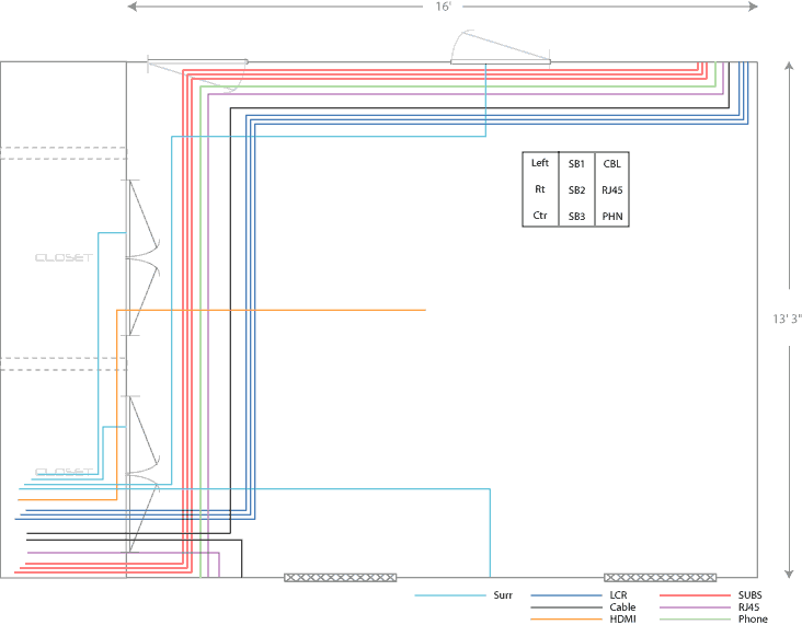

  ![[Wiring]](../../../images/wiring_th.gif) Before you go drilling holes or purchasing your wiring you'll need a diagram outlining the requirements to completely satisfy the operating parameters of the theater room. This was one of the starting diagrams we began with and it outlined the runs needed to accommodate the revised home theater setup as well as the workstation which exists just behind the listening position. We decided early on to go with  Impact Acoustics  to gather all of the speaker, networking, and interconnect wiring we'd need to complete this job correctly. Color coding helped identify what type of cables were required and made double checking the master cabling diagram much easier.
We elected to run loudspeaker cables to the front and make the terminations accessible for us to swap out with products that we would later test. I mapped out the front channels, surrounds, and rear surrounds which were all speaker level cables. The line level subwoofers came next and we ran an additional cable for a third sub to allow us to test a manufacturer's subwoofer from the front of the room. Next we mapped out RF cable runs as well as RJ45 and phone jacks. We finished by running HDMI and component video (not pictured) to the projector location on the ceiling.
All of the equipment was to be located in a closet at the rear of the room. An RF-based remote control system with IR blasters would be used to control everything as line-of-sight IR use would be impossible. Locating the equipment in the back of the room allowed us to utilize more of the front space for loudspeakers - a requirement when installing the CinemaSITE into a 13.3' wide room.

OK, let's start with the first, and most involved, part of the process… wiring. In order to get all of the wiring from one side of the room to another you'll need to either go through the attic (if you have attic access above the room), through the crawl-space (if your home has that type of access), or run the cabling through baseboard or crown molding. This is one of my favorite tricks, and while there are products available like Wiretrax which make this a simply process, others may want a more custom solution made possible by utilizing standard crown molding and furring strips. As I needed more space than normal, this latter method is the one I utilized in Reference System 2.
The basic premise is simple:
- Purchase crown molding and furring strips
- Cut to fit
- Run cabling around the top of the room and drop down into the wall (behind the crown molding) where you need to get the cable to the floor
- Add wall plates to dress up your cable drop points
- Cover and secure with crown molding, caulk, and paint

Once we were finished with the room construction it was time to load in the new equipment (we detailed the gear earlier in this article). The change from temporary system to final system was dramatic to say the least:
Temporary System Final CinemaSITE System
Check out our first look article of the RBH Sound CinemaSITE system for a full blow-by-blow of that product's integration into Reference System 2. Suffice it to say, the install was amazing, with the main system taking only about 4 hours from unboxing to installation. From there we installed the surrounds and back surrounds and proceeded to load up the equipment rack with our reference equipment.
