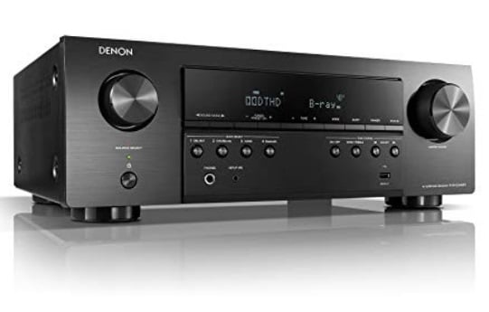

AV Receiver: Denon 5.2 Channel AVR-S540BT Receiver
Although released in 2018, the Denon 5.2 Channel AVR-S540BT is still one of the best 5.2 receivers you can get for the price. For around $250 you get a 5.2 receiver with the ability to deliver 70 watts (8 ohms, 20 Hz-20 kHz, 0.08% THD, 2-channels Driven, FTC) Although we’ll be setting this system up as a 5.1 channel home theater system, the receiver gives you the option of adding a second subwoofer in the future, which we always like the ability to do.
The 5.2 channel AVR-S540BT doesn’t include Dolby Atmos or DTS:X, but remember, we’re trying to keep the budget to a minimum! It does have the ability to decode DTS-HD Master Audio and Dolby TrueHD. The amplifier has 5 HDMI inputs which are 4K ready. HDCP2.2 and HDR10 passthrough are both supported by the receiver. Although this level receiver does not come with Audessey room correction, it does come with the Denon setup assistant which we really liked for newbies for ease of setup.
We also liked the Alexa voice control feature which will allow you to connect your new system with your Amazon Alexa to control certain features of your system. The AVR-S540BT also comes with HEOS multiroom abilities to connect your smartphone to HEOS enables speakers around your home.
With the CEDIA installers show just a few months away, most major manufacturers will be coming out with new models so you might be able to find a better receiver for about the same amount of money. For this editorial, however, I had to go with what was available to me at the time.

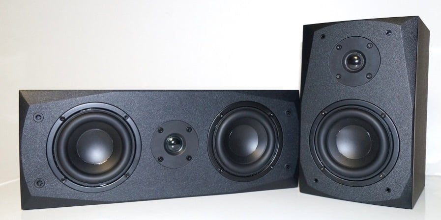

Speakers: Dayton Audio MK402
Bookshelf Speakers and MK442 Center Speaker
The MK402 is a 2-way ported design with a 4" midbass driver and .75" soft dome tweeter and sells for a meager $69/pair. The MK442 which we will use as a center channel steps it up with an additional 4" driver in an MTM driver topology along with a more sophisticated crossover network and sells for only $50 each.
When Audioholics reviewed these Dayton Audio speakers in May 2018 reviewer James Larson stated:
“I think the MK442s are one of the best value for affordable high-fidelity speakers on the market right now.”
That’s big praise from a guy who does benchmark tests on everything from $50/ to $50,000/pair speakers and rarely gives glowing reviews regardless of price.
Although we did find that the speakers ran a bit unnaturally bright in the treble area, you can correct this with the Denon Setup Assistant. In addition, Dayton Audio did a crossover upgrade as a result of our review so the 402X addresses the brightness issue and that's the model we linked up to buy from Amazon. The build quality is good for a speaker of its pricing; the woofer and tweeter are not bottom-of-the-barrel parts, and they have actual crossover circuits, unlike many sub-$100 speakers that only use a capacitor on the tweeter and even some premium brands that simply cut cost. This is even more true of the MK442 crossover which has to be the most substantial crossover circuit on any speaker anywhere near the same cost.
Upgrade Note: For $30 more than the price listed in our setup you could put three MK442s in the front of your home theater system, using one as a center channel in a horizontal position and the other two in a vertical orientation for your main front left and right speakers. In this respect, for around $60 more than what we have listed, you can use the MK442s for ALL five of your surround speakers ($200 for 5 MK442's) and have a killer speaker setup that is completely timbre matched and has more output capability. Find a way to make this happen and thank us later!

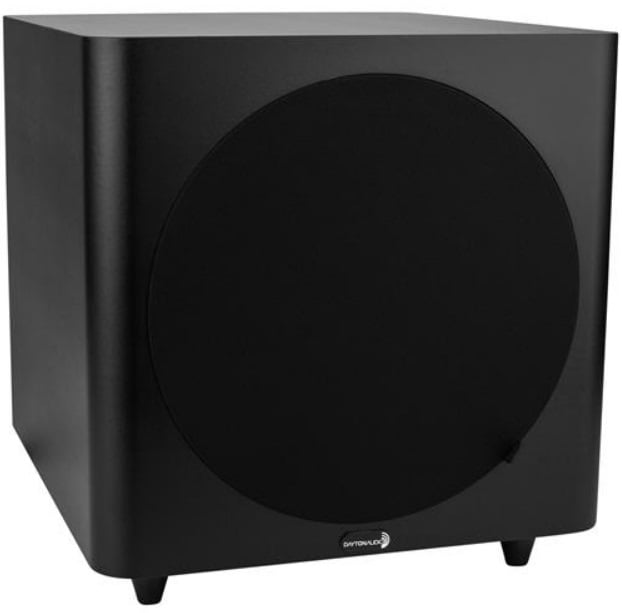

Subwoofer: Dayton Audio SUB-1000
10-Inch 100-Watt Powered Subwoofer
Dayton Audio swept the field in our speaker category for our budget system. For under $120 you get Dayton Audio's SUB-1000 active subwoofer speaker which features a 100-watt internal amplifier and heavy-duty high-excursion 10" driver. The downward-firing flared port design helps to provide clean, powerful bass and reduced noise. At 40 lb the SUB-1000 is an incredibly well-built subwoofer for the price. In fact, we’re not sure you could build a better subwoofer yourself for less money if you purchased the parts separately!

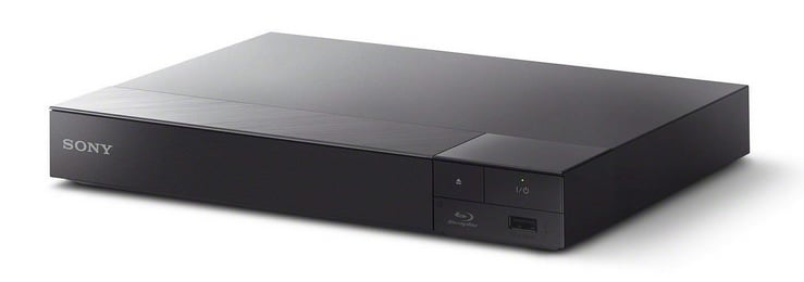

Blu-ray Player: Sony 4K Upscaling 3D
Streaming Blu-ray Disc Player - BDPS6700
For our 5.1 home theater system, we’re not including a display. We’re assuming you already have one matched to your listening area, but we did include a highly rated and affordable Blu-ray player with 4K upscaling built-in. The S6700 is compatible with DTS, DTS-HD Master Audio, Dolby Digital, and Dolby TrueHD formats. Again, no DTS:X or Dolby Atmos, but that’s not what we’re shooting for here. What you will get is a solid Blu-ray player that will bring out the best for both your sound and sights in your home theater.
The Blu-ray player comes with a bunch of additional features and apps that you probably already have on your TV, but it’s good to know they are there if you need them.
Upgrade Option: If you want native 4k, spend the extra $33 and get the Sony UBP-X700 UHD Blu-ray player. This is money well spent if you plan on watching 4K HDR content IF your display device supports it.
