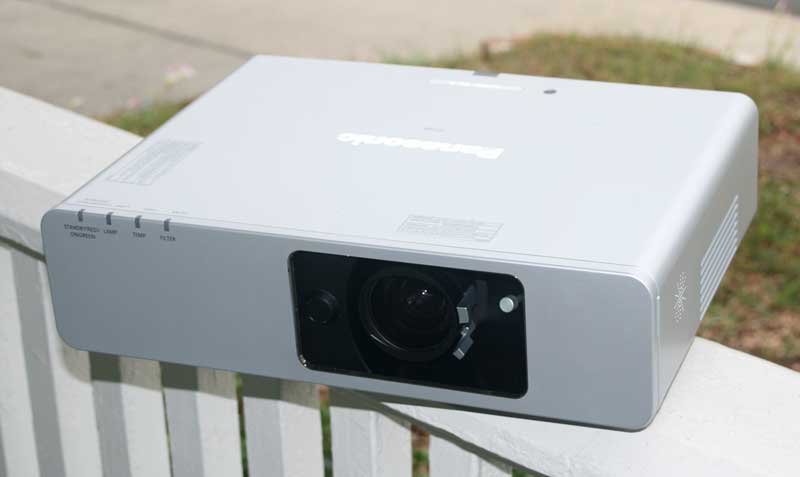

Build Quality and Features
There aren't many changes in the build quality department. The PT-F200U still maintains the Auto Rolling Filter (ARF) system whereby a dust-collecting filter auto-winds into a casing as it electrostatically pulls particles out of the path of the light engine. Panasonic specifically designed the airflow path to allow for particles to collect on the filter. This is a very cool system and since the ARF is a user-replaceable part it makes a lot of sense. The menu system even has a running "Filter Remaining" bar under the Options menu that shows how much is remaining.
They also maintained the same rear-entry lamp compartment, meaning that you'll be able to replace the lamp without removing the projector from a ceiling mount. The projector is housed in an aluminum enclosure that is very sleek. The lens is positioned about 1/3 the way into the unit and the entire front panel swings up on a hinge to reveal the lens shift, zoom, and focus controls. You can also access the menu system, input selection and soft power button. What's nice about this is that with the front panel closed, the projector takes on a very clean look while simultaneously protecting the lens and user controls from any dirt or interference. You can simply dust the front glass with traditional cleaning materials with no worries about ruining the lens coating or scratching any sensitive optical glass.

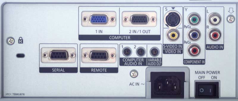

Inputs
Next to the user-replaceable lamp
compartment lie the inputs. Rear-mounted inputs seem to be standard now and
typically make for a more convenient and flexible connection method.
Like its predecessor, the PT-F200U has two RGB/PC (HD15) inputs, one of which can be configured via software to be a pass-through output (HD15 male-male adapter or cable required). There are two audio inputs (1/8-inch mini jacks) which are permanently assigned to the HD15/PC inputs. A single 1/8-inch variable audio output lets the projector control the output levels for a presentation via the remote's volume button. Component video, S-video, and composite video are also present, along with a stereo RCA input which can be configured to any of the analogue video inputs. You may ask where the HDMI input is and the answer would be: not present. This projector is analogue only and you will not be able to use digital video sources without first converting to analogue. Most sources contain at least one analogue output so we don't think this is a big issue, especially given the target market for this projector.

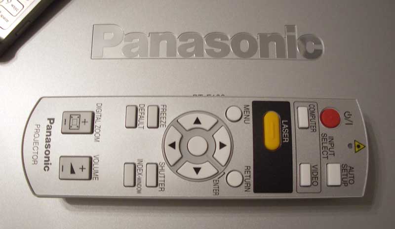

Remote Control
The
remote control is very average except for a couple of noticeable points of
interest. First, the Digital Zoom function is bound to come in handy and it
works very well. In fact, the Zoom amount is recalled on the first press of the
Zoom button, and you can hit the Return button to go back to normal mode. Using
this method you can quickly jump in and out of Zoom to emphasize the center of
the image. Digital Zoom does not, however, remember the horizontal or vertical
repositioning which is possible through the use of the cursor buttons while in
Zoom mode. There are no direct input buttons on the remote, though COMPUTER
does cycle directly between the two HD15 inputs as opposed to the VIDEO button
which cycles all inputs. The two buttons also remember the last selected input
for each, so if you are jumping between a laptop and a DVD, for example, you
can do so with relative ease. There is also a laser pointer on the remote, so
you can use it to point to interesting items on the screen, or just use it to
temporarily blind inattentive students (PS. That was a JOKE). The intriguing
AUTO SETUP button on the remote merely allows the system to set the dot clock
and clock phase for PC inputs sent to the projector. It doesn't automatically
perform an ISF level calibration to your screen or get you a cup of coffee.

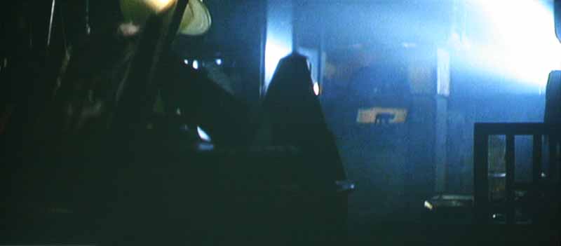

This is what a movie like Bladerunner
will look like during any of its many dark scenes. Notice the absence of black
level detail. Stick to brighter content overall for best results.

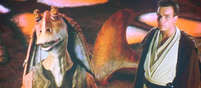

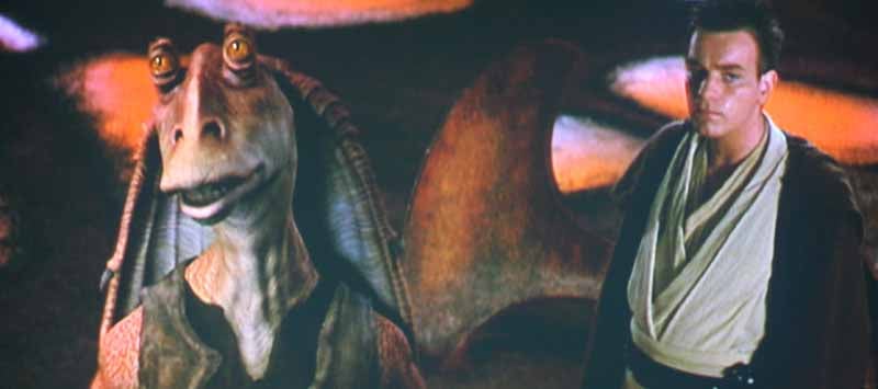

During bright scenes, like this shot from Star
Wars Episode I: The Phantom Menace, the picture looks excellent, though a
little soft due to the resizing of the image to the LCD panel's native pixels.
These guys are actually fat, not stretched. Colorful, bright images look
incredible on the PT-F200U.
