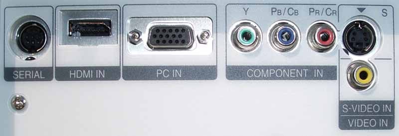

Connections

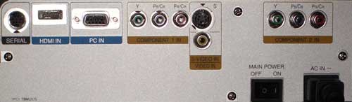

The PT-AX100U, like the model it replaces, comes with a remote, batteries and power cord - no cables are provided. Should you have the desire, however, you can fill up a composite, s-video, HD M I-HDCP, RGB/HD15, and component video inputs (only one set this time) to your heart's content. A serial connector is provided which, with an 8-pin DIN to 9-pin D-SUB adapter (ET-ADSER) that is sold separately, allows you to connect the projector to an RS-232C-based control system. Custom installers can use the pinout diagram and basic control signal info which are conveniently provided in the user manual.
There is a lot of room on this projector for making connections. Panasonic opted to remove one set of component video inputs on this unit, no doubt as a way to reassign some of the product cost to other areas, like the dynamic gamma-correcting Light Harmonizer system and more powerful lamp system.

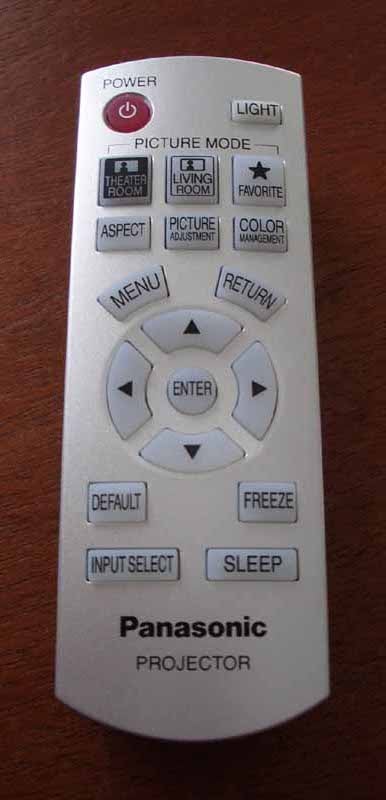

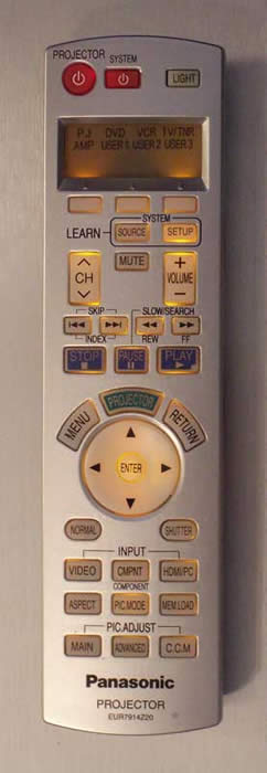

Remote Control
This would be the perfect remote (relax, there's more
                          than one "perfect" remote) if it had some direct input selection controls for accessing component, HDMI,
                          s-video, etc.
Even without the direct inputs, the fact that it has a fully backlit control face and
                          the menu/navigation system is well laid out make this a very functional remote. Gone is the "Exit"
                          button, instead replaced by a more intuitive "Return" button. There are large "Theater Room" and "Living
                          Room" buttons on the top of the remote as well as a "Favorite" button that recalls one of three saved
                          Favorites display settings (think calibrated Day/Night modes or a black and white mode calibrated for
                          ~5000K). The "Theater Room" button cycles through
Cinema1
Cinema2
Video
and
Natural
modes - while the "Living Room" button cycles through the much brighter
Dynamic
Vivid Cinema
and
Normal

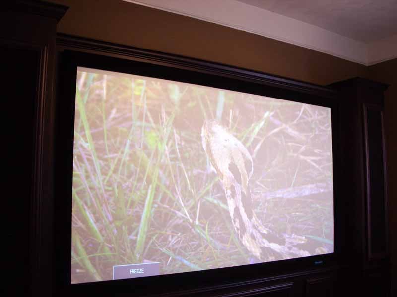

modes. My favorite button on the remote ended
                          up being the "Freeze" (frame) button that would freeze a full resolution image in screen for my camera to
                          capture -
helpful to say the least.

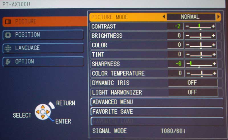

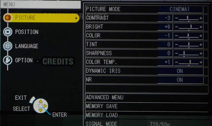

PT-AX100U Menu System

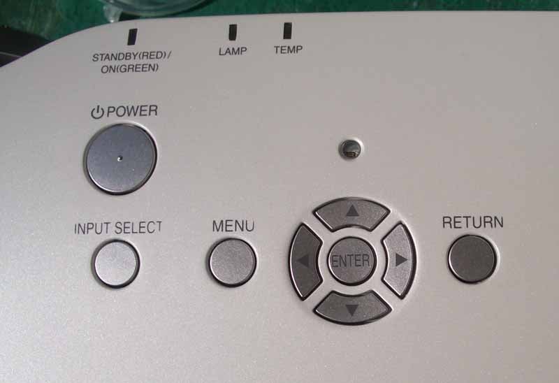

The Panasonic's menu system isn't much changed from the previous version found in the PT-AE900U. Changes include additional options for the added Noise Reduction options and new Light Harmonizer features. I won't rehash the menu system since I went through it at length in the PT-AE900U review, but I'll show the two menu systems here for comparison, along with any pertinent commentary on the changes:
Menu
The
menu is nearly identical except
                          that the PT-AX100U moves the noise reduction options to the
Advanced
Menu
and splits
                          out an option for MPEG noise reduction. "Memory" slots are now referred to as "Favorites" and the "Light
                          Harmonizer" option is visible near the bottom of the screen (Auto/Manual/Off).

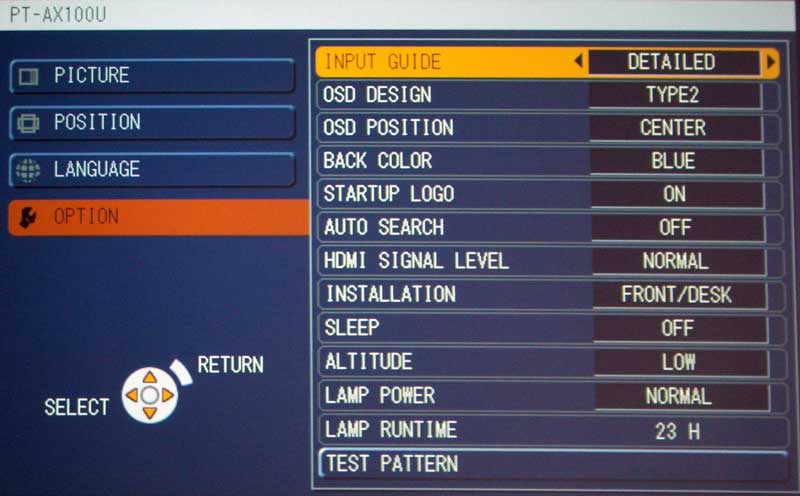

OPTION
Menu
The
Option
menu combines the Desk/Ceiling and Front/Rear projection options into one setting
                          that cycles through all four possible mounting options. An "HDMI Signal Level" apparently adjusts the
                          HDMI color range from 16-235 to 0-255 (essentially washing out your image). The rest is about the same
                          except for a few changes in nomenclature.

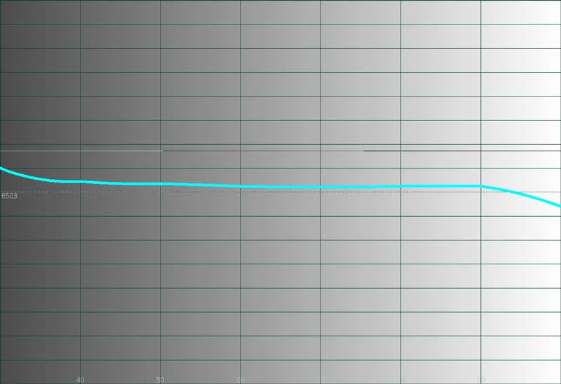

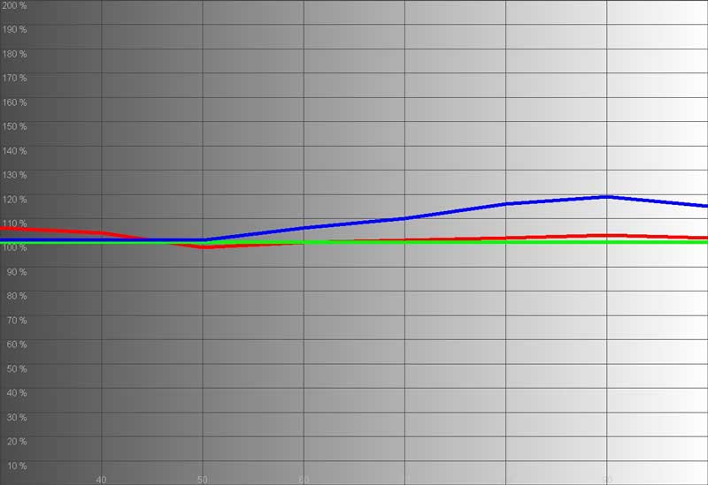

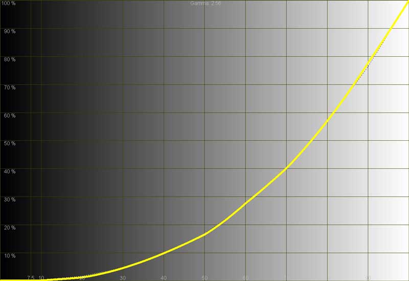

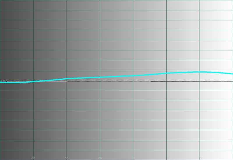

Calibration - Getting Those Black Levels Right!

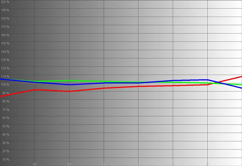

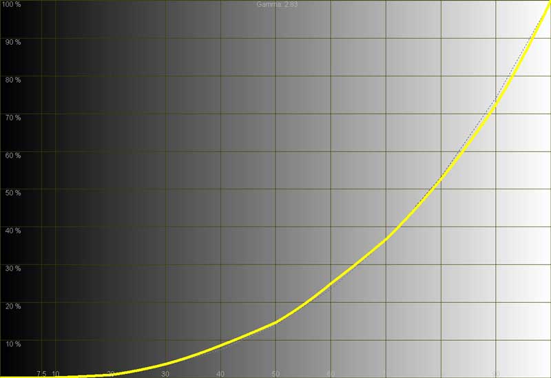

The PT-AX100U projector absolutely nails reds and blues, but greens tend to be a bit desaturated - not atypical for this type of display. I measured a "real world" contrast ratio of 1350:1 - awesome! This contrast ratio didn't change much after calibration since the white levels were spot on and the black levels were only adjusted by a couple of points on the settings bar.
We again utilized datacolor's ColorFacts Professional 6.0 software to calibrate and measure the grayscale response of the PT-AX100U. What we found was surprising and showed that Panasonic is paying attention and putting out a truly excellent product that requires virtually no initial calibration in order to look very very good. This is another difference from the PT-AE900U which needed a considerable amount of calibration in order to look its best.
Panasonic seems to be moving forward and we like the direction they are taking:
 Before Calibration  |
 After Calibration  |
 You're looking at the Cinema1 mode with no calibration. Red and green are nearly spot-on with blue lending a cool effect above 60IRE. You know what? I'll take it - this lends itself to a fantastic picture compared to other models I've seen.  |
 Calibration was touchy, red and green were very sensitive and the projector quickly ran into a point where I had to decrease the sensitivity of ColorFacts in order to proceed. Here Green and blue are locked and red seems to be the dissenting color of choice. I'm sure that with additional tweaking I could have gotten it closer to target - but is it worth the trouble?  |
 The initial luminance histogram looked decent 舰  |
 After calibration we increased black level resolution a bit and got the curve even closer to its mark.  |

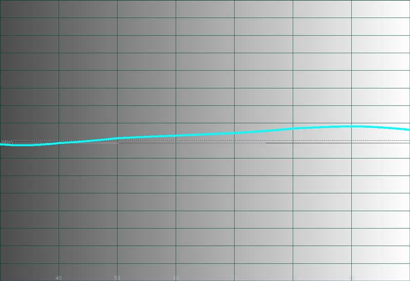

 Color temperature rose with the IRE level upon our initial measurements.  |
 Once tweaked, the color temp stayed fairly even.  |
This is a marked improvement over the default state of the PT-AE900U and represents a concerted effort to bring consumers a well-calibrated projector that needs very little tweaking in order to produce a fantastic picture. Measured contrast was quite impressive and this is exactly the type of results we like to see "pre calibration".

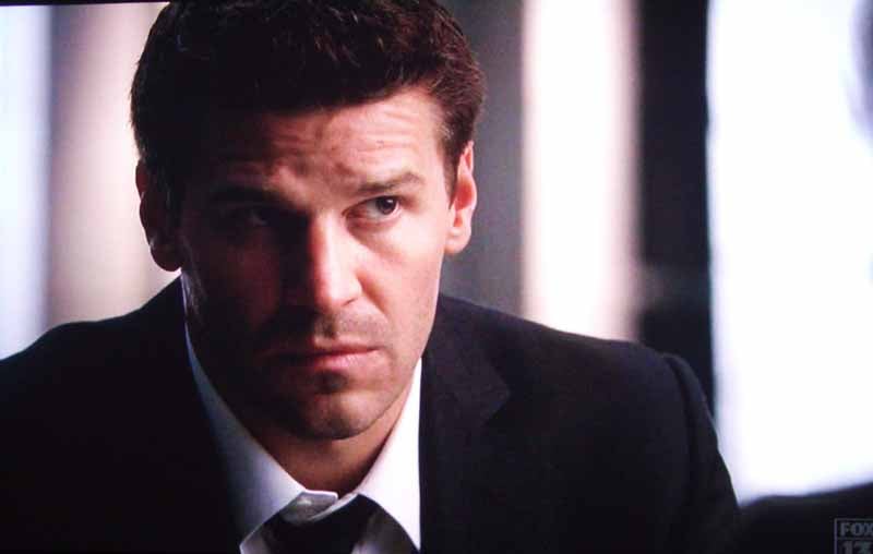

putting a projector through its paces. In addition to the dark scenes
shown here a lot of more colorful scenery was also visible, making for
a well-rounded presentation. I loved the way the Panasonic's Smooth
Screen technology allowed me to get very close to the screen (just over
11.5 feet in fact) without the dreaded "screen door effect" found in
most LCD projectors.

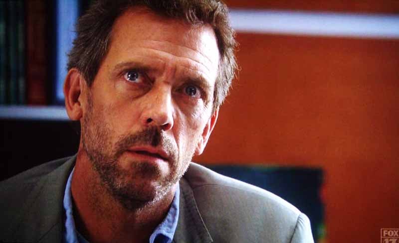

HDTV:
House
While detail was excellent,
House
showed me several scenes where I was able to compare to my
reference projector and note that the Panasonic was ever so slightly
soft on its images. This was about the same effect as if I did a manual
defocus in order to gently blend the pixels and reduce screen door

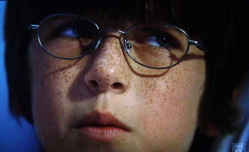

effect. I'm almost certain I like the compromise, though with a sharper
unit you will get a better picture if you are seated beyond the
visibility of the screen door effect. Look at the facial detail on the
boy's freckled face and you'll start to see what I mean about this
projector having no problem with rendering a crisp, clean picture
overall.
House
provides excellent review
                          material because it is a show with very little fast action, allowing the camera to sit for periods of
                          time on a single point and allow the lens to capture subtle nuances not present in a pan or zoom
                          shot.

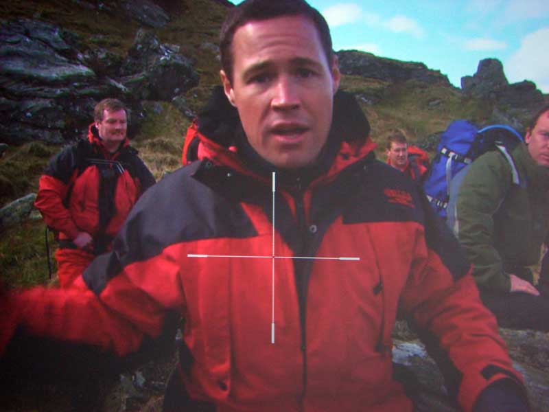

Misc HDTV:
Sunday Night Football, Discovery
                          Channel, NASCAR
I tossed in some random screen captures of some shows and events I
watched with the Panasonic PT-AX100U and I think you'll see that this
is one projector that can make just about anything look good (even a
holding penalty!) NASCAR has never looked this good (though I'm sure
David Ragan's introduction to the sport was less than satisfactory) and
the Discover Channel's
Sunrise Earth
- well, that always looks fantastic in high definition - and
                          this was no exception.
