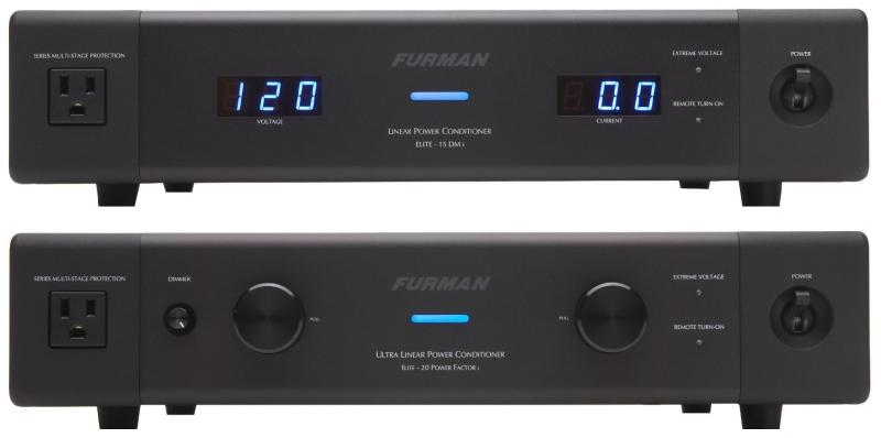

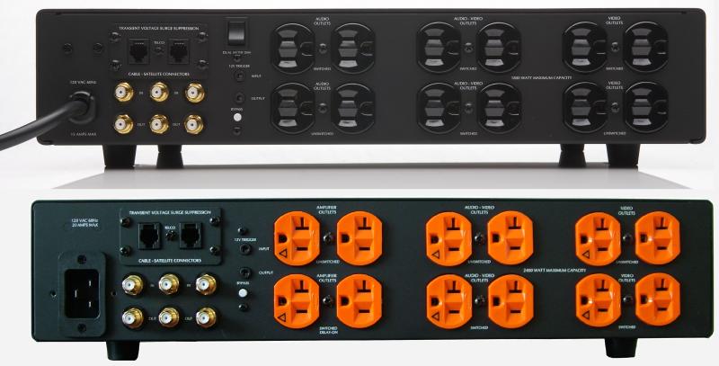

Just glancing at the Furman Elite-15 DMi and the Elite-20 PFi should give you the impression that these aren’t run of the mill surge protector strips. Both models boast a solidly built 2U rack mountable chassis, with the Elite-20 offering a detachable power cord and hospital grade receptacles for a solid connection. Glancing at the front panel, you’ll find a voltage and current meter on the Elite-15, while the Elite-20 eschews these in favor of a pair of LED lamps to illuminate equipment situated below it. Moving to the rear, you’ll also see 12V trigger inputs and switched outlets which can be helpful to stagger powering on your devices and avoid popping a breaker.
Rear view of the Elite-15 DMi (above) and Elite-20 PFi (below)
