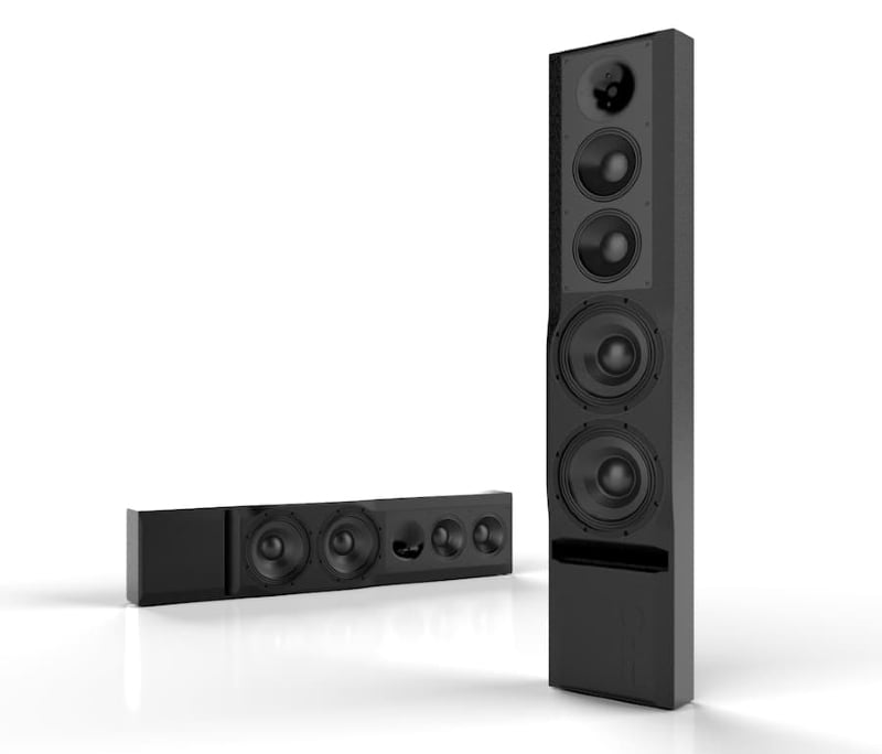

PRO describes the SR-28212ai as “the highest-performance, most versatile loudspeaker system” the company has ever produced. Simply put, it’s a large-format, 3-way multipurpose loudspeaker with a built-in subwoofer system, all packed into a wall-mountable enclosure just 6 inches deep. Although the SR-28212ai needs outboard amplification, it can’t be used with just any amplifier. The speaker requires tri-amplification via a PRO Amplified Loudspeaker Controller (ALC) unit, which handles the speaker’s crossover duties via DSP. Because the ALC also handles bass management, the SR-28212ai can act as three loudspeakers in one: a high-output, full-range loudspeaker for LCR or surround channels, a main subwoofer for the LFE channel, and a bass-management sub to support smaller in-ceiling speakers used for Dolby Atmos effects. In addition to offering this unique level of flexibility, PRO says that the SR-28212ai is the “most acoustically ambitious” design in the company’s history, with the ability to deliver “ultimate accuracy, resolution, and unrestricted dynamics.” The driver complement starts with a wide-bandwidth 1.75-inch advanced polymer “Ultra-Purity” compression tweeter, which sits inside a proprietary wide-dispersion axi-symmetric waveguide. The high frequencies are “clean, pure, and coherent, with no trace whatsoever of compression driver harshness,” according to PRO. The SR-28212ai is the first PRO speaker to use this custom Theorem waveguide, which is said to ensure “textbook on and off-axis dispersion of critical high frequencies.”

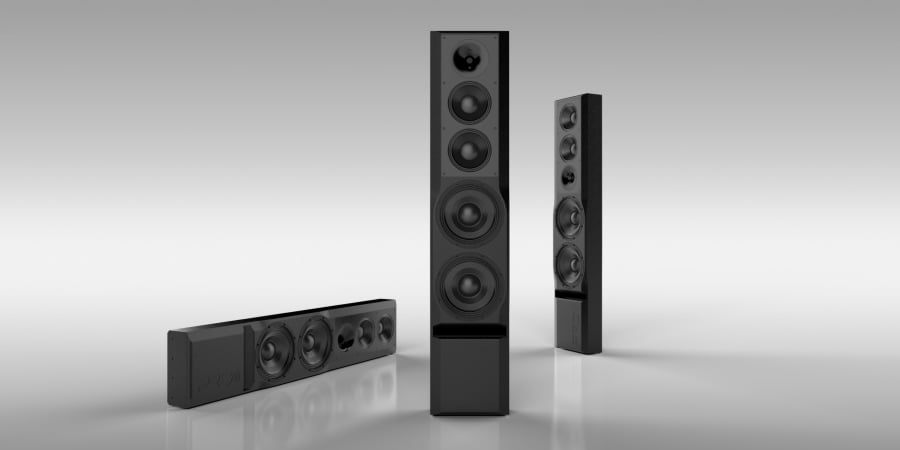

Now, back to the SR-28212ai’s versatility. The speaker ships with PRO’s pivot brackets, allowing it to be mounted to the wall and then aimed precisely at the reference listening position. In this type of installation, the customer would choose the straight-firing axi-symmetric waveguide. But in some rooms where depth constraints are an issue, a customer might need to mount the speaker flush to the wall, or even inside it. In scenarios where the speakers themselves can’t be pivoted away from the wall, the customer can order the SR-28212ai with an asymmetric waveguide that aims high frequencies at a 40-degree angle to the loudspeaker’s main axis when the speaker is mounted flat. The angled asymmetric waveguides can be rotated in 90-degree increments to aim the high frequencies in any direction: up, down, left, or right. The tweeter and midrange drivers are built into a module that can be inverted, so the user can choose to have the tweeter closer to the center of the baffle (as shown in the horizontal speaker in the image above), or on top of the midrange drivers (as shown in the vertical speaker). This flexibility allows the SR-28212ai to be used as a horizontal center-channel speaker mounted underneath or above a large TV, with either the straight-firing waveguide or the 40-degree option, as determined by the specifics of the installation. In another scenario, the flippable mid-tweeter module could allow an installer to mount the speakers upside-down on the side and/or rear walls of the theater. This would place the speaker’s subwoofer section near the ceiling, enabling it to augment the bass for height/effects speakers, while the inverted mid-tweeter module would place the midrange drivers and tweeters at the proper height relative to the listeners’ ears.
