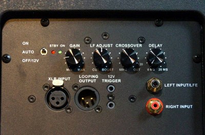

- Connectors: RCA and XLR

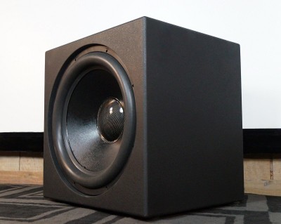

The RS1 comes shipped in a double corrugated box with 2” thick polyethylene foam pieces in 500 lbs.- rated packing, so it is well-protected against rough shipping conditions. Upon unpacking, we can see the RS1 doesn’t make a point of looking fancy. The aesthetic of the RS1 is very much a matter of function over form, and not much concession is given to making the sub pretty or stylish. That isn’t to say it looks bad; on the contrary, I like its simplicity. It is a simple black oblong shape with somewhat rounded edges and an 18” driver mounted on the front. It is finished in a somewhat coarse matte black that is designed to be non-light reflective for dedicated home theater rooms. It is not a small subwoofer by most people’s standards, but it could probably disappear in the corner of many rooms thanks to its muted color, especially in lower lighting conditions. A grille is provided to mask the driver which makes the sub look even less conspicuous, but for those who like the show of force of the high-excursion 18” driver, it does have that, sans grille. The massive driver has a very large surround encircling a smooth black cone with a carbon-fiber dustcap in the center. This is a subwoofer that looks like it means business.
Design Analysis
The JTR Captivator RS1 is a pow
erful sub but, as with many other sealed subwoofers, it is not a tremendously complex design. It mounts a powerful 18” driver into an optimally-sized cabinet and feeds it plenty of power. The more noteworthy aspects of this construction are in the details of the components. The driver design, for example, has gone to great lengths to control inductance. Inductance has long been the enemy of linearity and thus fidelity in subwoofer drivers. Inductance is voltage that is produced by the change in the electromagnetic field from the motion of the voice coil. It runs counter to the electric current being dumped into the coil by the amplifier and in doing so it diminishes output, especially in higher frequency ranges. Inductance also contributes to distortion quantities. It is a serious problem in really massive subwoofer drivers that have a lot of voice coil such as is used in the RS1. To combat inductance, JTR has added a 400-gram aluminum shorting ring in the motor which can help short out the induced voltage. The result should be a more even frequency response with more output in mid-bass frequencies as well as less even-order distortion over the entire frequency range.
The driver motor is a sight to behold with a stack of three 1” thi
ck and 8 ¾” diameter magnets. It is attached to a very sturdy cast aluminum basket, and venting is done underneath the spider. The cone is a paper/kevlar blend with a real carbon-fiber dustcap. It is attached to the frame by a very large half-roll treated-foam surround. The claimed 35.5mm linear one-way throw is definitely plausible from examining the driver. The driver is mounted in a baltic birch plywood cabinet. Baltic birch is multiple times stronger than the standard MDF that most subwoofer cabinets are made of. Due to this fact, not as much mass is needed, so the side panels and braces are only ¾” thick. That helps to save weight since MDF is heavier, and it makes the RS1 a lot easier to physically manage. Internal bracing consists of some panels that run from the front baffle to back panel, -which helps to brace the side walls as well as strengthening the front baffle that holds the massive driver. The inside of the cabinet is lined with wool which the sub’s designer Jeff Parmanian has found to be a very good damping material. The feet are some sturdy rubber rings that could help to damp cabinet vibrations from transferring to the floor.

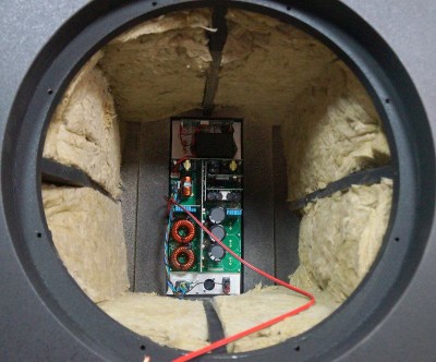

The amplifier is a monster 2,400 RMS Class-D plate amp by SpeakerPower that has a claimed 90% efficiency. JTR provides an option to upgrade to 3,200 watts with a 240v input for those who want to get the very most output out of the driver. It has an XLR input and output in addition to two RCA inputs. The controls are simple with knobs for gain, crossover frequency, ‘LF Adjust’ which can cut or boost the low end, and a delay knob which can add up to 20ms of delay. This is a very useful feature for those deploying multiple subwoofers connected to an AV receiver or processor that lacks independent delay settings for more than one subwoofer.
A heavy-duty driver, an enormously powerful amp, and a well-conceived enclosure: it is an ingredients list for a great sub. The driver and amp are assembled in the USA and the cabinet is built in the USA, so, unlike so many other subs that we review here at Audioholics, this is a homegrown product. The question now is how well does this subwoofer do its job? Let’s give it a listen to find out…

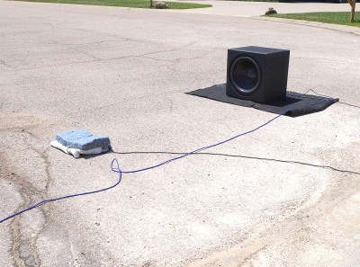

The JTR Captivator RS1 was tested using ground plane measurements with the microphone at a 2-meter distance in an open setting with well over 100 feet from the nearest large structure. The sub was tested with the woofer facing the microphone. The temperature was recorded at 79 degrees with 60% humidity. The subwoofer’s gain was set to maximum, phase was set to 0, and the low-pass filters were left off.

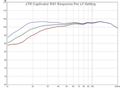

The above graphs show the measured frequency responses for the JTR Captivator RS1 subwoofer per ‘LF Adjust’ dial where the green curve is the 12 o’clock setting, the blue curve is full boost, and the red curve is full cut. The RS1 produces a very linear response that can be flat all the way down to 20 Hz with a few clicks in the direction of ‘Boost’ on the ‘LF Adjust’ dial. Most subs that bear that kind of response are ported, and few sealed subwoofers have the displacement to justify that kind of curve, but the RS1 does. If room gain makes that sort of low-end too boomy, you can always knock down the ‘LF Adjust’ dial to the ‘Cut’ direction which will taper off the low-end for a better fit in smaller rooms. Something else that is nice to see is an upper-end extension out to nearly 200 Hz; that can be useful for those who need to use higher crossover frequencies for either smoothing out the response with multiple subs or supplementing the low end of a speaker with limited extension. There is not much of a higher-pass filter cutting out low-frequency output since the RS1 driver is capable enough to handle the enormous excursions demanded by extreme deep bass frequencies.

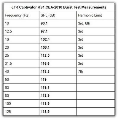

The above CEA-2010 measurements are short-term bursts that show the subwoofers clean peak SPL before heavy distortion sets in. Our measurements have been referenced to 2-meter RMS, which is 9 dB down from the standard requirement for the measurements to be shown at 1-meter peak. However most publicly available CEA-2010 measurements are shown at 2-meter RMS, so we followed that convention. The results here are excellent for a sealed subwoofer, as expected, particularly in deep bass. In fact, the RS1 runs very close to the most powerful sealed sub that we reviewed to date, the monster Paradigm Signature Sub 2. The RS1’s burst test measurements are very close to the Sub 2’s below 20 Hz and tops it from 20 Hz to 40 Hz. That is remarkable when you consider that the Signature Sub 2 costs four times as much, has nearly twice the amplifier power, and nearly twice the cone surface area. What gives the RS1 an advantage here is linear throw; it is a lot easier to move the cone a long distance when there is more room for suspension components to do their work. The smaller drivers in the Sub 2 haves necessarily smaller spiders and surrounds, and they incur a lot more tension for high excursions, thereby inhibiting linear travel. The RS1’s motor is also geared for the high excursion that allows for these kinds of scores. And it isn’t sheer throw that is on display here but tightly controlled throw. This isn’t just a subwoofer cone moving a lot and making a loud noise but rather covering such wide oscillation with composure. CEA-2010 burst-testing is a test of quality as well as quantity, and those tremendous numbers are achieved under certain distortion thresholds. We can see that inductance, so often the bane of high-throw drivers in pursuit of linearity, is nicely addressed here, and the response is flat above 40 Hz even at the highest drive level.

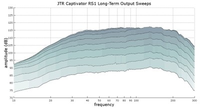

Testing for long-term output compression was done by first conducting a 20-second sweep tone where 50 Hz hit 90 dB with the subwoofer 2 meters from the microphone. We then conduct further 20-second sweeps by raising the gain by 5 dB until no more output could be wrung out of the subwoofer. These tests show us the long-term continuous headroom that the subwoofer is capable of. As we saw in the burst tests, the RS1 has a formidable amount of headroom, which can be seen here to exceed 115dB from 40Hz to 200Hz. In the low end, it manages over 112dB at 30Hz, 105dB at 20Hz, 100dB at 16Hz, and 90dB at 10Hz. The response shape doesn’t change dramatically from nominal to high drive levels either, although these sweeps were done with the ‘LF Adjust’ dial set at maximum cut, and the responses of other settings would have changed even less than what is seen here. This is an astonishing amount of output for a sealed sub in deep bass that would be rivaled by very few other single driver sealed subs.

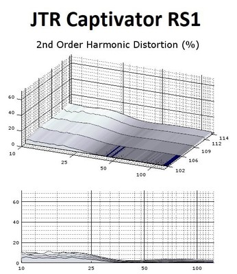

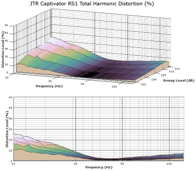

The above graphs show the corresponding total harmonic distortion to the long-term output graphs. Essentially, they depict how linear the subwoofer remains for the corresponding drive level seen in the long-term sweeps. The quantity being measured is how much of the subwoofer’s output is distortion and is shown here as a percentage. It should come as no surprise by now that this is the best THD measurement that I have done with a sealed subwoofer. The RS1 can’t be pushed past 10% distortion above 25Hz, period. The rate of distortion rise below that point is admirable as well, and the RS1 doesn’t touch 20% THD until 14Hz at its very highest drive level. At nominal drivel levels, it holds distortion down below 10% across the entire measured band, and that is phenomenal given the band stretches down to 10Hz. At the 105dB sweep level, the RS1 keeps distortion down to less than 5% from 25Hz and above. This is all extremely clean bass, especially for such deep frequencies. If you want a subwoofer that produces nothing but the input signal, this is all great news. Despite how loud this sub can get, it does not sacrifice accuracy for output.

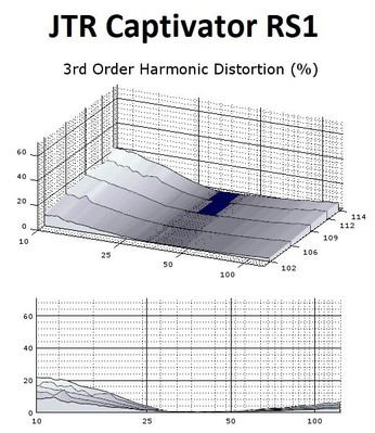

The above graphs depict measurements of the constituent harmonics from the long-term output sweeps and are what the total harmonic distortion measurements are composed of for the 2nd and 3rd harmonics. These individual harmonics can give us a clue as to what might be the cause of some quirk or non-linearity. We are only showing the 2nd and 3rd here because they more or less reflect the higher even-order and odd-order behaviors, although higher-order harmonics tend to be much further down as a percentage of distortion compared to the second and third.
Odd-order distortions are more prominent especially at the low-end, and that shows some degree of optimization for both directions of woofer travel. There may be some slight asymmetry in travel given the rise in the 2nd order harmonic at lower frequencies. At higher frequencies, even-order harmonics are pretty negligible, which indicates relatively low inductance-induced problems. Again, we see the shorting rings are really paying off here. Getting such low THD quantities means paying attention to all the nonlinear elements that can add up, and we see some of that attention to detail in these graphs for the RS1.

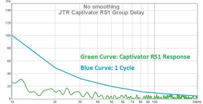

Group delay is the measurement of how much time it takes for individual frequency bands of an input signal to be produced by the speaker. It can indicate that some frequency components are developing slower than others or are taking longer to decay. It is generally thought that 1.5 sound cycles are needed for group delay to be audible at bass frequencies, although there is an argument that group delay should remain under 20 ms to be completely unnoticeable, but that is likely meant for mid and upper bass frequencies. In the group delay of the RS1, we see another exemplary measurement with superbly controlled latency across the measured range. Delay seems to average around 5ms above 40Hz, and about 10ms below that, so there is not much even approaching 1 cycle until past 150Hz. For this reason, I didn’t even bother including the 1.5 cycle curve that I normally do since it is irrelevant for the RS1. One of the advantages for a sealed subwoofer of having a driver with such a huge linear throw is that heavy-duty limiters aren’t really needed, and that is tremendously beneficial for group delay as these filters are what usually increase delay quantities. The time-domain behavior of the RS1 is excellent; this sub produces sound when it is asked and no later.
