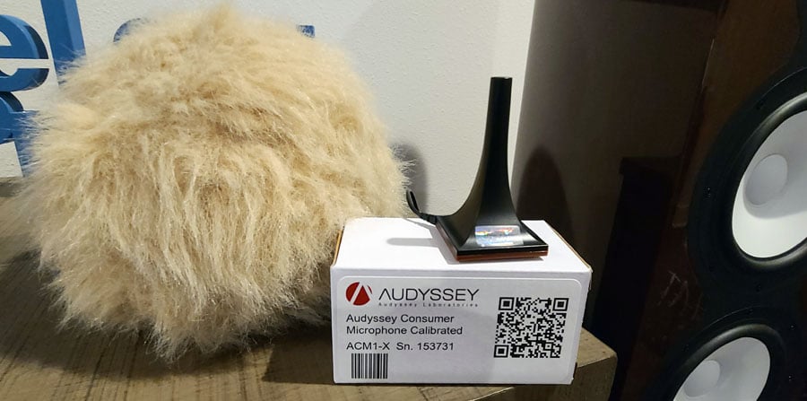

Los Angeles, CA – Audyssey, a leader in audio technology for the home, automotive and commercial theater markets, has unveiled the new ACM1-X calibrated microphone as a companion accessory to its recently announced MultEQ-X room-correction software. The microphone enables measurements to be corrected to a near-perfect match to those of a “type 1” reference microphone.
Each Audyssey ACM1-X microphone is individually measured at Audyssey's laboratory in Los Angeles, CA. Once calibrated, a serial number is assigned, and a unique calibration file is created. MultEQ-X users who purchase an ACM1-X microphone then log in to MultEQ-X and, on either of the pages that have a mic selection option, select “Add New Mic.” From there they enter the microphone serial number, and the mic file is then downloaded and stored within the MultEQ-X application. Once the microphone and app are successfully paired, the user can attach the microphone to their AVR to perform MultEQ room correction to perfect their listening environment.
