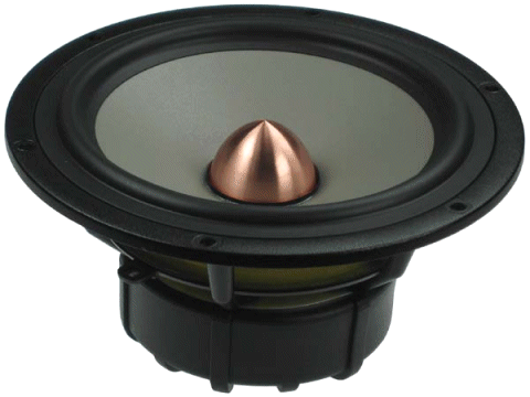

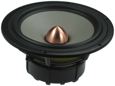

Example of a quality loudspeaker driver not meant to be used as a bass driver
One particular example that recently comes to mind is from a high end online loudspeaker company utilizing a fabulous SEAS mid woofer as a bass driver in a tower speaker that was tuned too low causing the driver to bottom out if played at output levels exceeding 75dB 10 ft away from the speaker in a moderately large theater room. In our opinion, the woofers in a well engineered system should never bottom out, nor should they ever try to reach beyond their designed bandwidth. The driver shown above is a wonderful midrange driver, but its not well-suited for bass frequencies based on its limited Xmax and Xlim characteristics. Yet, this didn't stop the manufacturer from employing it in a floorstanding speaker tuned to play full-range.
Part of the reason this happens, is because frequently the requirements for a good midrange, are opposed to the requirements for good low frequency performance from the same size driver. Mass, cone geometry and depth, cone flare, voice coil length and inductance, moving mass, all of these parameters of the speaker designed are going to influence its ability to reproduce accurately either mid or low frequency sounds. Expecting one speaker to do both optimally is an unrealistic expectation, and the employment of a speaker optimized for one purpose in a box too large reaching too low is asking the driver to do more than its designer had envisioned.
Editorial Note about Xmax & Xlim for Driver Mechanics
The maximum amount of usable excursion before unacceptable levels of distortion are reached is known as Xmax, and is measured typically in millimeters. This is based mostly on the height of the voice coil, and the thickness of the top plate. Xlim, however, is how far the speaker can travel mechanically before it ends up creating damage to itself.

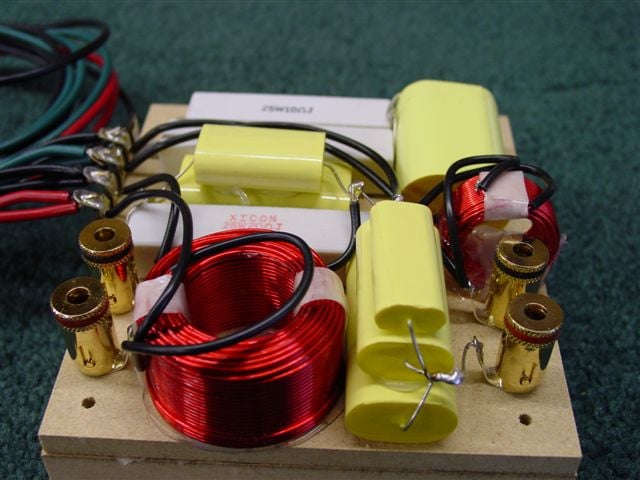

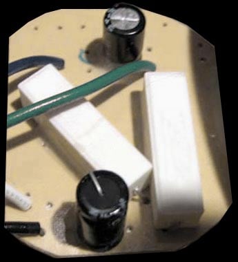

Was the crossover designed correctly? Did the manufacturer avoid extremely low impedance dips (under 3 ohms, especially at low frequencies) where amp power would be gobbled up needlessly? Did they make the mistake of running a midrange driver full-range which causes it to exceed its excursion capabilities and allows it to play audibly into its break up mode, (high and audible distortion), while also dropping low frequency system impedance?
Example of a Poorly Designed Budget Crossover Network (Left Pic) & a High Quality Crossover (Right Pic)
The crossover (above left pic) is from a two-way bookshelf speaker system costing in excess of $350/pair. The speaker system employs a stiff cone driver which has no crossover circuit (namely a Low Pass Filter) on the woofer to limit its bandwidth and reduce its audible break up mode. We've even seen variants that employ electrolytic capacitors in series with the tweeter which, in our opinion, is done solely for cost savings as these parts have higher resistance and performance variances than quality and more costly poly designs. This is the type of network you'd expect in a $150/pair of speakers at Walmart and should not, in our opinion, be part of any serious high fidelity loudspeaker. The crossover (above right pic) utilizes high quality air core inductors and polypropylene capacitors. The midrange drivers are correctly bandwidth limited to ensure the breakup modes won't be audible even at high drive levels. Notice this crossover (right pic) uses multiple poly caps stacked in parallel which gives an equivalently larger value needed for the proper roll off characteristics, but also greatly reduced ESR (Effective Series Resistance) to further reduce losses.
It is important to remember as consumers, there is a big difference between an engineer getting a few samples correct versus designing a product with all the tolerances calculated so that everything assembled turns into a working unit. Making a good pair of speakers is one thing. Designing a process where every speaker is a clone of its prior unit is something else again. One of the most important things we can do as consumers to protect ourselves, is getting that money-back guarantee. If we know nothing technical, at least we know when we get the speakers home, if they are not performing to our delight that we can return them. Before you buy, ask, and be sure to ask if they also charge a re-stocking fee. In our opinion, a liberal return policy is a valuable asset that is a must when buying loudspeakers.
