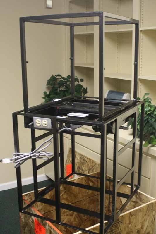

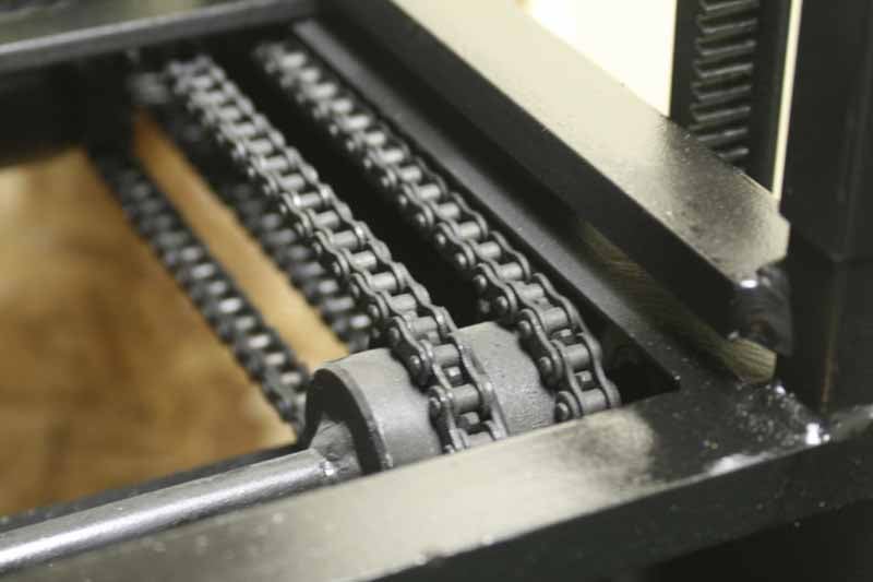

It was very obvious from the moment we received the package until the unit was lowered under power, Auton had cut no corners on their construction. While the unit is fairly heavy, it is also that much more sturdy. Built from steel, square tubing and angle-iron, and with full welds at every junction; I would have no problem letting this unit support all of my "trim" 260 lbs. Along with the well-built frame, is the use of all metal gears, drives, and chains. This system is full of parts you would find looking at a McMaster Carr catalog (Industrial Supplier), or looking under a Caterpillar D-9 (bulldozer). On one hand I could mention that making this cage and frame from aluminum would lighten things a bit; on the other, some of the structural integrity would be lost as well.
Due to the build quality, it did make things a bit cumbersome when trying to hold the unit in place and mount it. This was being installed in a business conference room with a suspended, drop-ceiling. So not only did we have to manage holding this in midair, we also had to maneuver around the ceiling grid. Even with the weight of the lift and the ceiling grid, it was a very nice fit. The dimensions of the lift seem to be well thought out, as it would have worked between residential ceiling rafters, and it also fit well in the 24 x 24 ceiling grid.

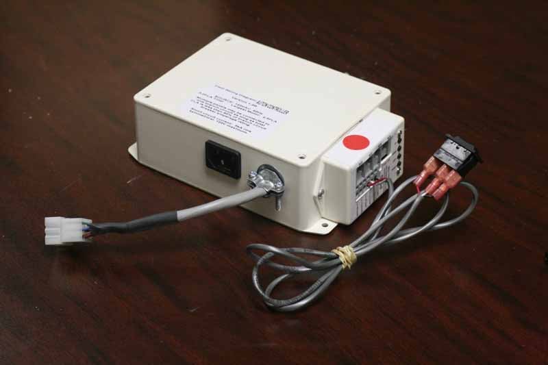

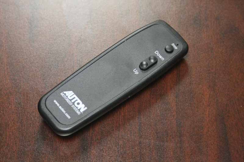

There were several controls included with our lift. One was a typical IR remote with a rocker switch for Up or Down, and a separate button for Stop. Also included was the system control box with Up, Down and Stop buttons attached as well. Lastly, there is a rocker switch that is hardwired into the control box, with several feet of wire to enable remote mounting.

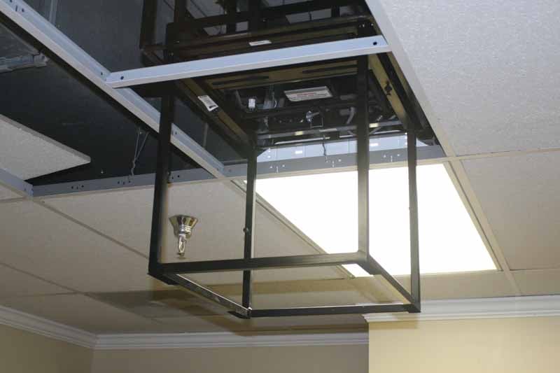

This is where some of the "real" work began. Hanging this well-built cage above a drop-ceiling and fastening it into concrete overhead was not an easy task. There were no instructions included for installation, likely due to the almost limitless possibilities which exist. After all, this product is made for experienced installers (don't try this at home, kids). Despite this, with some simple measuring and a good once-over, we were well on our way. Well, at least we were on our way towards thinking about how it should be done. So, with our fingers at work, we quickly found ourselves Googling for the best concrete anchors. Afterwards, it was off to The Home Depot.

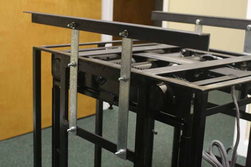

We decided the best scenario for installing the unit was to mount 1" angle to the concrete ceiling, using "Sleeve Anchors" made for concrete. Then, we would use 1" flat-bar bolted to the angle, and bolt the other end to the lift. This would suspend the lift from the concrete ceiling at a distance of several inches, but still leave room for it to be concealed by the drop-ceiling. Walking into the 'can't spend less than a Franklin' store, the time was 8:45 PM. We were able to find all the hardware needed for around $50 (flatbar, angle, strap, bolts, nuts, lock-washers, washers, concrete drill bit, metal bit, and sleeve anchors).
Now the fun began - we actually had to put the plan into practice. We made our measurements and marked the ceiling. I drilled the four holes for mounting the sleeve anchors, and only hit re-bar on every other hole (50/50, not bad). We adjusted, pushed the anchors into the completed holes and two of us carried the lift up the ladder. Yes, one ladder, two of us. What?! Hey, that's why there are steps on both sides. Anyway, with a little engineering and a lot of sweat, we got the lift positioned and anchored into the concrete ceiling. Very sturdy too, I might add.

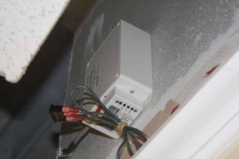

Once mounted, the wiring was very easy and self-explanatory. The control box was mounted to the wall, above the suspended ceiling, and the grounded plug was plugged into the outlet. We won't discuss the well thought-out procedure to get the 110V outlet in the attic space. (Let's just say that there are electricians pliers that are no longer of good use.) We then trimmed down one of the ceiling squares, so it would fit through the grid. Using industrial hook & loop (Velcro), we fastened the smaller ceiling tile to the lift cage. Plugging the male/female controller wires together, it was time for testing.

Now that the lift was securely anchored in and all the plugs were safely connected, it was time to play "Let's see what this button does". One push of the "Down" button revealed the lift magically dropping from the ceiling. Looking at the mechanisms driving the cage (very industrial, as earlier mentioned), I expected a not-so-pleasant sound when in use. I was surprised to hear a very slight hum when in motion. The cage dropped to its full "down" position and stopped. Pressing the Up button had the same positive results. Now we moved on to the fine adjustments.

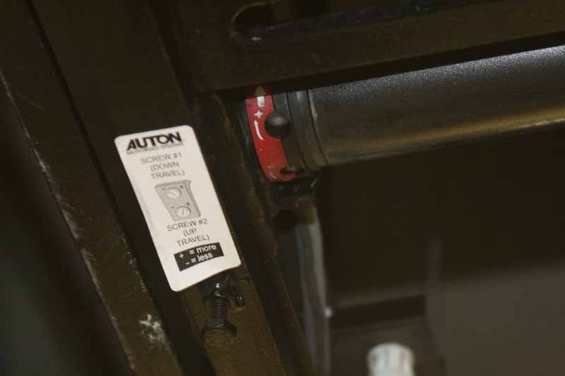

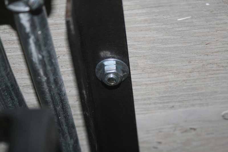

There are manual and electrical adjustments for the drop of the cage. We did not need to use the manual adjustments, which only require loosening a 7/16" bolt on each leg of the cage. The included hex-wrench was used to make the adjustments on the electric motor. With a few twists of the wrench, the travel of the lift was dialed in perfectly. It really didn't take too much back and forth and we were able to get exactly thr height we needed. With the ceiling tile attached to the lift, when the cage reaches the top, you could never tell that there was 100 lbs. sitting over your head.
Now that the cage was dialed in, it was time to install the projector for testing. Using our existing projector and mount, it easily bolted into the sliding mount on the cage. The only parts needed were two 1/4" x 1" bolts with 1/4" nuts and washers. Included on the cage were two outlets to supply the required 110V. Plugging the projector in, we fastened the wire to the cage securely with zip-ties. We then connected the wires from our source, in this case, VGA from a laptop. Everything worked flawlessly.
