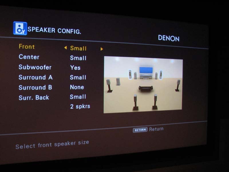

Check your set-up configuration in your A/V receiver / Processor (aka. AVR)
First go
into your AVR's setup menu and ensure all speakers are enabled and properly
assigned for the channels they are supposed to be reproducing (ie. center,
left/right surrounds, etc). Some
receivers have an option for Speaker A or B for the front channels. Make sure you make the proper selection as to
what you have connected.
If you’re running 7.1, make sure the Surround Back channels are engaged in the receiver setup menu. Most 7.1 A/V receivers default the back channels to “off” or re-route the back channel amplifiers to another zone. Consult your operators manual for more information.

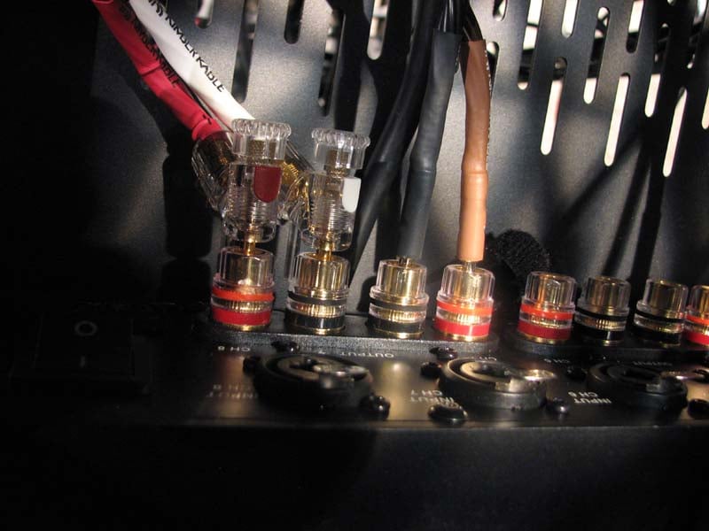

It is highly recommended to use compression style locking banana plugs like the ones pictured in our Kimber 8PR speaker cable review instead of bare wire or spades.

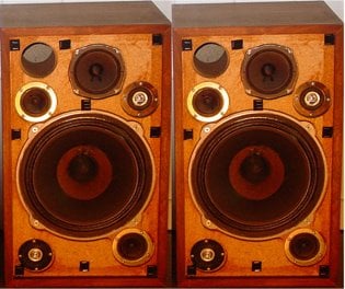

Try connecting the problematic speaker to another channel and verifying it works correctly. If it does, you'll hear sound when it moves to another working channel. If it doesn’t, then the speaker is either damaged or blown out. It may be time to upgrade some or all of your speakers, especially if they share any resemblance to the ones pictured here. Consult this site for hot recommendations.

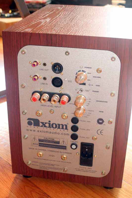

I’ve also run into scenarios where the master power switch on the back
of the sub was turned to offI. In either case the subwoofer will not get power
which is obviously a bad thing. Check
for both of these potential issues before delving further.
Pop quiz:
Look at the picture above of the Axiom EP400 subwoofer. What is wrong with this picture? If it baffles you, re-read the previous paragraph and look again.

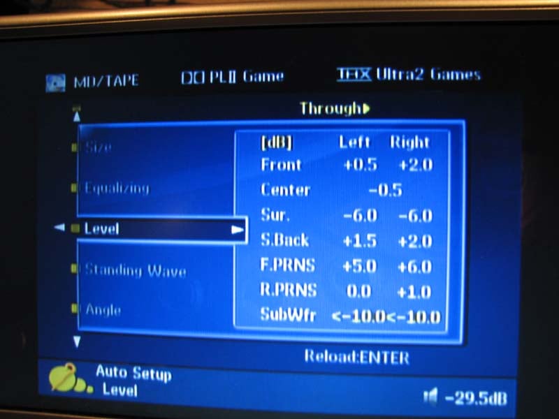

If the subwoofer level control is ok, check the subwoofer level in your AVR. An SPL meter will come in quite handy to ensure all of your speakers, including your sub(s) are level matched. Most users prefer boosting the sub woofer level a few dB higher than the rest of the channels. Don’t be afraid to do this, adjust to preference.

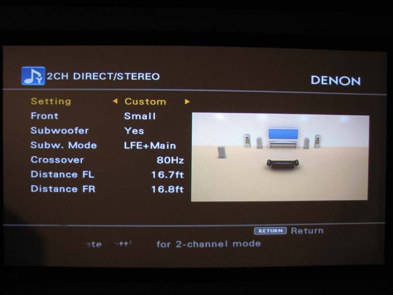

Check your bass management settings in your AVR
For most installations, you can achieve the best overall performance setting all of your speakers to “small” with a fixed global crossover of 80Hz. Make sure you defeat the Low Pass Filter (LPF) in your subwoofer or set it to its highest setting to avoid cascading effects with the LPF in your AVR.
You should also verify that the “Bass out” in your AVR is set to “subwoofer” or “both” else you may run into a scenario for two channel sources where there will be no subwoofer output at all.
Verify the proper speaker distances in your AVR are
set for all of your speakers, including the subwoofer. Improper setup here can lead to a substantial
suckout at the crossover frequency between your main speakers and subwoofer(s)
resulting in a thin sound or poor satellite to subwoofer integration.
It’s also important to note that some AVR’s have an independent bass management configuration for two-channel audio. If your AVR does in fact offer this option, make sure you properly configure it else you will have no subwoofer output when listening to two-channel sources such as CDs. In addition, if your AVR offers a “pure direct” mode, verify if your subwoofer is still active when you have that mode engaged. If it isn’t, and there is no way to enable it via the AVR set-up, don’t use this mode if you prefer simultaneous output of your subwoofer.

Have you moved the subwoofer(s) or furniture recently? If so, this could have an adverse affect on low frequency performance. Recalibrate levels, phase, etc accordingly. If you initially calibrated with an Auto-EQ and your room conditions have changed significantly since then you would be advised to re-run the setup again.
Use the following subwoofer placement & calibration tips:
An Easy Solution to Subwoofer Calibration
Tips for Connecting a Multi Subwoofer System
Editorial Note on Auto EQs
Even the best Auto-EQs are notorious for botching your system's calibration. Never treat them as a biblical source but more as a starting point. After the Auto-EQ has completed its setup, its usually a good idea to check your bass management settings to ensure it properly configured your speaker sizes, crossover points and subwoofer distance.
