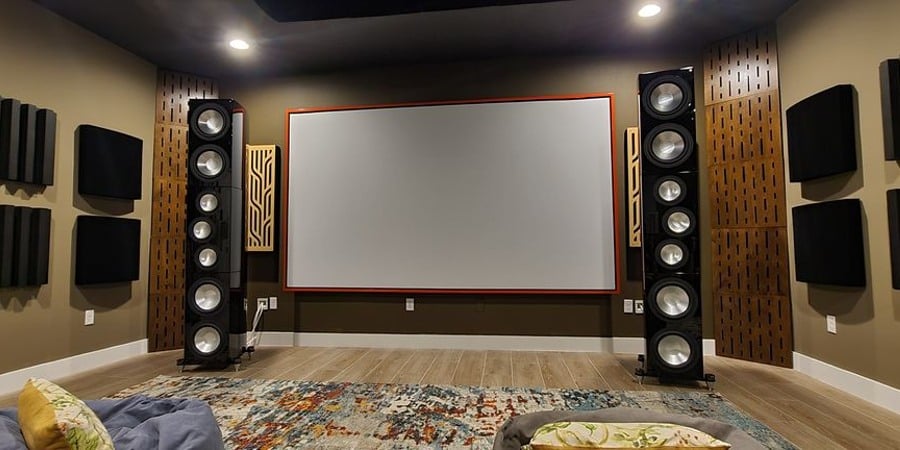

AH Smarthome Theater Room - Front Stage w 150" Screen Innovations AT Screen

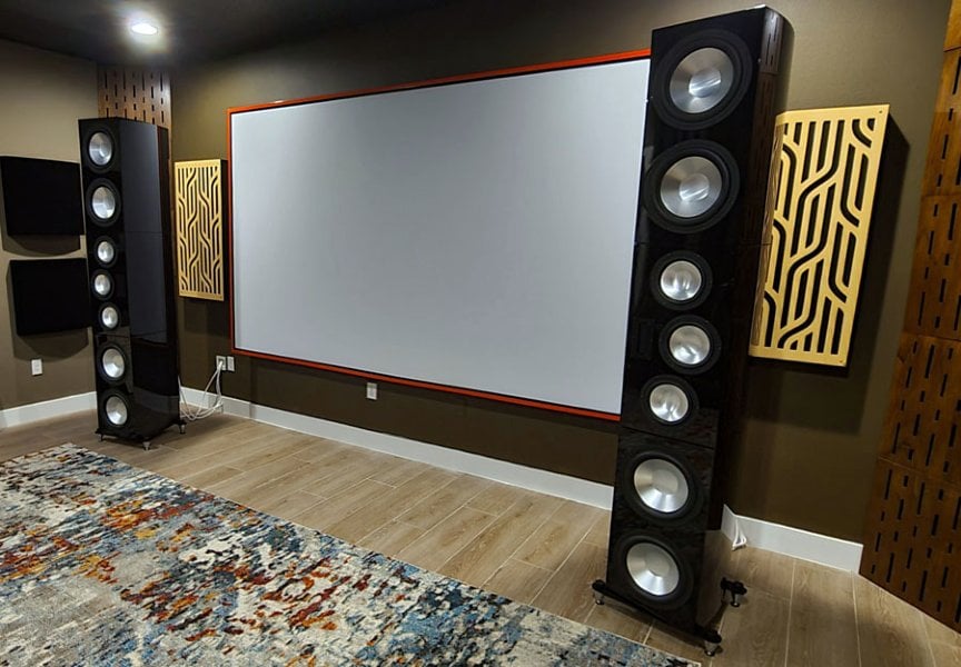

In Gene’s home theater (and in his family-room system as well), he has eschewed on-wall and in-wall speakers for his main left and right speakers, placing only the center-channel speaker behind the acoustically-transparent screen. While it’s certainly possible to achieve great sound using flush-mounted speakers for your whole front stage — particularly if your main focus is movie-watching — it’s extremely difficult to create a deep soundstage when your front speakers are all mounted to the front wall, and therefore all on the same plane. (If you do need in-wall or on-wall speakers that do an unusually good job at this, and you have plenty of cash to spend, check out Steinway Lyngdorf.) Using freestanding speakers allows you to adjust how far the speakers are placed from the walls, how far they are placed from each other, and the angles at which they are toed in. While there’s no way to tell you exactly where to place your speakers for optimum sound in your room, you can start by checking out our articles about room acoustics. Experimenting with speaker placement can be enlightening, and even fun. And if you don’t enjoy the process, you can appreciate that it doesn’t cost you anything but a little time. Even small changes to these parameters can have a significant effect on sound quality.
By bringing the speakers out into the room, you can definitely get an increase in the depth of soundstage that you just can’t get with your speakers behind a screen.

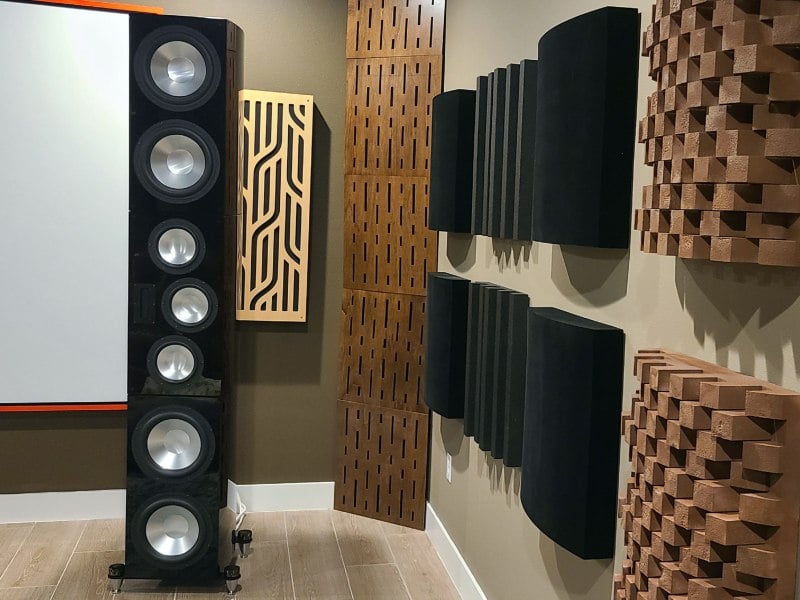

Excessive Room Treatment
Another likely culprit for compromised two-channel performance in a dedicated home theater is an over-treated room. Specifically, the use of too much absorption can make your two-channel audio sound dry, flat, and dead. When you’re surrounded by speakers, you might be tempted to add more and more absorption in order to reduce reflected sound and allow your speakers, rather than your room, to produce the sonic ambience. To a certain extent this approach makes sense; controlling reflections can improve dialogue intelligibility, and can help a Dolby Atmos system more precisely place objects within the 3D sound-field, for example. But too much absorption can make a room sound unnatural, and this effect is more noticeable when listening to just two speakers.

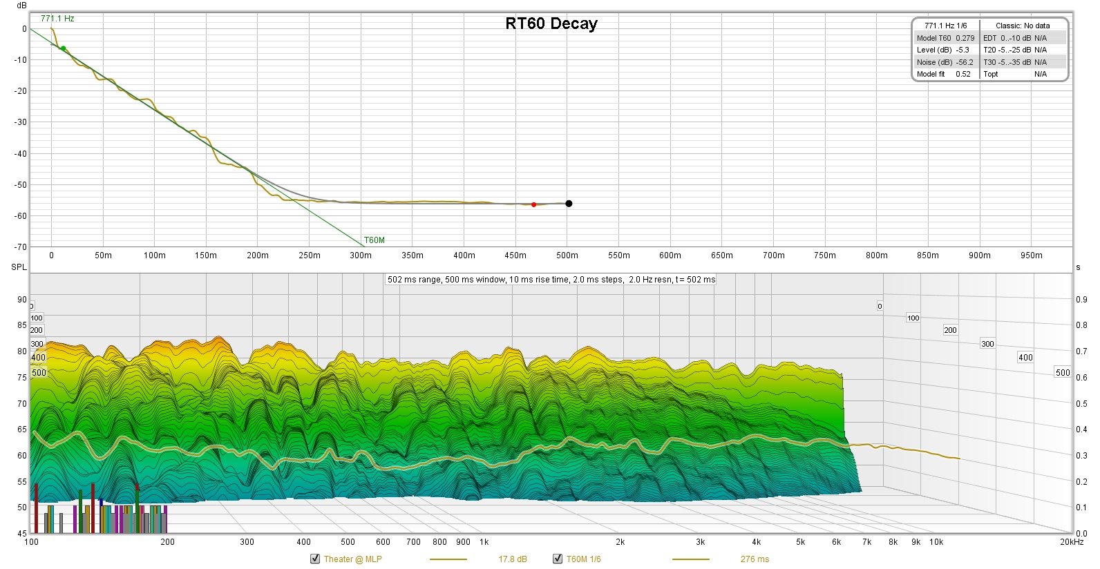

Some reflected sound is actually required in order to make stereo work. Don’t believe me? Try setting up a pair of speakers outdoors and see how hard it is to achieve any kind of soundstage. If you’re technically inclined, you can use REW (Room EQ Wizard, a free software for room acoustic measurement) to measure your room’s RT60 (reverberation time) before and after applying treatment. RT60 decay time is a metric that describes the length of time taken for a sound to decay by 60 dB from its original level. Gene recommends shooting for something between 300 and 700 milliseconds. An RT60 decay time in this range should mean that there is enough reverb for two-channel audio but not too much for home theater.
The RT 60 decay measurement below was taken in the AH Smarthome theater room with the front speakers and subs playing at the main listening position. Notice how linear the response is for the entire bandwidth. The acoustical treatments in this room are furnished by Sonitus.
RT 60 Decay Time AH Smarthome Theater Room (approx 360 msec)
Every room has a specific balance of direct to reflected sound that will make the room feel natural to listeners. You need some absorption, yes, but also some reflections. Typically, you should only cover about 25% of wall surfaces with absorption. Exceed that amount and the room will start to sound too dead. 25% absorption means that 75% of the wall surfaces will still be hard, leading to reflections that could cause errors in sound clarity. You can simply break up these reflections with diffusers. They generate uncorrelated and random acoustic energy that sounds more like the pleasant reverberation of a concert hall and less like the annoying hard reflections you often hear in small rooms. The right balance of absorption, reflection, and diffusion results in a more pleasing sound field, with better envelopment, better imaging, and a wider sweet spot.

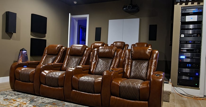

AH Smarthome Theater Room w Tuscany Valencia Seating
Bad Seating Positioning
Unless you’re lucky enough to have a dedicated listening room, you may not have complete control over where to place your speakers and your furniture. That said, the location of your listening seat in relation to your speakers — and in relation to the walls — can have an enormous effect on sound quality. For example, it’s best not to have your seating off to one side, or pushed up against the back wall. Start by forming an equilateral triangle using your speakers as two points and your main listening position as the third. For example, if your speakers are 10 feet apart, your seat would be 10 feet from each speaker. If you find that the center image isn’t as rock-solid as you’d like, try moving your speakers a little closer together — maybe 8 feet apart instead of 10. Just make sure that your seat remains equidistant from the two speakers. Ideally, your seats should be located away from the back wall — ideally about 1/4 of the length of the room (ie. 6ft from the back wall in a 25ft long room). If you’re too close to the back wall, you’ll likely experience very uneven bass because of the standing waves that tend to form in that part of a room. These are just guidelines, of course. You will have to do some experimentation to find what works best within the limitations of your space.

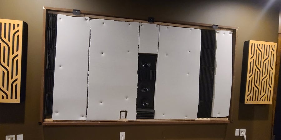

AH Smarthome Theater Room 150" AT Screen Framed out with Acoustic Treatments and Center Channel
Gene also has a great tip for anyone wanting to maximize two-channel performance in a room with a large acoustically-transparent projection screen on the front wall. First, he suggests framing the screen and installing it off the wall by at least four inches, with the ideal distance being 8 to 10 inches for the best acoustic performance. Then, fill the space behind the screen (with appropriate cutouts for any speakers) with a dense foam, such as the memory foam commonly used in mattresses. This will provide effective absorption of reflections off the front wall and prevent the tympanic membrane effect of a vibrating screen. In Gene’s home theater, this relatively affordable memory foam installation worked better than the foam products commonly sold for absorption, resulting in more focused imaging when listening to two-channel audio.

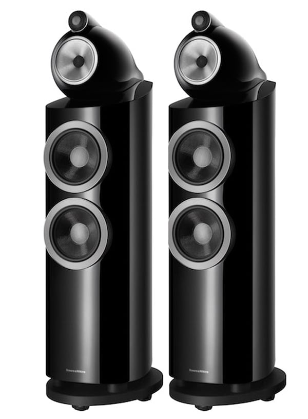

speakers, he had a pair of impressive floorstanders from Bowers & Wilkins
(I think they were the 803 D3, but don’t quote me on that). He didn’t use a

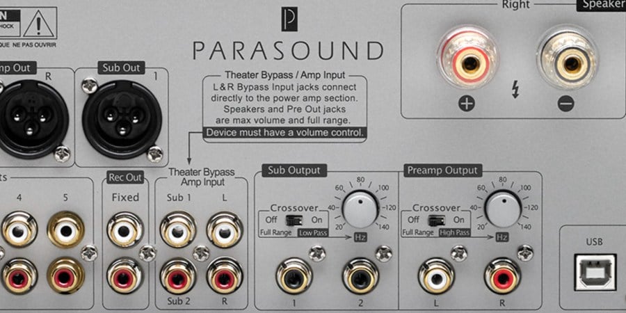

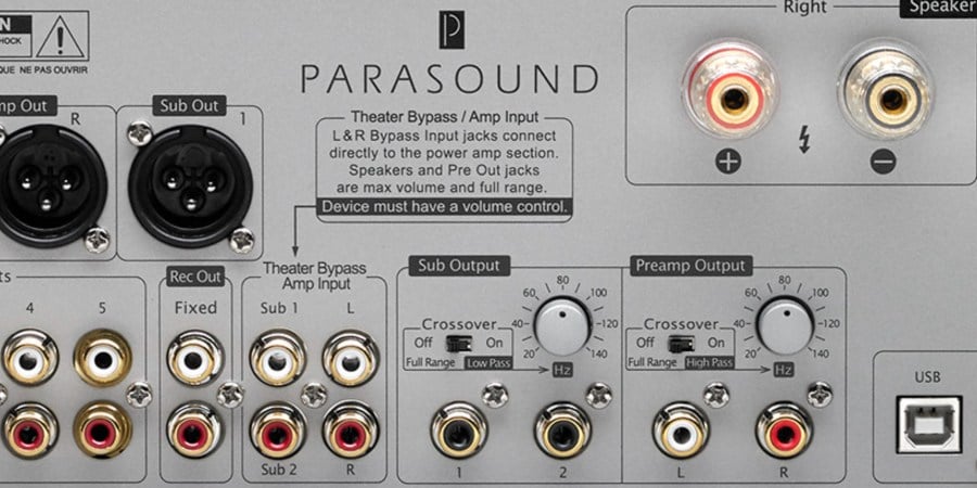

sub. Because his preamp included a feature called home theater bypass, building
a home theater around this system was not only possible — it was fairly easy. Home
theater bypass is fairly common on high-end integrated amplifiers, and it’s not
unusual to see on preamps either. Basically, it is an input (RCA or XLR) to
which you connect the front left and right preamp outputs from your AV receiver
or processor. (This works with any AV processor, and any AV receiver that has
preamp outputs.) When you select the home theater bypass input on your
integrated amp or stereo preamp, the incoming signal from the AVR bypasses
everything — the volume control, tone controls, etc. — and is sent straight out
to the power amp. It allows the stereo gear to operate as normal, without any
of the home theater equipment in the signal path, yet it also allows the AVR to
control the main speakers’ volume (along with the rest of the theater system)
when watching movies. So, everything in Sharad’s existing system remained the
