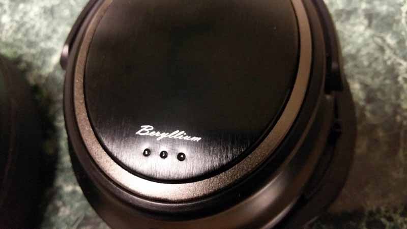

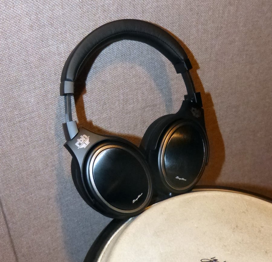

Despite their modest asking pricase-pkg.JPGce, the RBH HP-2s come armed with serious technology, most notably their 45mm beryllium-coated drivers.  Beryllium is an ultra lightweight and strong material that allows for a breakup mode much higher than the upper limits of the audio band, allowing for reduced distortion and better clarity.  This is a hallmark of ALL speakers we've heard with beryllium drivers, most notably RBH's very own $50k/pair Status 8T reference speakers.  The HP-2's have a rated frequency response of 10Hz to 40kHz.  There are three tiny ports on each cup that extend bass response but they can be plugged if desired.  What is most impressive to me about the design of these headphones is their high sensitivity (98dB) and 32-ohm impedance, making them an easy load for even a smartphone to drive at levels that can cause serious hearing damage if the listener isn't careful.

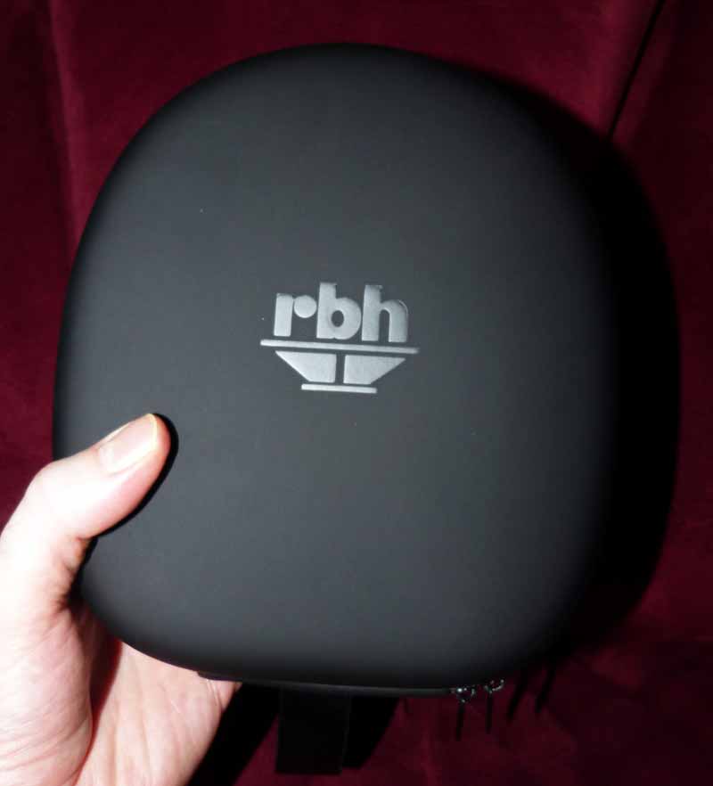

The HP-2s come with a sturdy and reasonably compact protective carrying case, a 4ft standard audio cable with built in microphone and controller, a 4ft tangle-resistant audiophile cable and a 1/4" phono  adapter. A longer cable can be purchased through RBH if needed.  The carrying case is lighter and more compact than some we've seen recently and they actually had the foresight of including a pouch to stow used cables.
The first thing you will notice when picking up these headphones is that they are extremely light (8.82 oz). In fact, I'm able to lift them comfortably with my pinkie.  Why is this important?  The lighter the cans, the less wear fatigue, something regular headphone users can appreciate.  The ear cushions are quite comfortable too, making these headphones a real pleasure to wear for extended listening sessions.  The earpieces swivel 90 degrees inward from the headband making them easy to fit back into the carrying case.  Unfortunately I found the headband clamping force to be a bit too tight for my head, but I do have a workaround discussed later in the review.  There are plenty of color options to choose from—as long as you're happy with black.

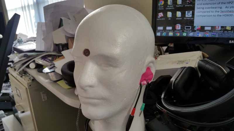

Here is a quick and dirty way to measure over-ear headphones using a foam head at a Michael's, which is a local crafts store. Let's call him Mr. Bob.  The microphone was placed inside of Mr. Bob's ear while the HP-2s were placed over his head to conduct the measurements.
Mr. Bob simulated head for On-Ear Headphone Measurements

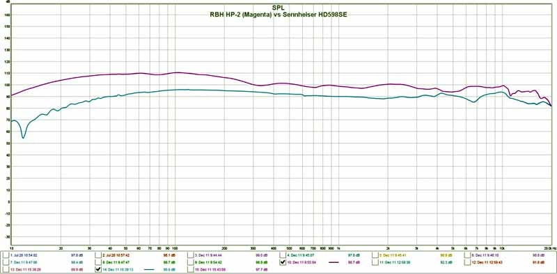

RBH HP-2 vs Sennheiser HD598SE Frequency Response Graphs
The RBH HP-2 were compared to a known reference, the Sennheiser HD598SE. The sensitivity of the Sennheiser is about 7dB lower than the HP-2, which doesn't surprise me. As I said before, the HP-2s play hellishly loud with very little input.  What is interesting about this graph is how the HP-2s follow a target room curve for loudspeaker playback systems. According to Harman research, good headphone and speaker response should be very similar when measured at the ear.  You want a slightly elevated but flat bass response with a gradual tapering off of the high frequencies.  This profile is what made the HP-2s sound warmer and fuller than the comparably priced Sennheisers.  I also found this to be the case when compared directly to the more expensive Oppo PM-1 headphones.  The PM-1's were both less sensitive and had less bass output than the RBH HP-2s.

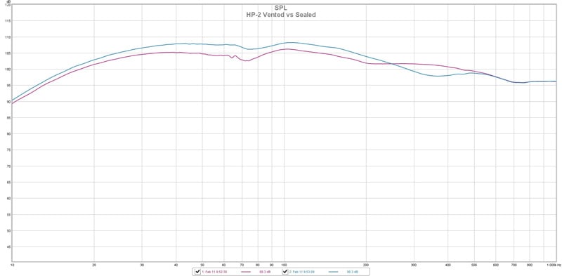

Too Much Bass?  Here is the Solution
For those that prefer less bass from their HP-2s, you have three options:
1.  Use a tone control to dial to preference
2.  Seal the ports with silicone (semi-permanent solution)
3.  Electrical tape over the ports (as needed)
Sealing the ports with silicone does work nicely to maintain a finished look but once you do it, it's diffuclt to reverse .  Thus I highly recommend to instead use black electrical tape to seal the ports as desired.  That way you can always take the tape off when you desire more bass from source material that sounds a bit anemic.  My personal preference was to cover just one port on each side with electrical tape for bass heavy program material.  It was very easy to apply and remove as needed.
RBH HP-2 with ports sealed for reduced bass
 Here is the port plugging procedure:
  1. Use your fingers or tape (scotch, masking, electrical etc) to initially cover the wholes while listening. Experiment with covering 1, 2 or 3 holes to see how much reduction in bass you prefer.
  1. Once you have decided how many holes to cover, put a little bit of GE black silicone (or any other brand of black silicone you can get at your local hardware store) onto the tip of a soft cloth. Lightly rub silicon into the holes you want to fill.
  1. Wipe excess silicone off of headphone. It will come off very easily.
  1. VERY IMPORTANT! Let silicone dry an hour or so before using headphones.
  1. Done! You now have modified the tuning of the headphone chamber to give you the low frequency response you prefer.
RBH HP-2 Frequency Response Comparison
blue trace: ports open      red trace: ports sealed
As you can see, sealing the ports significantly reduces bass response (about 4dB below 150Hz) but also bumps up the 250-400Hz range about the same amount.

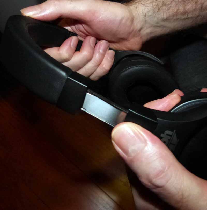

As good as the RBH HP-2sheadband.JPG are, they aren't perfect.  Despite these being ultra-lightweight headphones, they quickly caused me ear fatigue when wearing them for more than 30 minutes at a time.  I soon realized the headband had too much tension to comfortably accommodate my largish head.  I informed RBH about this and they suggested that I bend the metal extension glides out a little.  After doing this, I had no problems with comfort.  I suspect others will run into this issue so I'd recommend before sending them packing before the 30-day trial period is up,  give this fix a try.  I do hope RBH looks further into this and upgrades to a wider headband to eliminate this issue entirely.
