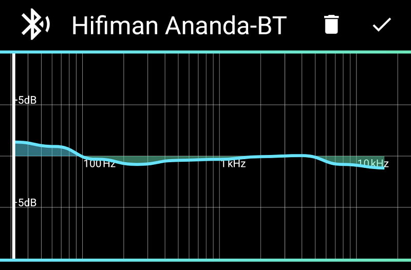

Having said that, you only live once.  I do have a slight correction applied using Neutralizer, an Android 10-band EQ app.  These headphones lend themselves very well to EQ.  I applied a slight boost to the 32 and 63 Hz bands while taming the 125 and 250 Hz bands a bit.  These filters pivoted the cymbal range down a couple dB, which I accepted with indifference.  The result leaves me grinning like an idiot.

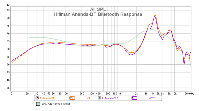

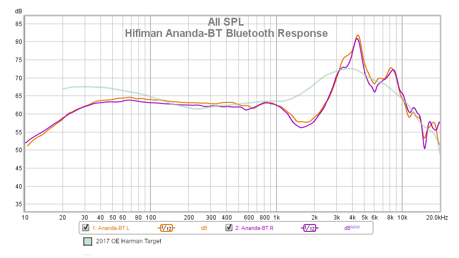

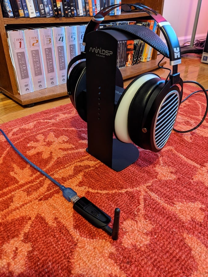

The Ananda-BT headphones can get signal either via USB-C or via Bluetooth.  Both require the headphones to be powered on and for signal to flow through the onboard DSP.  Because I intend to use these headphones exclusively as Bluetooth headphones, I performed measurements over Bluetooth.
response_with_target
According to the graphed response I would expect to be missing some detail around the 2kHz range.  Honestly, I don’t.  This is a good argument for spending some time becoming familiar with your equipment before letting a graph tell you what you should expect to hear.  It’s a bit of a Catch-22 for one who shops for equipment based on response graphs, right?  How does one choose what to buy without some expectation of what he will hear?  All I can say is, graphs are the beginning of wisdom, not the end.
The subtle rise from 600 Hz down to 60 Hz explains the slightly overcooked midbass I mentioned earlier; but as I said, it’s not enough to make the sound displeasing.

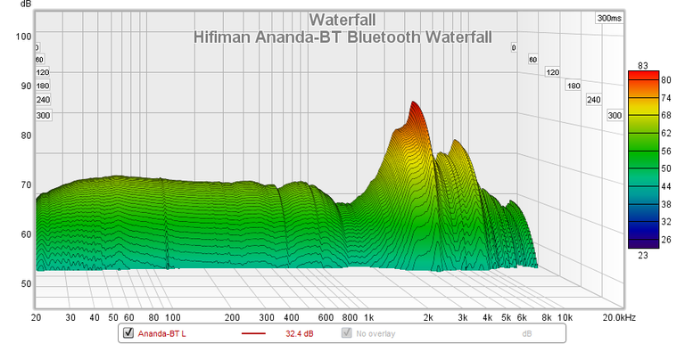

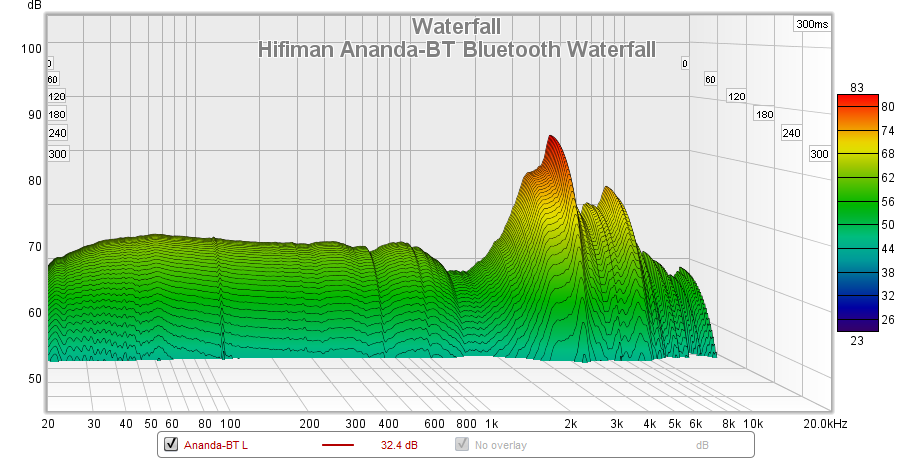

Hifiman Ananda-BT Waterfall
Because this was measured over Bluetooth also using itself as a timing reference, I’m not certain how reliable it is.  Measurements in the time domain have diminished meaning with such a latent transmission method.  Regardless, there is no range on these headphones where I hear any ringing.  The waterfall plot seems to support this.

HiFiman BTThe headband expansion mechanism is tight.  Pulling the ear cups down takes some effort.  Unfortunately, this feat of brute strength is required right next to a delicate wire feeding up into the headband.  Hopefully over time this tension will relax.
Once the headphones have been properly sized, they are supremely comfortable.  They are deceptively lightweight.  The clamping force is barely noticeable while still sufficient to support their insubstantial heft, and the open backs allow my ears to breathe.  Comfort is not affected by wearing glasses, nor can I perceive any audible difference with glasses versus without.  The polyester face of the ear pads may get sweaty after an hour or two of listening.
